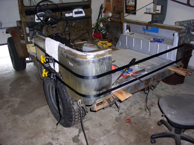

Well, made some more progress tonight. Spent some time squaring up the rear of the tub with shims and ratchet straps. Got it close enough--I think/hope.
As you can see, I have lots of top quality, welding-specific clamps. :rolleyes: We make due.

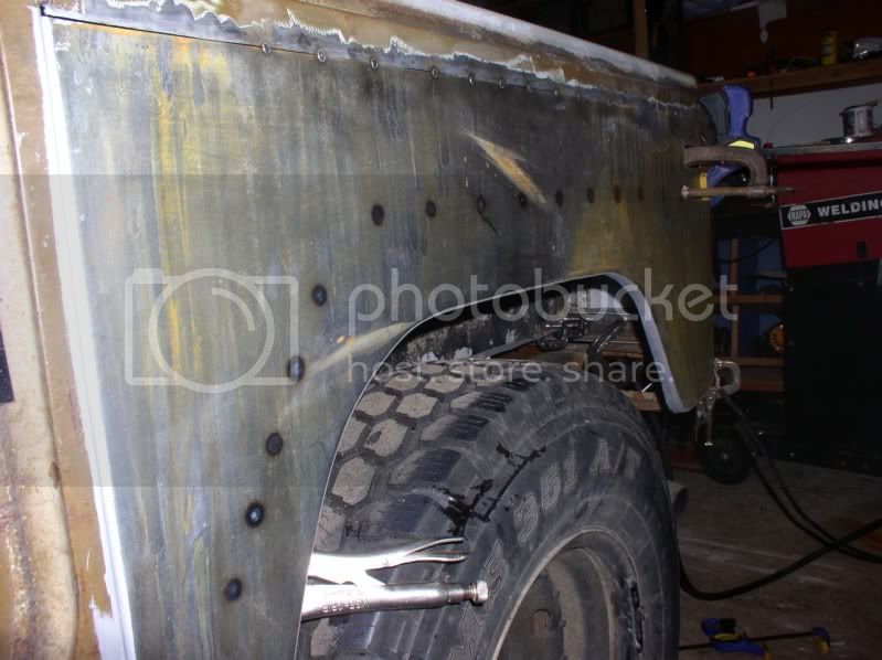

In an effort to reduce grinding in highly visible areas I'm doing my rosette welds from the inside. I'm wondering if the heat will deform the panel just enough to create a visible impression reminiscent of the factory spot welds. I hope so.

Well, it's been a productive week but I'm currently about 12 years from having this beast back on the road. The fill welds are done and I was making a punch list for finishing up the odds and ends on the 1/2 tub (which has all been assembled this week) and something didn't look right. It wasn't right. Somehow the rear opening was WAY out-of-square. I spent a couple hours feeling sorry for myself and cutting and drilling welds, and I think I've got it square enough for my standards now.

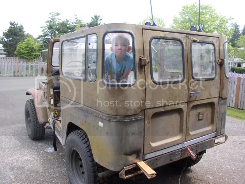

Next I put the sides of the top on and did some door fitment to make sure the reveals around the doors were satisfactory. You can see my 3-year-old anti-productivity pod peering through the window.
The outer sill still needs to be installed, there is a ton of grinding to do, holes drilled for the lower hinges, captured nuts need to be replaced, seams sealed and about a million other things, but I'm really happy to see that the doors line up better than they ever have.

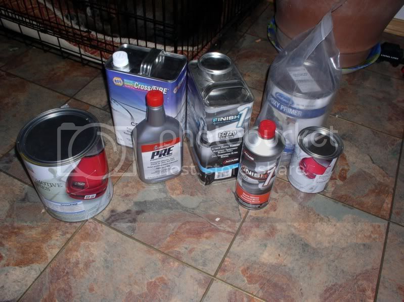

Most of my coatings are here. I'm going with a bc/cc system. It will be the first time I've worked with anything other than acrylic enamel. Napa doesn't have anything other than high gloss cc, so I'm going to have to be a little more careful with my body work than I planned to be. I also have a Raptor Liner kit and about 12 other paint cans not pictured.

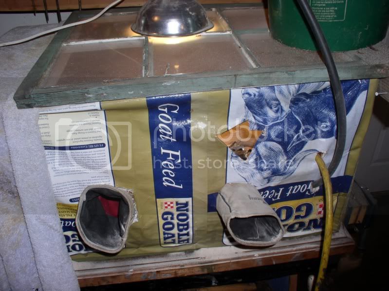

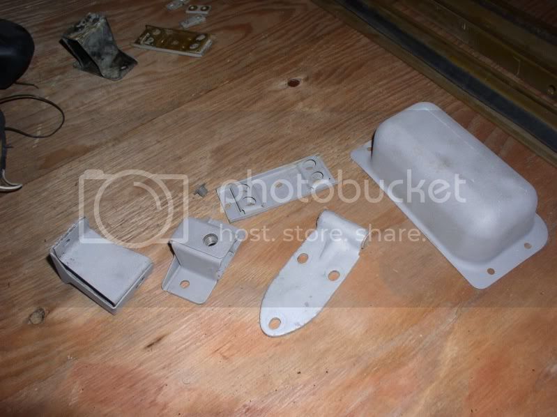

Yesterday I didn't have the energy for anything big so I spent about 45 minutes converting a dog house into a very basic/ghetto media blasting box. It isn't really sealed so I just used a respirator. The goat feed bag adds a touch of class:
Seriously, I was having the time of my life doing this:

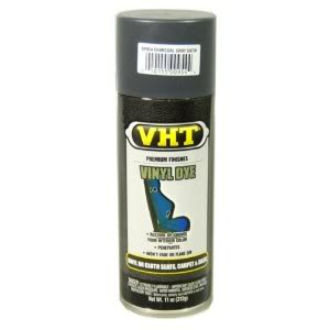

Does anyone know of a good color of vinyl dye for the graphite gray interior parts of a 40 such as the plastic part of the heater and the headrests?
I used 'Charcoal Gray' vinyl dye for the bench seat I'm installing:
But it's more of a navy blue than a gray and I will have to re-dye it. Any suggestions?
