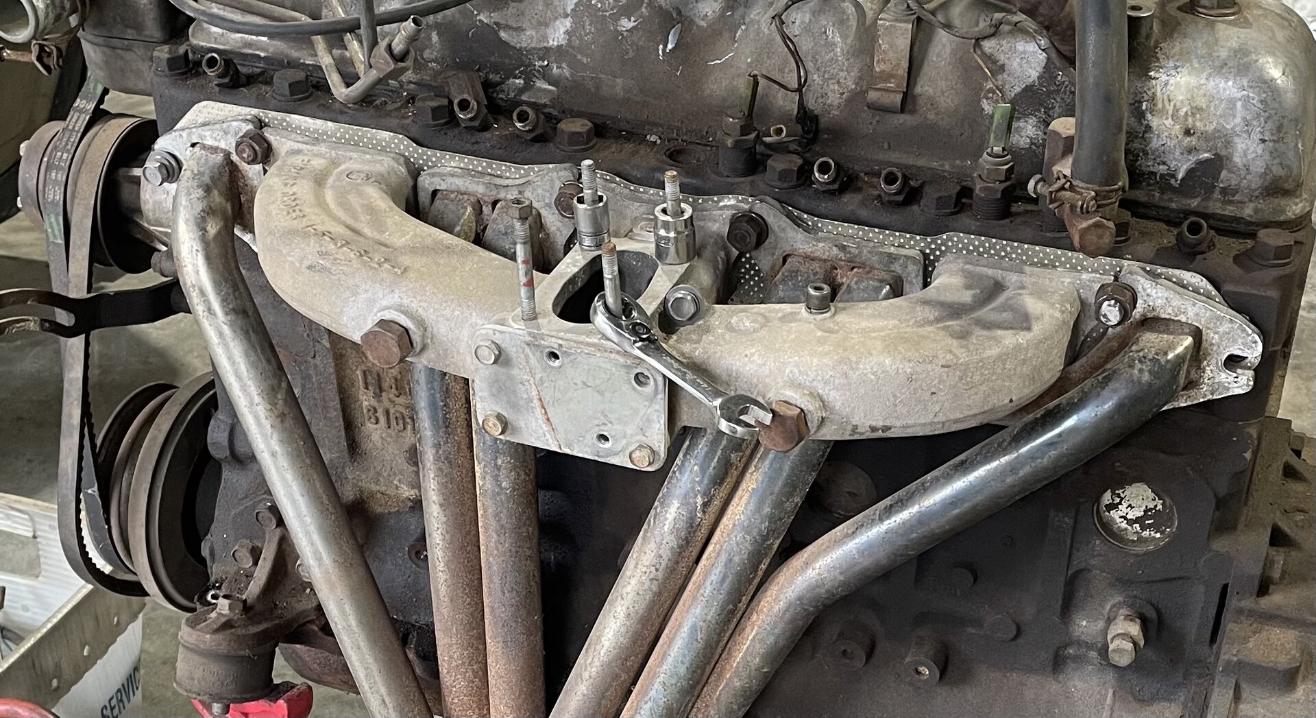

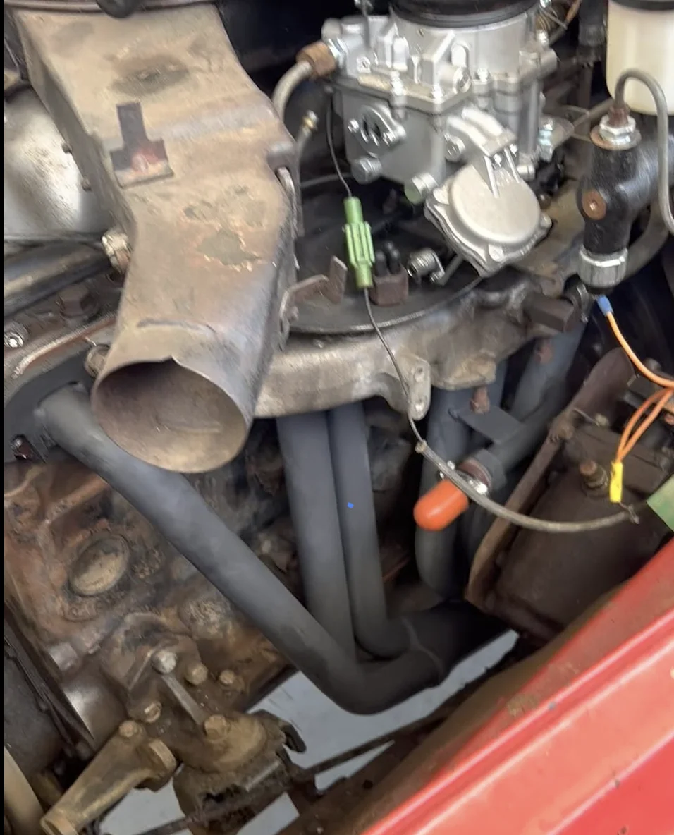

I’m certainly not sure about every header out there, here’s the last one I did, one week ago, There’s one of these intakes on my FJ45 with the 2 piece dual outlet header I think MAF sold
Those duel headers ha! I had a set of those I bought before the Downey headers those where much thinner and really hard to get anyone to machine flat....what a PIA to get them installed right! 🤬😡
Still have those in a box in the back shead actually. I replaced those with the Downey one piece header so much easier to install and keep sealed. 👍 When I swapped it onto the 2F just a little file work on the stud holes got it done. No grinding required.

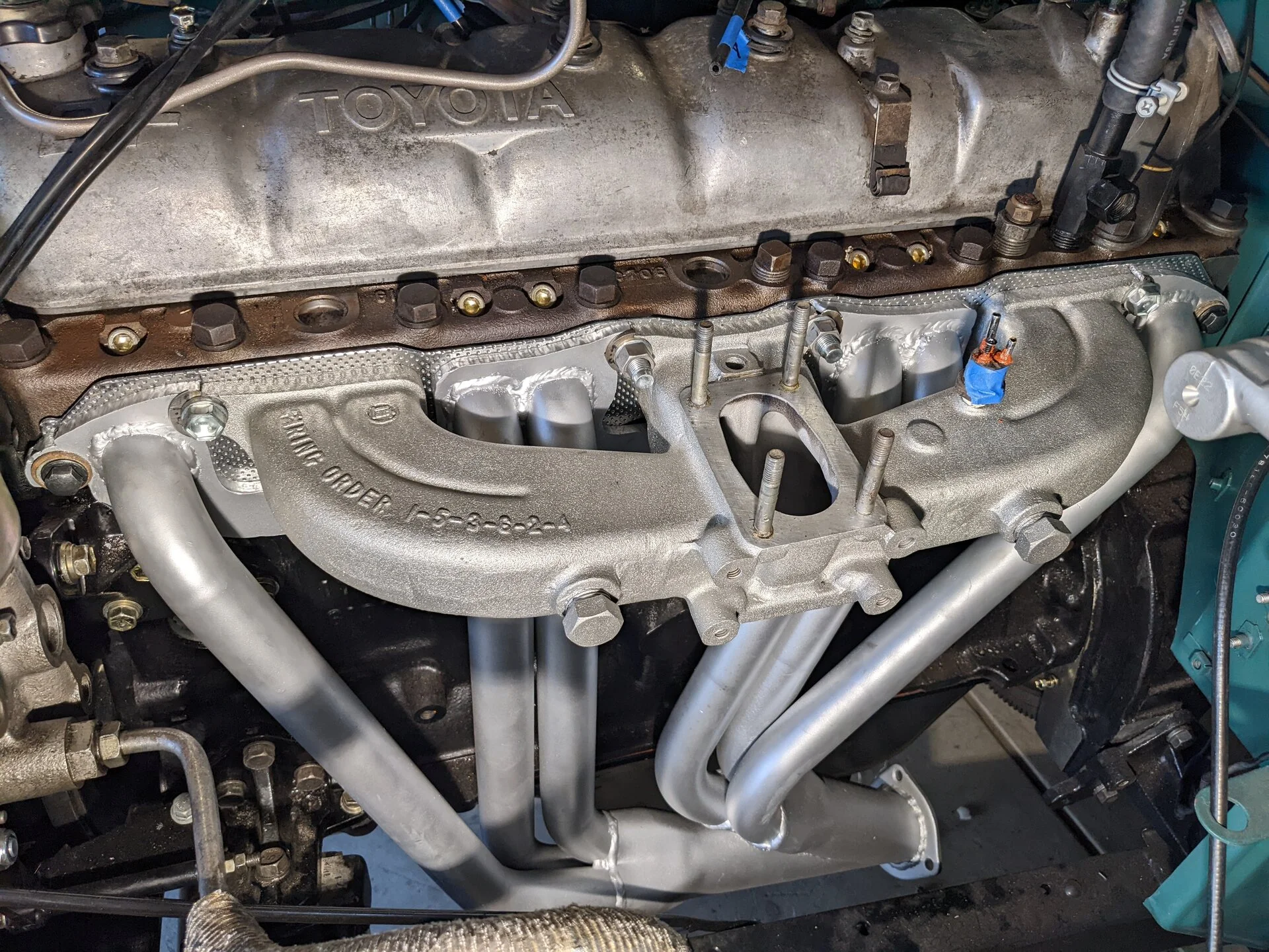

No dimpling or filing here,
I just went and slid a piece of cardboard between the tubes mentioned,
no issues

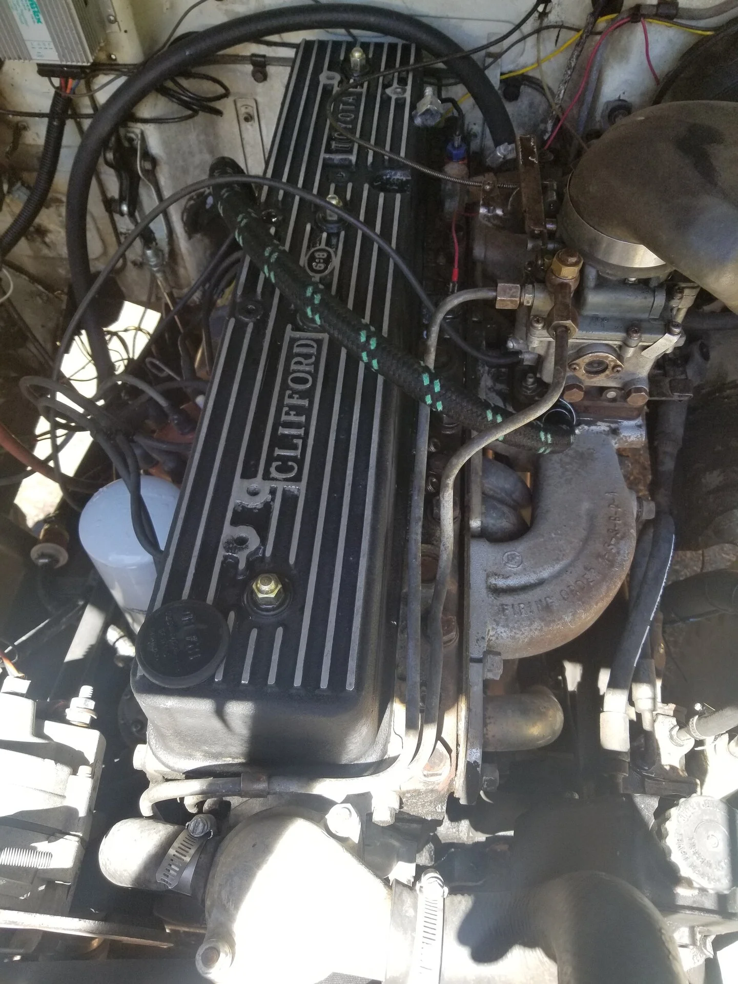

I’m not sure what one piece header I have on my 77 (yeah it’s been that long ago). No issues with the install from a fitment standpoint. I did measure manifold depths at each shared bolt/ stud location and shaved half of a heavy flat machine washer to match the measured delta. Numbered and painted the opposing side of the washer so I could see the proper orientation of the cut. I did this to ensure torque was applied equally to each ear of the manifold and header. OEM gasket, dry and torqued per spec. It’s been flawless for a hell of a long time.
A bit of dimpling on the front tube runner, but then eventually the header cracked two times at the collector tube. I eventually found that supporting the bottom of the header near the frame eliminated swinging. I eventually went to @Mudrak where he re-welded the exhaust manifold and made it work. Use a Thick Felpto gasket and no more than 15-20ft lbs torque. No mo' exhaust leaks
