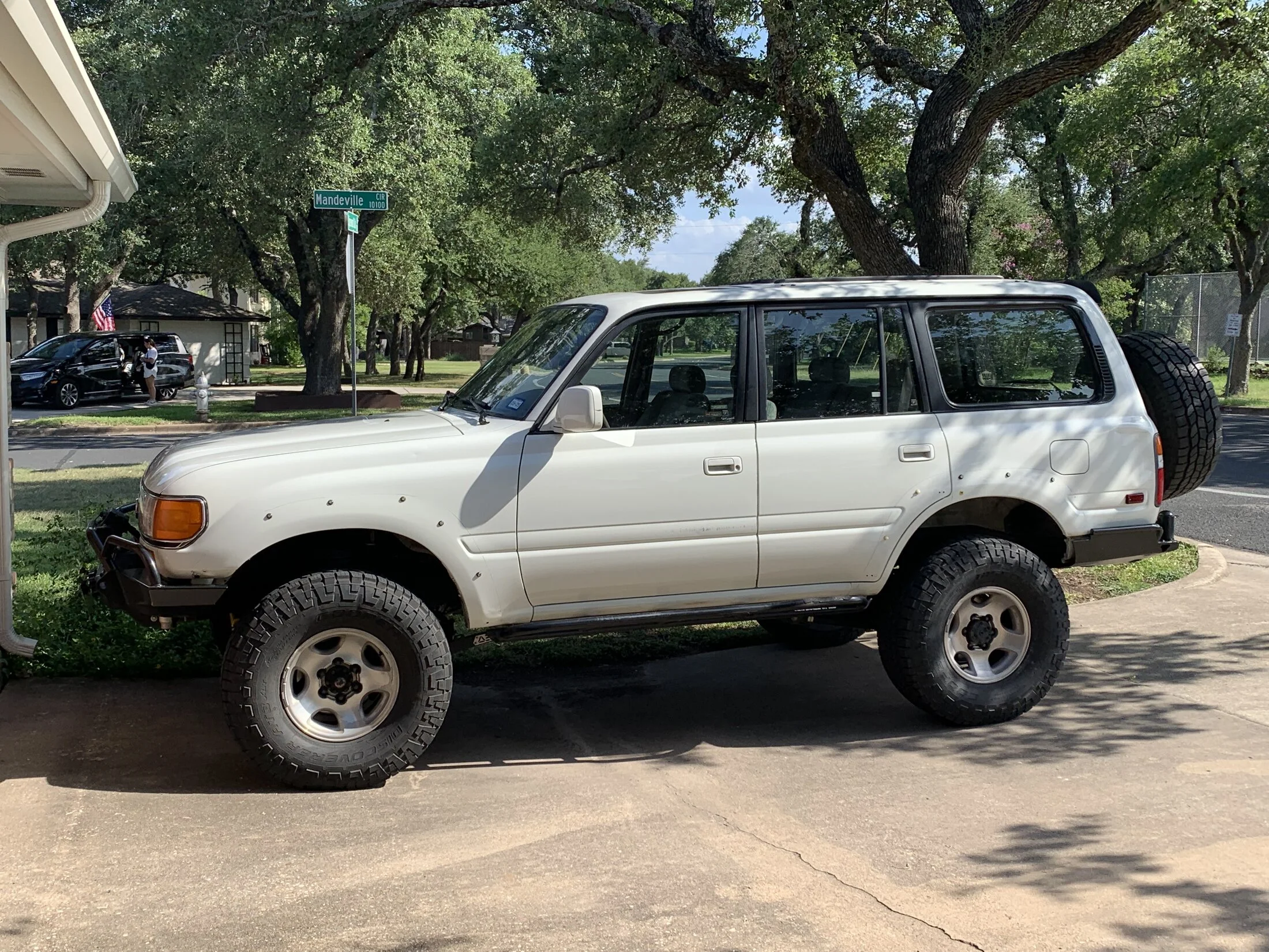

Here's a pic of mine. I'm running 315 Firestones. I can get some measurements later. I don't have a winch on it yet or any cargo at all in this pic. Its as light as it can be without removing the interior or emptying the gas tank.
You’re a hero, thanks!
