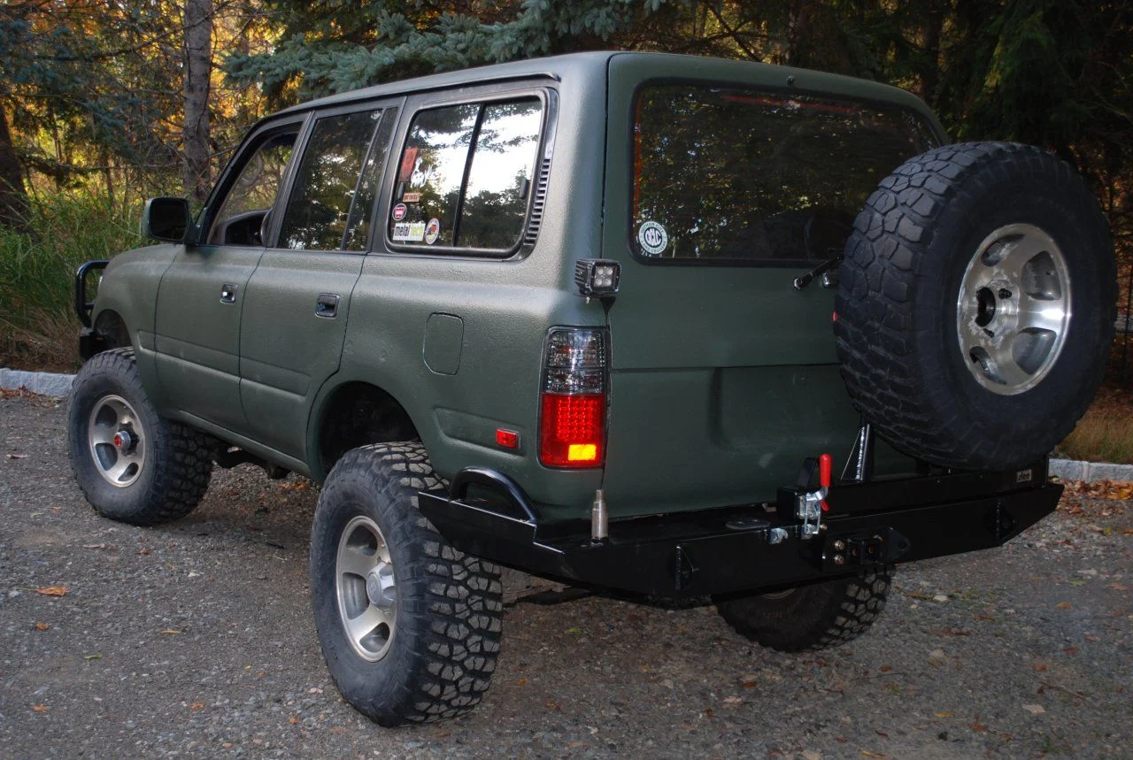

Can you say Toyota Army Green Monstaliner? You can now!
I worked with Eric @magnetman to develop this shade of Monstaliner. I sent a painted steel sample to Eric and he was able to match perfectly to the Army/Dark green of the Toyota FJ Cruiser. I didn't do a perfect job applying it, but that was mostly user error. I applied during the night in a dimly lit garage, while it was raining outside...the humidity gave me about 30 mins of pot-life, so I had to work quick. Overall, I am very happy with the end result.
Other improvements I have made while I had her torn apart.
  • I tore off my junk Pro-line rear bumper and installed a Slee dual-swingout and hitch. This thing is stout...20 bolts holding it to the chassis. I still need to install the ladder.
  • I replaced all four window runs
  • Replaced both the inner and outer window trim for all windows including the outer rear quarter
  • Made up new vapor barriers for all four doors using 6mm concrete underlay plastic and butyl tape
  • Installed 3/4" rubber door looms from electric-life so I have a clean way of routing the ditch lights and CB coax (coming later).
  • Installed @SoCalFrank ditch light brackets and rear hatch brackets along with two pairs of knockoff dualies that I have had sitting around for about a year. I still need to wire up the relays and switches.
  • Since I had the headlights out and the snorkel off, I decided to give the inside of the fenders a liberal coating of primer so prevent the backside of my welds from rusting out.
  • I had two cans of Army Green spray paint mixed up which I used to paint my mirrors and I then applied two coats of clear. They came out decent, but I may redo them.
