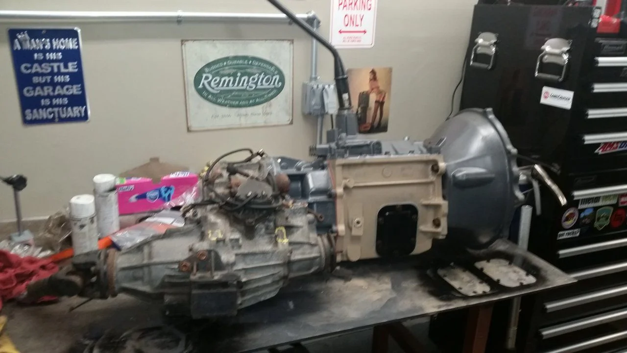

Last night I buttoned up the trans (PTO covers, bellhousing and trans fluid) I used 5 quarts rather than the standard 4 as it has been said there are benefits to adding an extra quart, plus I have a small amount of additional volume now with the space in the adapter plate.
I have a spare HF2AV that I bolted up, it all went together rather easily, this was a major relief as I have the original prototype adapter from Diesel Adapter and haven't seen any details of swaps using this setup yet. I can now confirm that the cut down 2wd mainshaft and adapter plate work as designed.

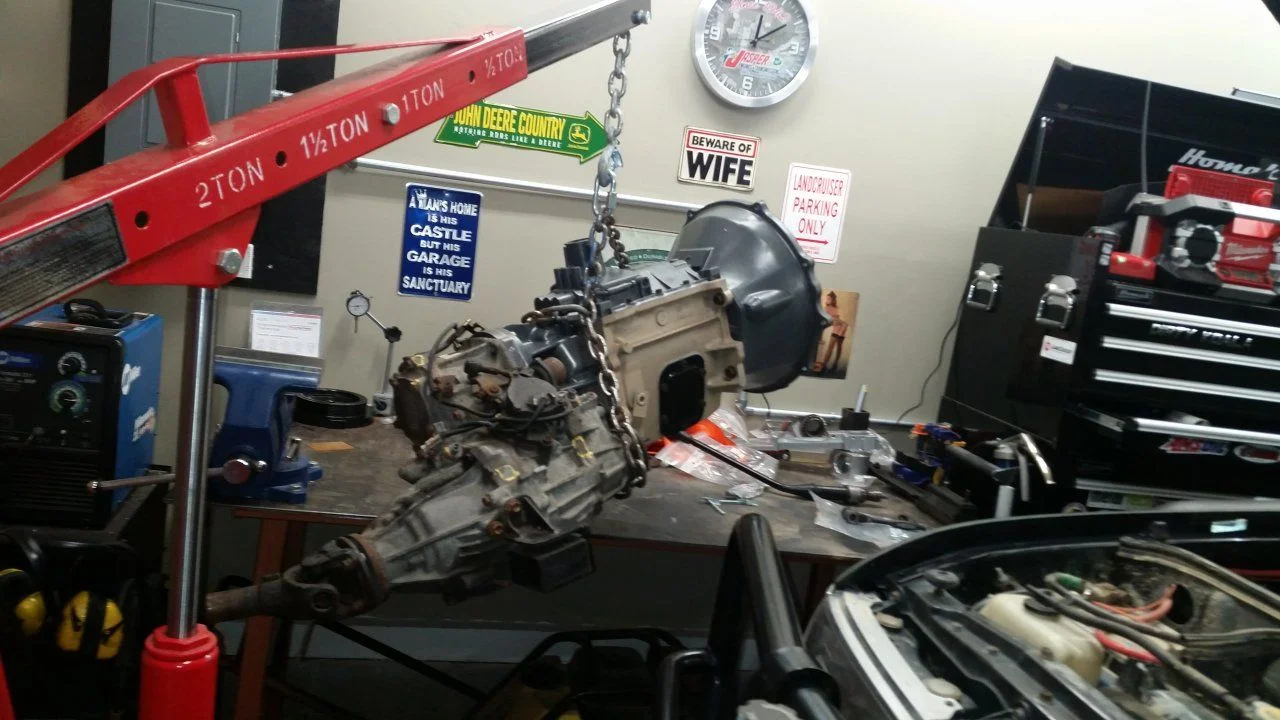

I hoisted the trans and xfer case off the bench, because I ain't playing herules today. Stabbing the trans was pretty straight forward, but I wouldn't want to be doing it under the truck on my back. This will all go in as one unit.

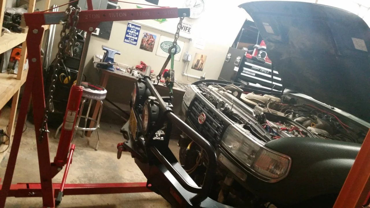

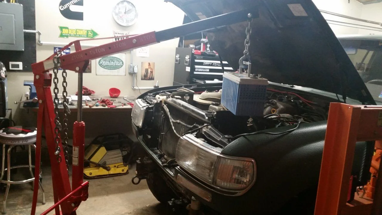

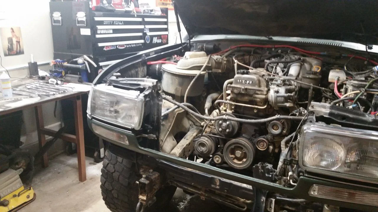

Tonight the conversion officially got underway...finally. I pulled the condensor, batteries, battery trays and radiator.
I try to work smarter not harder...screw lifting that group 31 battery by hand.
