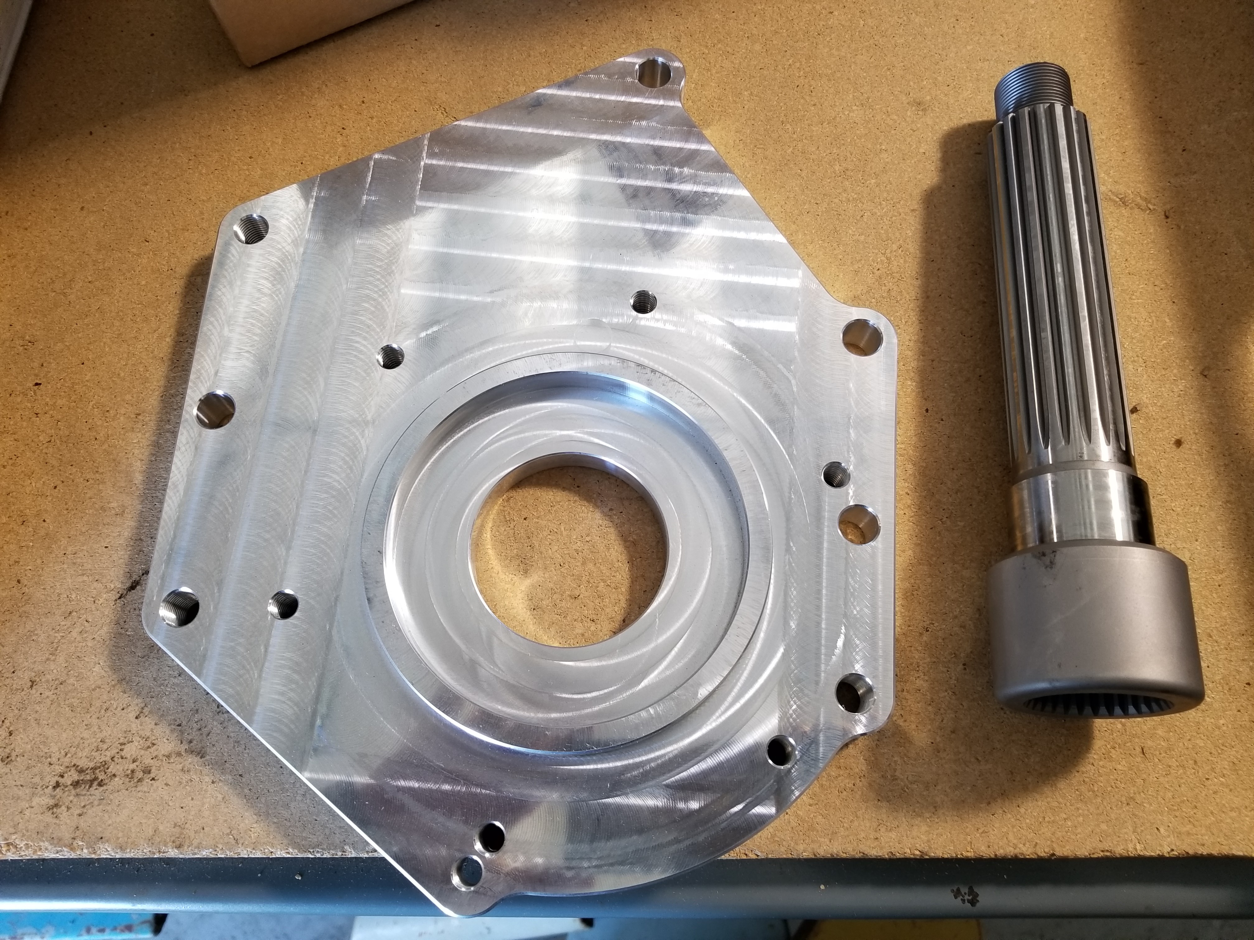

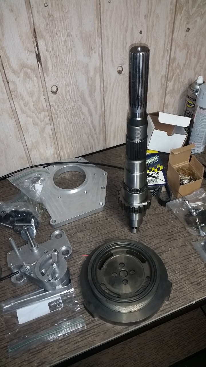

Yes, this adapter was designed after I pestered Dustin for a while to make it. He has since made and sold a bunch. I beleive @Wheelingnoob & @thegogglesdonothing both have this adapter. I particularly like that there is no intermediary shaft between trans and xfer case.
Could you elaborate on this point a little bit? What is the advantage of having no intermediary shaft between the trans and transfer case? A different vendor uses a spud shaft for their kit. Is that bad?
Is there any disadvantage to using no intermediary shaft between the transmission and transfer case? Do you have to move the trans or t-case forward or aft?
The reason some adapters use an intermediate shaft is to adapt the output of a transmission to the input of the xfer case. That is one extra part to potentially fail. OEM transmission/xfer case combos are designed to mate together without an intermediate shaft...the way we did it was to follow the OEM logic...make the NV4500 mate to the HF2AV as cleanly as possible.
Intermediary shafts are bad if you push the limits of your truck. More connections = more failure points. Aka spud shafts. I'm not a fan of them either.
The reason some adapters use and intermediate shaft is to adapted the output of transmission to the input of the xfer case. That is one extra part to potentially fail. OEM transmission/xfer case combos are designed to make together without an intermediate shaft...the way we did it was to follow the OEM logic...make the NV4500 mate to the HF2AV as cleanly as possible.
But don’t you also have to machine down the splines on the output shaft of the transmission if you don’t use the intermediary shaft? Isn’t that also making it slightly weaker?
