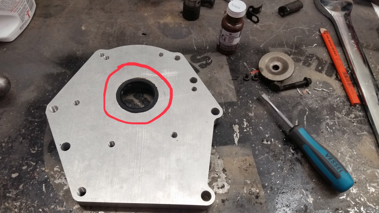

Dumb question about the NV4500, adapter plate, and machined 2WD mainshaft. I know there was some drama on previous design versions of the adapter plate where all of the fluid would drain out of the NV4500 transmission and into the transfer case. How does this adapter plate work? You use the Dodge seal at the 4WD extension housing, and a Toyota seal at the adapter plate? And the Toyota seal on the adapter plate seals to the 2WD main shaft?
I guess I'm having trouble visualizing what-seals-what from the NV4500 4WD extension housing, adapter plate, and transfer case, and I was hoping you could shed some light on it. Thanks!
Edit: I guess my questions is, where does the transfer case input seal mate to on the Toyota transfer case? The shoulder of the HF2AV input gear?
That seal you circled is the exact same part number as the xfer case input shaft seal in the transfer case. So you have 2 of the same seal, 1 in the transfer case to keep fluid in the xfer case and then one in the adapter plate in the opposite orientation to keep fluid in the transmission.
Awesome, thank you. And the adapter plate seal rides on the input gear of the transfer case? Or on the output shaft of the NV4500?
Post 380 you can see pics of how it all looks bolted together. The seal in the adapter plate runs on the output shaft of the NV4500.

Does the seal ride on the splines of the NV4500 output shaft? Or is the NV4500 output shaft machined smooth at the seal?
I guess what I'm asking is, how do you keep trans fluid from leaking past the splines on the output shaft?
its on the smooth part
