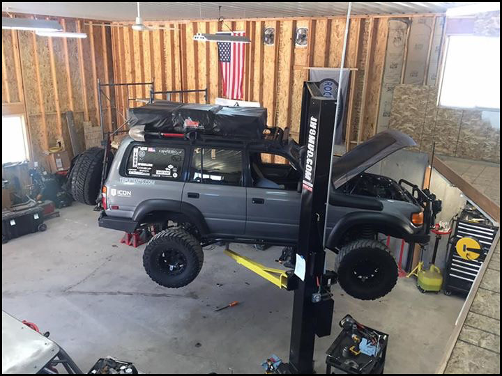

Had a light 9 hour power session in the shop last night with one of my mates.
We got the Slinky Stage 4 suspension installed along with Blackhawk HD rear sway bar and upper/lower control arms from @AutoCraft Aus. Also replaced the front sway bar bushings with new OEM. Even though we were in an 8 lift shop...we did the suspension on the floor...didn't feel comfortable picking the truck up behind the radius arm mounts with the cummins up front.
Also got a bunch of electrical work done.
Installed the Quarter panel mount from @NLXTACY. I had to remove my drawer side wing to get enough room to work...folks at the shop where impressed with this product.
I ran +/- 1/0 AWG cables from the mount up the passenger side and out the firewall grommet to start battery #2. This cable is protected by a 200amp blue seas mega fuse.
I also re-did the positive and negative cables that link start battery 1 & 2 in paralell with 1/0 AWG...no pics of the cable work yet.
