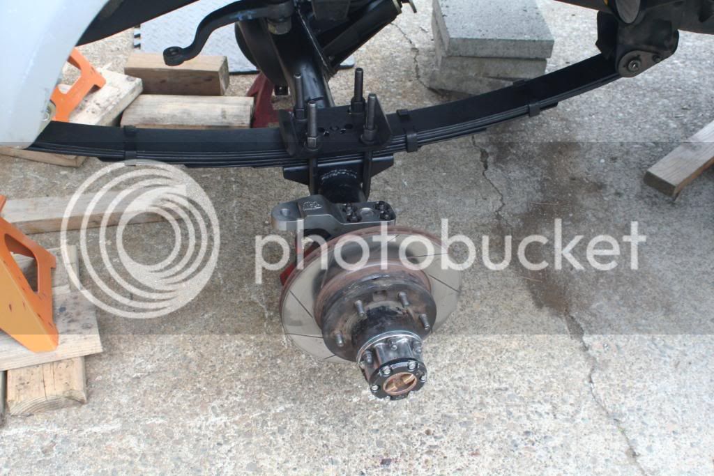

Lets build a front axle. Friends stopped by. First Marlin:
Then Bobby:

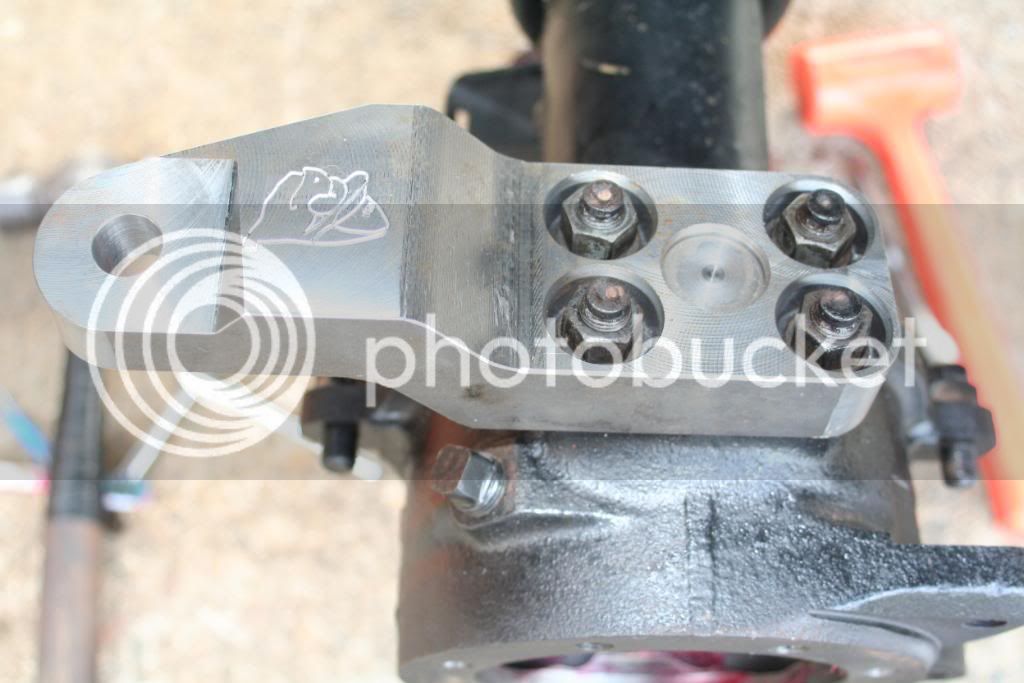

Drivers side buttoned up. No backing plate mod:

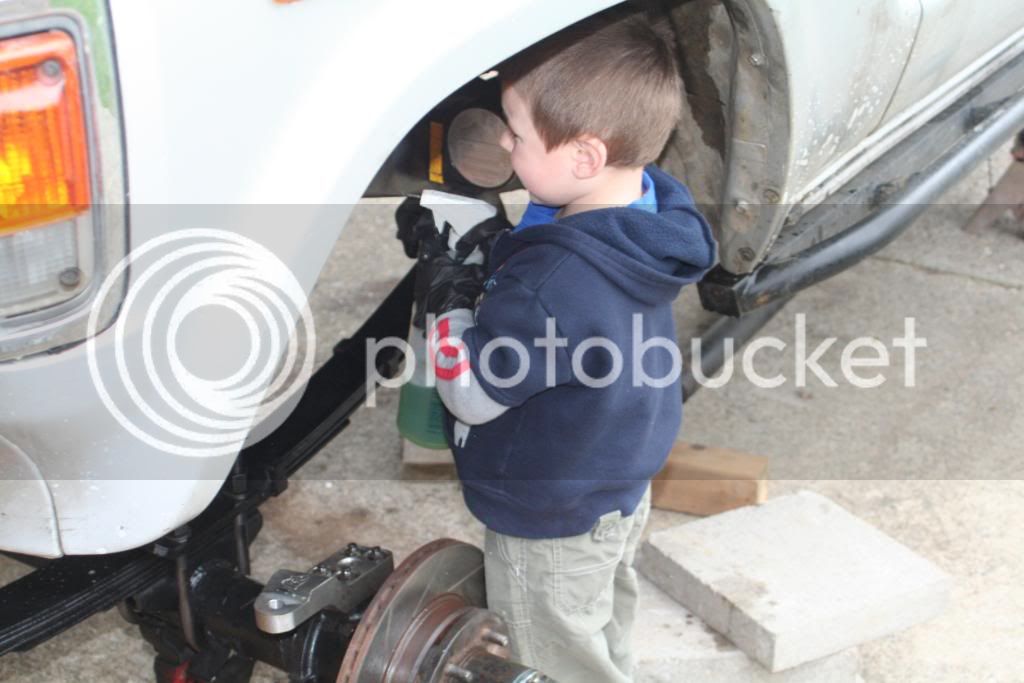

More help from mini me:

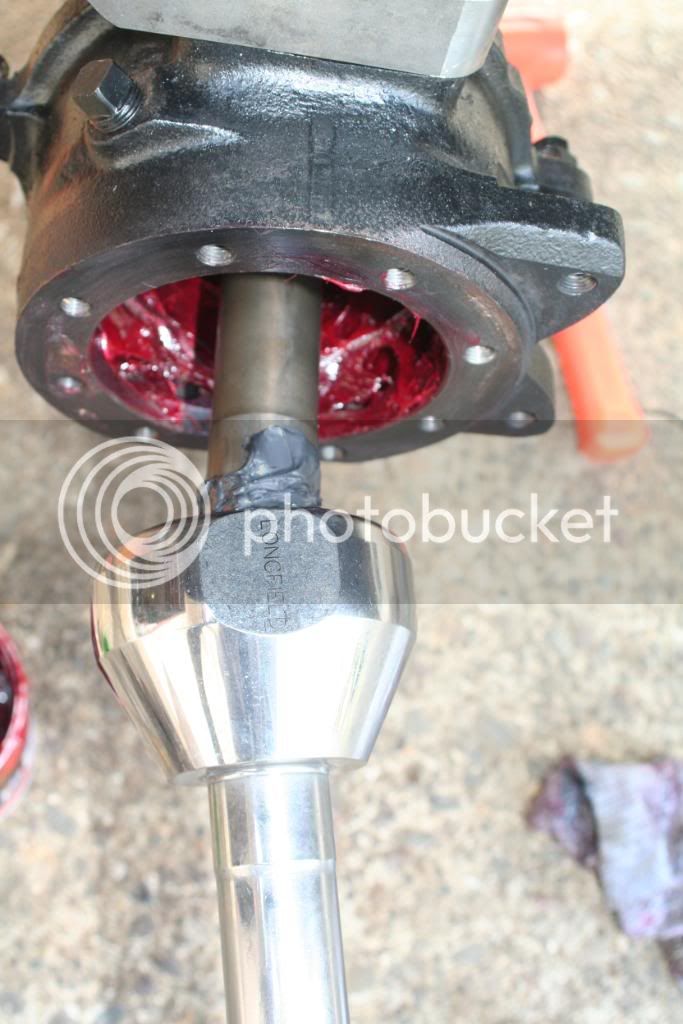

Busted 2 pitman arm pullers so this is as far as I got with steering:

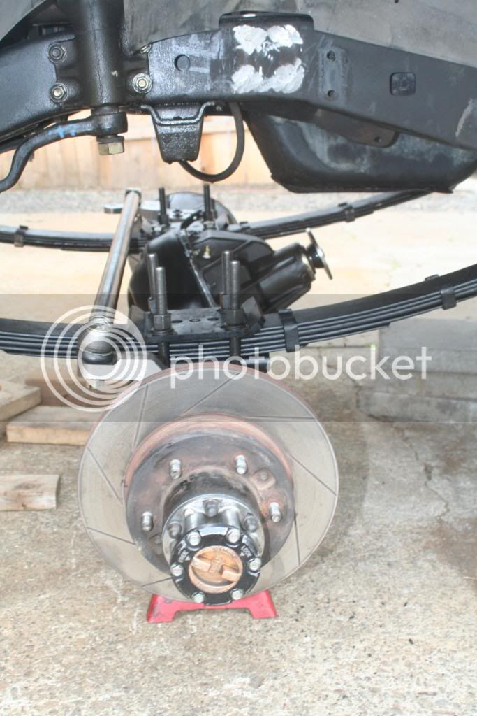

Rebuilding brake calipers. The more you get into these builds this is where time and money starts to add up:

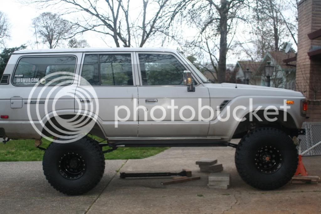

Check it out crackers. A bit tall but am hoping it settles with some more weight and time on the spring packs. If not then I will start pulling leafs to get it to come down:

For the pittman arm, you might wanna try putting some good tension on it, spray it down with some blaster and leave it sit over night. This is what I had to do after breaking a puller as well. Also, a picklefork works awesome too to assist the process. I ALWAYS carry a picklefork with me on the trail too. I just love those things.
It actually saved my ass on Deer Valley last year when my Pittman arm snapped...I used to to break the rod ends on my set up, and also had to BORROW Calicruisers pittman arm to get out, so it really made an impact on an already bad day.
Things will settle in on that. It may also seem sky high since youre not used to it too. Once you test the limits on it, youll wonder how you ever wheeled without it SOA.

...Things will settle in on that. It may also seem sky high since youre not used to it too...
X2. It will come down from just driving around the block since the suspension hasn't really cycled yet. Once you work it a little on the trail it'll settle. Hope it makes it to the clean up on the 18th!
man that this is sick, for the pitman you might try a gentle tap (understatement) on the pitman with the puller on it. I'm sure some might say this could damage the gear set in the box itself but cutting could impart too much heat, plus you can take a little frustration out on it for breaking the other two pullers. anyways happy cruisn hope mine turns out as well as yours. Do you think its possible to post a cost summary to give us who plan on something similar, a rough idea of what we are looking at. I know not everyone will want to do the exact same thing, it would just be nice to see.:beer:
to hammers and the puller ( old locally technique ) hit the pitman with both hammer at the same time ( require practice ) and the puller making pressure ..

I have a fork but I don't think it is big enough to fit around the pitman shaft. I will take a look. Good idea on the PB blaster I need to find my can and coat it for the next few days.
How much did your springs settle? Any chance of a current side shot of your rig?
I hope so too. If not then we need to make a day to go out and flex it out a bit.
Thanks for the compliment. I did try the hammer but I shy'd away from the BFH for fear of damage. I think that PB blaster, heat, puller and BFH may do the trick.

lookin good Clint... those springs will settle considerably. Give it a little time. I broke 2 pitman pullers too when getting mine off. I finally used a torch to heat mine up enough to persuade it with my hammer. I believe cursing helps too.
I am hoping for a solid 2" on the spring packs so we will see. Thanks for the pitman arm tip. I will give it a try saturday.
