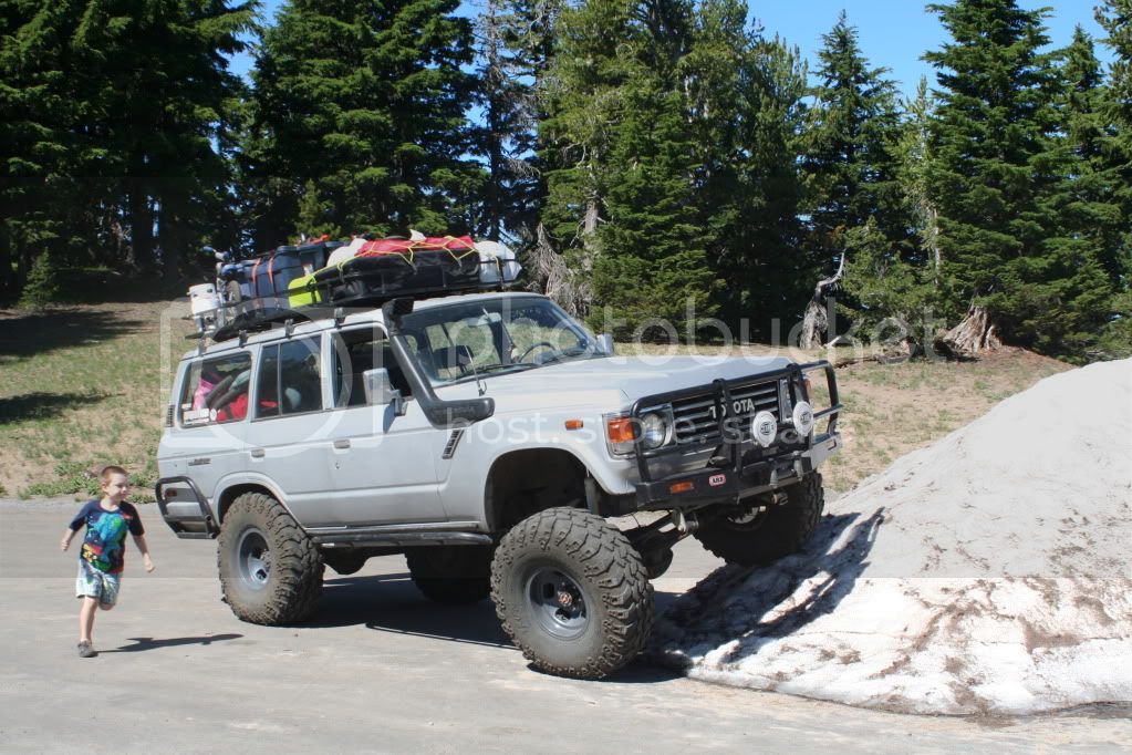

Here she is loaded in all her glory on our trip to Crater Lake. Not sure how much it weighed but it was a lot!
Anyways as you see it my 0-60 at 5000Ft elevation, first gear start, slight uphill and 75 degrees outside was 17 seconds give or take a second. Not sure how that stacks up to others but I am happy with it! :steer:
I did just under 800 miles of driving with 80% loaded as you see and the other 20 % unloaded. Both highway, mountain and rural road driving and my mileage for the trip was 19.35 mpg! :bounce:
