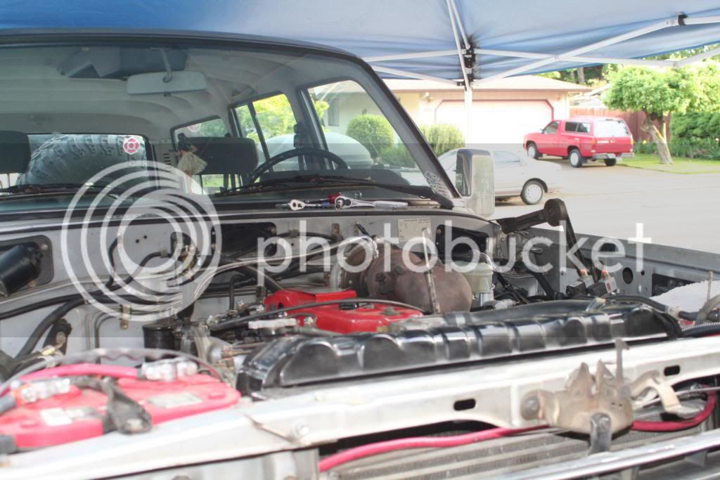

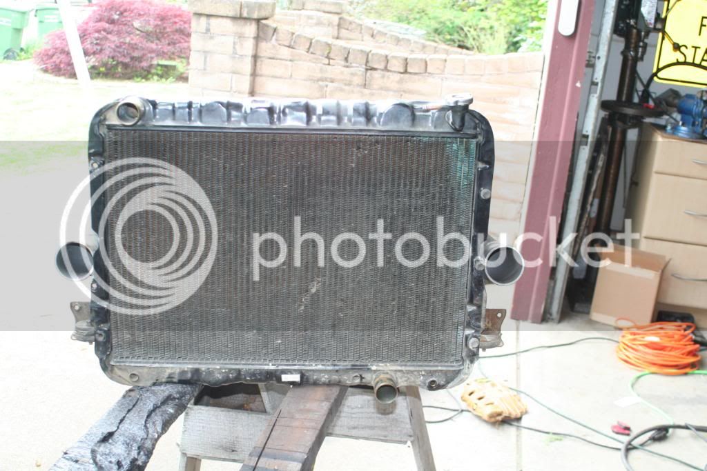

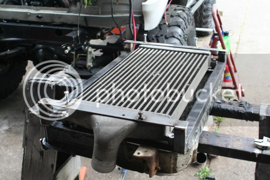

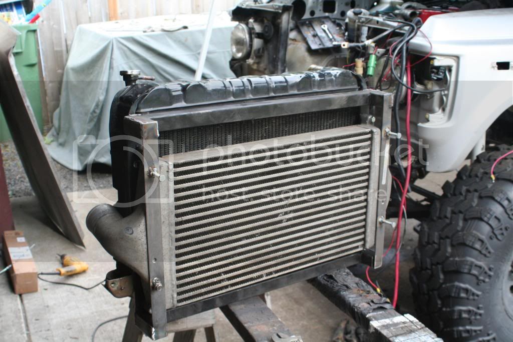

First item of buisiness is the intercooler and radiator mounting. The intercooler is a massive unit off of a 8.1 liter Hino diesel. As you can see in the pics it's roughly the same size of the radiator! Good thing I put in a 4cyl diesel or I would run out of room real quick:
My intial design put the fans too close to the engine so I ended up having to sandwich the intercooler. Not ideal for removing easily but the intercooler, radiator and fans now are all one unit.

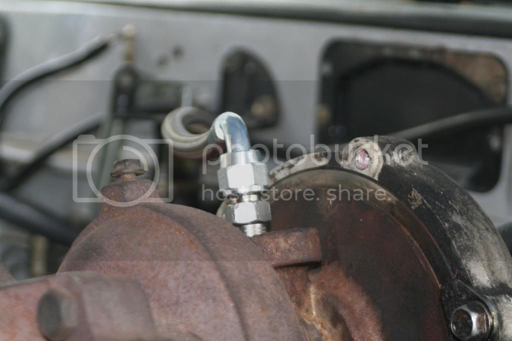

A delay in the build came when trying to source an oil feed line for the turbo. After many phone calls and a solid day wasted driving around trying to find fittings I found Oil Filter Service in Portland with the help of Mike. Though they didn't have the fittings on the shelf they did have it made overnight for about $60.

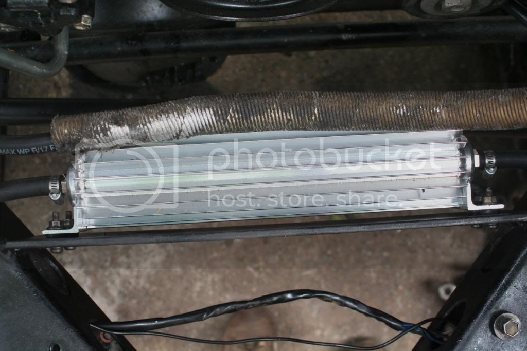

The Brown Santa came by and dropped off some parts. Power steering oil cooler and flex pipe for the exhaust.
Steering cooler plumbed and mounted:

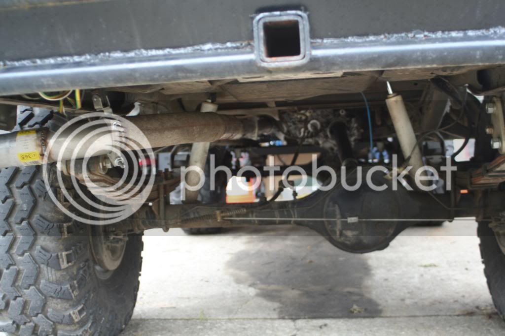

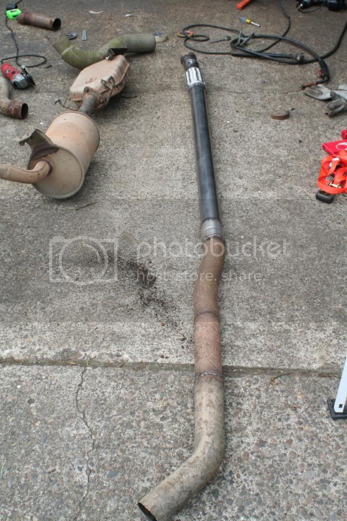

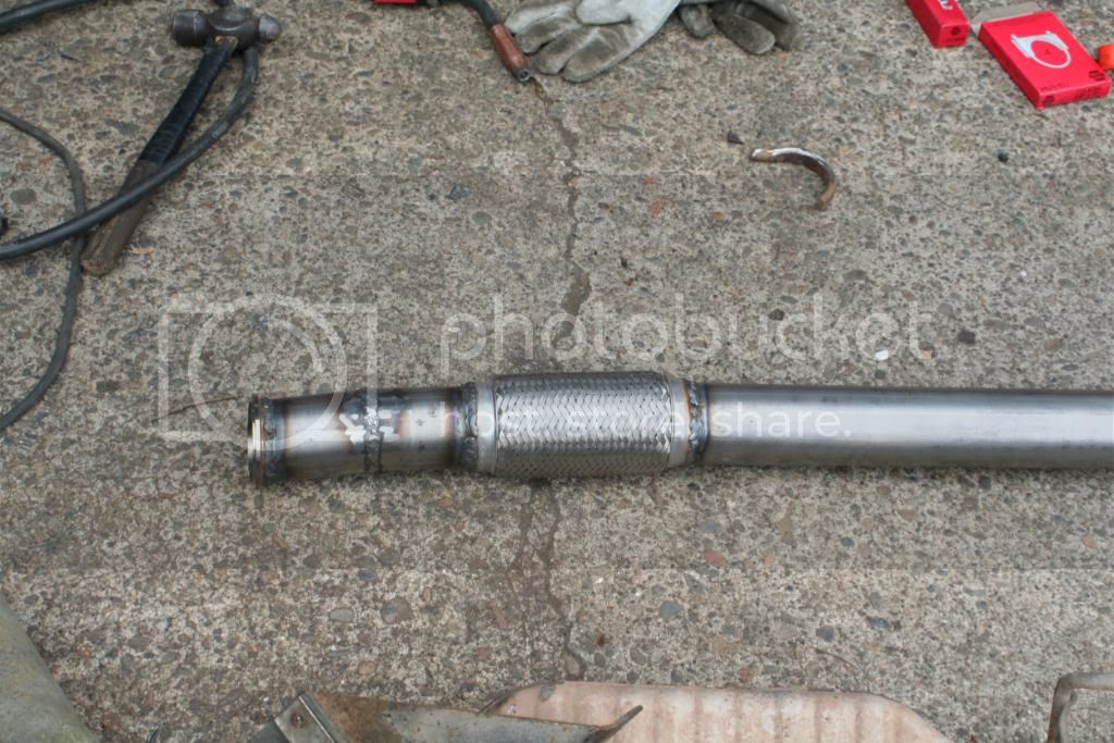

Flex pipe welded on 3" straight pipe exhaust:

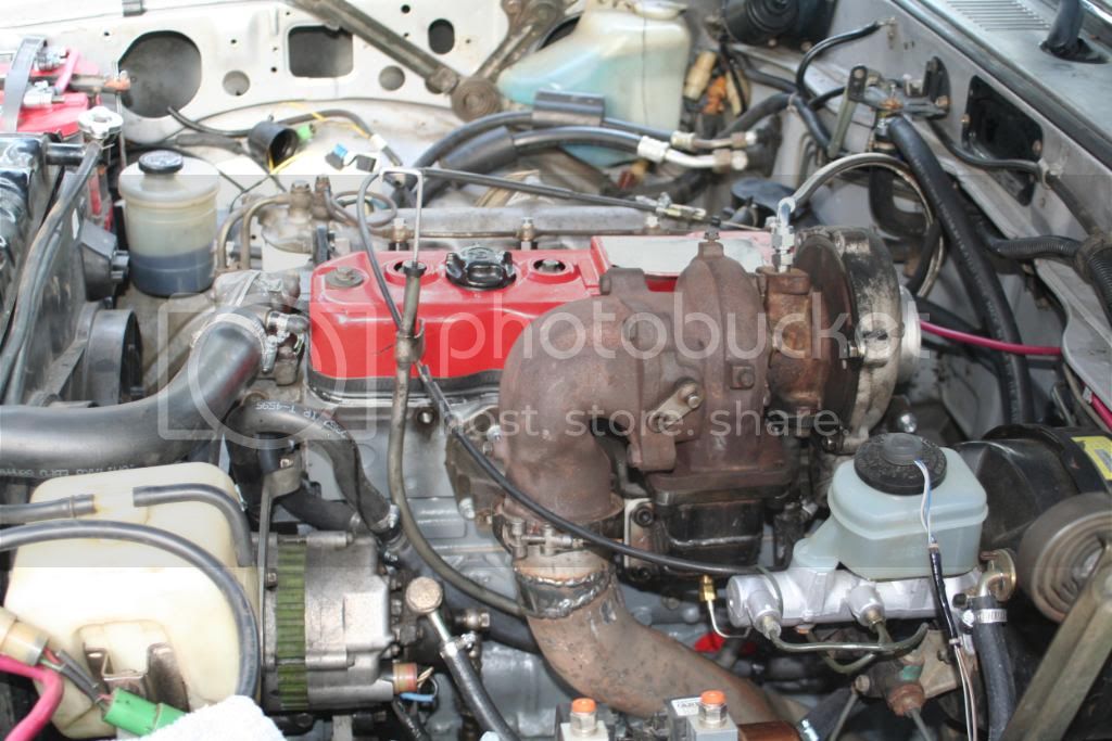

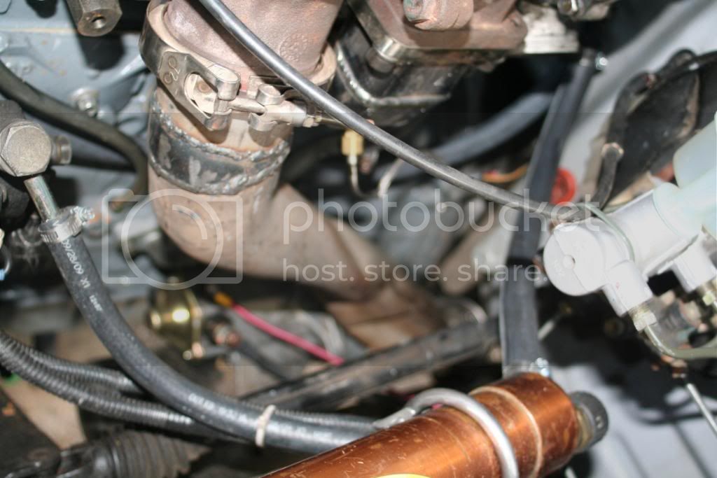

Part of the frustration with the build came in the form of the down tube for the turbo. Apparently Chevy runs thier "own system" and aftermarket parts are $100 plus. I was able to get the stock down tube and clamp from a wrecked truck for $20 but it took weeks to track down. It was almost an exact fit into the engine bay an only took about 30 mins to cut and weld in a wedge to get it to line up:
I bought a stick of 3" straight pipe from Napa for $35 but it was just a bit short. A quick trip across the street to my neighbors house yeilded a stock exhaust from a Dodge diesel for a 6 pack. It had all the bits I needed to finish the exhaust. 3" next to stock:

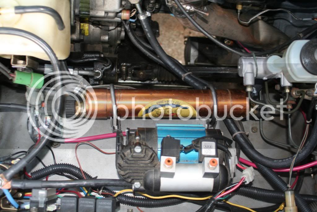

I made a few changes to how I had routed the cooling lines to better facilitate flow to the rear heat and to add in my heat exchanger for on board shower/ hot water:

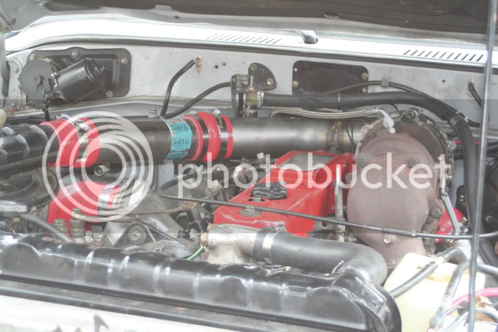

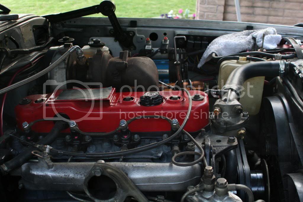

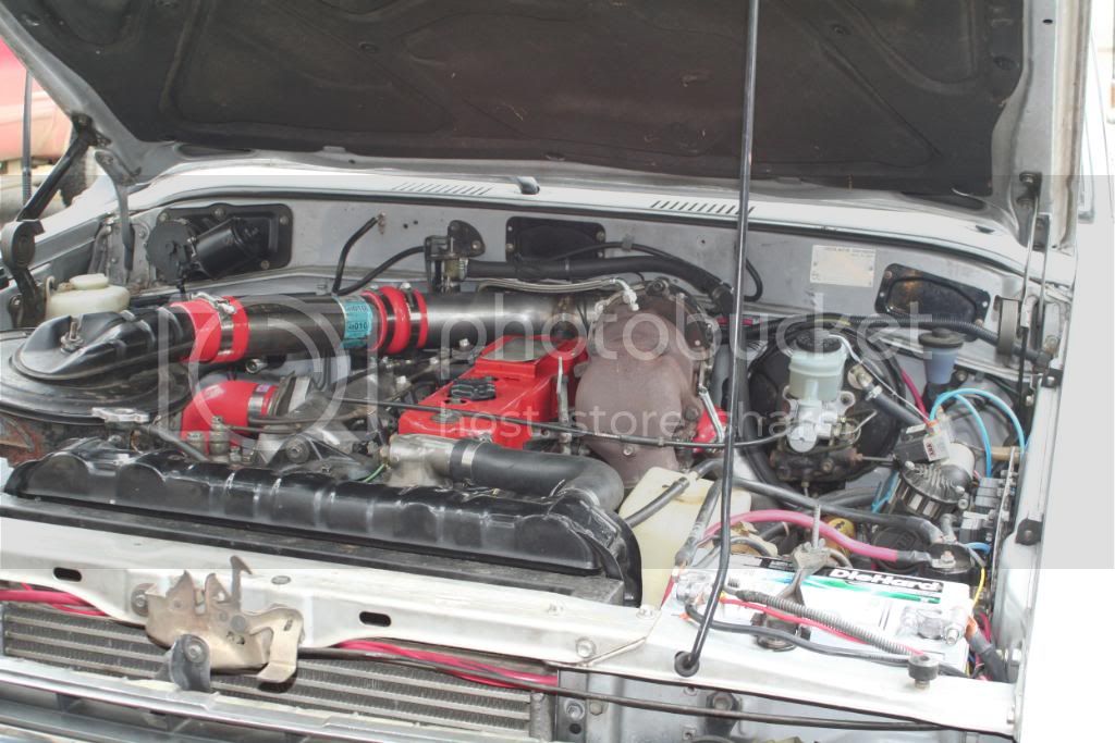

So blah blah blah here is a few pics:

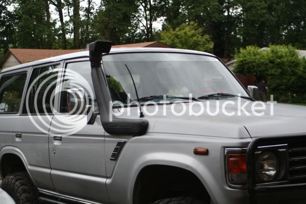

I am going to be replacing the cheap intake clamps with HD t bolts when my hardware store gets them back in stock. For now I used them on the hard to reach spots.

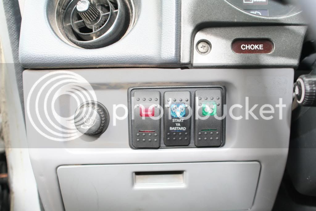

Dash switches again for now added fan control, glow relay, dual batteries/ inverter:
Fan switch controls 100% on, computer controled, and off functions. The last one is needed for those water crossings in case I need to use this:
