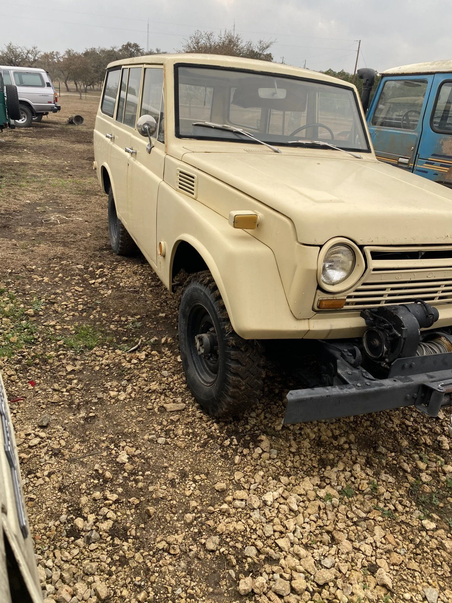

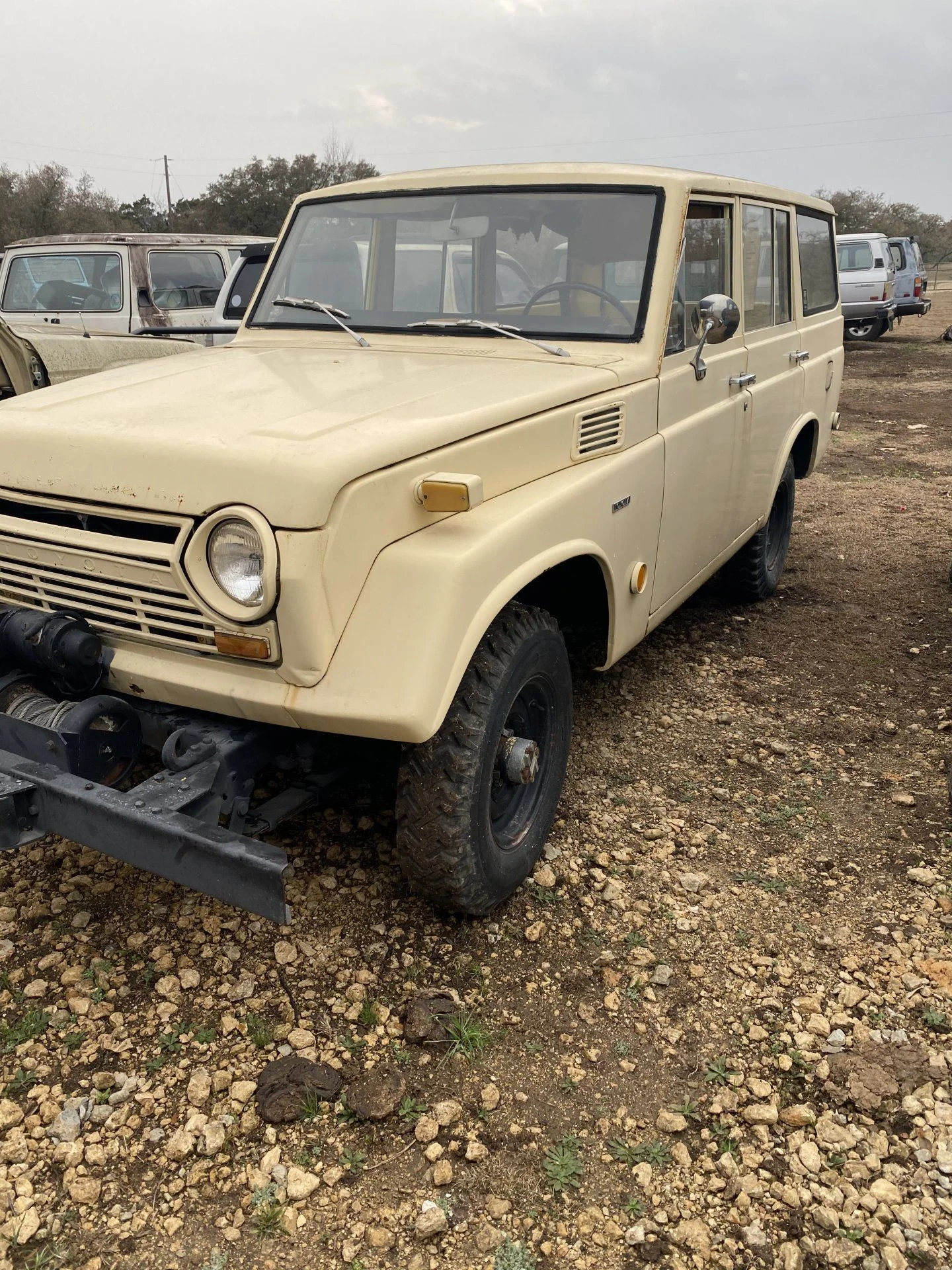

Deposit down on the new 68 Pig
Nice beginning. Like the pizza cutters
Hate to be naïve but "pizza cutters"?

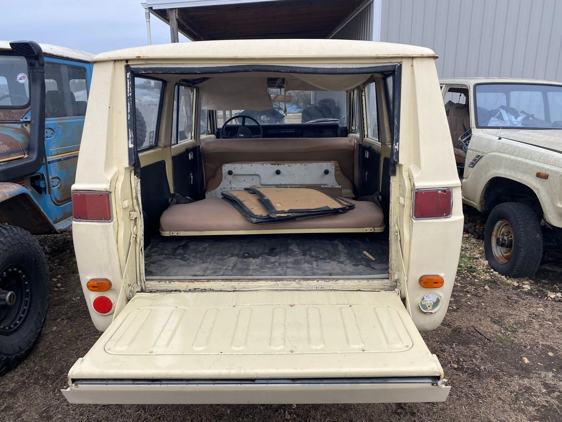

I am missing the strip of dash under the heater controls and just trying to figure way to replace this if anyone has access to the part ( I am sure these are just as rare as anything else on these beauts!)
More pics coming today when owner back from the lake. I am curious after reviewing a ton of pics if the hubs are "dualnatics" from the old days!

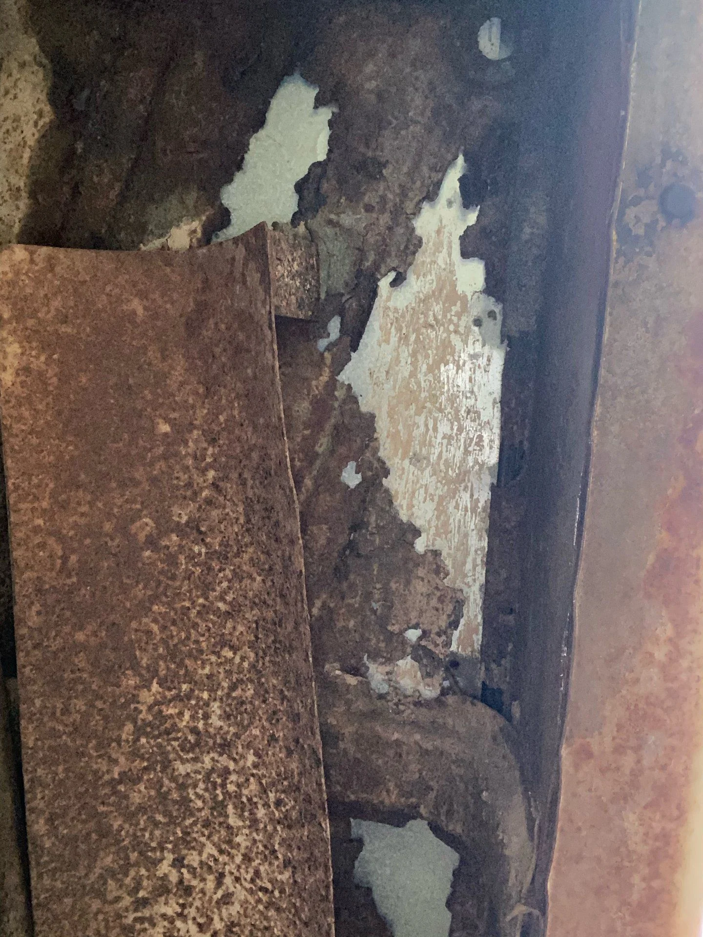

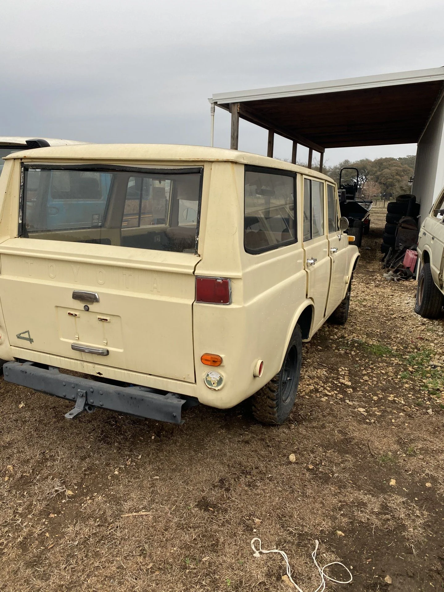

Fresh pics? as expected some nice rust and more to be found. I am not deterred though!
This was reported to be on hunting ranch in Tx (Belton) area. Seller said it appears to have been passed through several other ranches in area in the past.
It's in Wimberly now.

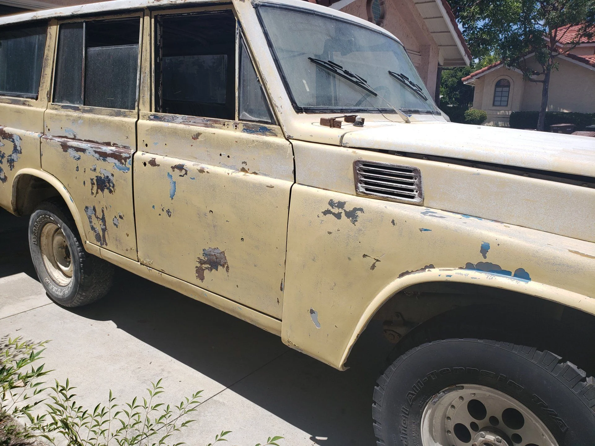

Forgot this one!
Early one! Looks good
Yeah, not the one I was thinking. That was a 69 that made a brief appearance
Similar taste in Custard, like the Pokey Little Puppy
