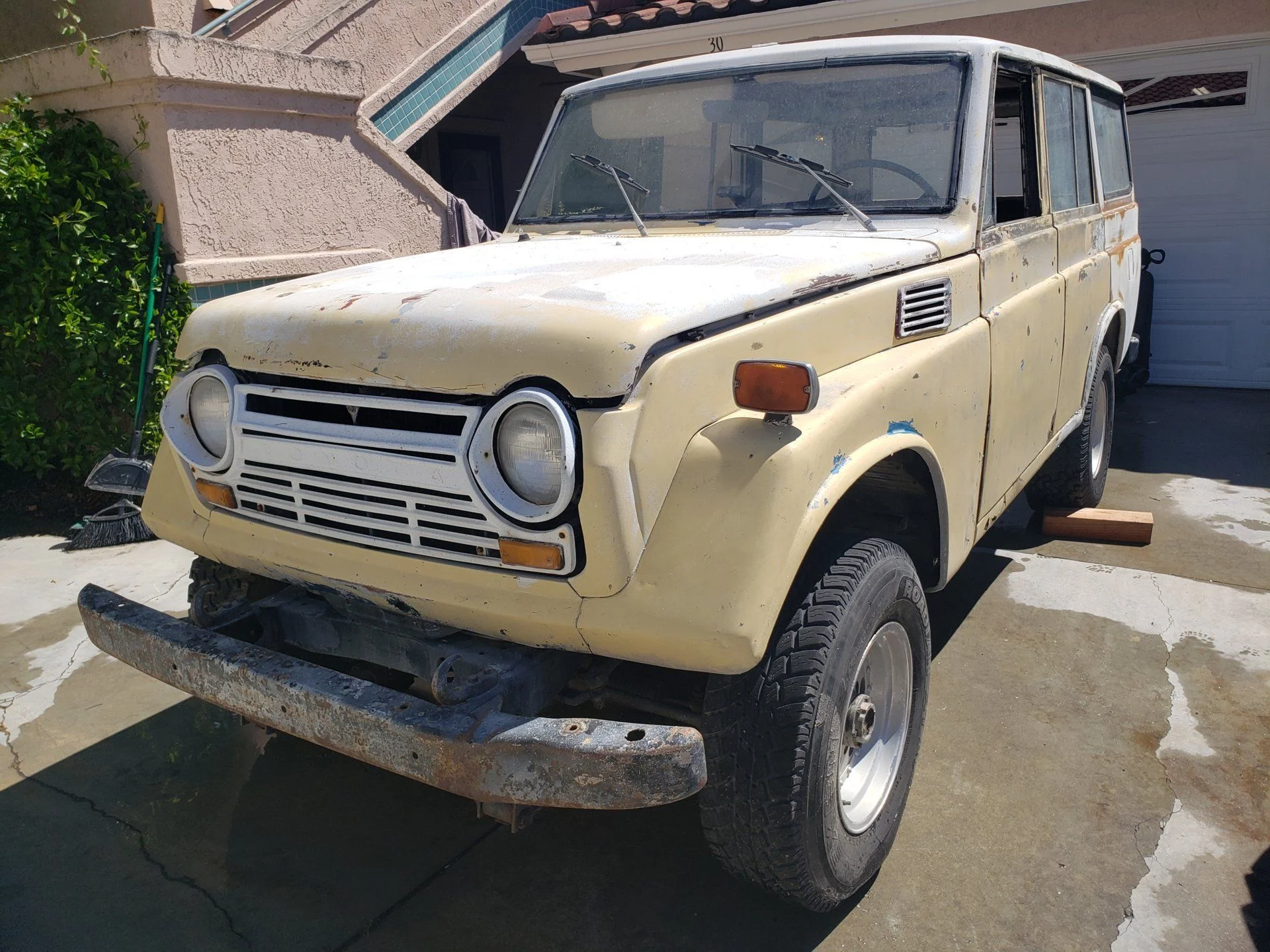

Ok. Here goes....
Don't really know a damn thing about these, so going to have a ton of questions.
Hoping the front seat will be here soon (Greyhound).
Got a new master cylinder and it's time to bleed the brakes. Anyone know what size the port plugs are, so I can bench bleed this thing?
Here's some pics... more to come.

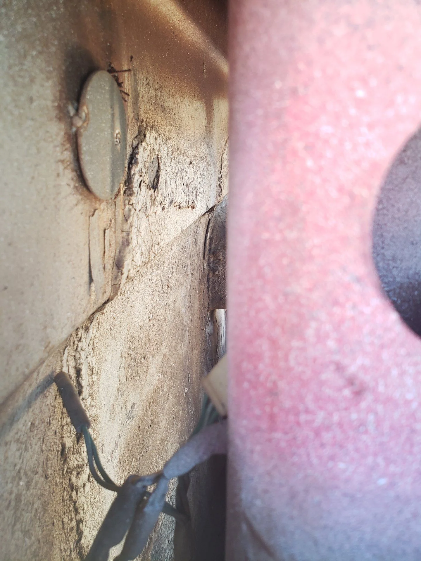

I'm talking about the holes that would be on the side of the rig with small rectangular lenses. Here is the passenger side of my 71:
See the small reflective lens almost to the very butt end of the cargo panel just a hair into the green paint ;)
Oh. I dont have those. I presume they are impossible to find.
Are you speaking about the brake line threads, they should be 9mm or if someone changed it out to a newer master then 10mm.
Yes, the brake lines. I need to plug the end of the matter cylinder so I can bench bleed.
You and me both! Would like to see it installed. Wonder where that seat has been the last week and a half?
The ones you see on mine are FJ40 ones that I swapped gaskets front to rear on. Should be readily available.
But it looks like you are missing holes for them.
The front could be a simple matter of someone hanging later model(75+) fenders on the front which relied upon the turn signal assembly for the marker.
I see a plug on one side, however, nothing on the other.

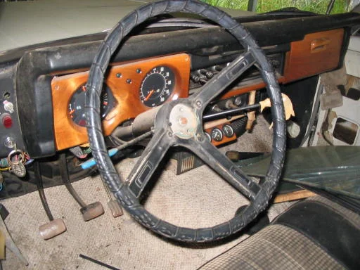

Does anyone have a template or model of a custom gauge mount, for the speedo/tach?
Are there OEM mounts available? It aftermarket?
Overall correct... with one caveat, if the work and design is exceptional, the value could be raised. But, a cut up pig will lower the number of people who might be interested. And a high priced pig lowers that number even more.
This is one of those mods that you do because flipping the 55 isn't on the table.
In theory, if your current gauge cluster mount is in good shape, you can unbolt the stock gauges, create a round ring, and bolt aftermarket gauges in place.
Here are stock gauges in a custom cluster:
I took the stock gauges out of the above and inserted some Haneline 3-n-1 gauges in there place.
*EDIT*
Here is the gauge set I used installed:
gaugesmount2_sml-jpg.332518
Here is the back of the same cluster:
gaugesmount1_sml-jpg.332517
I love these gauges. They maintain a 'factory' feel to the rig and the price of them was close to the price of the six separate gauges they cover.
Looks good. I was thinking of using sheet steel or aluminum, using the stock gauges. My original foam mount is disintegrated.
