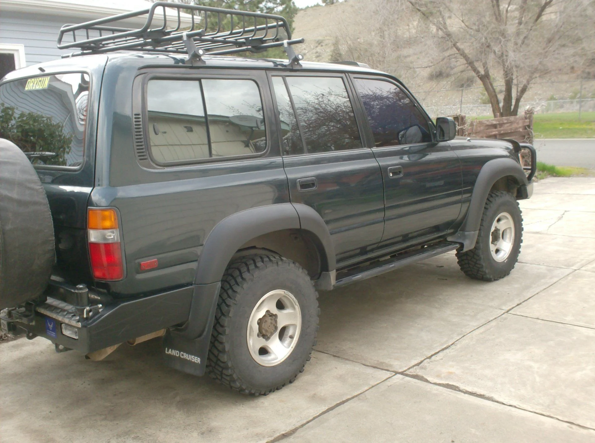

Another consideration is how would the bumper end look if flares were removed. There's a significant number of rigs with flares removed. Delta's pic has mud flap removed & that might be an oversight. My Kaymar ends at mud flap, so if either are removed, the fit & finish is not affected, IMHO. Might be a better way to go:
Example:View attachment 1823359
Sorry for the old pic:rolleyes:
When it comes to looks, we just do what we think is most functional and looks best (in that specific order). Can't say I agree with the statement that "the fit and finish is not affected", as there is no such thing as one size fits all, and the Kaymar is going to look vastly different and in my option unfinished, when on a de-flared/mudflapped rig. But your input is respected.

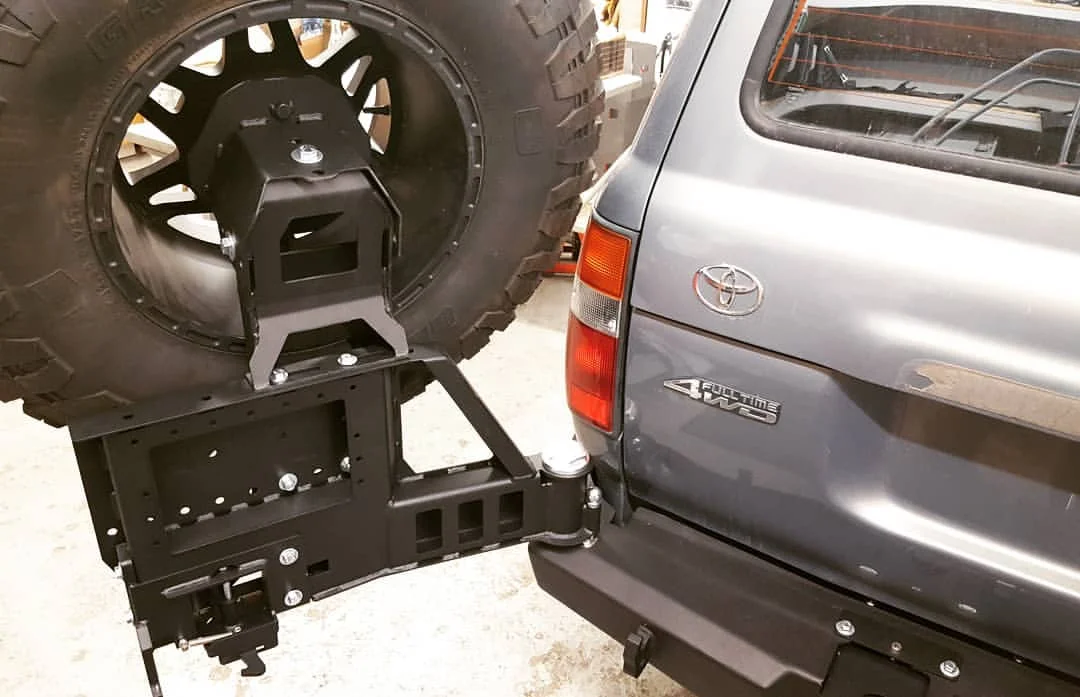

Looks like Patrick did snap a pic with an arm open, so here’s a good shot.
And to all the folks worried about lights, notice there is A LOT of room to the left of the tire mount which means it’s up to you, the user, to not block your lights when you install your stuff. Or, up to you to install two spares and have no cares.

As for the Delta bumper, the modular aspects will be extremely useful for a lot of people I believe. Being able to remove the accessories without needing to remove the entire swing out is a nice touch to allow lift gate access.
The feedback about the angles of the side wings of the bumper and how they fit to the flare is good constructive feedback. The sloping angle of the top of the wing does feel a bit like the wing wasn’t welded correctly and square. Obviously that’s not the case but making the top of the wing flat (at least where it meets the flare) might clean that up a little. Maybe for a version 2.0 down the road?
A hitch would be a cool addition but unless it was added below the bumper the buyer would need to cut out part of the rear cross member for the receiver. Dave’s bolt on hitch suggestion is probably the way to go unless he decides to change it in the future.
Really like the recovery point design to accommodate a shackle or a strap loop. Shackle is ideal but sometimes people just don’t have one and only have a strap. The hook it better than tying a strap to some other spot not designed for recovery.
It’s not possible to build the perfect solution for everyone that ticks every box. But clearly a lot of thought and effort went into this design to make it useful for people. As always, good work Dave.
