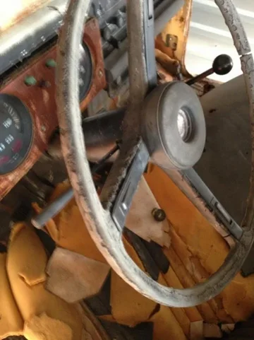

One thing I want to do is replace the steering wheel.
This is in parts Pig.
Would this be correct for the 76?
Any means to restore the padding and cover on the wheel itself, or save center and trash rest?
Prefer the blue, since it'll go with red and white, but have in one hand, want on another...
Practice on your old steering wheel, epoxying and sanding, while you look for a better one. That's what I'm doing, Boss Hog is sending me one and I'm going to patch my old one.
The one depicted is on parts Pig, but since blue is correct, this one will go to another Pig in need.
I'd like pristine on the 72.
confused by "padding and cover on the wheel itself" as there is no padding or cover factory on the wheel. yes, you can restore the steering wheel itself. i just did the steering wheel on our 1962. epoxy, sand paper, spray paint and patience are all you need.
This pic doesn't show, but the plastic (?) portion of the wheel is separated in two spots, exposing the inner steel ring.
There's a significant amount of some type of eating adhesive that's pitted the plastic (?) too.
I have honestly forgotten what the steering wheel on the 72 looks like, but believe its in much better shape than this one.
Will remove and store for 72 potential, though, since I think I have a line on a minty wheel with blue center for this Pig.
that's insignificant. you have to sand the cracks down to that ring anyways before you epoxy them
Gotcha. More thread searching.
Eating adhesive?
Haha. Best I could describe.
Ever see how some porous plastics look like Swiss cheese after super gluing?
That's what it looks like, with a grainy, fibrous layer of crap stuck to it.
