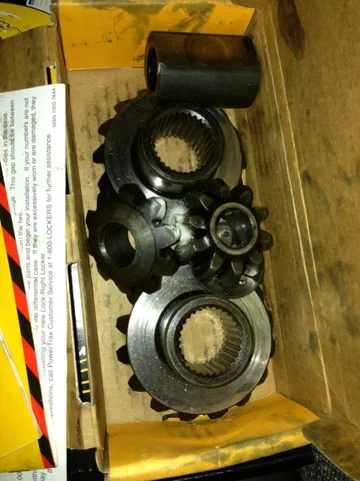

Currently has a LockRight, which I'll be removing since a driver, not a wheeler, and no intentions on PS.
What else should be considered "while I'm in there"?
Intend to run 33s, but considering those like an OD, so see no reason to gear, but have no clue what's involved in swapping the OE spiders back in.

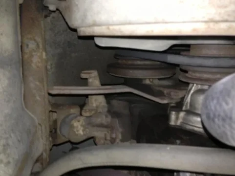

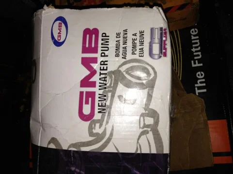

Water Pump. Prefer OE, personally, and will opt that route unless NLA.
Check these bad boys out. Are these NLA?

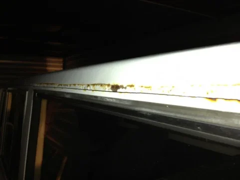

Knew the roof gutter was rusted, but it's actually separated slightly on the DS, so will need addressed.
Caved in, like the other two, too.

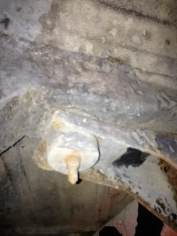

Body mounts are in the best shape of any I own or have personally seen, as are the floor supports and front fenders.

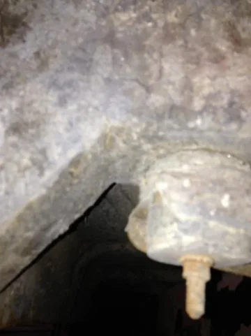

Lower fender attachment is crusty, as is the rocker at the rear, but still feels solid, so maybe patch?
Only leak I've located, so far.

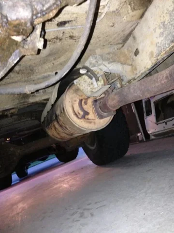

This might drag over a speed bump.

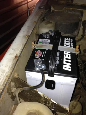

I may have made a mistake, in the haste of getting a battery to get to tag agency. Usually prefer DH Platinums but was hurried, all in vain, as we know, to tag.
Kept the physical size of what was in it and it appears the terminal of the previous may have contacted hood.

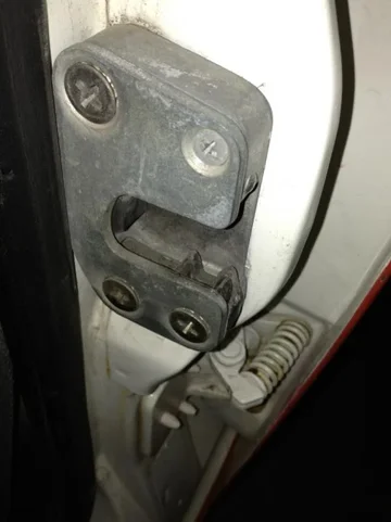

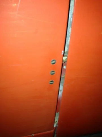

Door fix?
Have so many doors to choose from, but hopefully an easy repair that won't require more than a skin patch.

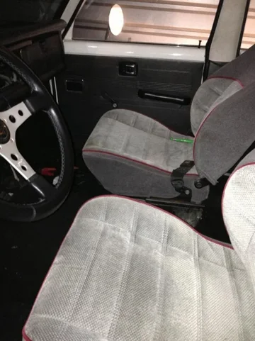

The steering wheel and seats have got to go.....

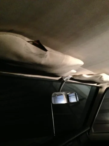

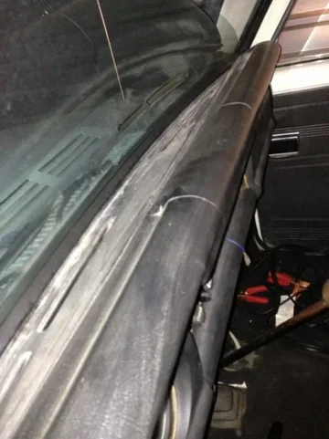

Visors are shot, but have two replacement sets to work with. Not sure how headliner will fair when removing to fix roof.

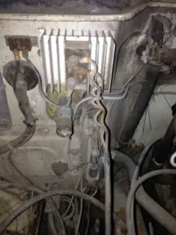

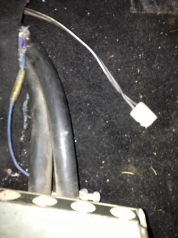

Have no clue what this could possibly be for. Appears to be a stranded wire, so thinking stereo? (Flame on, if its something simple I should know)

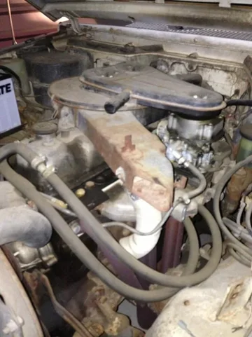

I have no idea if these are the OE linkages he said I'd need, or not, since its not an OE carb.
Sure is tempting to put an AC compressor here.

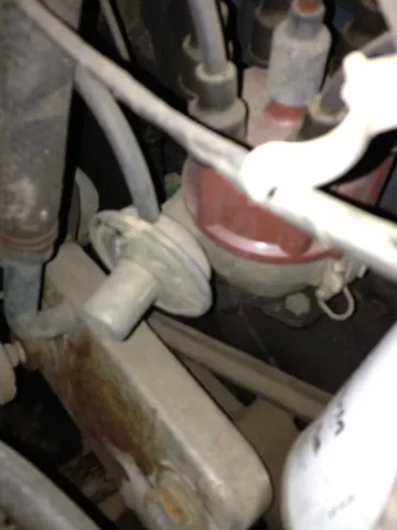

Dizzy pics. Not sure what I have, yet.

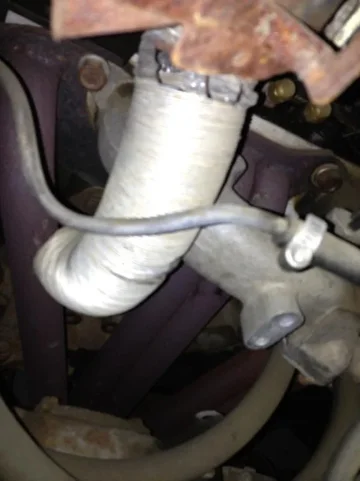

Not sure about this....but it isn't heat resistant.

Yes, i have a few good non-US dissys, which can have a pertronix added to it.
But the mid-1976 & 1977 dissy is a very good points dissy, and should have a semi electronic ignitor system piggybacked on the coil already. If you can get that working, it's the best. Send me a pic of the dissy so I can tell if it is vacuum advance or retard (changes mid-year)."

Nice rig! That water pump is crap (had one fail brand new on a 3FE - came with the truck deal), the wire is for he seat belt light ;-)

Thanks for info on seatbelt light.

The seat belt light must attach to the seat belt, somehow. There's no dash indications, so maybe the seat swap will be more involved?
I don't even know if the 71 bench will fit, nor do I know if that's what'll be installed.
Saw your 80 seats, but mine in the PP80 aren't that comfortable for my size, so don't know if they're viable or not.

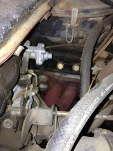

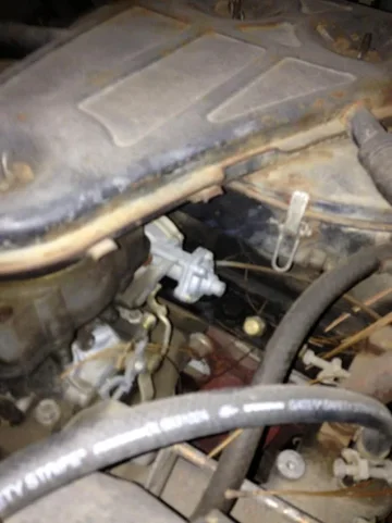

Pig's Breath 2F
She's a runner. Hear a little valve action, I believe, but based on previous replies to the 72 video.
Notice the brass plugs?
What are they for?

Not a problem to put open diff back in. Search my Aussie locker install and do the reverse.

can't veiw the video from my phone, but if the brass plugs are in the head, they're blocking the ports for the air rail.

i don't see thrust washers for your spiders. the thrusts for the side gears woud've been reused with the locker, but not the spider thrusts. you need those to put locker back in. (2 spiders, 2 spider thrusts, 2 side gears, 2 side gear thrusts, center block and pin and bolt for center pin)
They are in the head.
Will inventory complete content of all boxes and research the Aussie install to determine what is there and needed, then probably ask several other questions.
I have pulled and installed complete 80 and FJ. thirds, but have never touched the gears, themselves.

OEM water pumps are still available.
Well, based on the inclusion of a NIB water pump, I'm going to assume it has been determined to be in need, so I guess that'll be included in the cooling system PM, or whatever it's called on a 37 year old vehicle.
