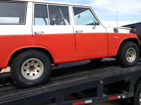

Met with Britt to inspect the 71 and while he was there, we discussed future plans for the 76, to which exclaimed an excellent starting point that isn't going to require much to, if continuing the same path as the 72.
Bondo on the rear corners and the roof issue, about all that will need major correction. Said fenders are good, rocker appears solid, pinholes in a few spots on fender lips, and about it.
Suggested hunting a roof "lid" as he'd want to drill out what's there, opposed to trying to repair, since there was something that caved it in and pulled at the gutter welds.
Glad to hear some good news, for once, but he seemed to think it has a lot of potential if restoring.

How much of the lid? I have a roof in the sideyard
It's pulled the DS seam all the way down where the gutter welds and the PS from the front pillar to the rear door.
It's caved in pretty good and the assumption is whatever impacted pulled it at those seams and that's where the rust began and is visible, but it's what below that concerns.
I didn't have the FSM for the 72 on me, but best I can recollect and visually see, along with what Britt described as a "lid" is the entire roof skin and gutter as one piece.
When I asked about correcting what was there, he did say that it's possible to, but that this Pig was in such good condition, that it warrants the search which I've all kinds of time to do.
He really wanted to keep the 71 parts Pig roof for this one, but not going to short that build, period.
What he's planning to do is drill the welds on the 71 and transfer to 72, gutter and all and thinking that's what he's describing here.
Would you think that it'd be possible to recreate a "lid" if what he's suggesting is as rare as a dinosaur?

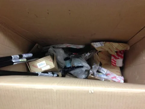

OE Goodies

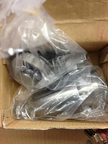

Steering and Brakes addressed.
Found a spider kit, but need to ask if that's what's necessary to pull the rear locker.

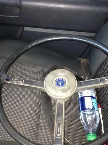

Also, a gift from okiedave
Need to clean up, but no cracks on wheel and it looks much better than the Grant that's on it now.
Thanks, Dave!

Nice steering wheel, that's going on the 76, right.
To pull the locker you need a tiny flathead screwdriver and a lot of patience, parts wise you just need a spacer, set of side gears and spiders w/spacers. You'll use the same thrust washers that are on the locker now -

Address brakes, parts included in this shipment, too.
Both items are safety concerns, so planned to do before seeing road service, but the delay on titling has impacted the timeline to do the work.
Yes. Pighead or Ige confirmed correct for model year, wanted the blue for the 72 but wasn't correct, so figured this would beat the Grant wheel that's on the 76, now.
Dave dropped it by at 6:30 this morning on his way to Corpus, so he went well out of his way to get in my hands and I'm much appreciative of.
Think it'll clean up fine and no cracks anywhere I can see, so a big time score that he refused money for.
Tucker
The spider kit in box is for driveshaft as Onur informed. I didn't open, otherwise I could've avoided the dumb question.
Going to see what I have, since Ige insinuated that I'm missing something to pull locker and replace with spiders on hand.
