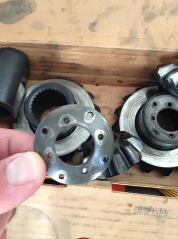

The spider kit in box is for driveshaft as Onur informed. I didn't open, otherwise I could've avoided the dumb question.
Going to see what I have, since Ige insinuated that I'm missing something to pull locker and replace with spiders on hand.
IIRC, she was talking 'bout the washers that go with your spider gears.
If I wasn't so dang wordy, it'd been easier for me to find.
Thanks for the reminder.
These?
#1...Yes

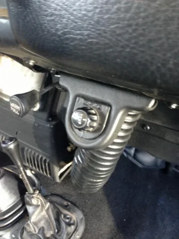

#2...If you can turn the knob almost full circle and not just on & off, then yes Flux Capacitor. They need to be brought up to speed slowly. Don't want to burn that up! :)

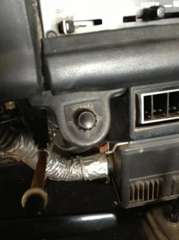

My other dumb question of the day.
What's this for?
Best I can tell, maybe it used to dim lights, but it's been hacked and doesn't function for anything.....unless there's a flux capacitor I've yet to locate.
Air Conditioner baby!
Do you have the other components?
if yes, then yes, those.
Was AC a dealer option in 76?
I do not believe I have any other components but sure going to hope I missed. The wiring dead ends above dash, tangled in the gauge wiring.
If none are present, since the switch is there, guess it could still fall into "period correct" form, even though not a strict adherence on this build, eh?
Yes, I know of another '76 that had factory ND air. I had claim on the interior piece, and it slipped away from me...
My '74 has a similar knob to that.

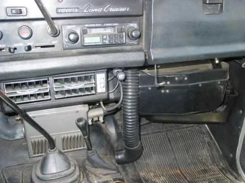

I think the biggest piece you would want/need is the evaporator, located inside the interior duct work, along with the expansion valve, as those have some specific fit requirements.
The condensor can be sourced new, in a more efficient design for r134a. You want new barrier hose as well, and new drier.
Does it have a compressor? Or at least mount for compressor?

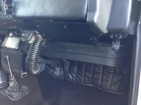

Would this be where a compressor would've mounted, or smog equipment?
(Lower bracket in pic)
I assumed smog, but assume starts with a-s-s, so....
Edited: know that's the pump, so I don't think accommodation for the compressor are still there. I'm perusing pics, since wont be back at 76 until tomorrow.

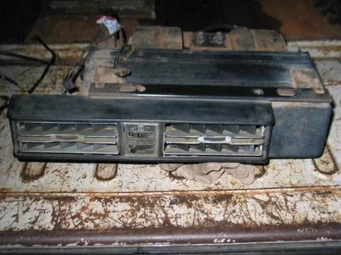

I got this on the shelf. I'm going aftermarket.
What's "this"?
Something that PC is describing?
Or am I to read between the lines in the aftermarket?

t's one of the harder pieces to find.
Ron,
I can't think of anything to trade except Benjamins.
About all I have of value is some uber rare, 6 of a kind known on existence, coarse spline Aisin hubs, but they're worthless to you too.
That said, if that's what I need for AC, I'm interested, if you are in selling.
That bracket is for the smog junk Chris.
No more perfect a place for a compressor, right?
