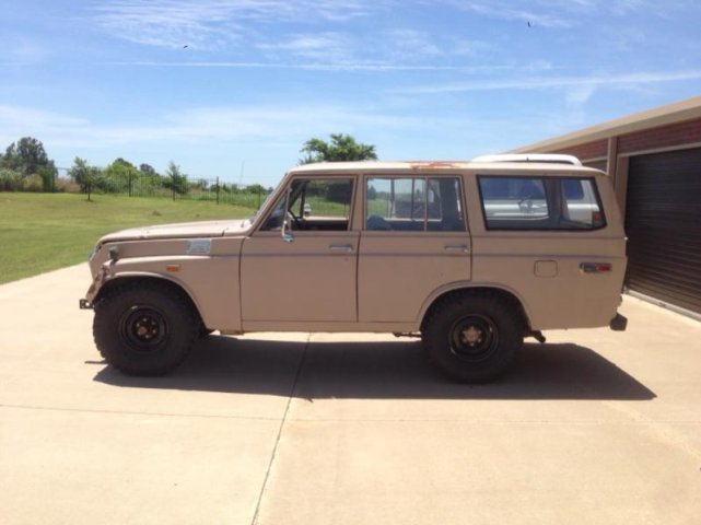

That is incredibly helpful. I've actually been trying to find a pic of an all tan pig. Thanks again!

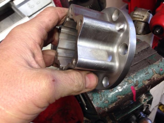

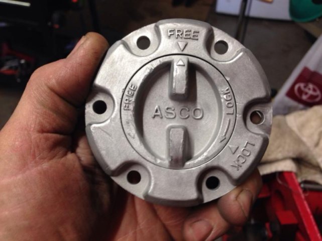

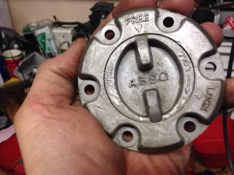

From this: To this: Wasn't sure if these would need to paint, considering condition, but think they turned out awesome.
Huh huh, you said "ASS CO". That was cool!
Sorry for the basic humor, but I think of that every time I I see my ASCO dials.
No paint, the 55 dials were silver.
