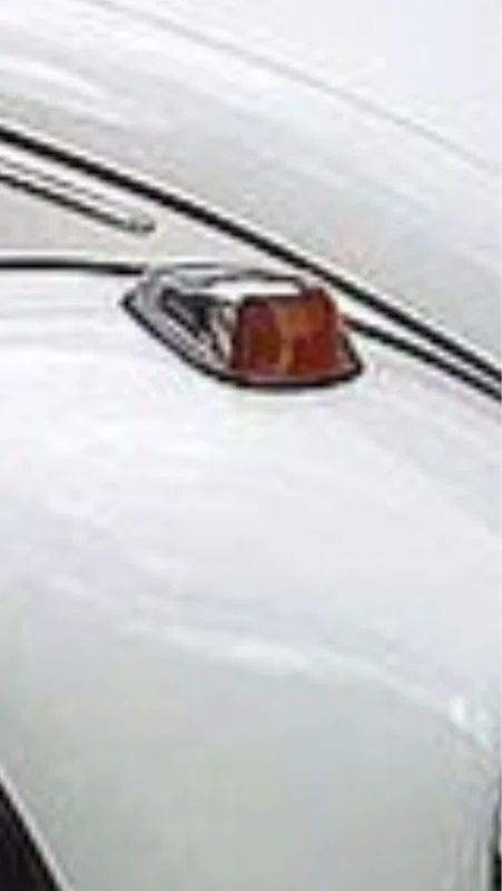

Not really certain what avenue travel, but feel a lower profile signal on the top of the fender is a must, at the very least.
Ron had suggested VWs, which promoted a Google search resulting decent options that cast forward and to the side, but all curved bases.

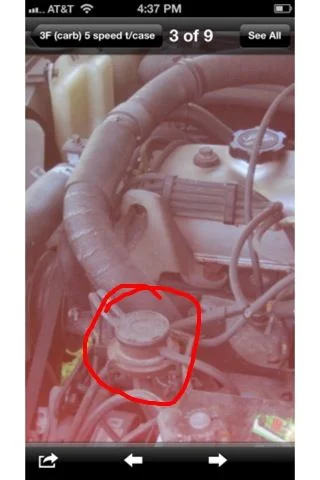

not insulator, but on base of carb...one of those 3 ports on the vacuum tube rail of carb...
Gotcha now....
is that Trollhole? ask him which one is vac advance...
Yes. I've been unable to reach him. Had been trying for the big cap and a few questions that other thread perusals promoted, to no avail.

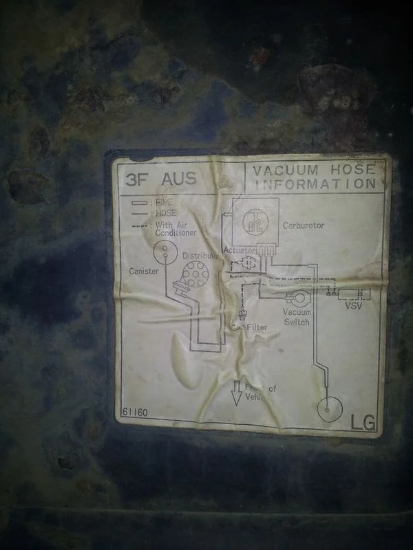

I know those guys with aussie 60-70 series had some info on this you posted in...
Trying to find it.

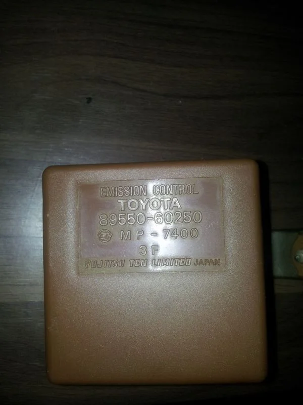

Not sure what this is...
The others I've seen, don't clear up much for me....

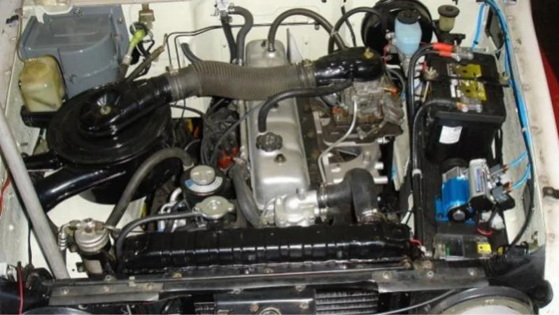

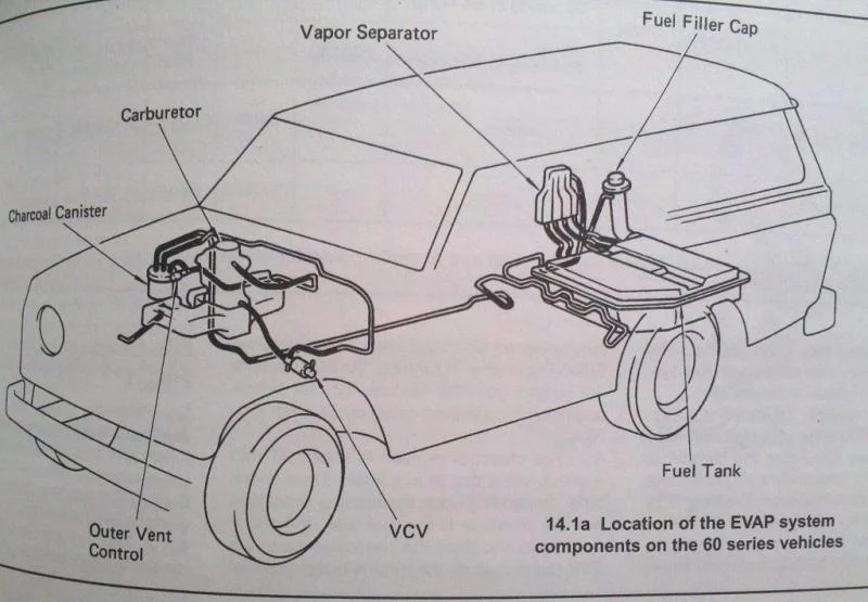

I'd use that auto zone canister and vent valve as pictured above personally. Then delete 76 VSV and vacuum surge tank and early/old/non-functional;) 30+ year old charcoal canister.....
Gotcha.
About to cut the 80 can apart and pack with aquarium grade charcoal, then reseal it, since they're NLA and I don't care much for the other options.

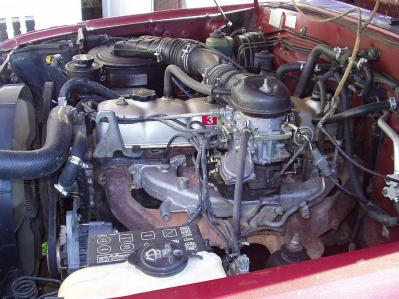

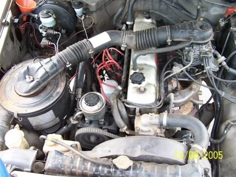

Ha. the last pic says a "60 series" but shows a pig...not sure about the distributor hook-up based upon these as there seems to be a coninuity issue with the pics...one shows dizzy at inside back left in pic, the other shows base of carb above throttle plate...might make more sense to you...
the OVCV opens when engine temp is warm enough via BVSV to allow vapor to manifold(key on)see if there isn't another vac port at the base of carby...for advance...maybe you carb only allows for one canister and already has advance at vac tube rail...check to see where they come out in the bore in relation to throttle plate...
I'm getting lost reading this on my phone whilst watching football, but just to be clear you plan to desmog this correct? No reason for any of the emissions crap in OK correct (realize another story in CA)? I think my vacuum routing was simpler on my EFI 3FE after desmogging than what you guys are posting :(. I used the big ass charcoal canister off a 62 FWIW -
Tucker
the only thing emissin related in these pics could be the charcoal can, and you'll want that- at least the one anyway. the rest of the vac is for dizzy and a/c. you should not need the computer or vac switch in those pics, just do green wire mod or use fj60 computer operated by fj60 vac switch to operate fuel-cut decel function. FWIU, Jim recommends using the decel unless you get backfire on decel, then to do green wire mod(which keeps power to idle solenoid when ig is on- fuel cut decel cuts idle solenoid on heavy vacuum{decel}) essentially a desmogged 2F without HAC, but with EVAP and vac advance...the 62 still has EVAP when desmogged, and vac advance, but no idle up for A/C...it's easy:p
Tuckers on the same track I would take...but if you found some toyota-ish lights to cut-into the grille, you could do that too. I'd bet there would be several models of yotas in yunk jards around that would have suitable marker lights you could do that with. FWIW, I have thought about the simple rectangular LED marker type lights for that spot, ala suggested by Tuck..they would work well and not look terribly out of place...
The holes they put in the '69 Pig grille happen to fit the factory side marker lights used on Pig & 40 very nicely!
Wire it up for turn signal using factory parts...

I say nothing on the fender, figure out how to wire the side fender lights to the blinker and put a blinker in the lower grill. I used 70 series lights on my truck but they were still pretty bulky.
