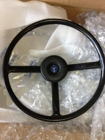

Check this out, a gift from Alberto SD from his El Salvadorian 79 BJ40.
Perfect. Can't wait to swap the Grant for.
That said, how easy is it gonna be to swap the Grant out?
While I'm a freak, that's beyond the degree to which the fetishes extend. Bahaha.
Very cool gesture from Alberto, to say the least.
This wheel is perfect in every respect.
Thanks, Alberto!!
That is a nice wheel. For the 76, right. I get so confused!
Ron, me too:)
Thanks Bob
You think I'm not?
Bahaha.
Ige said somewhere that the blue T would be correct for the 72, and this is in such good shape I feel it belongs on it, but, odds are, it'll be the crown of the 76s interior, because it's killer.
I have one from okiedave that needs cleaning that I'll run on the 72, if it's correct, or will find/restore the brown bottle cap one that it came with.
Considering how this build (76) has changed, I think both are going to wind up very cool Pigs, so not going to short change it, by any means.
One thing I had considered after measuring other vehicles and seating was trying to incorporate a tilt column, but don't think this will work, so will scrap that idea and focus on how to get the Grant off and this one on in its place.
