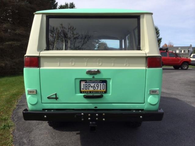

I didn't realize he'd axed the rear vents and reflectors.
Blasphemous, I'm sure, but had considered cutting out the reflector raise and recessing the reverse lights, of course, saving that corner for a true resto'd Pig.

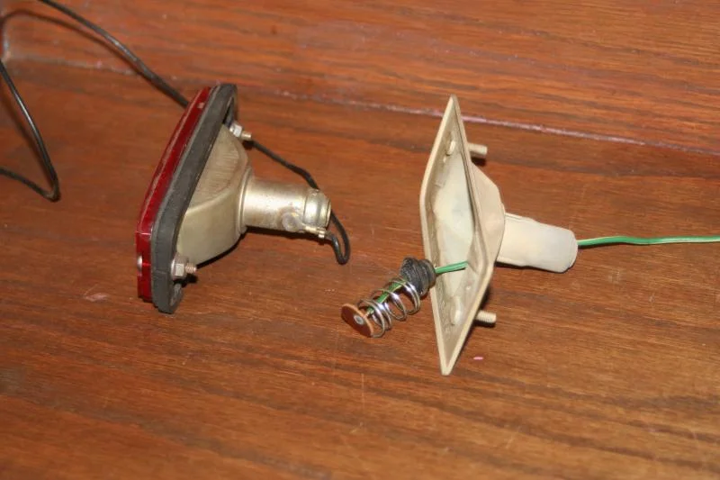

Chris,
Here's a couple shots of a marker light and the grille light, that I got from Lambcrusher.
The lights are different and so is the wiring. The marker light has a wire coming off the spring base, like the grille light and it has a ground wire on the side of base, which the grille light doesn't have?
I stole the wire, that's on the grille light, from a marker light.
I'm worried about the rubber gasket. Mine are shot, so I'll be making something up.
Lambcrusher's grille cleaned up nice and I've been trying to get all the little dents, etc. out before powder coating.
Bulb housings have been blasted and Cad. plated. :)

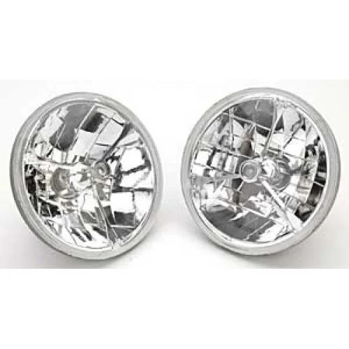

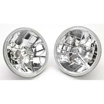

I don't know the legality concerning side market lighting, but had considered eliminating the front and rear side lights, moving combined signal and front markers to lower grille.
Had seen the combo headlights but thought they looked ghey, but happened upon these and has me thinking.
Since you can't tell the signal is there until illuminated.

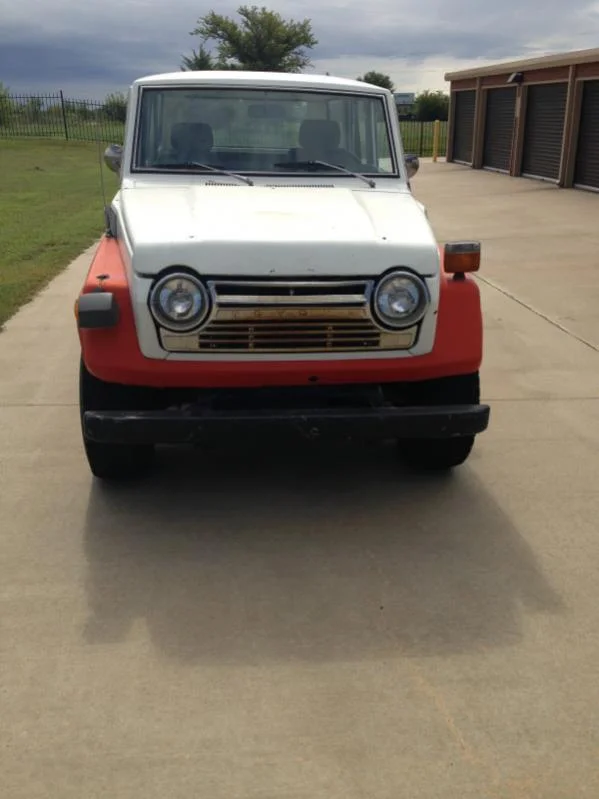

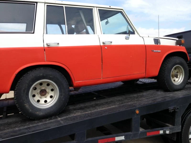

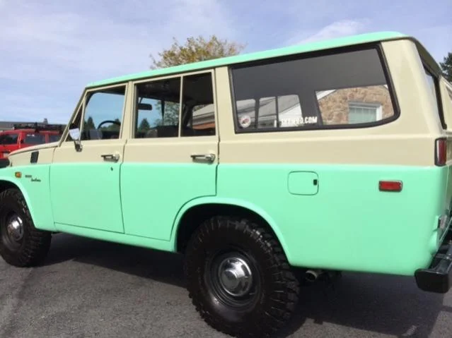

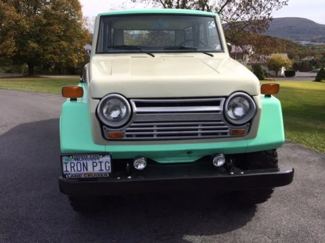

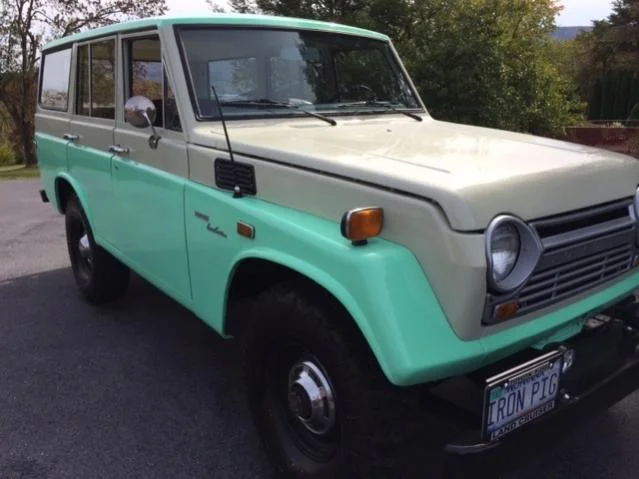

That's montyorpenn's Pig in the pics, the first a before and the last string the recently revealed finish, but it is a good looking Pig....as the look 5 billion times better when they're closer to done than I am.
OE wheels with OE caps and appears to be KM2s on montyorpenn's depicted, which I chose for the 72.
The to be Freeborn Red 76 will keep the aftermarkets it came with, cause I think they're kind of cool, but may opt for ATs.
I may even keep the white roof.

now thats a great color! however I think I am a little biased based on the color of my piggy. The red roof looks great IMHO.
I'd like to get some steelies and put the dome center caps on. Think it would really make my pig stand out. however I have a bunch of money spent on trim, bits, tune up, and then i have to re-do the interior so think the wheels I have will need to wait till the CFO releases more money. ;)

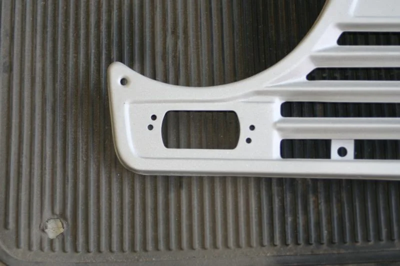

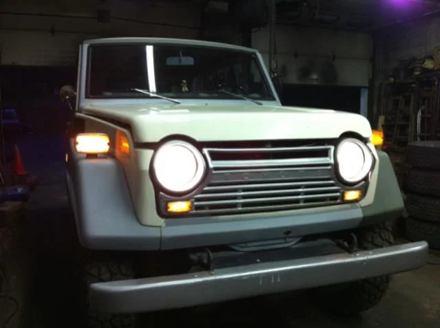

Now you have scrap daddy's pic of the grille cut out to contemplate. Those cuts on the '69 grille will accommodate the orig '69 grille marker lights, or the side marker lights.
You heard Ige right, the orig marker lights are R and L sided, while the side marker lights are ambidextrous.
Some grilles had 2 little plastic pieces of trim in the area where the cut out is pictured. His powder coater should have caught that if he didn't.
