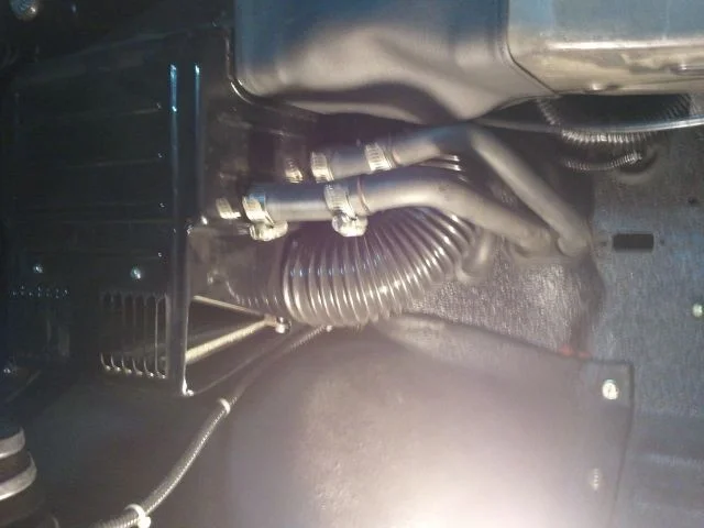

Took my old hoses to NAPA. Bought correct lengths of flexible hose in approximate diameters, similar to above. Pushed it on at both heater and metal ducting. Works fine after three years. No shipping, no excessive re-engineering required. I suppose you could use black plastic slip ties if necessary.

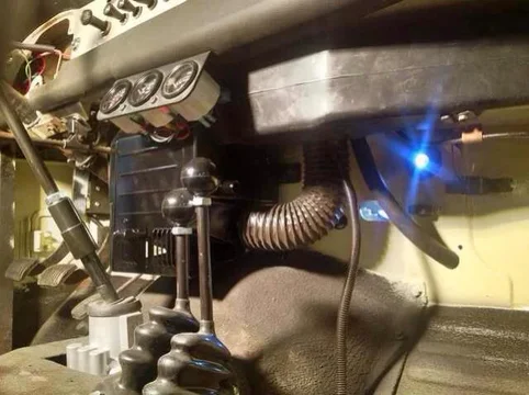

SOR sells the elbows. They are pricey though. My tubes were missing altogether so I used heater vent tubing from AutoZone. I think it was 10 bucks for a 7' section. It slips right on and holds tight enough with no clamps or tape.

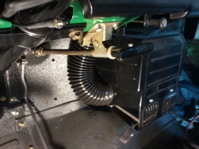

I just finished re-installing the hoses on a 75, Fj40. The elbows were fine after liberal quantities of Goop hand cleaner treatment. The upper collars were useless, however. what I finally did was construct a new collar using 3/16 rubber sheet. I cut the rubber to the correct size then rolled it intop a column with about 1/4 overlap. I glued the rubber using an industrial, flexible, cement used for repairing conveyer belts. Once the new collar was cured I glued it to the flex hose. O droped a thumbscrew hose clamp around the collar, oriented the seam to the firewall and tightened the clamp. It is a solid repair that cost about $25 for the rubber sheet & adhesive.

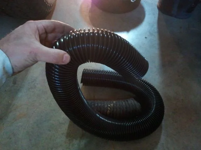

Here was my simple fix (mine were missing when I purchased it) It is just a generic duct hose from Autozone for like $11.99: Dimensions 2-1/2" x 72" PN 96004 you can trim it to size to do both ducts, and have some left. I used black zip ties to secure it on top & bottom & it works great!
It's not original but it works well!!
