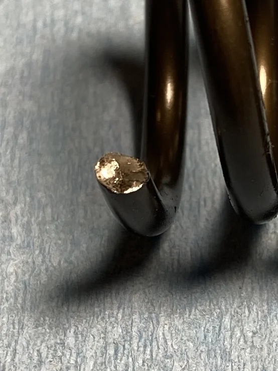

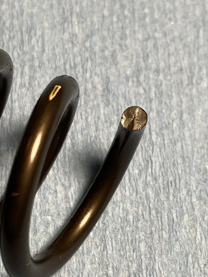

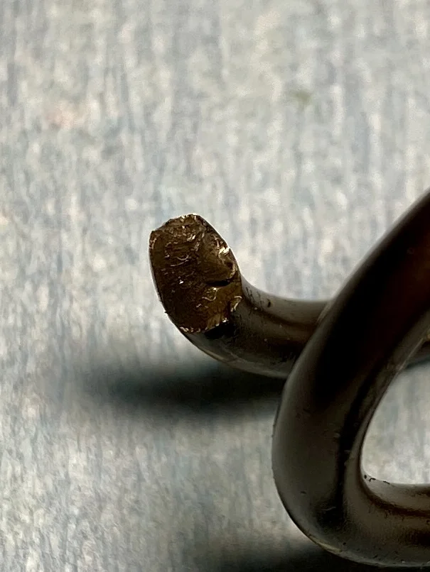

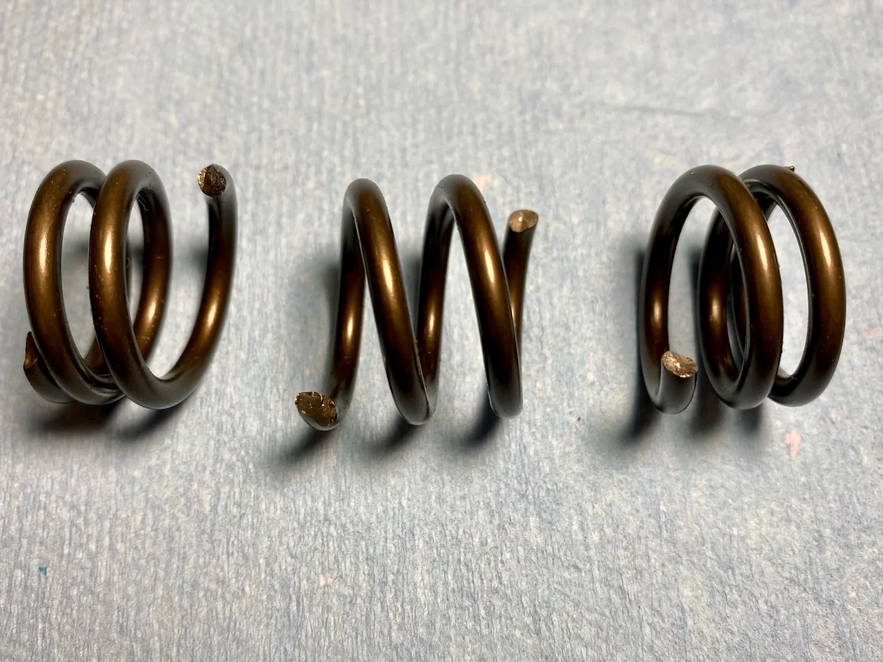

I never had any noticeable top end racket or power issues under load but I haven’t towed anything in several months. Did make a few mountain trips and never noticed any power issues though. I can’t recall exactly what the CEL code was initially when I had the CEL and check VSC system that happened several months ago but in this instance when it happened and the miss was evident it was multiple cylinder misfire code. The misfire counts being the highest on #5 and #6. The mechanic called me late yesterday to give me his initial findings of the broke exhaust valve on #5. He is supposed to check out the other side today and see what’s going on with #6 today.
Interesting that the misfire is in the same cylinder, could be the spring was crying for help.

@fj40z got his spring today but I will let him share. It did remind me that I wanted to post some detail images of mine. Best I can do with a cell phone.
