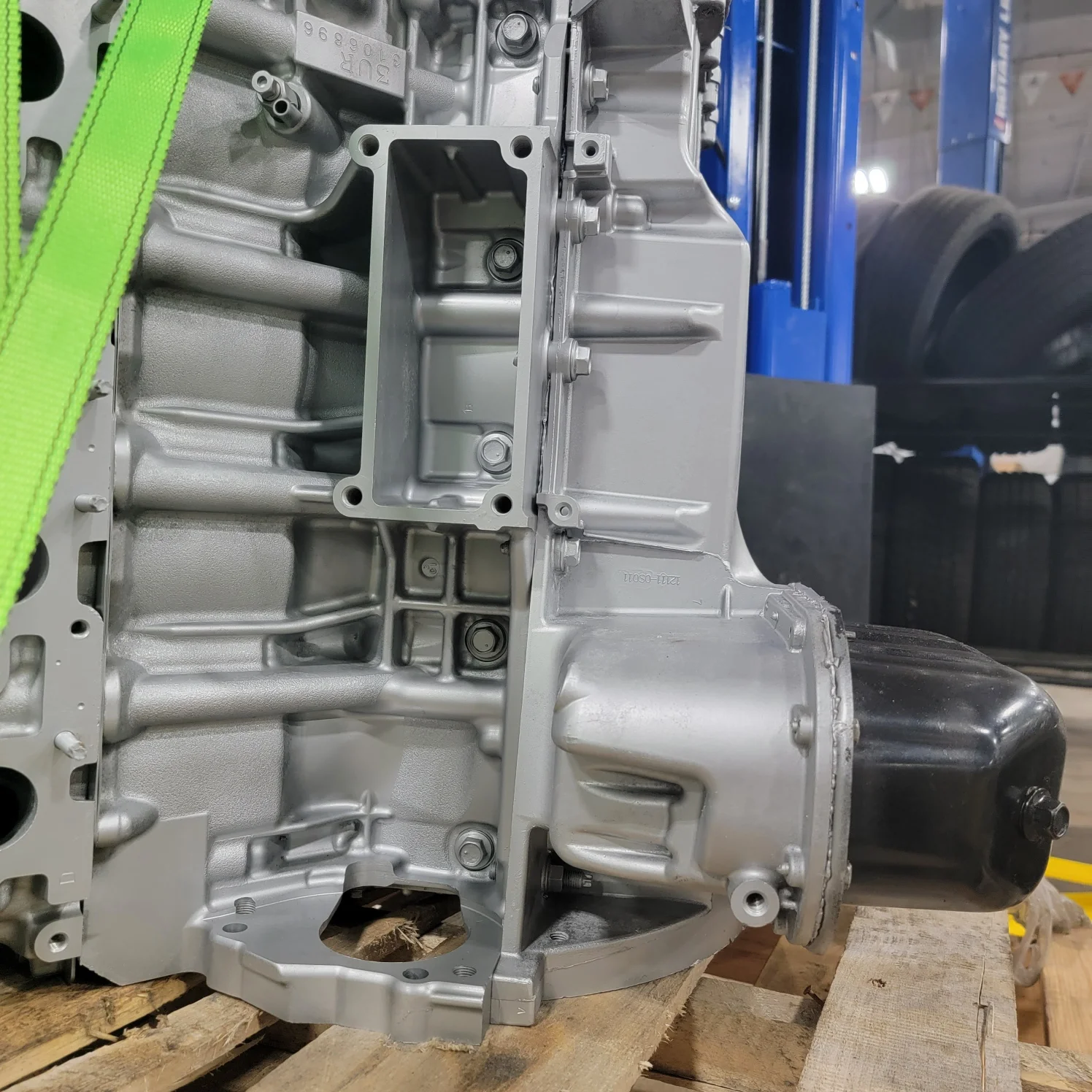

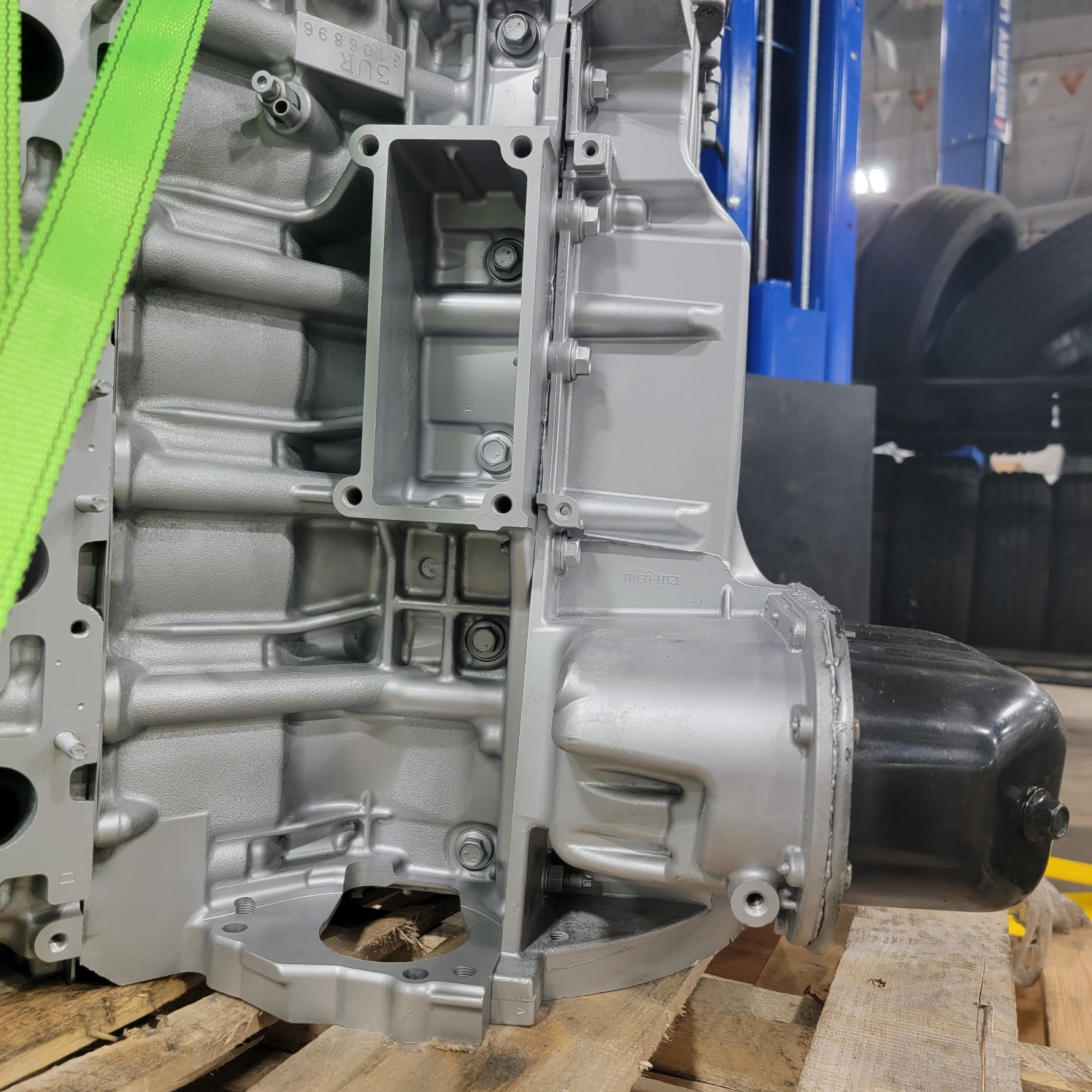

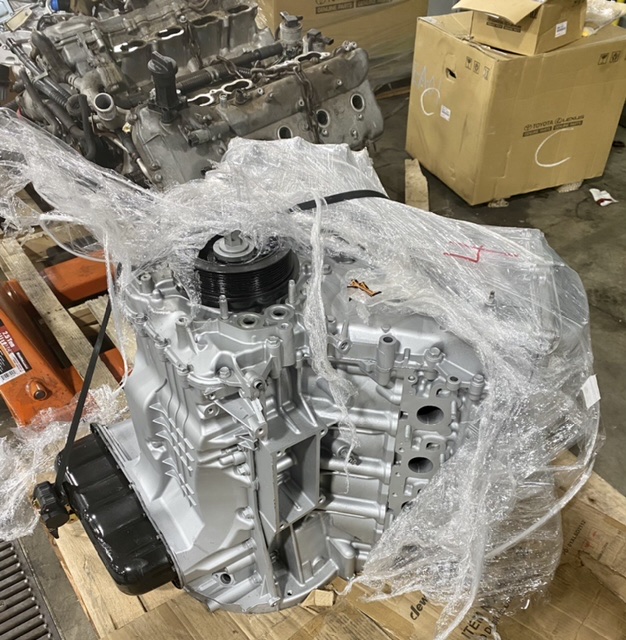

Something is not right on the “new” motor either.
Still trying to wrap my head around how they get that block clean enough for a paint job without completely tearing it down… I guess that’s fully “rebuilt”?

Wrong upper oil pan? Beyond that I can't tell.. (edit: part number matches 08-11 200 3UR, so I was wrong on that)
They hosed a used engine off with solvent, let it dry (maybe), masked a couple things (maybe), then sprayed it with paint.
Yeah, no oil level sensor on upper pan that should have been present on the described 2013 engine. Either the pan was swapped at the shop supplying the motor or the entire things is a bait/switch. I haven’t been available to pull the vin on the block yet. I have some options to resolve but it is another speed bump

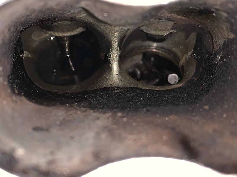

Let’s try again. “New” engine arrived today with the correct oil pan. Also on removing the old, the tech found the #2 fuel injector to be leaking. New theory: While parking (wife reported a sudden rough idle while putting it into park) the injector became stuck open or a seal failed. The cylinder filled enough with gasoline that it hydro locked during startup.

I believe hydrolock damage would be concentrated to the bottom end, you had a pic of a broken valve so I’m still in the bad valve spring camp. It would be interesting to see a tear down of the bottom end to see the #2 cylinder, rod and piston.

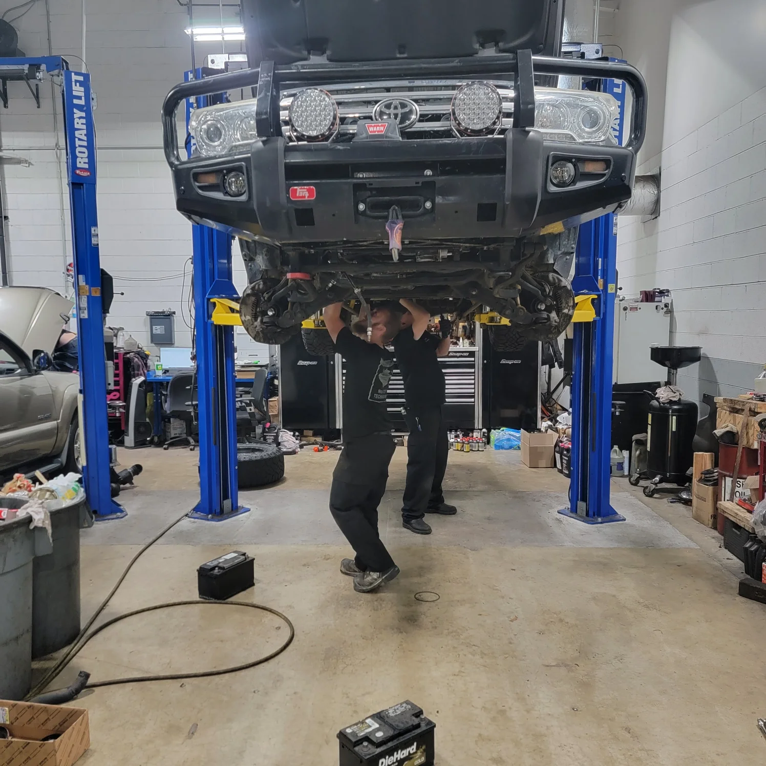

Gotta have more pics. Is the old engine out? What about flushing the trans. now? Has to be easier with the engine out of the way.

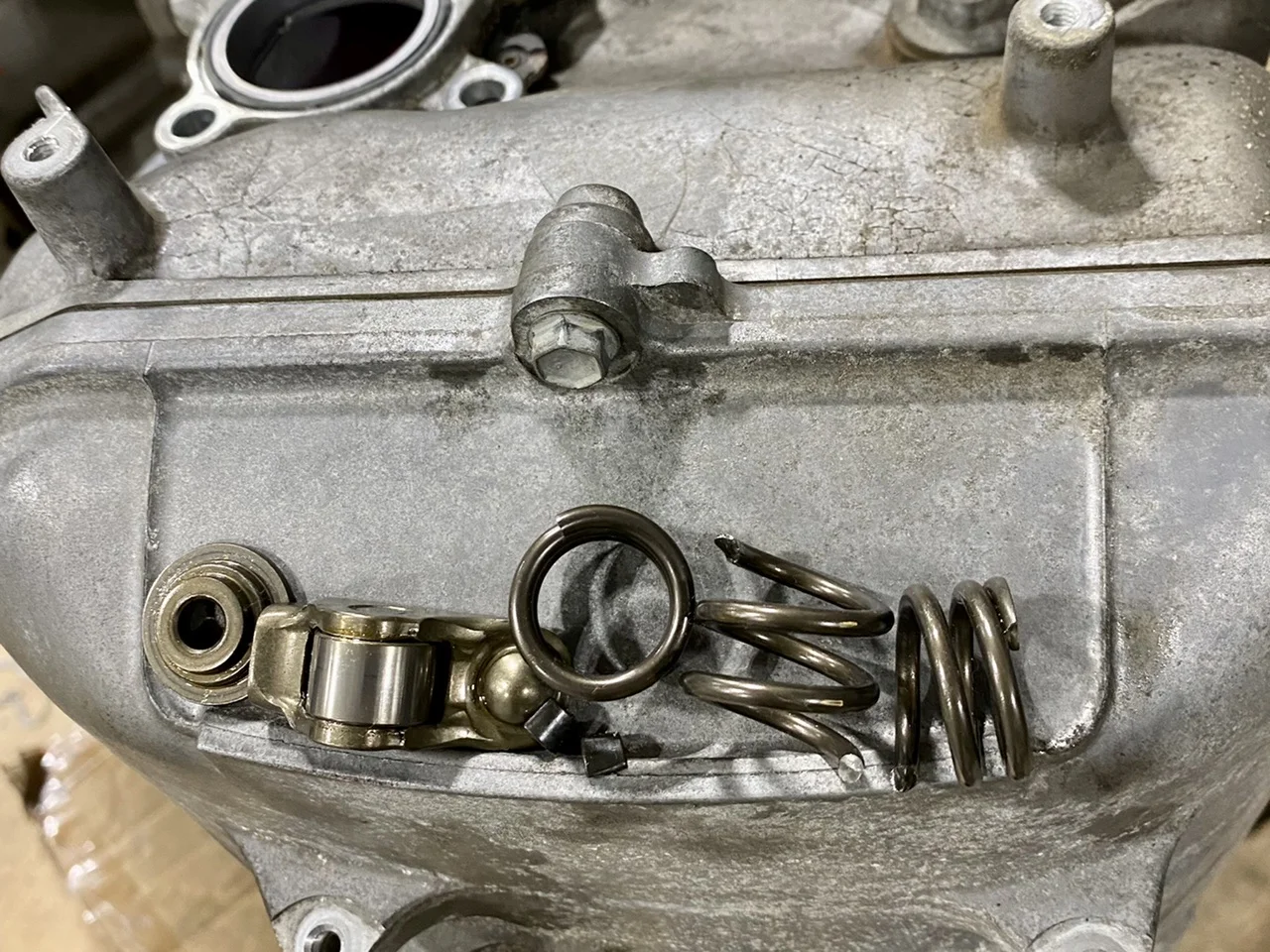

There she is. One spring became 3.

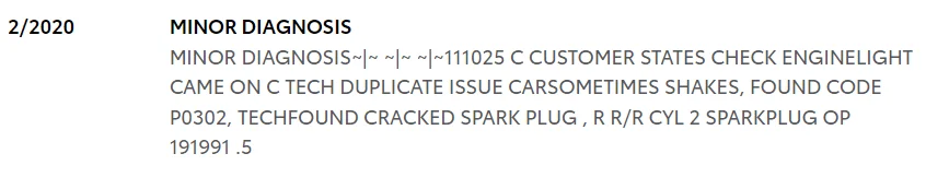

Engine is in and running fine now on it's 3rd cycle of fresh oil and about 50 miles. Dug into my vehicle's service history and found something interesting from before I owned it.
Looks like there was some trouble but the dealership couldn't figure it out.
Shortly after, it comes back and they found a cracked spark plug on #2!

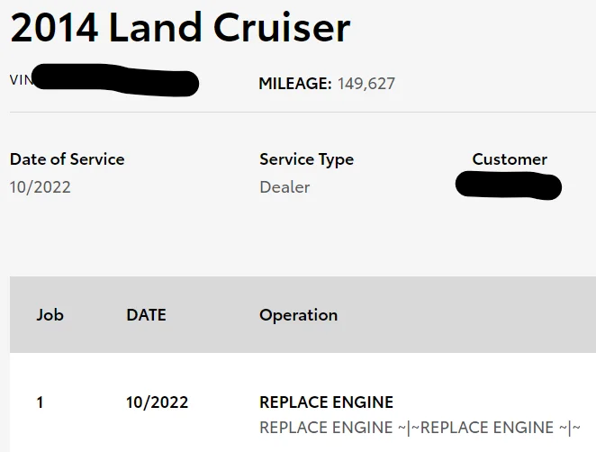

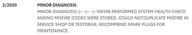

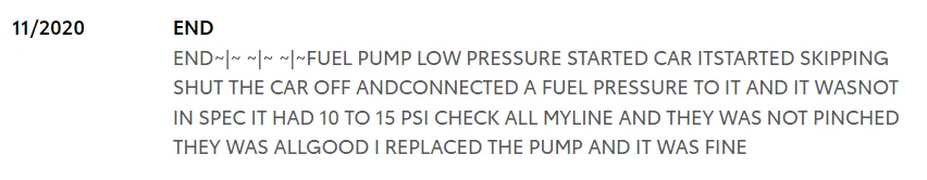

PO dumps it and I pick it up. There is an open recall on the fuel pump and I get it done. The shop calls me to report they needed to keep it longer because it was not running correctly. Their notes show a fuel pressure issue and they put in another pump. "was fine"
Now I have it and I get a Cyl #2 misfire some time later. I did not know about the plugs before or previous misfire and figure that the mileage was right for a change and start with "spark" to diagnose the misfire. Along with new plugs, #2 coil pack gets swapped with #4 to see if the misfire chases it, and the plugs looked like they were in good shape (yeah, they were less than a year old).
The misfire code never comes back. I did have the occasional rough start that would engage limp mode, but it never triggered a code and a restart would put everything back to normal.

Bumping this thread as the same thing just happened to my 200. 2010 with 200,000 miles. #5 exhaust valve broke. Truck was running fine cruising at highway speed when all of a sudden the dash lit up like a Christmas tree and had a bad miss. Similar backstory as well, a few months ago got the check VSC system, CEL and 4Low lights. Did a search here and several people had encountered the same thing. So I did what others here had done and cleared the codes, unhooked the battery and everything was fine for several months. When it happened again this time I definitely wasn’t expecting a broken valve spring. Very thankful that the valve did not drop in the cylinder and so far it looks like it’s avoided the catastrophic damage. As of right now I’m definitely leaning towards just replacing all the valve springs as PM while we’re in there. Just think it would be foolish to replace just the broken one leaving the possibility for another to break, especially after dodging the bullet this time.

I would do all the springs and buy a few lottery tickets while you’re at it.
