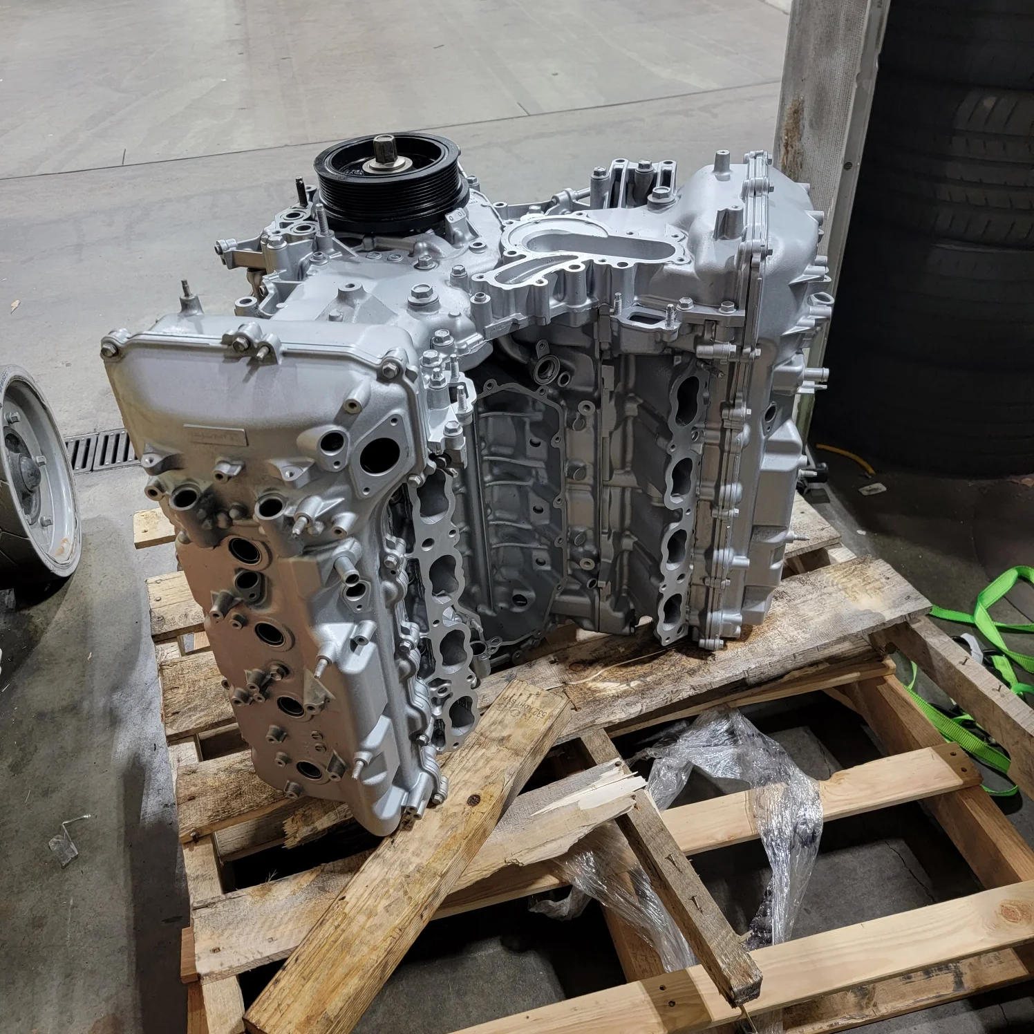

Edit: looking closer.. they painted the one above silver. If the installing tech has any attention to detail he has his work cutout removing the paint from the oil cooler ports, VVT module ports if they didn’t plug them, etc.
It came from Houston, so maybe same place. Yes, painted too. The place says that they get comments all the time about it. From the closeups I have seen, I think we are okay from paint in ports.
Houston is an enormous hub of salvage yards, so it’s possible it was the same place but I’d say unlikely. I also have trouble believing what I saw would be allowed on a wide scale with Houston having been in trouble with TCEQ. I’ve been to a fair number of these yards from my engine and transmission swap projects over the years and was surprised by this setup..
Next step is parts list now that we have it. Still haven't dug into the broken motor to confirm cylinder damage but with a broken piston/rod and one destroyed head it may not be worth it beyond curiosity

Seals is where it seems to get tricky. Could order the engine overhaul seal kit from Toyota but there is a lot in there that I won't need (head gaskets, valve guides, etc inside) and I am not certain what it is missing for all the other components around the engine for $500.
I can't promise this list is complete, but judging by the picture of the engine I see that you will need: coolant pipe o-ring x2(for timing cover to valley cover), plenum gasket x2, exhaust manifold gasket x2, manifold to cat gasket x2, manifold to cat exhaust nut x6(they don't like to go back on, chase the threads on the studs and replace the nuts), dipstick tube o-ring, oil filter bracket o-ring x2, crossover pipe gasket x2, FIPG 103 for valley cover, oil drain plug gasket, lower injector o-ring x8, OCV o-ring x4, air injection gaskets x4, oil filler neck gasket. I would also add a rear crank seal and housing re-seal as the engine is currently out of the vehicle. Cam sensor o-rings are not available separately from cam sensors.
Helpful, thanks. Tracks with my growing list but forgot about the oil filler neck. Already have a fresh dipstick tube oring (it's the little things in life 😀 )
