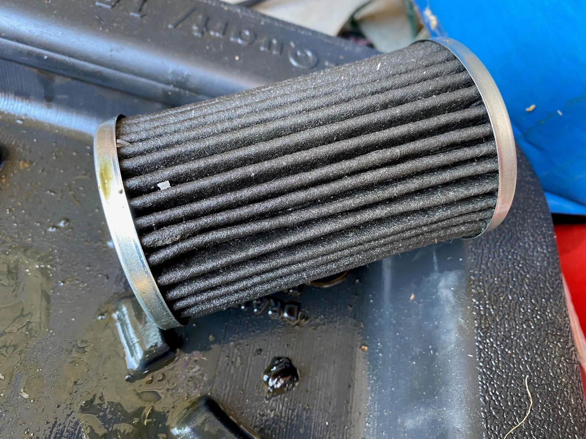

My saga continues. We are engine #4 for anyone keeping track. A quick recap because I didn't update my troubles post-swap as it was not relevant to the original discussion but here we go:
#1: The beloved factory original. Death by valve spring failure (9050133030) and internal damage.
#2: Wrong engine sent. Suspect it was a Tundra motor though labeled as LX570.
#3: Installed LC motor. It went back to the dealership for a few immediate issues from the swap that were handled. These included a coolant leak from a rolled o-ring and busted CV. Really should have been seen before returning the vehicle but I give them the benefit of the doubt since it was non-stop raining that week. At 500 miles I wanted to do some due diligence myself in pulled the skids to inspect better. Found another coolant leak at the water pump (new pump had been used) and an ominous problem when I pulled the oil filter to inspect for any debris. When I removed the filter housing drain it had a blue o-ring. I had used the TRD filters on the original motor and this appear to be left over from that. No biggy, right, just an o-ring. However, when I dropped the filter, it was my original filter instead of a fresh one.
The dealership claimed they had done 2 cycles of oil changes on the used motor. Only one oil change was listed on the invoice, but still, the part number for the filter used was the standard filter that would be expected. Also considering that the TRD was not available at the time, I know because I was approaching 5K miles and had looked for this filter when getting supplies for an upcoming oil change, there was no doubt that they never changed the filter when they swapped the filter housing onto the new motor. I popped a fresh filter in and took it back to the dealership.
They identified 2 issues. First, the coolant leak was caused by overzealous surface prep on the timing cover that caused a wavy (their term) surface that was preventing the water pump from sealing. Second, while addressing the first, the techs identified a lower end knock caused by a bad crank bearing. They agreed this was related to the oil filter not being replaced, either oil starvation or unfiltered bypass oil, that ruined a good motor in 500 miles.
#4: Warrantying that motor through the engine source has been a disaster. After months of delays and lies, we finally got a motor last week. We inspected it from the outside and could tell that head work had been done to one side because of signs of a valve job. Yesterday they started to put it together and found that they can not even thread in a spark plug on #2. We suspect that this was the original motor that went back as a core, and was repaired. The supplier denies it, but either way, I am anticipating more time with the dealership today.
