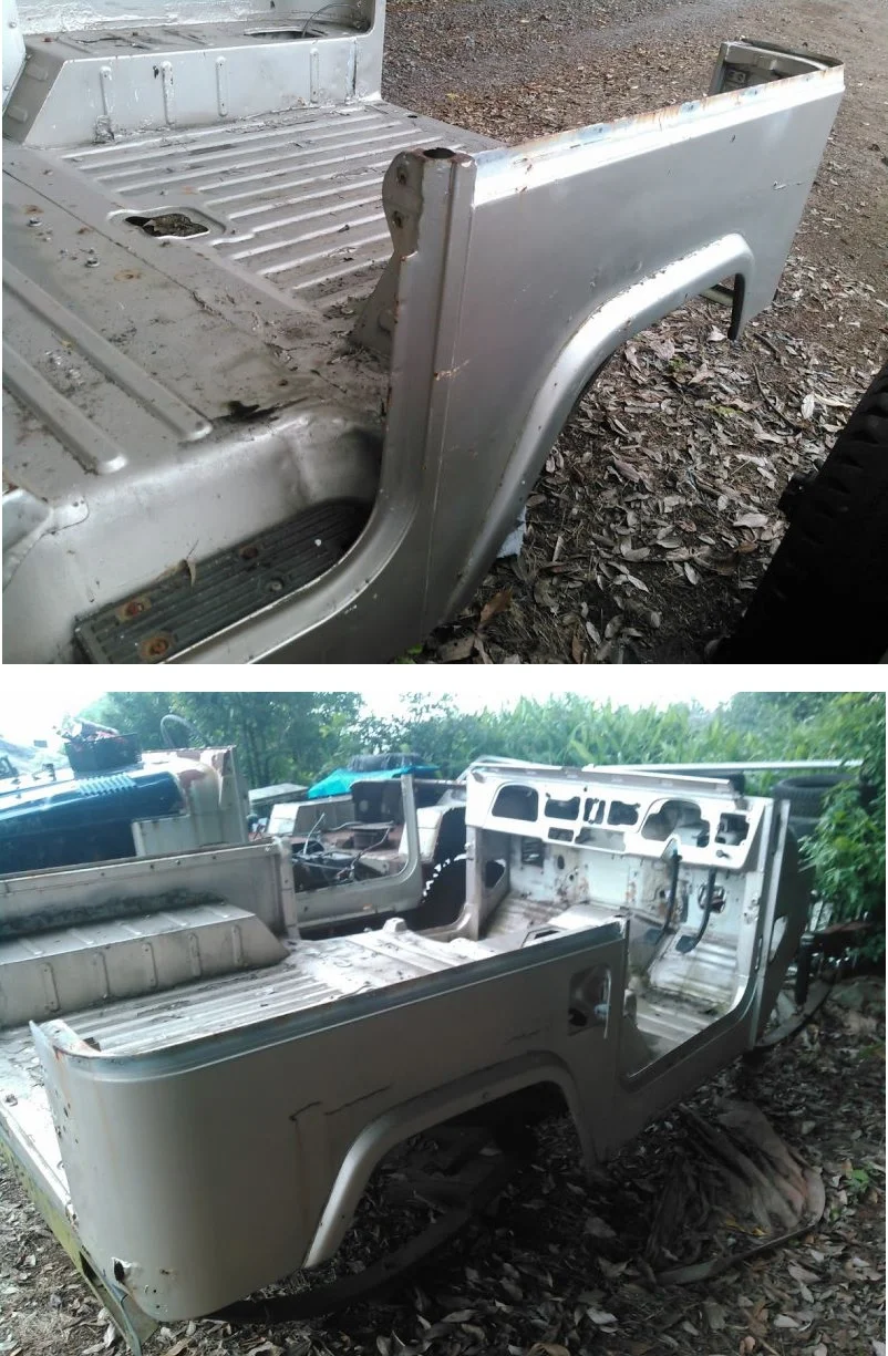

I have some rear wheel opening that were cut to the maximum size (up to the inside fender well) by a PO. I am trying to decide if I should just buy the pieces from RSCP to bring them back to stock look or go with some custom made flares over the openings. Having a stock look is not required for this daily driver. I know some folks have made them with tubing frames and flat stock but there are probably other ideas out there as well. If you have something custom back there let's see them.

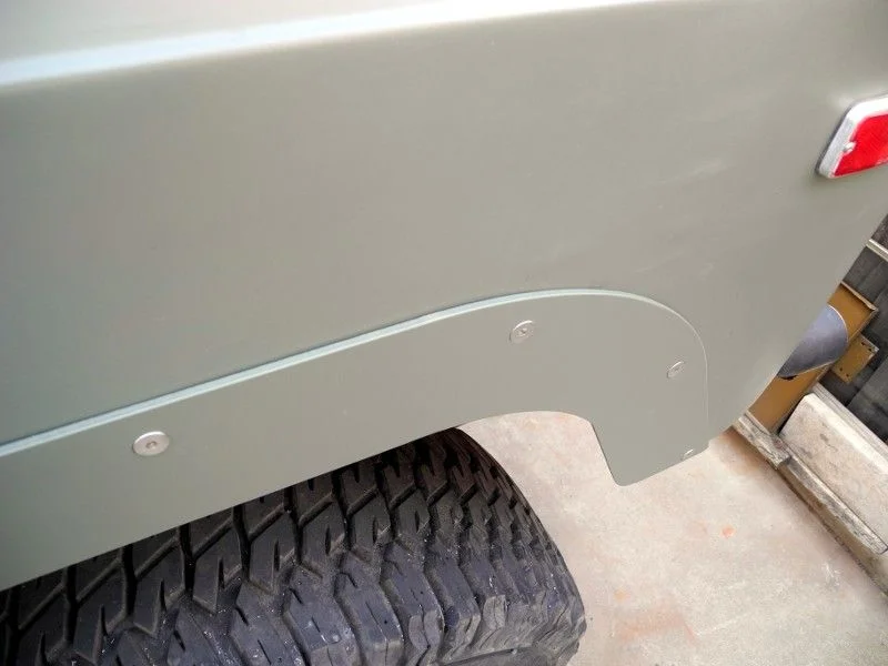

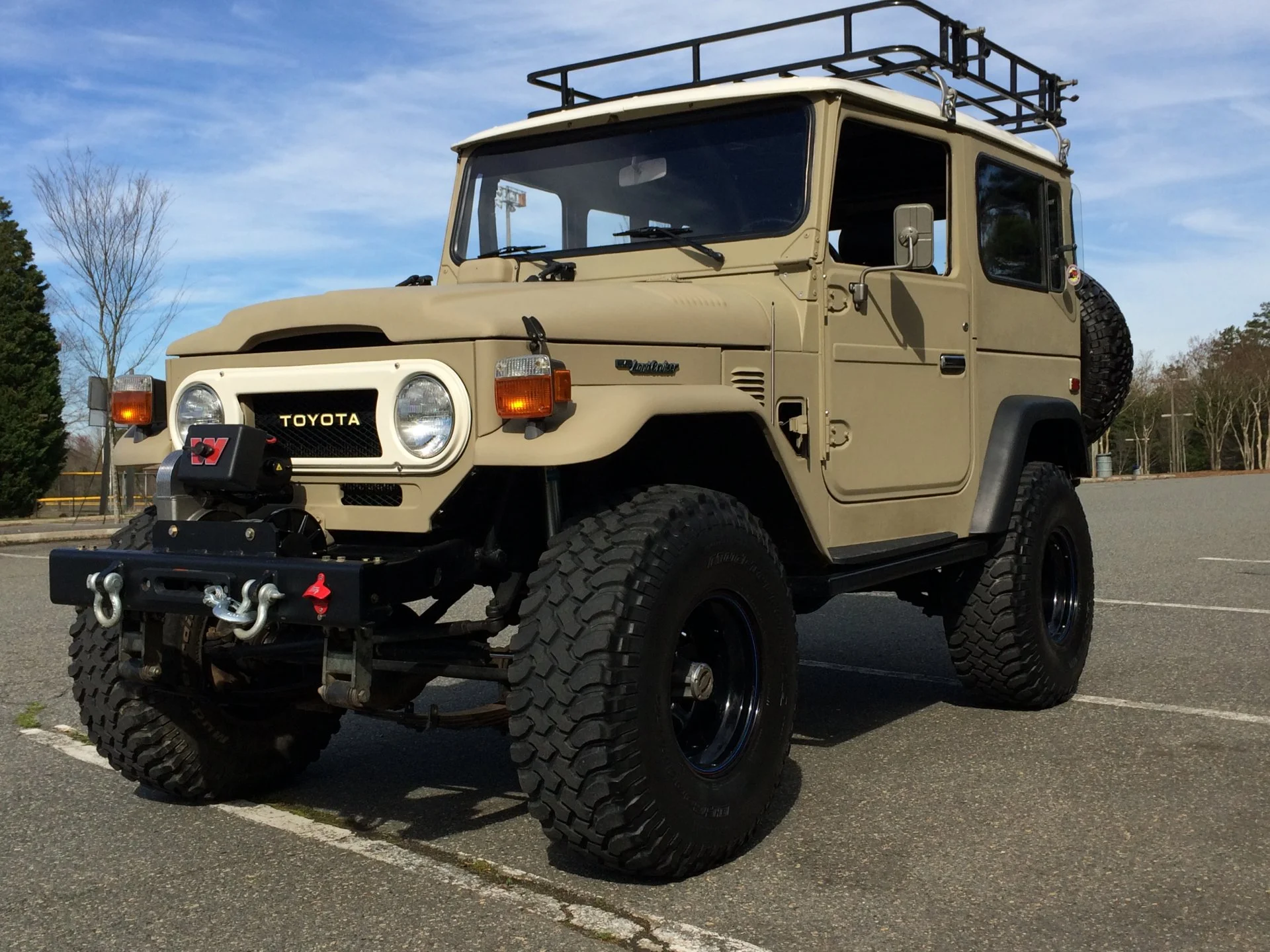

I did some metal ones to mimic the rare JDM-spec ones, but I shifted them up onto the side of the tub vs extending downward. They're bolt-on/removable, they just attach to the inner lip. Fairly simple design...could make it as wide as you want, but I kept mine to about 1" as I'm running 255s.

Hey, those look fantastic. You put a lot of work into those. Thanks for posting!
I'm glad I tried making them...didn't originally plan on it, but had a spare week while I was done with the main bodywork but paint was stuck in shipping from the warehouse.
Figured I didn't' have much to lose, and it was a fun project to improve my metal-pummeling skills. 😆
Not sure if you could do something similar with a cut arch...possibly so, especially if you don't make them removable and just get to welding.

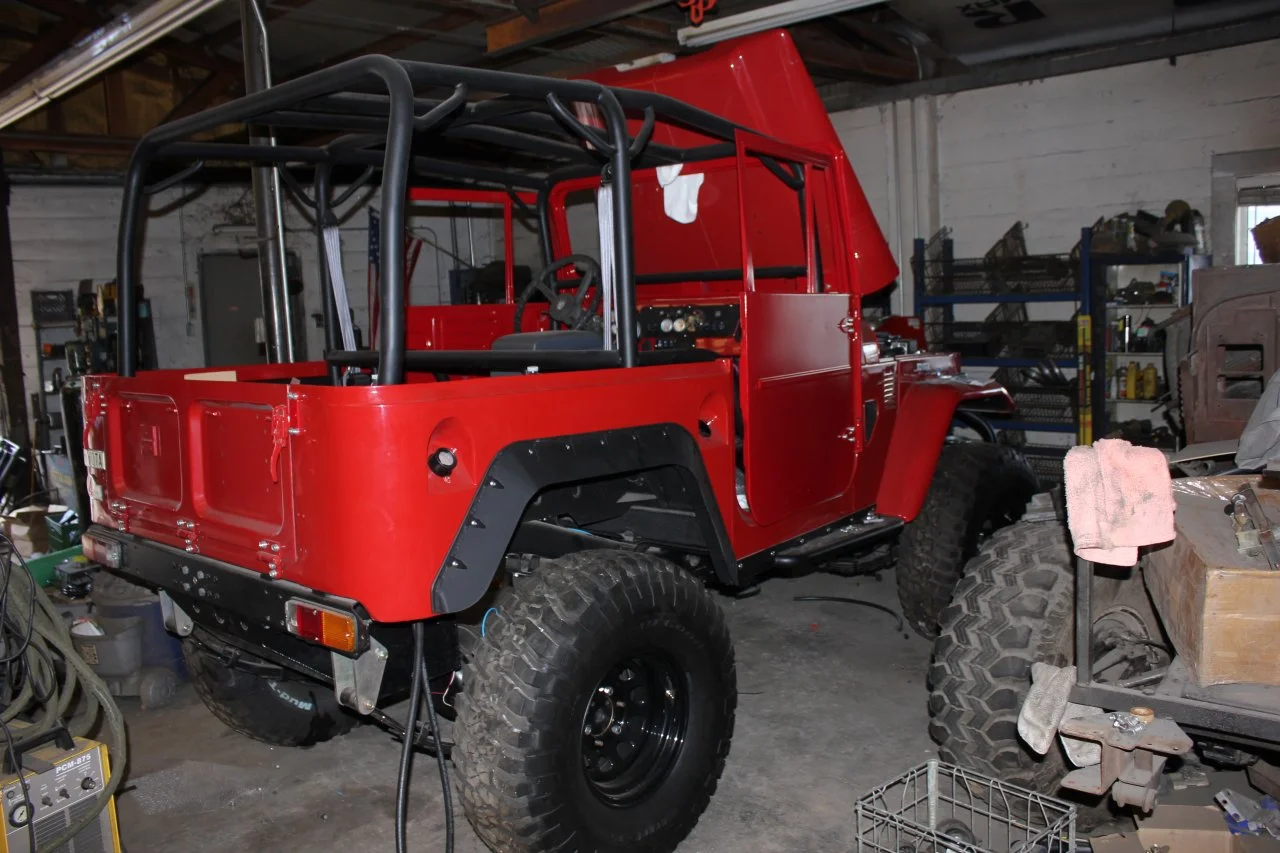

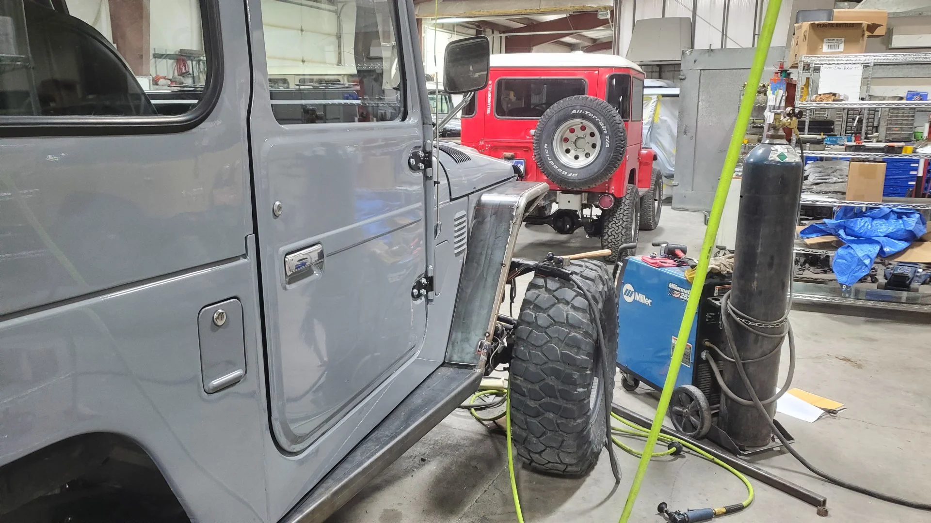

Test fitting some aluminum flares that the head fabricator at work whipped up (not for my build). I'm probably going to make some similarly styled ones.
Here is how they turned out.

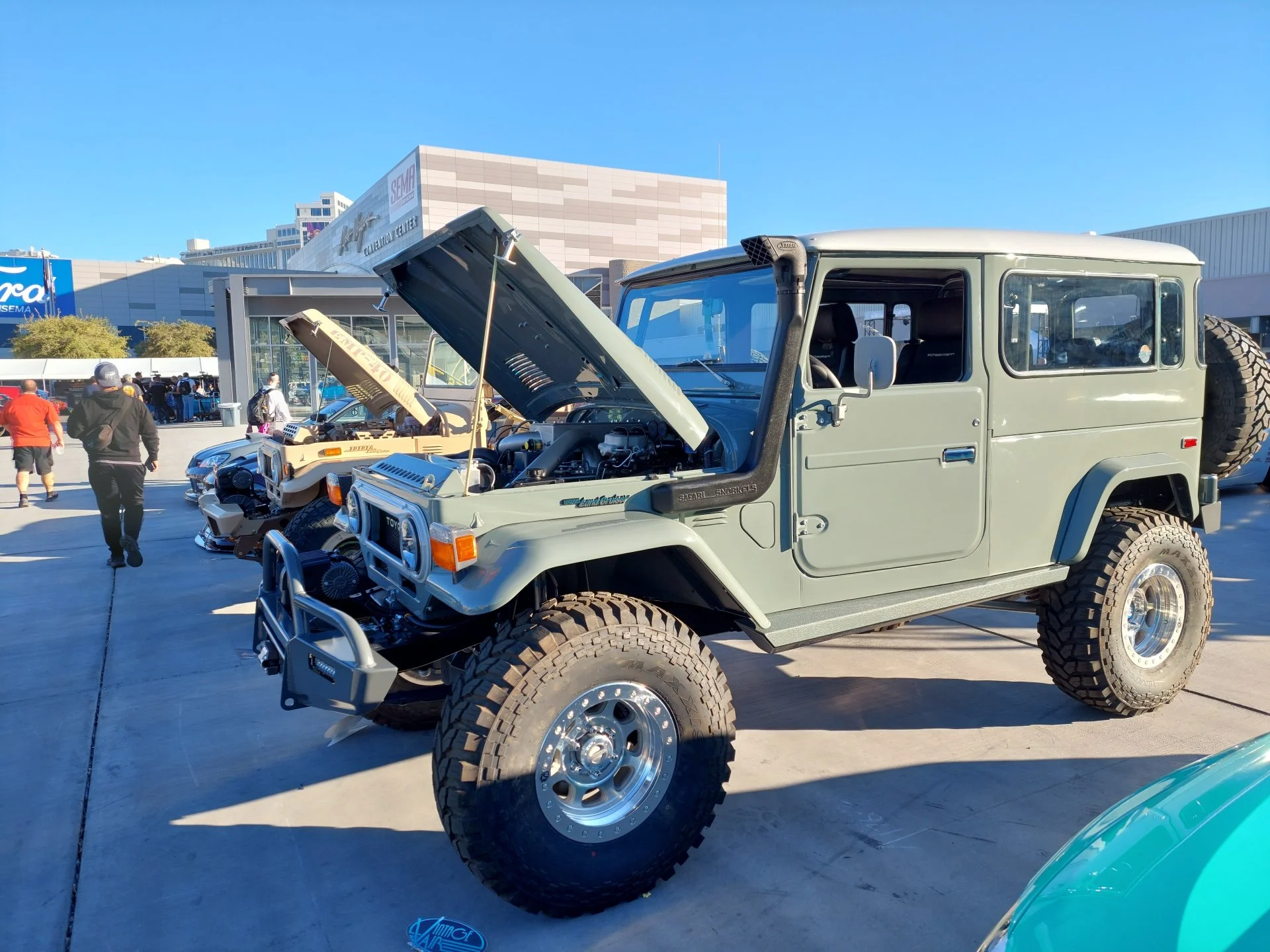

Had to dig a bit, but there's also the @Fast Eddy un-flared flare...but well suited to cut arches not needing wider coverage:

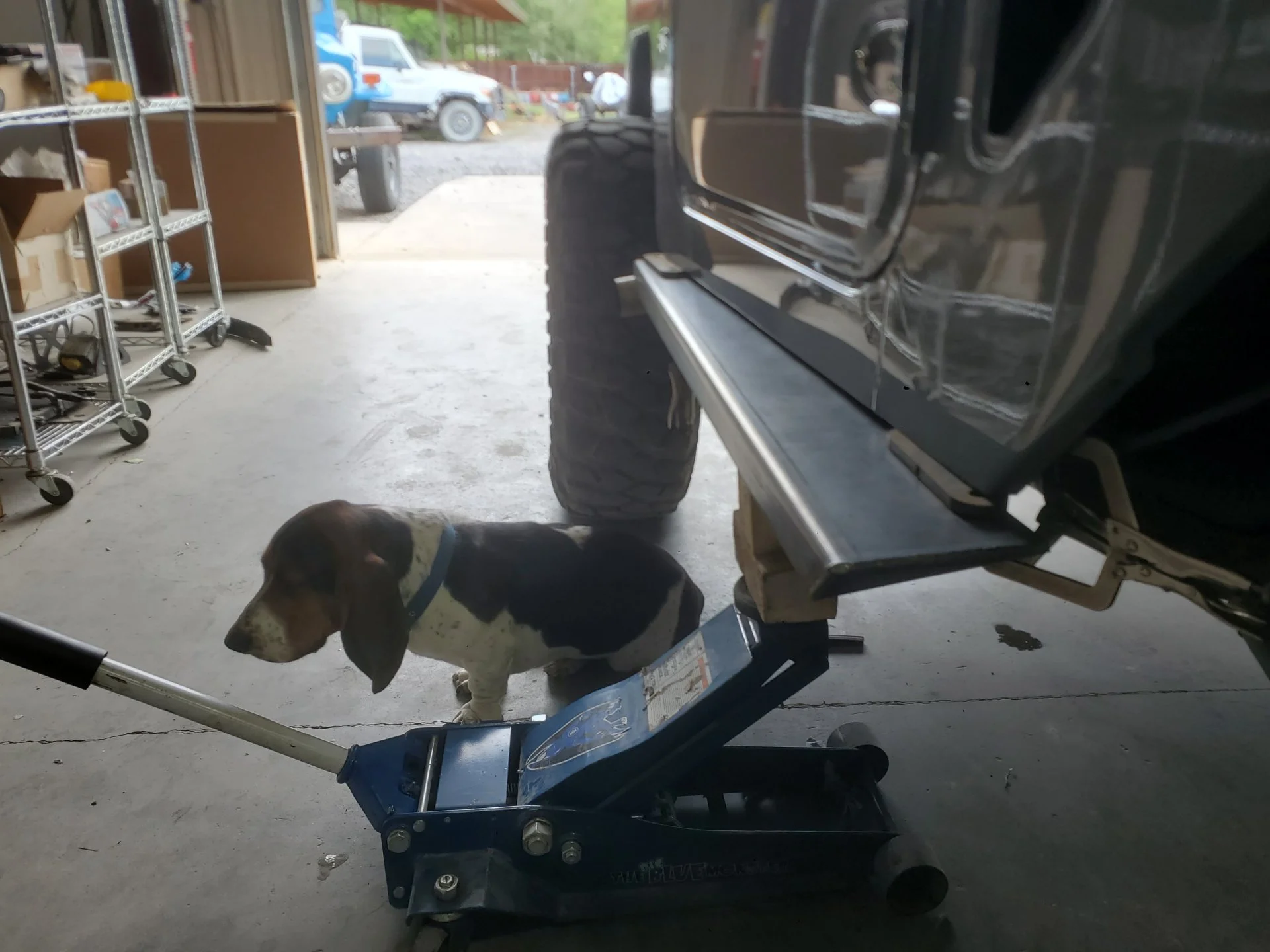

Is that boxed steel you used for running boards? If so, what dimensions and wall thickness?
Not fully boxed, but 3/16 sheet plasma tabled out and folded on the 200 ton press.

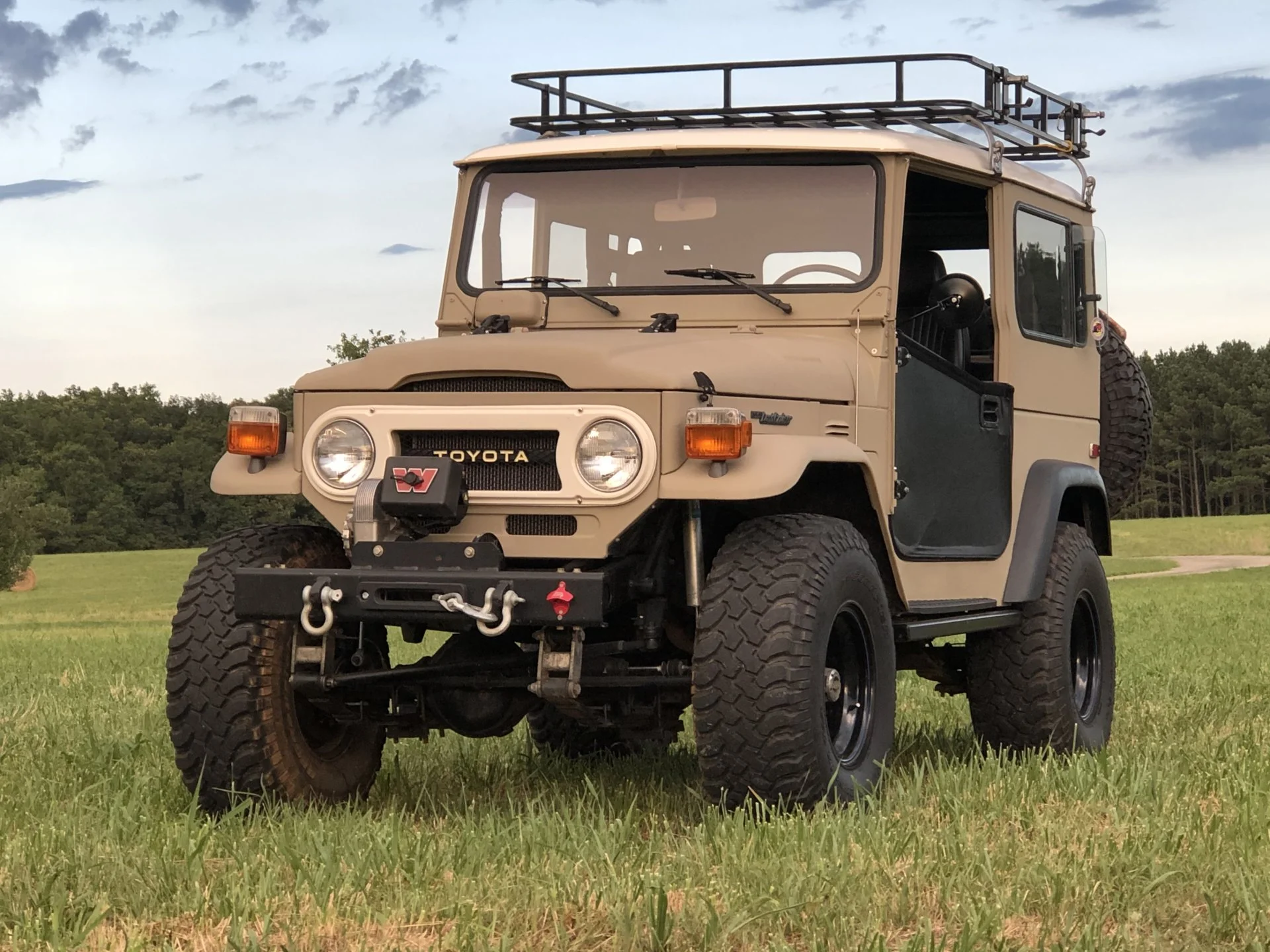

@roadstr6 Did you have to modify anything on the flares to make them fit? Did you have to cut any of the body? How do they mount? Can you share some more pictures? Are you still happy with them?
The body of my 40 was already cut with a set of the old Specter rubber flares installed. The rubber flares were torn and looked terrible. I just fitted the Heep flares up to the outside and scribed through the existing flare bolt holes with a paint pen. Drilled the mounting area of the Heep flares and bolted them on with stainless screws and nuts. I did end up cutting a little of the extra length off the ends of the Heep flares. Just used a razor knife and smoothed the edges with a little 400 grit sandpaper. I am happy with them. Been on the truck for six or seven years now. No more pics, sorry. Truck is in storage offsite at the moment.
