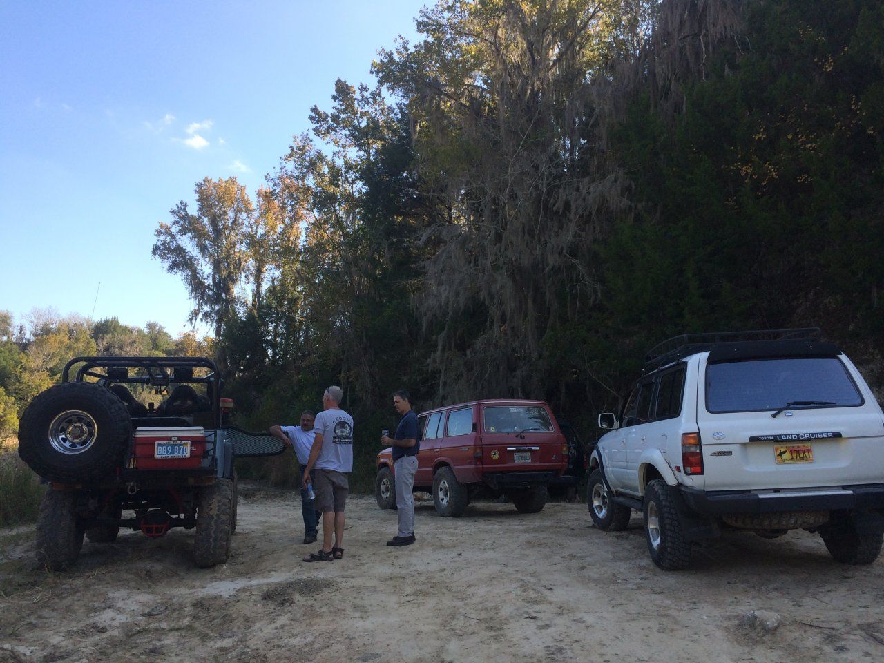

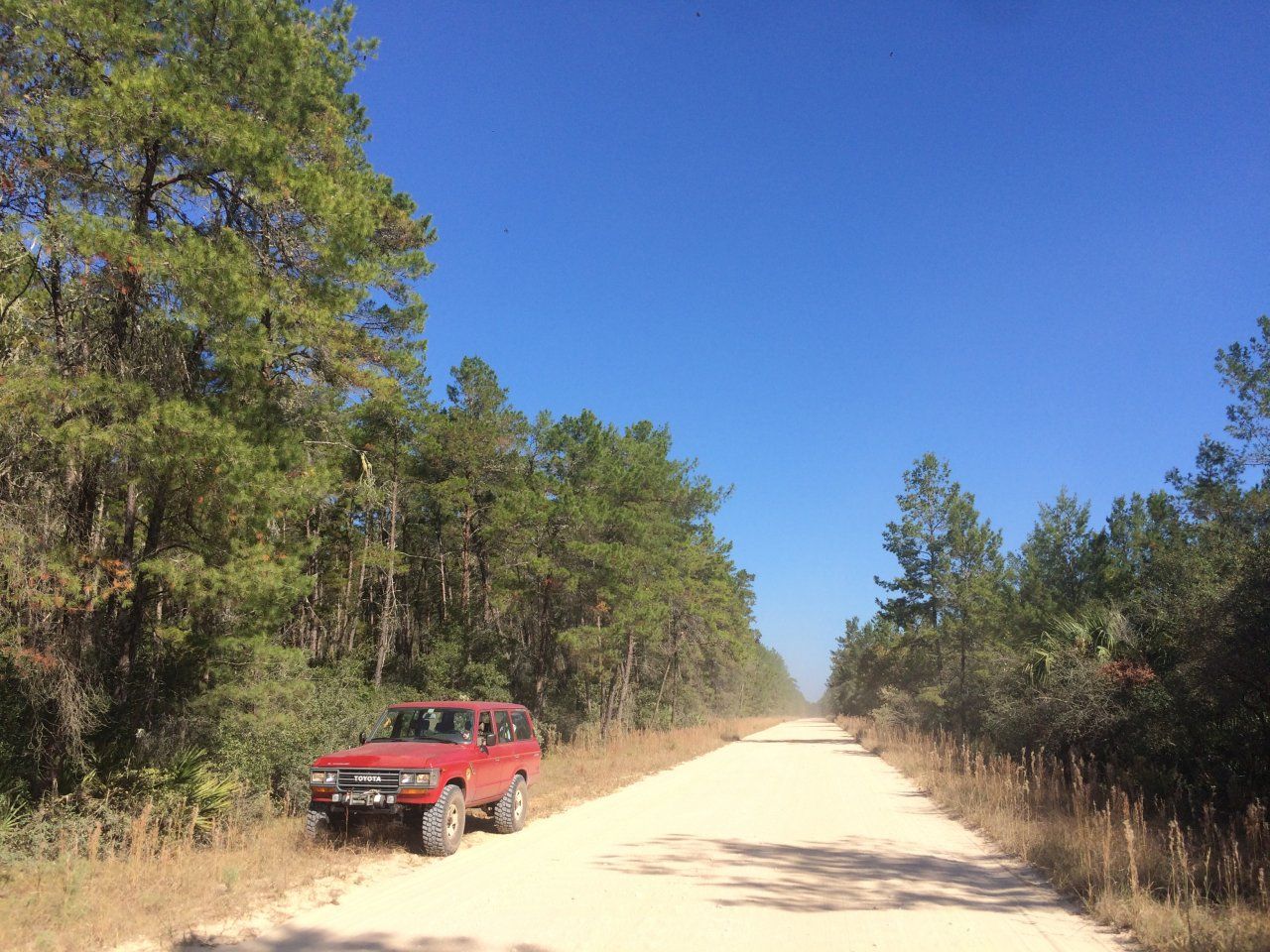

Spent Saturday morning tooling around in the national forest for a few hours, easy sugar sand roads just nice to enjoy nature, then headed over to the off-road park our club frequents. In between that trip partly out of laziness and partly out of curiousity I left in 4WD and got on the road, and went faster and faster, and the front driveshaft I did went 70MPH with no vibrations!!! I was blown away. I probably just got lucky :lol:
Anyways. Here's some poser pictures as no one got any pictures of me on obstacles :doh:
I had it on some rocks and some good hill climbs, it's F+R locked all the time so it makes me look like a good driver. Kind of like cheating.

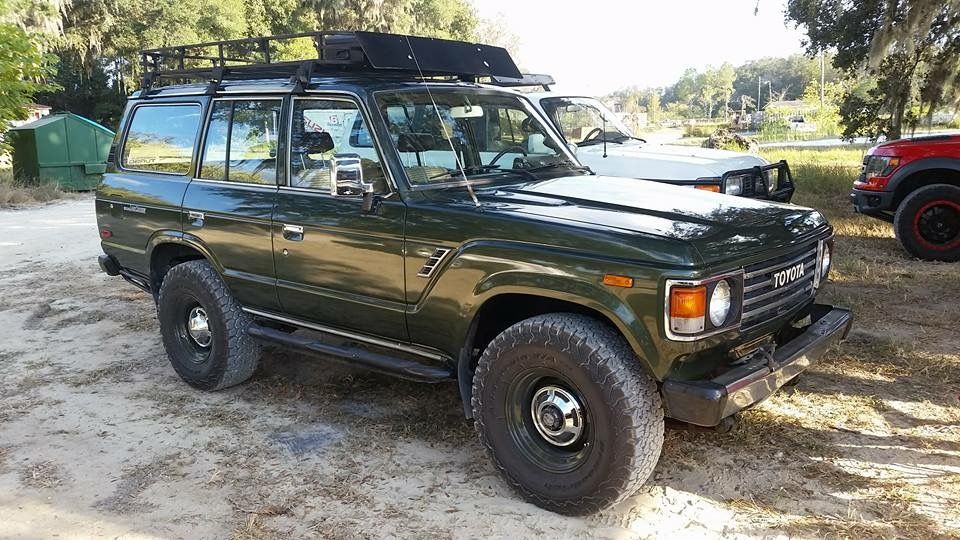

my $0.02. 35's seem to look and perform best on SOA using old saggy springs. When you AAL old saggy springs, or buy all new springs, 35's are not the right look IMO. I think the look you have right now is perfect, 35's w SUA so try and keep that same wheel well filler if you can. If I were to do my SOA again, I would have not done AAL's. My truck sits up a little too high and has a little more body roll than I'd like running 35's. The overall wheel well opening to tire is too much IMO. I'm in the process of going to 37's, just saving $ at the moment.
The plan is use my worn-out 2.5" lift rear springs in the front.
Ya Matt stay away from AALs unless you want to look like Shaquille O'Neal wearing a size 11.5
