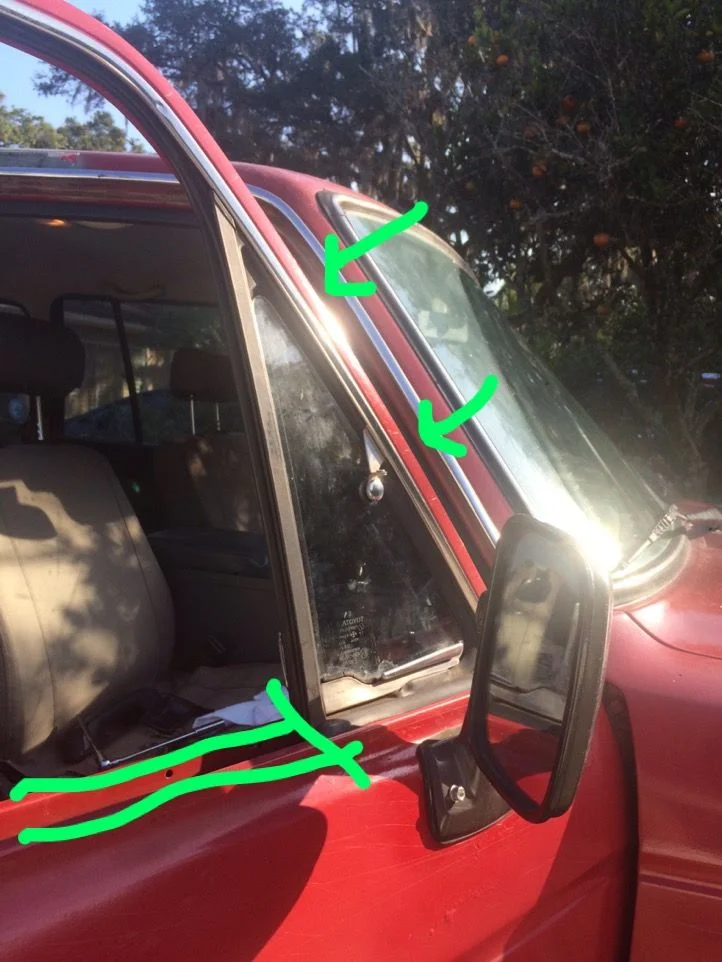

So the only big issue I ran into was that both my right-side main glass and regulator didn't play nicely with each other. And the main glass side to side had different mounting methods, the left side has bolt tabs like the normal front glass, whereas my right side glass had a slider tab like the rear windows. See picture.
My original plan was to weld bolt tabs onto the glass channel but ended up modifying the regulator, making it into the style of the rear doors. Unfortunately I didn't take any pictures of this process as I had no idea if it would work.
I'm the end it works, it's not amazingly smooth so I'd like to source another piece of glass and regulator eventually.
As for getting the wing in, in needs to be screwed in to the forward door frame however two of the three required holes are not present, it's lower-most hole intercepts with one of the exiting holes used to hold the original frontmost window track in. The green arrows show roughly where the holes need to be drilled, I only drilled the uppermost hole and everything is fine.
The doorsill weatherstrip needs to be cut on both sides of the glass, I don't know how it would look if you are still running the chrome strips. Luckily I'm not so its a quick slice with the Dremel.

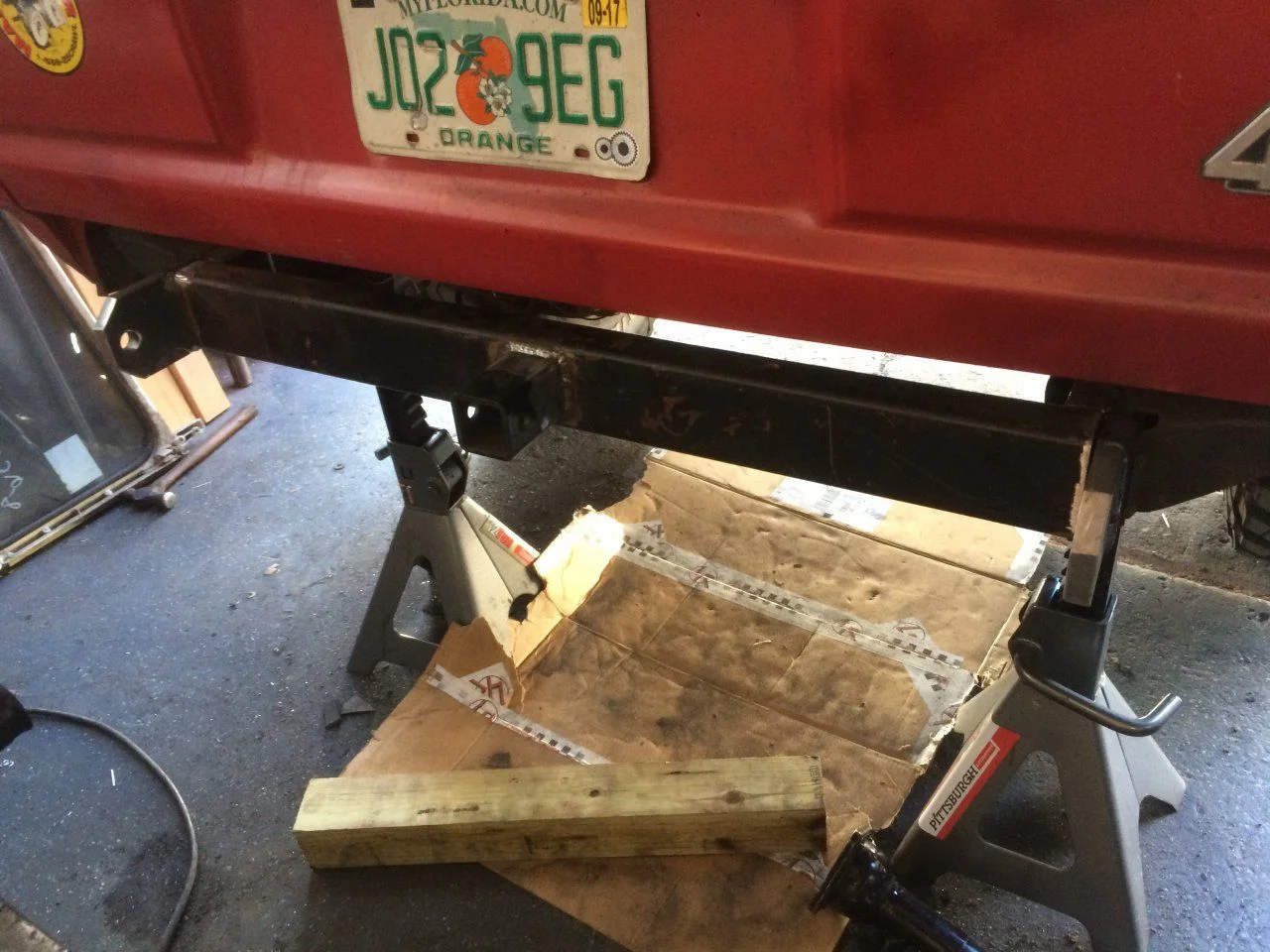

I'm officially starting my rear bumper/crossmember/hitch receiver/frame boxing/inner c-channel repair/recover points.
I want to relocate and french my rear shackle hanger for the 63" springs which means I need to box the frame, which means the notorious rusty inner c-channels need to come out, and my existing hitch receiver hangs down too low, and I want quarter panel armor and recovery points.

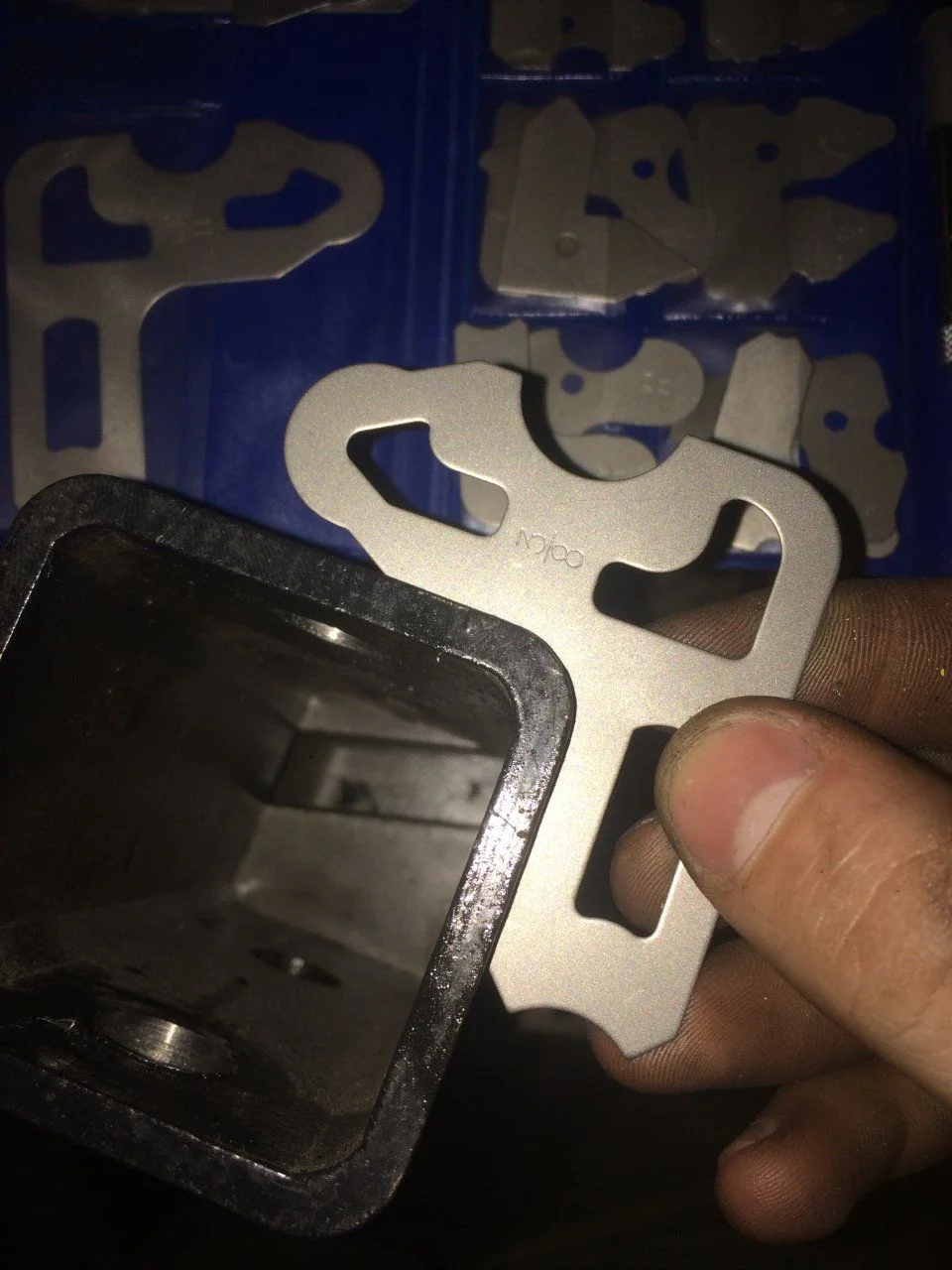

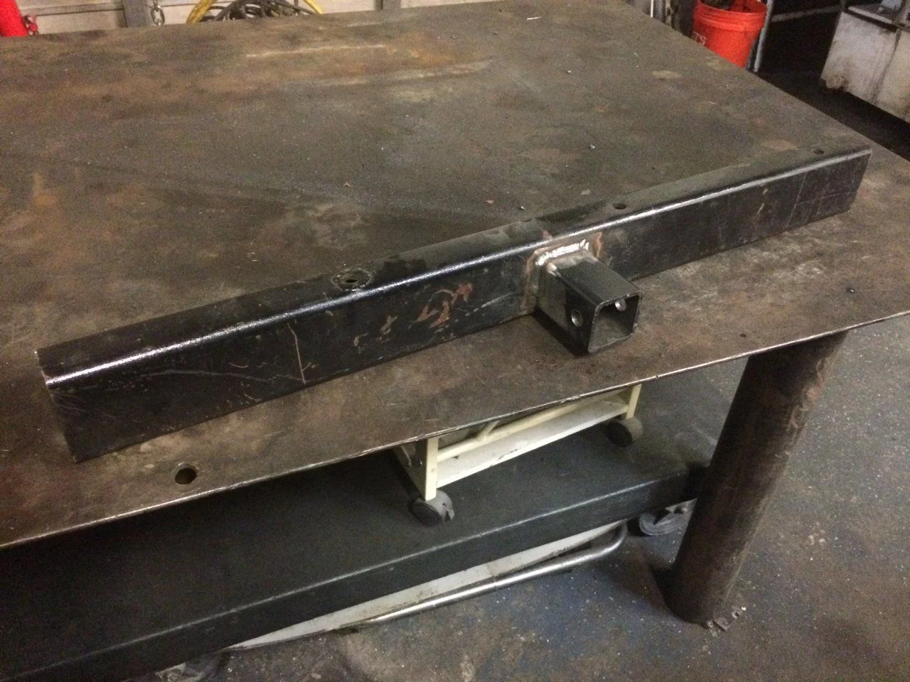

Take some 2.5"x2.5" and drill a hole in it
Check the radius of the corners
And sink it into the main bar (drill four 3/8" holes and cut to each with a grinder, end mill woul work too but I was lazy)

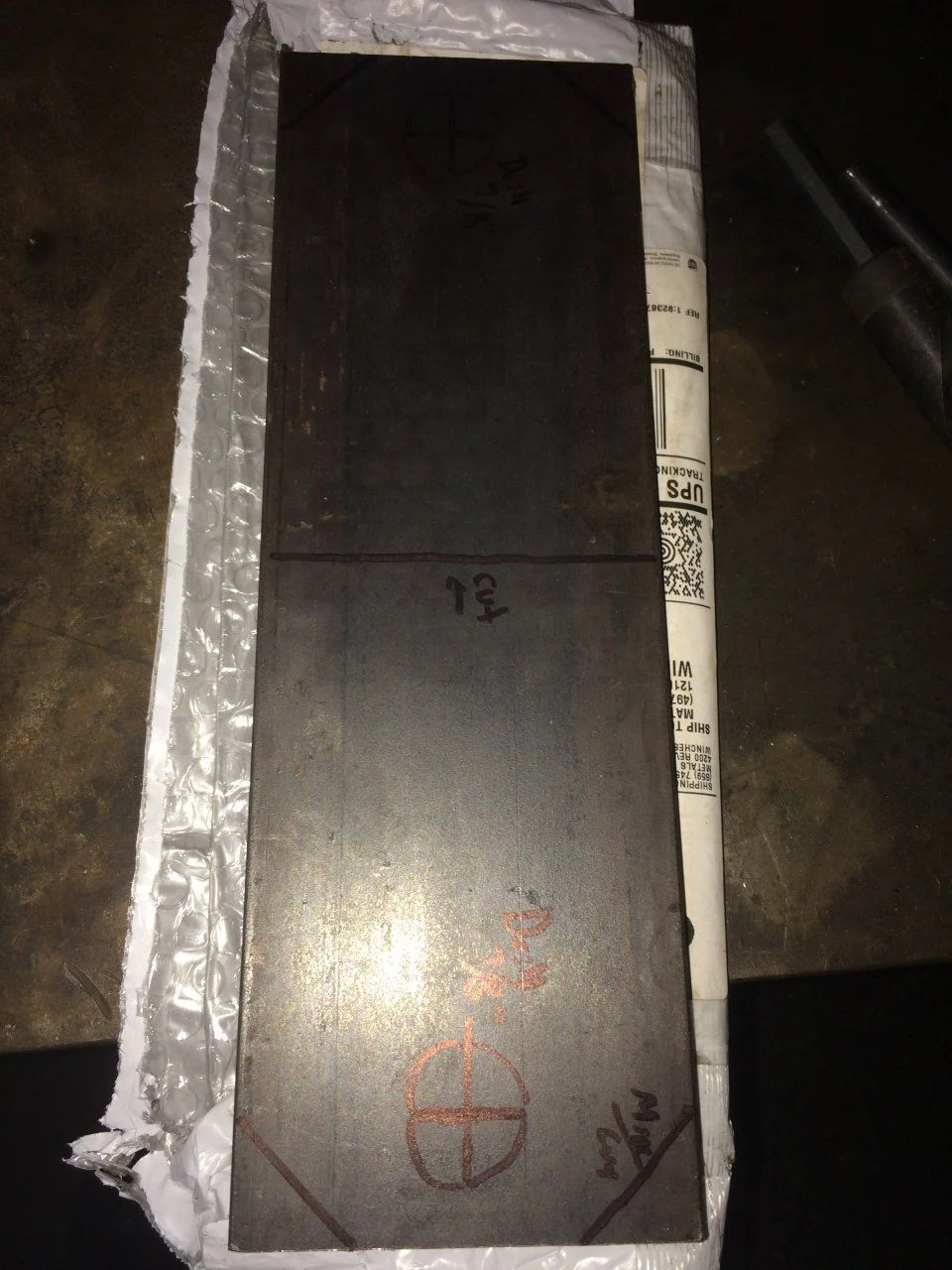

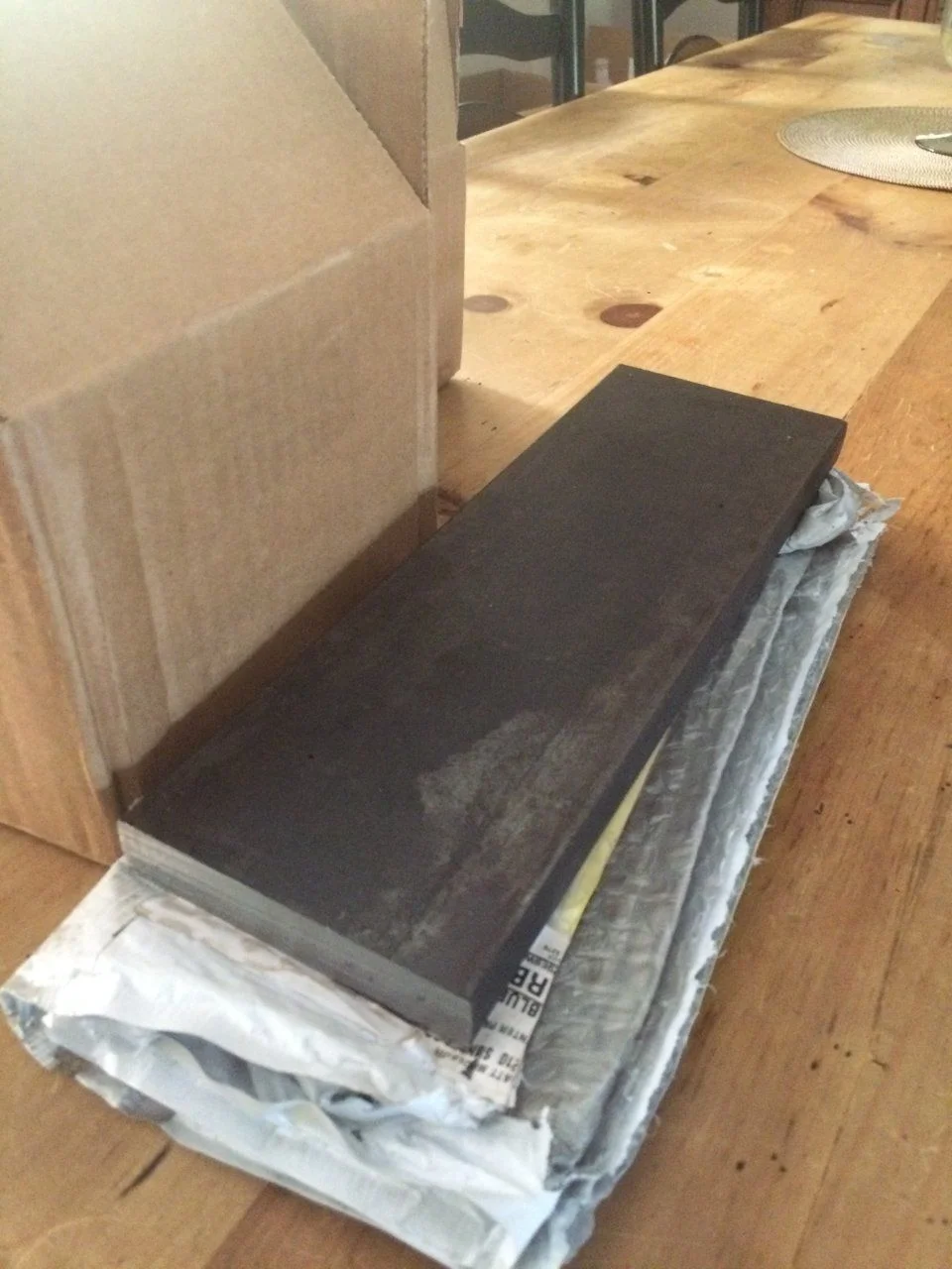

Today I got my 3/4" thick bar (4" wide) from onlinemetals.com (convenient!)
Doodled on it a bunch
And drilled two 15/16" holes then cut the corners off with a grinder. Not too bad.

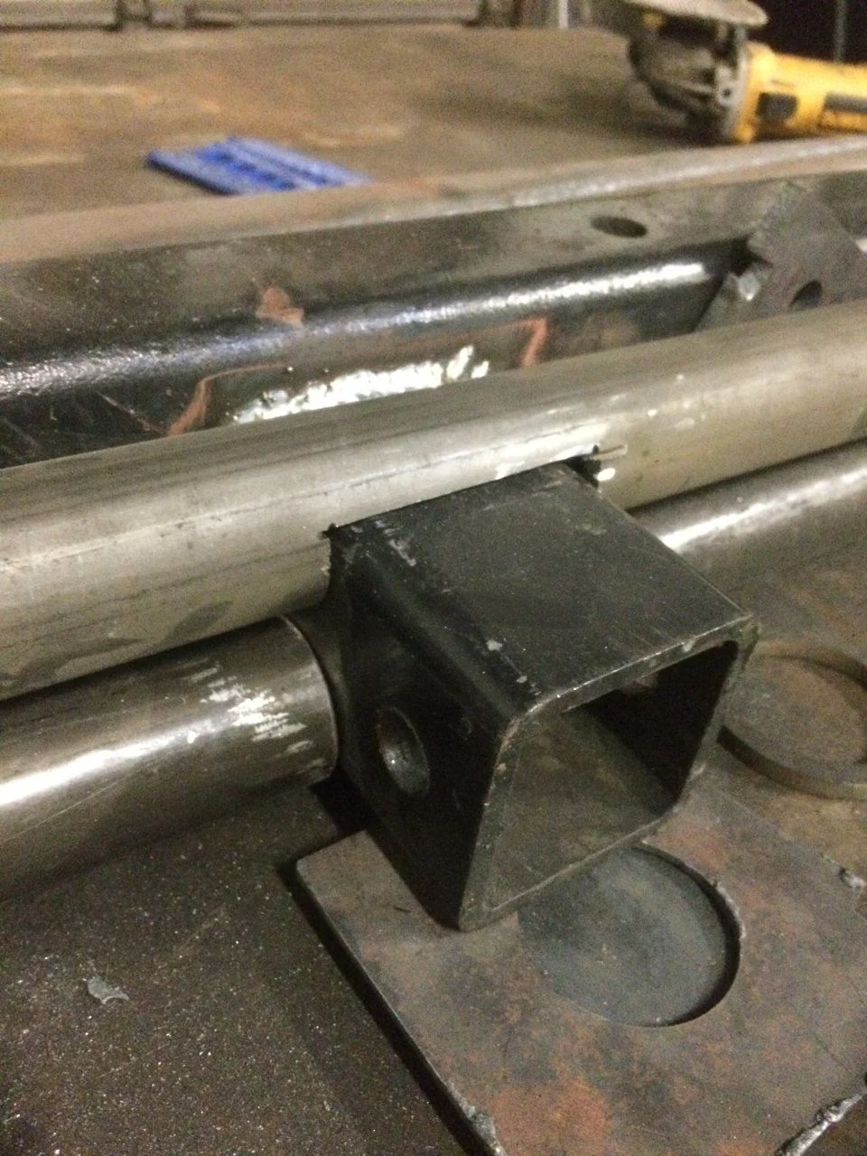

Tubes are 1.5" x 0.188" DOM
Getting the upper tube to wrap over the hitch receiver was kind of a pain to do but I think it will look nice
So this is what I'm shooting for except mine will have a 1/4" wall 2x4 hiding behind it. And I'm going to actually bend the tube instead of using cutting and welding pre-bent sections :rolleyes:

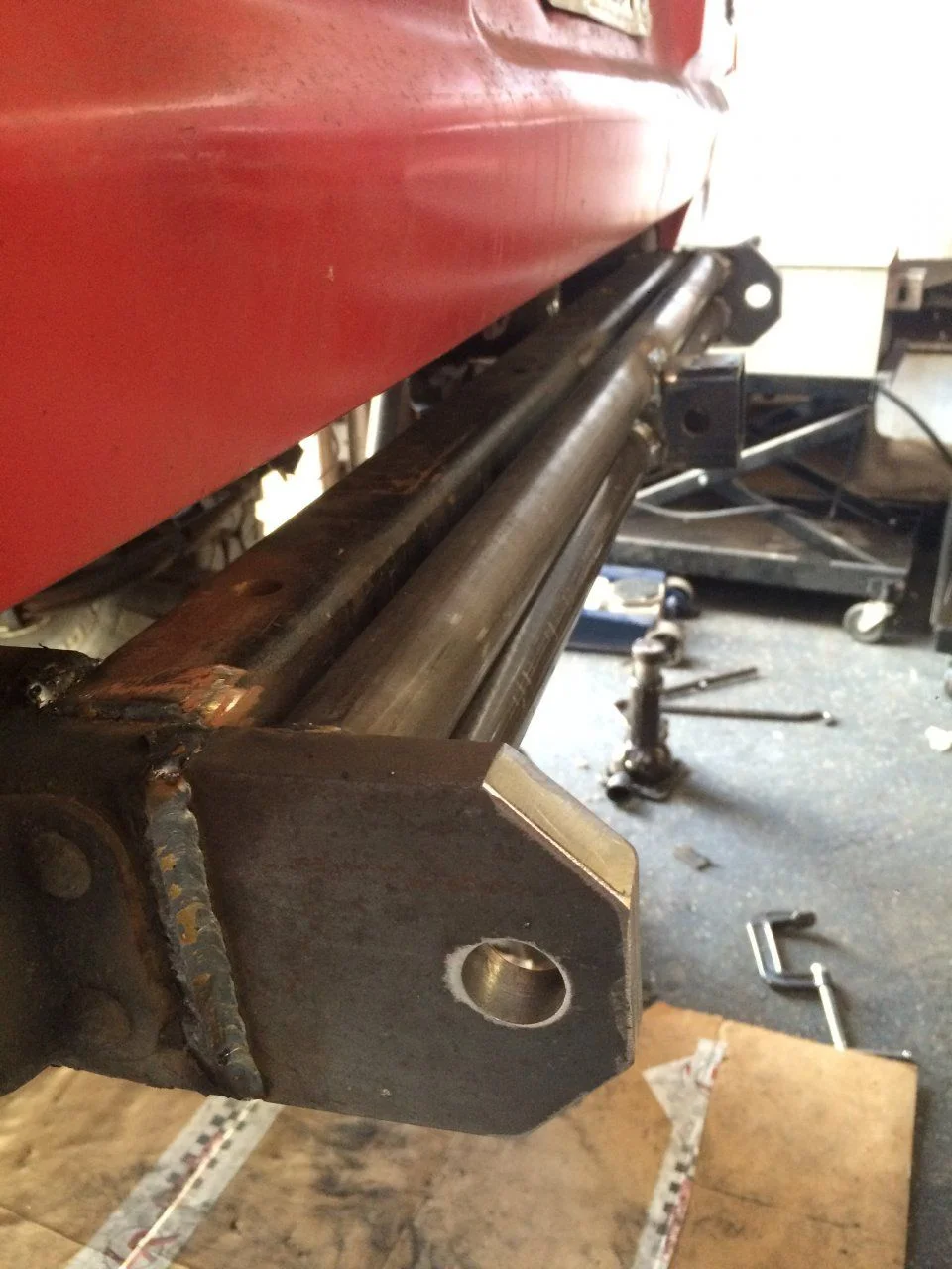

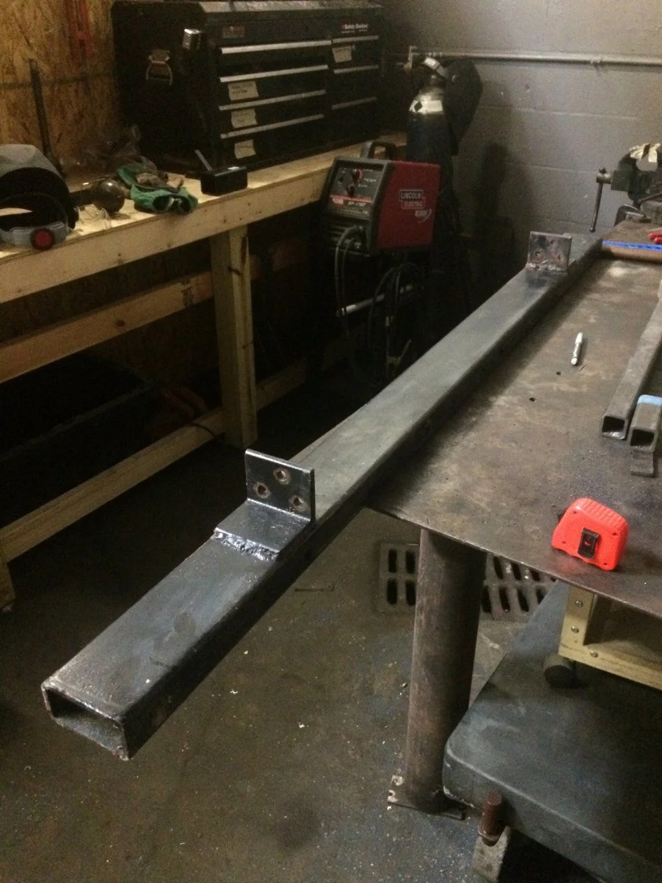

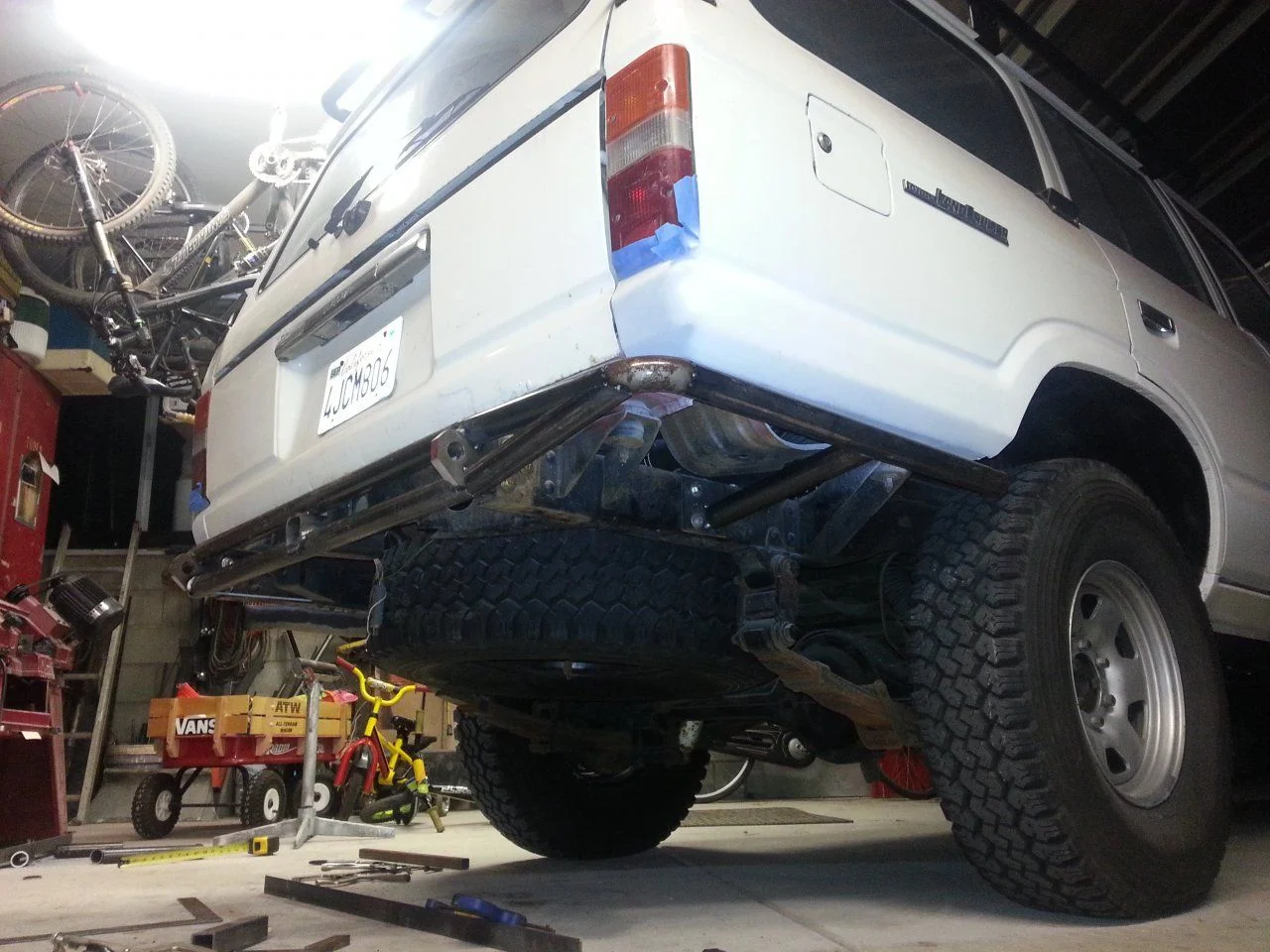

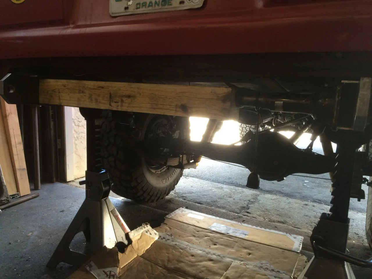

Chopped the crossmember and got it all welded in today. Started with the recovery points. Then had to spread the frame (it bowed in about 1/2-3/4" when I cut the end off). All I had was the factory bottle jack and a 4x4 and it actually was really easy to spread. Then I welded the main bar in and the decoration tubes.
Looks great bro!!! I'd recommend coming up with a way to bolt the side rails on instead of welding them on. They will undoubtedly get bent by someone or something, no matter how thick they are, and it'd be nice to be able to just unbolt them to replace.
