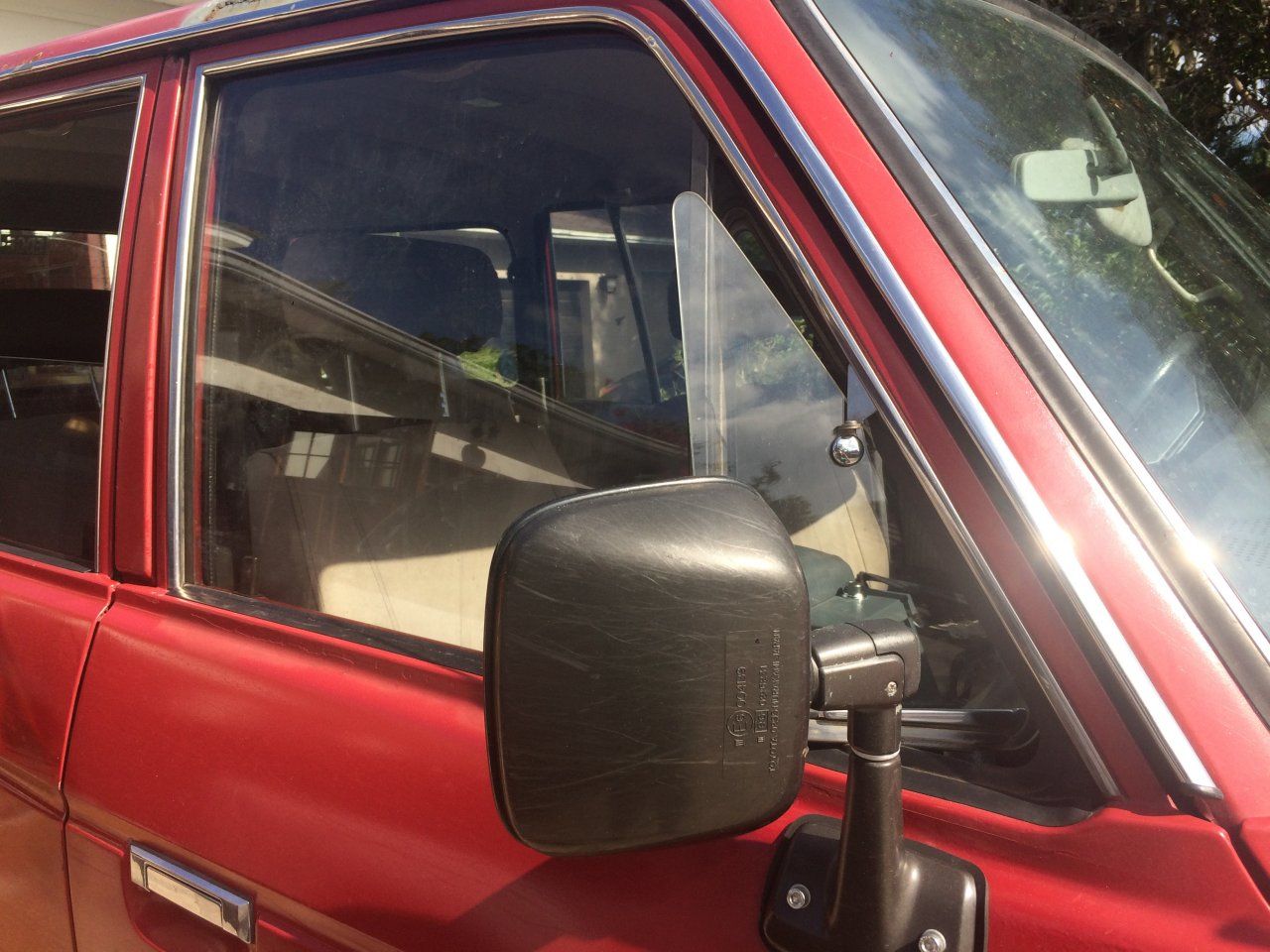

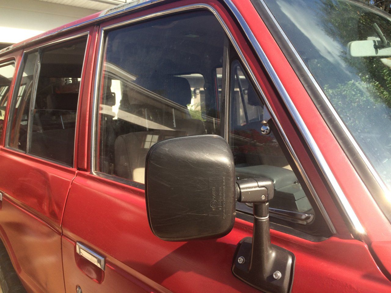

Those look sharp....
I gots lots of stuff I need to install in my rig....
Including a set of those wing windows....
How hard was the install?
Royal PITA. More on that later.
