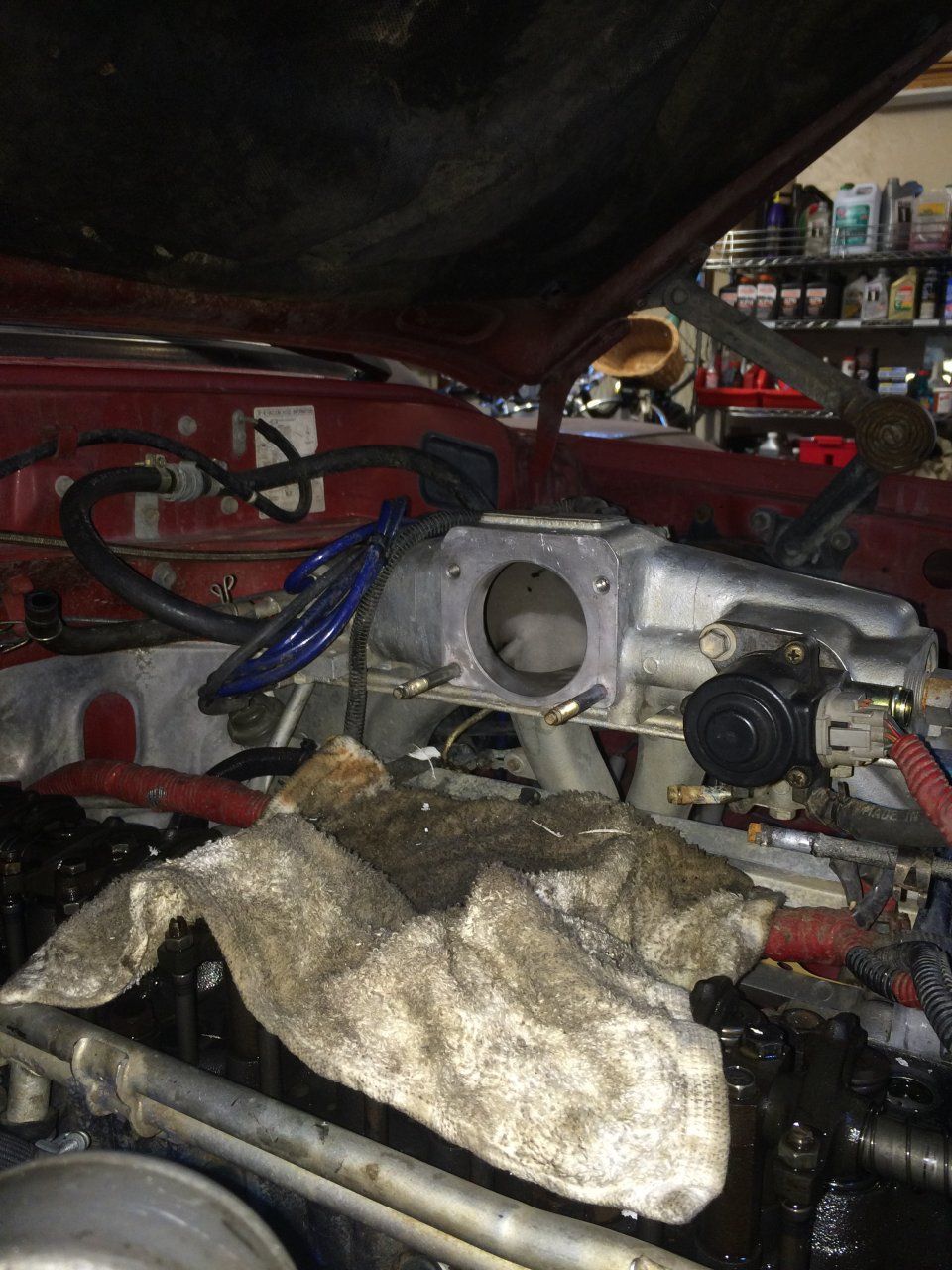

Put in a bunch of hours late last night. New plugs, wires, cap, a bunch of vacuum lines and caps, the water hoses that go to the throttle body and IAC, new throttle body gasket, adjusted TPS to spec, pulled the rocker assembly and checked all the head bolts, and checked the valves.
Runs awesome now. The exhaust note calmed down too, it's far tamer.

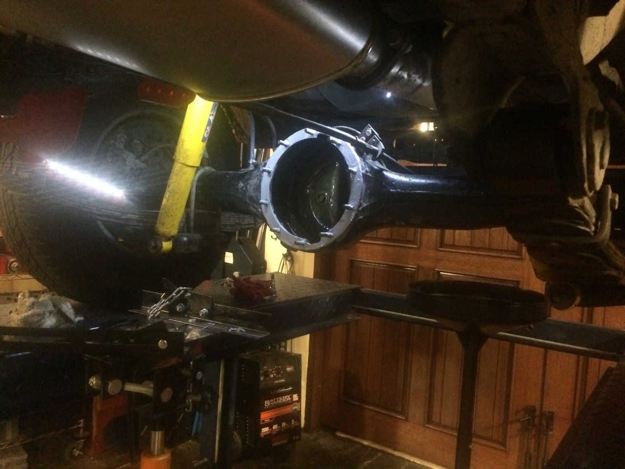

Good work once again Matt. I was looking at the image thinking, how did he pull the third member without taking off the inspection cover, and then I remembered, Full Float! Sweet.
Yeah, full float 80 rear was definitely my favorite modification, that position has now been replaced by the NV4500. I still love that I can take the diff out without taking the wheels off.

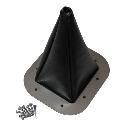

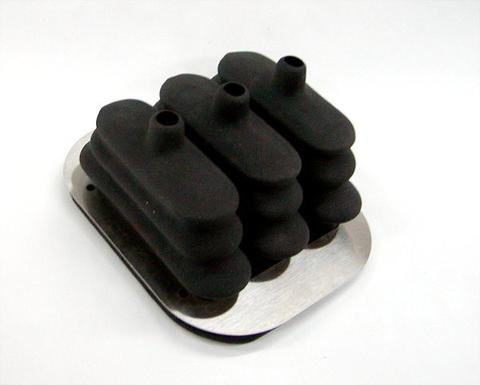

Ordered some fancy shift boots from JB Fab, so hopefully I can get my triple sticks installed and start testing them. I also need to do some sheetmetal work around the shifters, right now it's all duct tape :hillbilly: Look forwards to that this weekend.

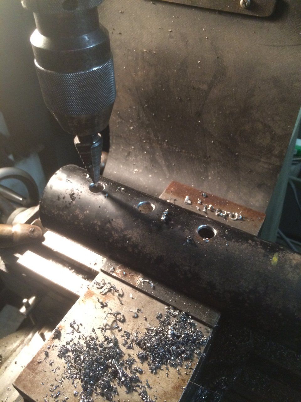

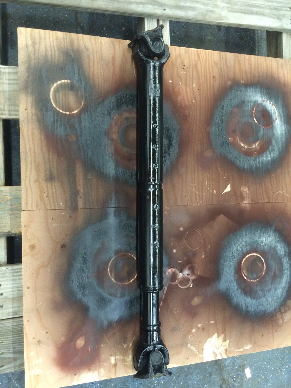

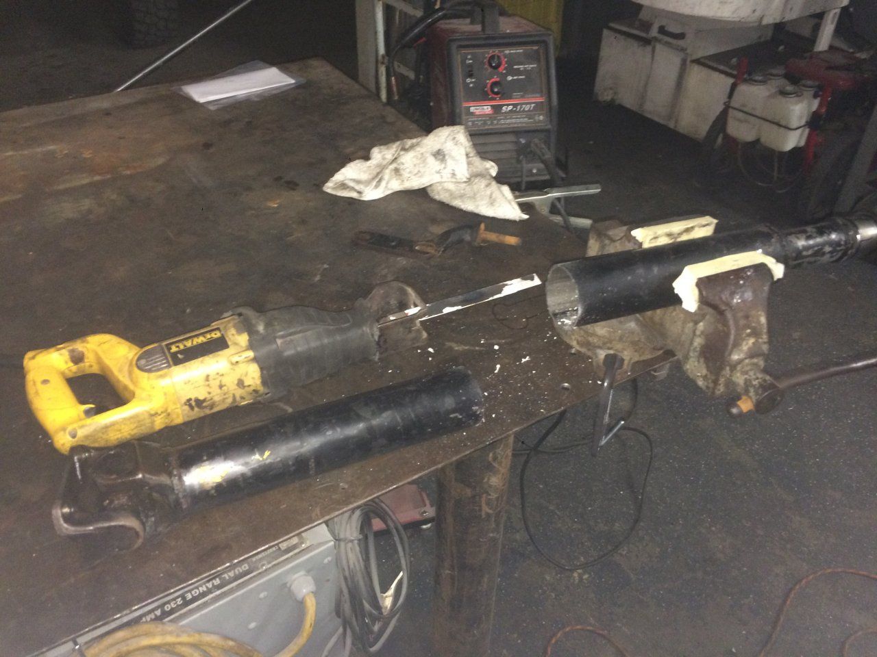

Front driveshaft is done, total cost $10 for the tube. Cut it in the middle, put in the mill and drilled some holes for rosette welds, slid a 2.5" tube (.08" wall same as stock) inside, (the ID of our driveshafts are 2.5") and welded it up. Not worried about vibrations as I never run it in 4wd on the road because of the front locker. And usually not more then 10-15mph off-road. No snow here either.

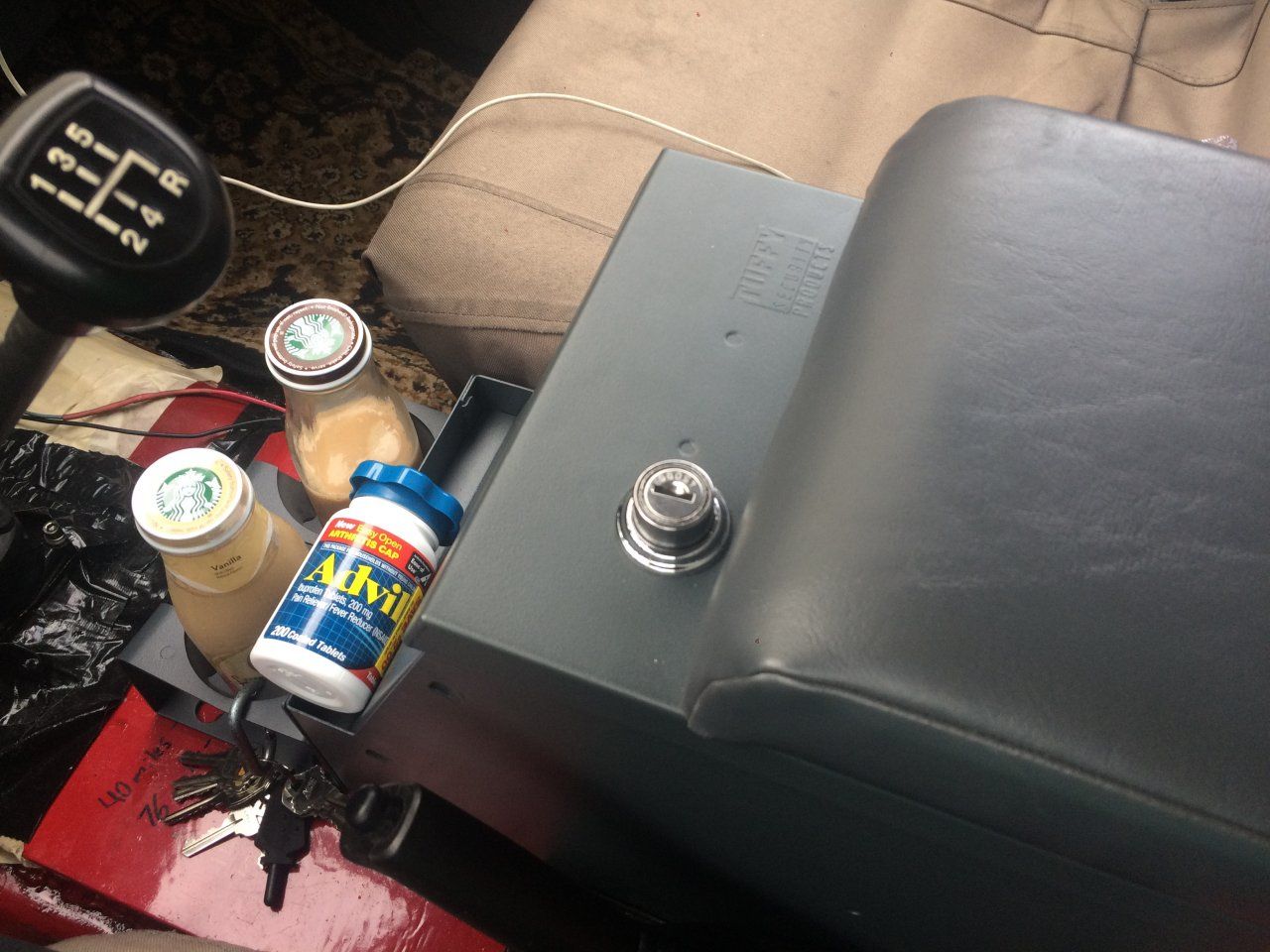

Got my Tuffy console mounted, love this thing. Because of my raised transmission tunnel the armrest sits level with the window sill so it feels like I'm in a throne while driving :)

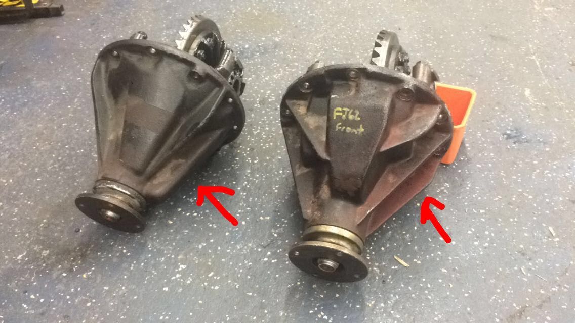

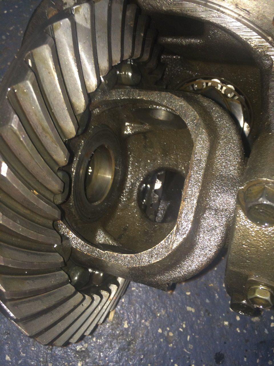

Also when I was swapping my rear diff out I noticed something I'd never read about before, the 80 rear diffs have what looks like an oil passage to the pinion bearing that is absent on the 62 diff.
After I did the 80 rear axle swap last summer I was running and 80 rear diff in the front and the 62 front diff in the rear, the 62 diff broke, I ran it for a whole year with a bad pinion/bearing thinking my driveshaft/geometry was bad, now I have 80 rear diffs front and rear. Which is good because I like that oil passage.
Interesting find, but I'm not sure that's an oil passage. Wouldn't make sense because oil isn't pressurized in the differential, it's only splash lubrication. The drain for the pinion bearings is in the bottom of the carrier. Do you have an extra 80 carrier you can take apart to look inside?
That protrusion was definitely hollow and went to the pinion bearing.

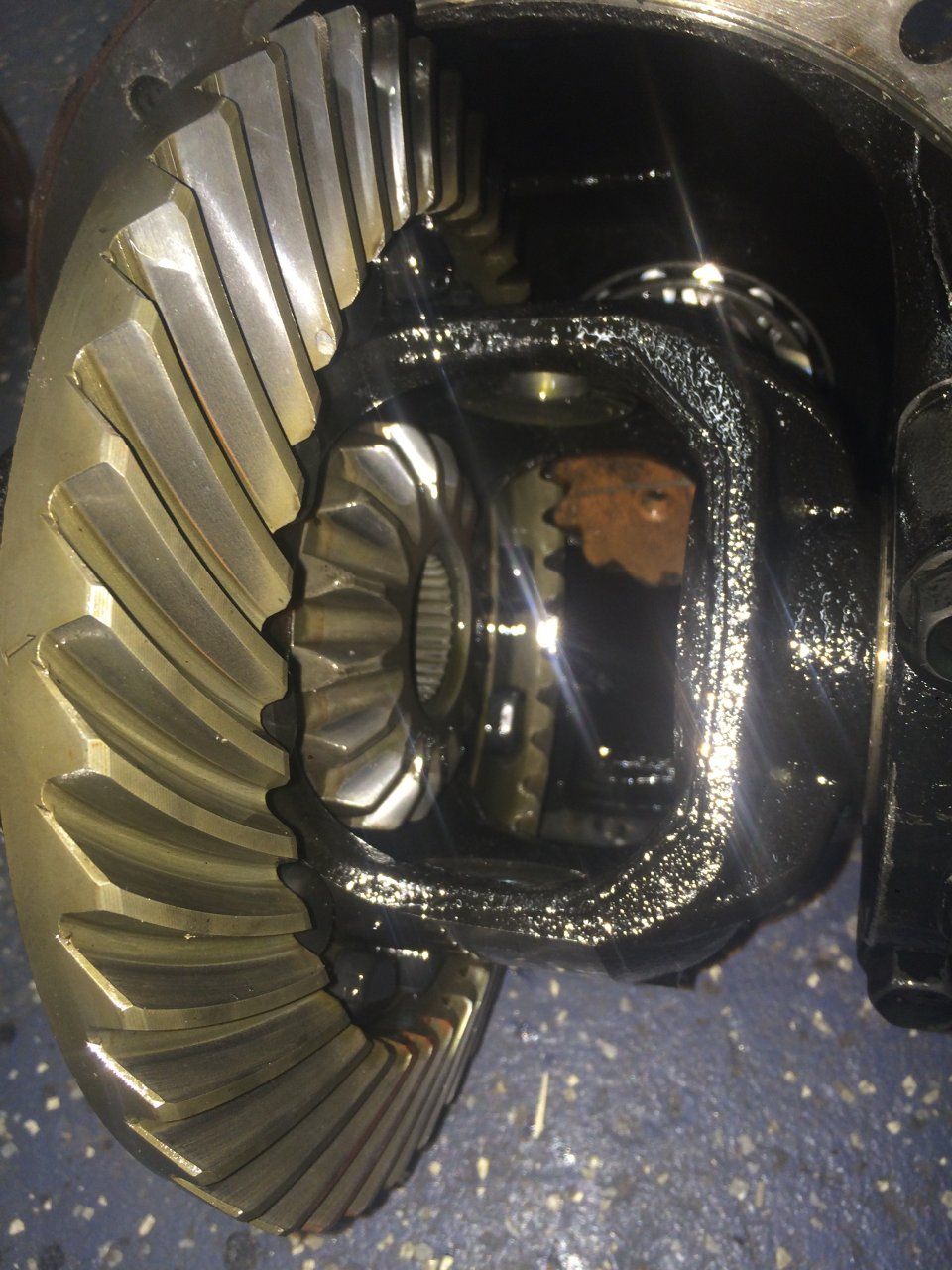

The 80 diff that was my spare is now in the truck. I did find some other interesting differences though. Look at the differences in the carriers:
Really odd, because I was pondering this just the other day. Land Cruiser housings were basically the same for decades until the 80 came out and the 80 rear is completely different. The oil circulation is different, the pinion bearing spacing is slightly different but over all it's the same size and shape. I don't know which is stronger or better. I would like to know which one circulates oil better in reverse rotation-as I am running an 80 rear in the front of my FJ60.
So it sounds like we both have the same set-up, 80 rear diffs front and rear. I suspect that tunnel on the side of the case that I pointed out is probably always full of oil (assuming flat pinion angle which I have in the rear, stock 62 front housing points it up a couple degrees).
