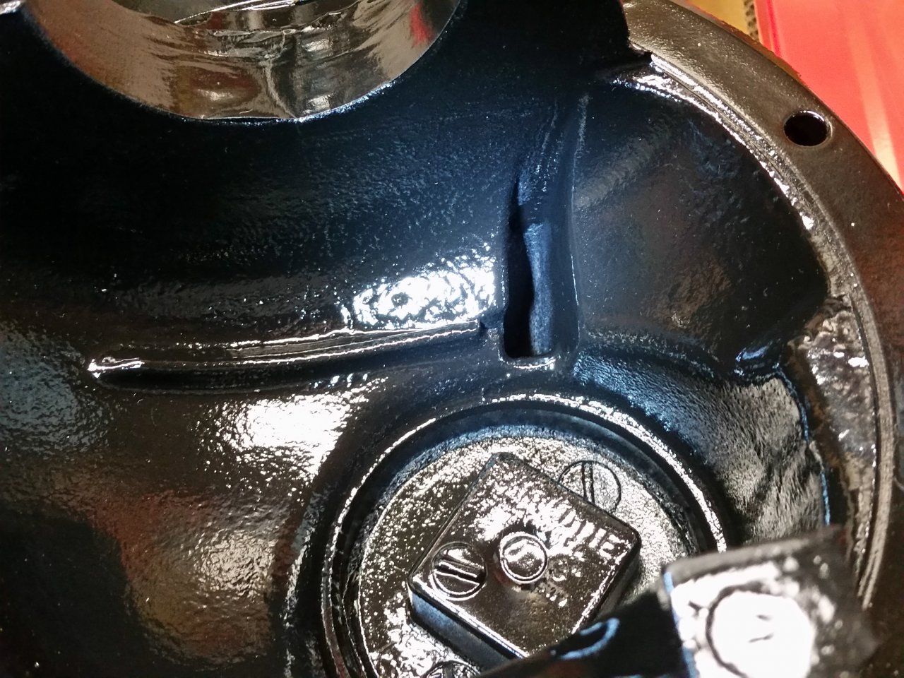

I'd like for someone who really knows to discuss oil circulation in the differential. Clearly that happens.
I *think* that with standard rotation (ie rear use), the ring gear flings oil up into the passage in the top of the case. Then gravity carries it down to the outer pinion bearing, from there it flows to the inner pinion bearing and returns to the case.
That's what makes me wonder about reverse rotation-ie front use. My pinion is tipped up enough I close the filler and add an extra quart of gear oil through the breather-hoping to make sure the outer pinion bearing has adequate lube.
If you think about it, there is no way to "splash lube" the outer pinion bearing. It's not in a spot that gets any splash, and is contained inside an iron cylinder.
Anyone really know?

Thats easy!
There are two oil passages in the diff housing.
Here is an 80 front with masking from painting still.
80 front doesn't matter. It's the 80 rear in question.
And especially how does the oil circulation work with the differential in reverse location, like running an 80 rear, in a 60 front housing.
You are overthinking it. Front and rear are basically the same design in different sizes. The ring gear slings the oil up the passage enough to lube the bearings. In both cases the ring slings oil into the upper passage and it drips through the bearings and drains back through the lower passage. No pressure is needed. and it obviously works, or you would be frying bearings all the time.

Ok, but we're talking reverse rotation. No slinging of oil up into the upper oil passage. Is there enough push into the lower passage to keep the bearing lubed? I've run reverse rotation "normal" diffs for years without problems, but I'd like to know how it works. Because it doesn't look like it should.
Should be fine.
That oil really gets moved around
In 60/62 we run 9.5" front and rear, and both diffs are the same, not mirrored. The front runs in "reverse rotation" on these trucks. If you think about it Toyota probably never intended for any of their 9.5" diffs to be ran in the front for any type of high speed or extended trips, why they put an 8" reverse-cut in the front of the 80. 60's are part time so the front diffs usually never see action on the street. Usually off-road at slow rotational speed.
@Cruiserdrew i think the conclusion is that the reverse-rotation really doesn't make a huge difference because the ring gear is slinging oil regardless.
