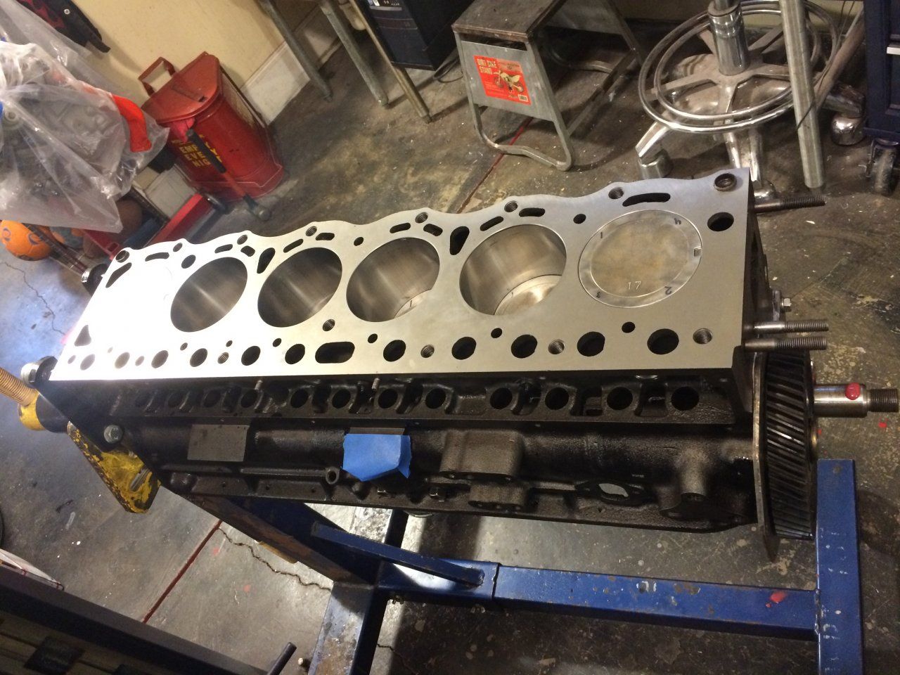

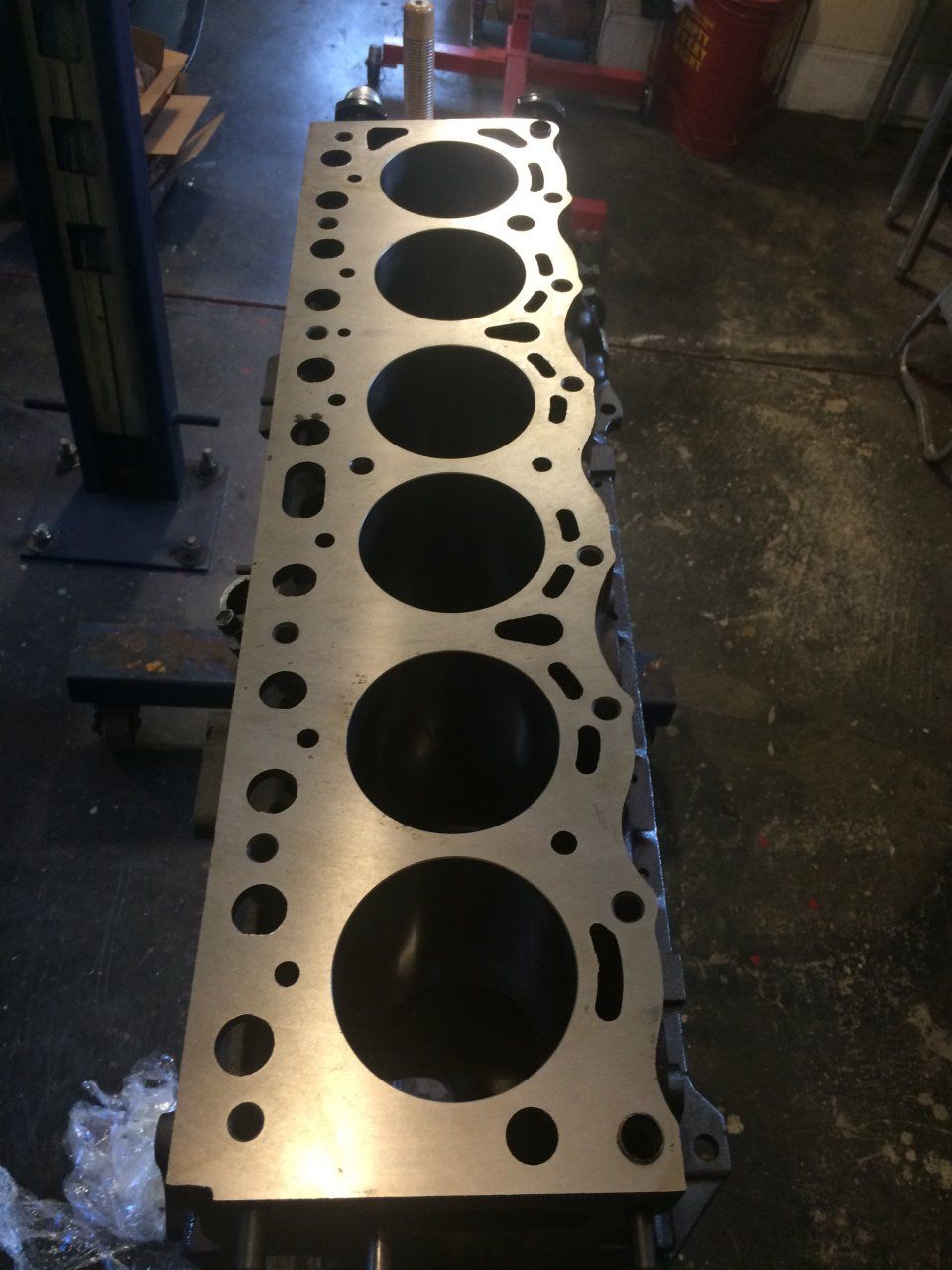

By the way, all the short-block components are done being machined and on a stand at my dad's shop. Crank is in the block already, the whole short block would be built already but I had the wrong rings, turns out there are two thicknesses, 1.5mm and 2mm. Anyways, have the right ones now and will put the short block together this weekend. Re-using the cylinder head and water pump from the last motor build.

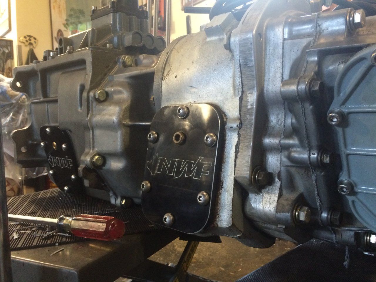

Were you filling the 203 at this plug in the middle of the PTO cover? Quantity, two quarts?
So, three quarts or two quarts?

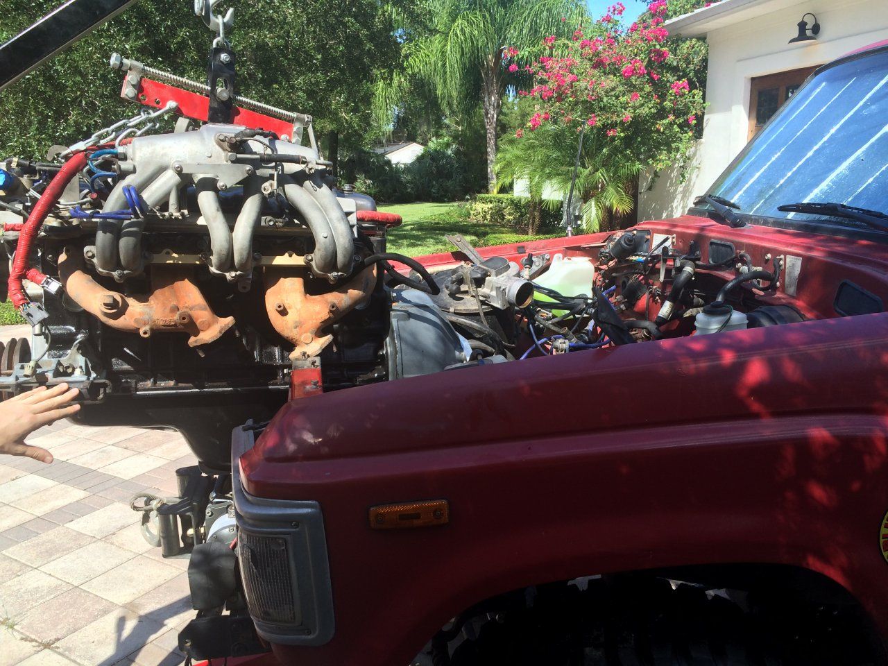

Sorry for the lack of updates, been super busy. How about I sum up the last three weeks in a couple pictures.
Last picture is as of about 15 minutes ago.
No, I built the motor and was putting it in this morning. It's in now :grinpimp:
Also, for reference (I'm going to make another thread with all the details of the NV4500 swap after I put some miles on it and make sure it works), the NV4500 bolted to the 3FE just fine using the Ford 302 conversion pilot bearing and Chevy 10" clutch.

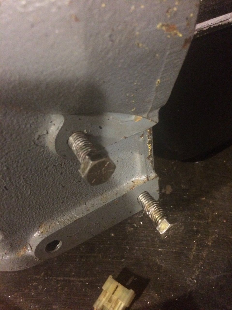

-Make a new trans mount, going to be solid. The one I put in lasted for about one second before it collapsed :lol:

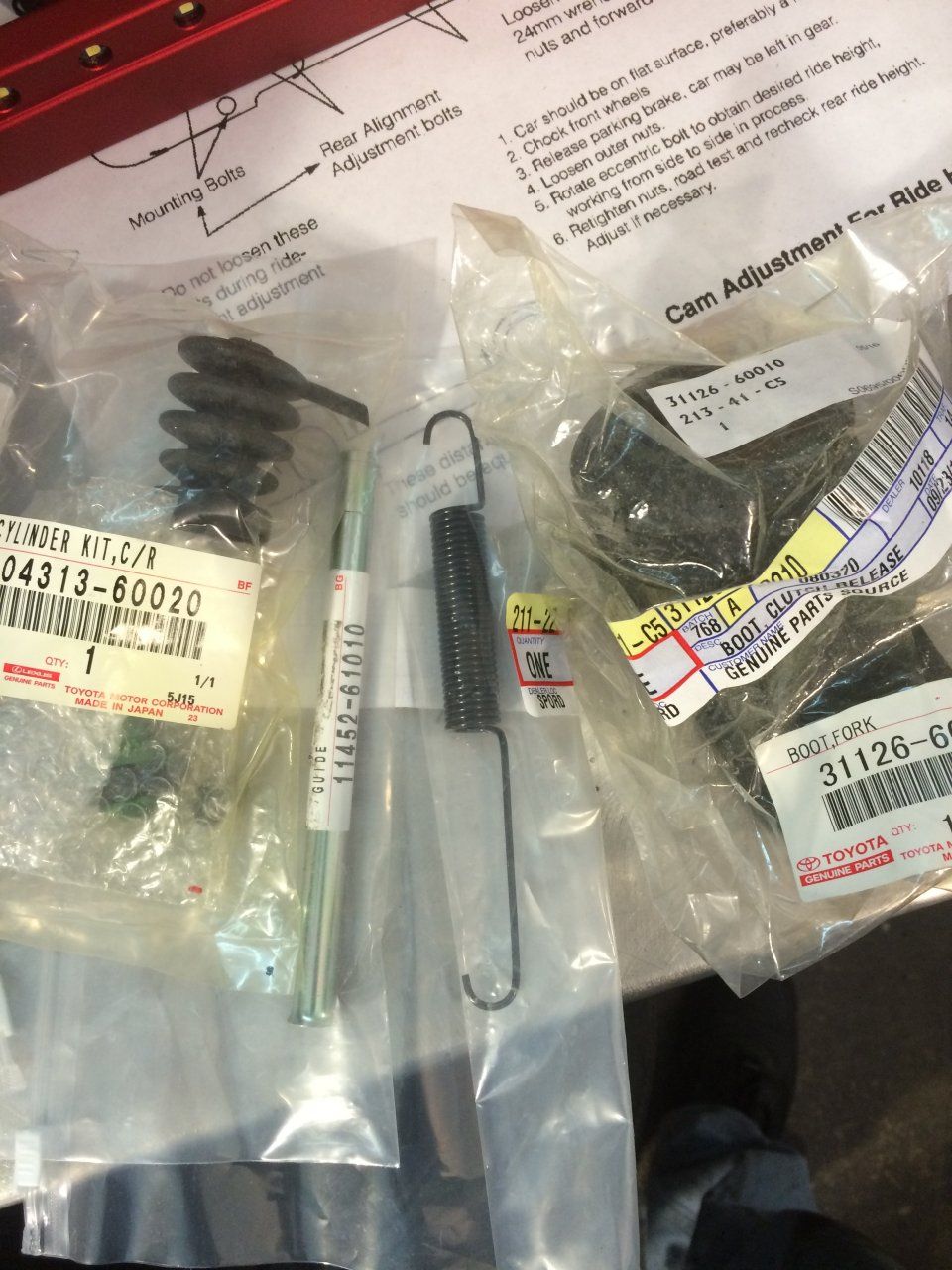

Got my new dipstick guide. And a clutch fork boot and spring for a 3-speed aplication.
