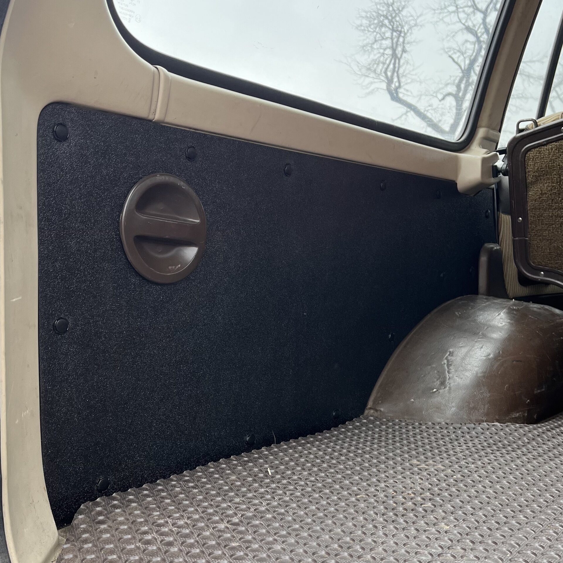

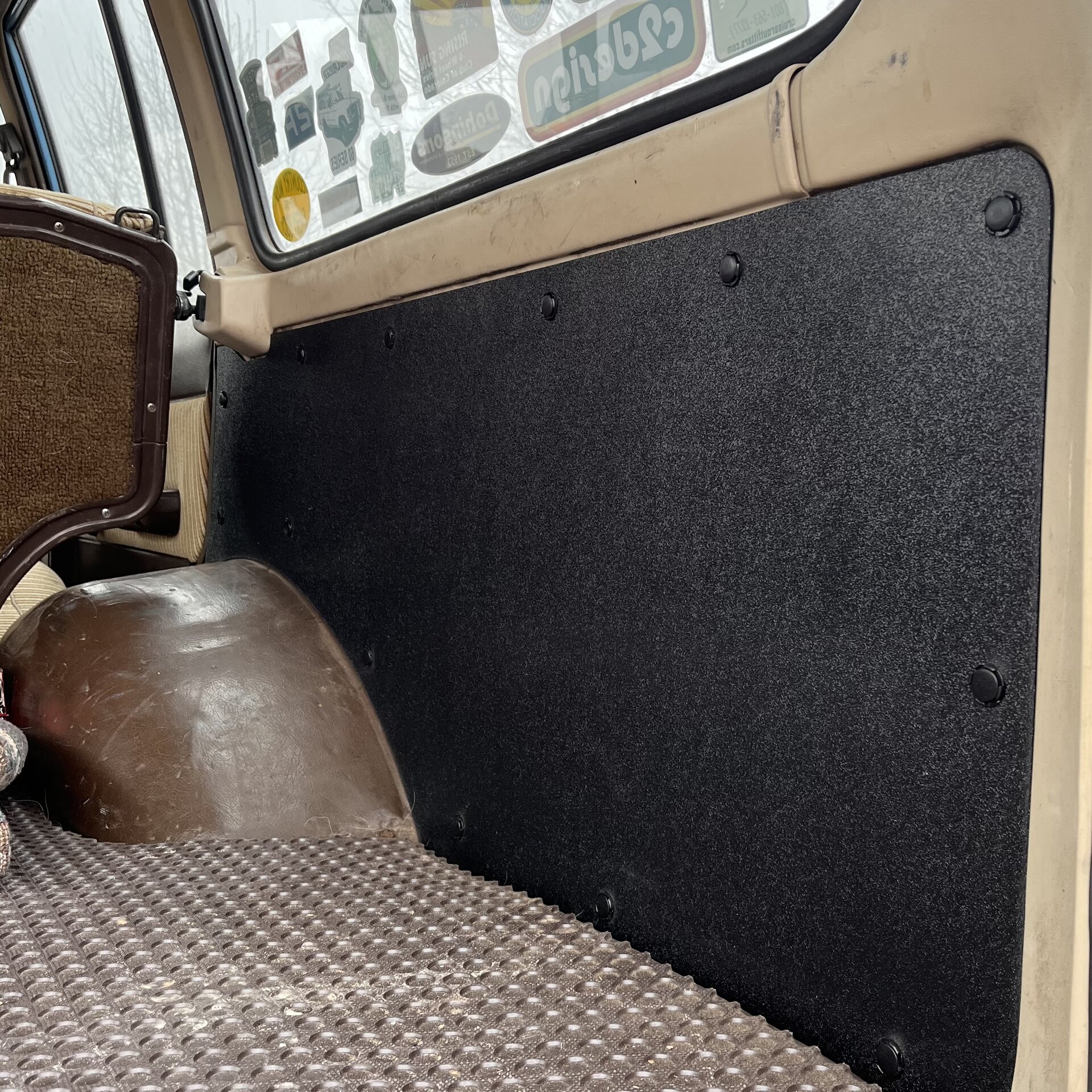

Learn something new every day:
1981-1982 trucks have a slight difference in the cargo panels. I happened to have a 1982 60 and tried to slap some of my pre-85 panels in there and they didn’t work. Oh well, let’s design some new ones. They are done and installed this morning. Thanks to @CenTXFJ60 for the additional photos from his early trucks! So now I have the following panels ready to be cut (and sometimes on hand):
81-82
83-84
85-87
Some HJ6Xs
I also have variations I can add for:
Wiper fluid hole delete
Aftermarket 3-point rear seat belts
Yes I am still slowly chipping away at 62 cargo panels. Hoping to get with @ryaneddy16 one of these weekends to measure some things on his 62. (@red66toy gas also been helpful with some dimensions too, thanks!).

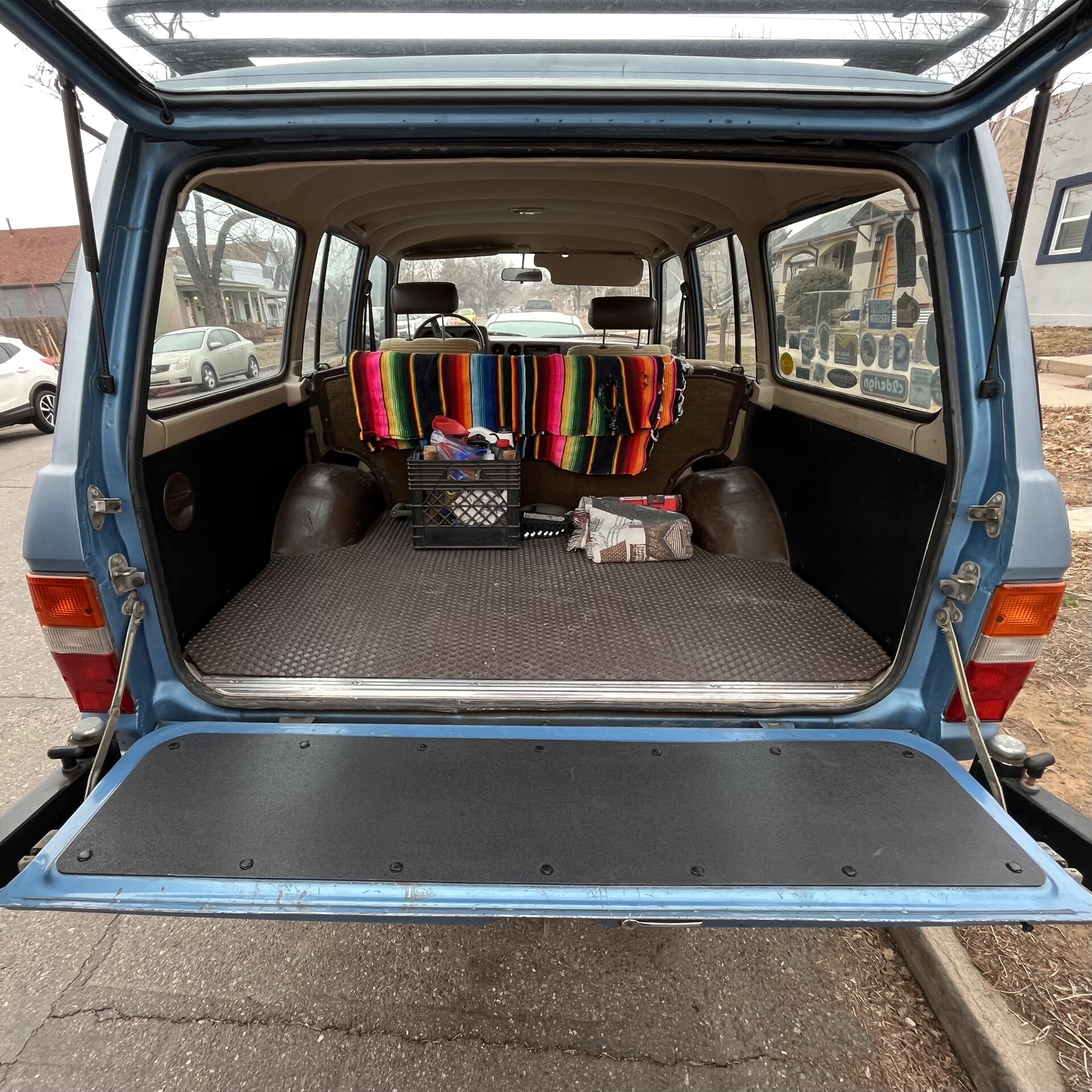

Here’s my truck all decked out in ABS, tailgate panel too. Can’t wait to beat the snot out of it camping when the whether warms up.

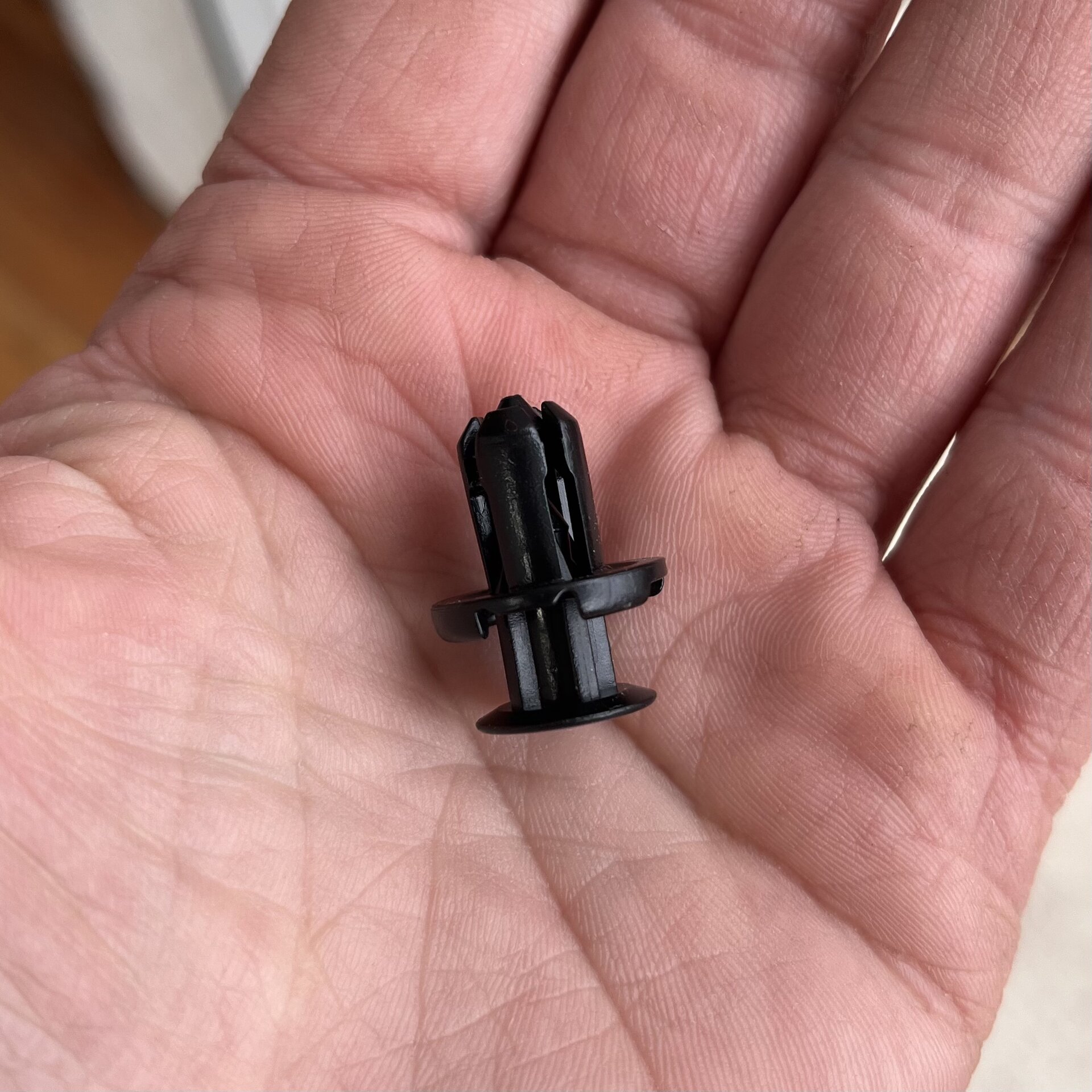

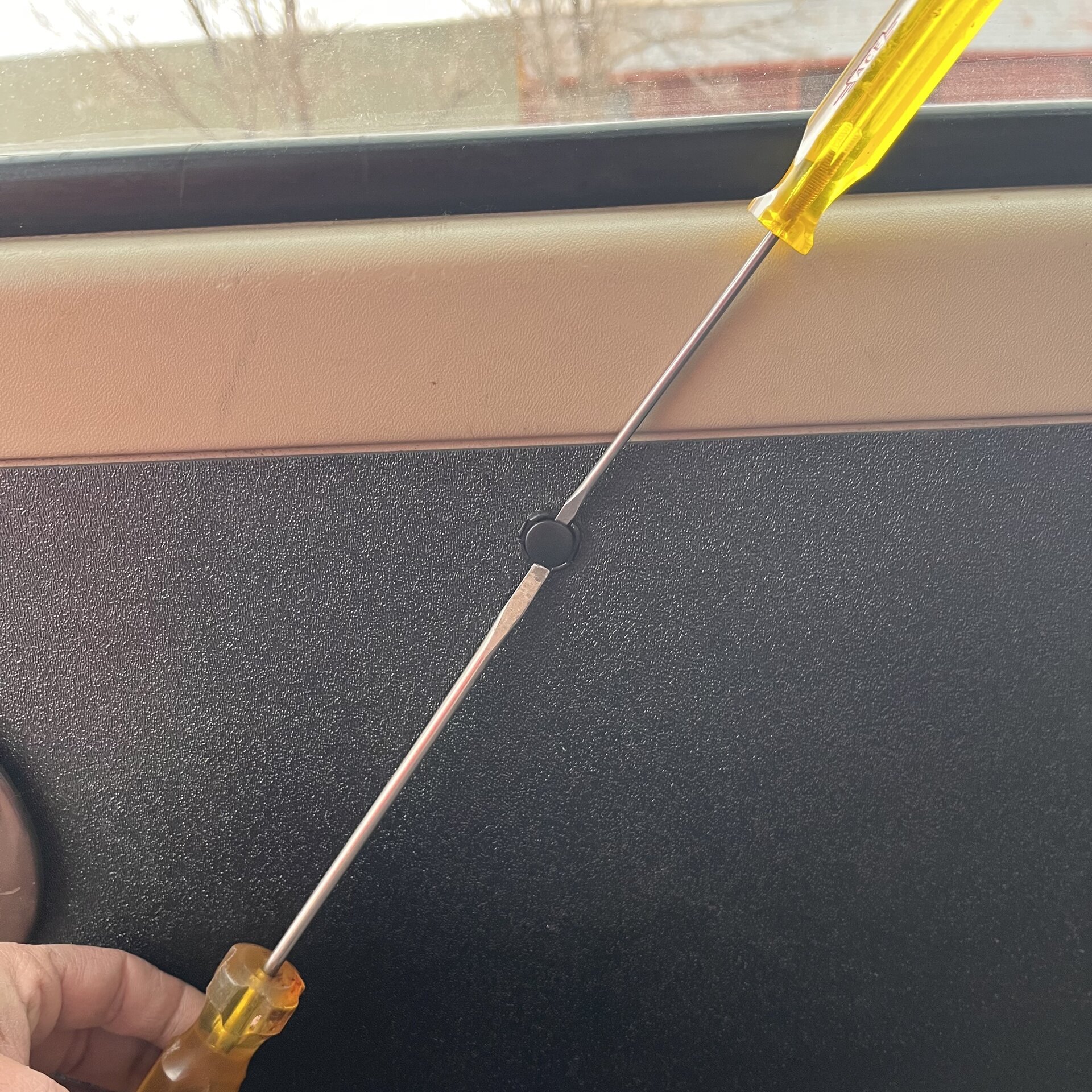

In case anybody is wondering how to remove the fasteners, get a screwdriver blade under each side and pop:
When pulling them out, make sure the head is popped out about 80% and lift the fastener from the flanges disc under the head. If you pop the head out too far it expands the wedge again and will prevent it from coming out.
Good:
Too far:

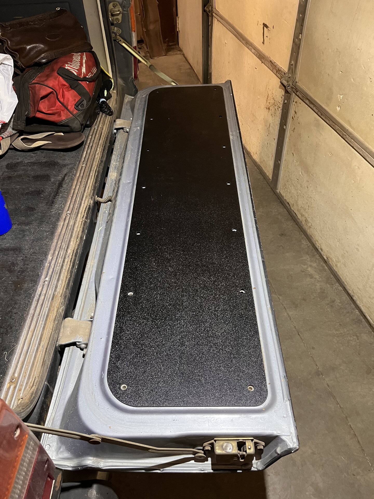

Thanks to @ryaneddy16 I’ve confirmed the Tailgate Panel fits 62s.

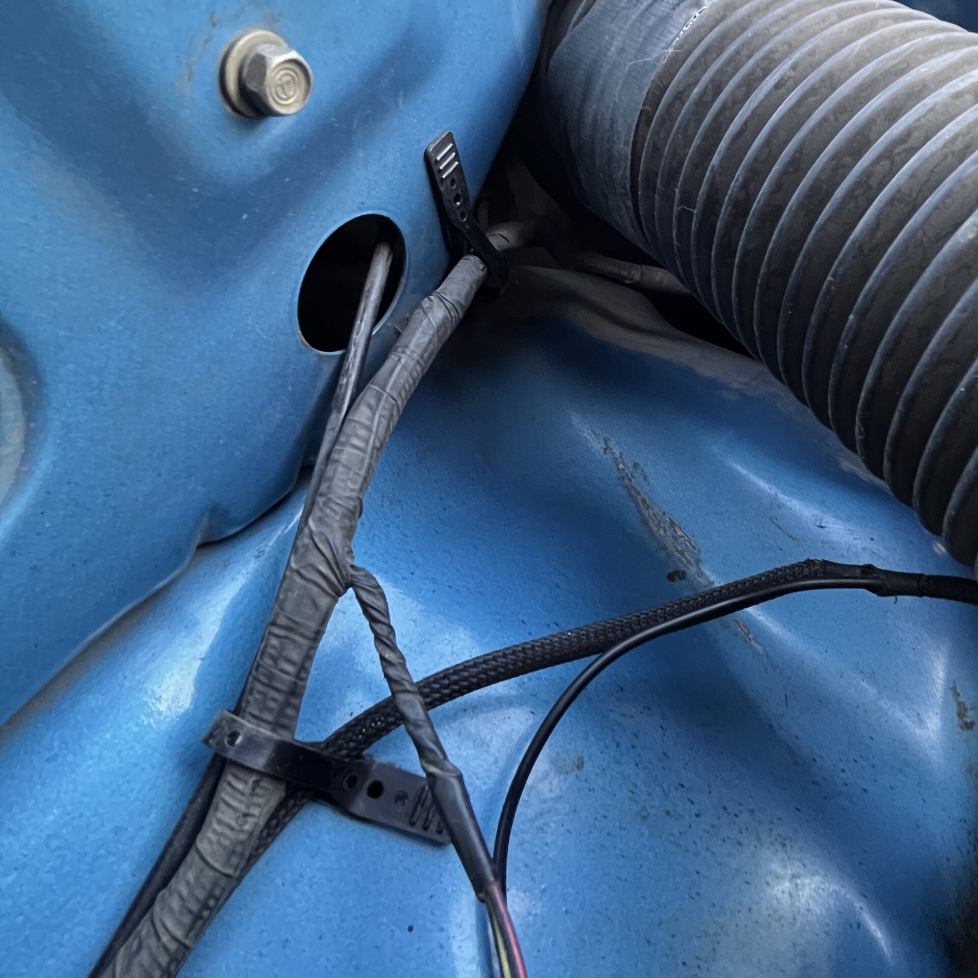

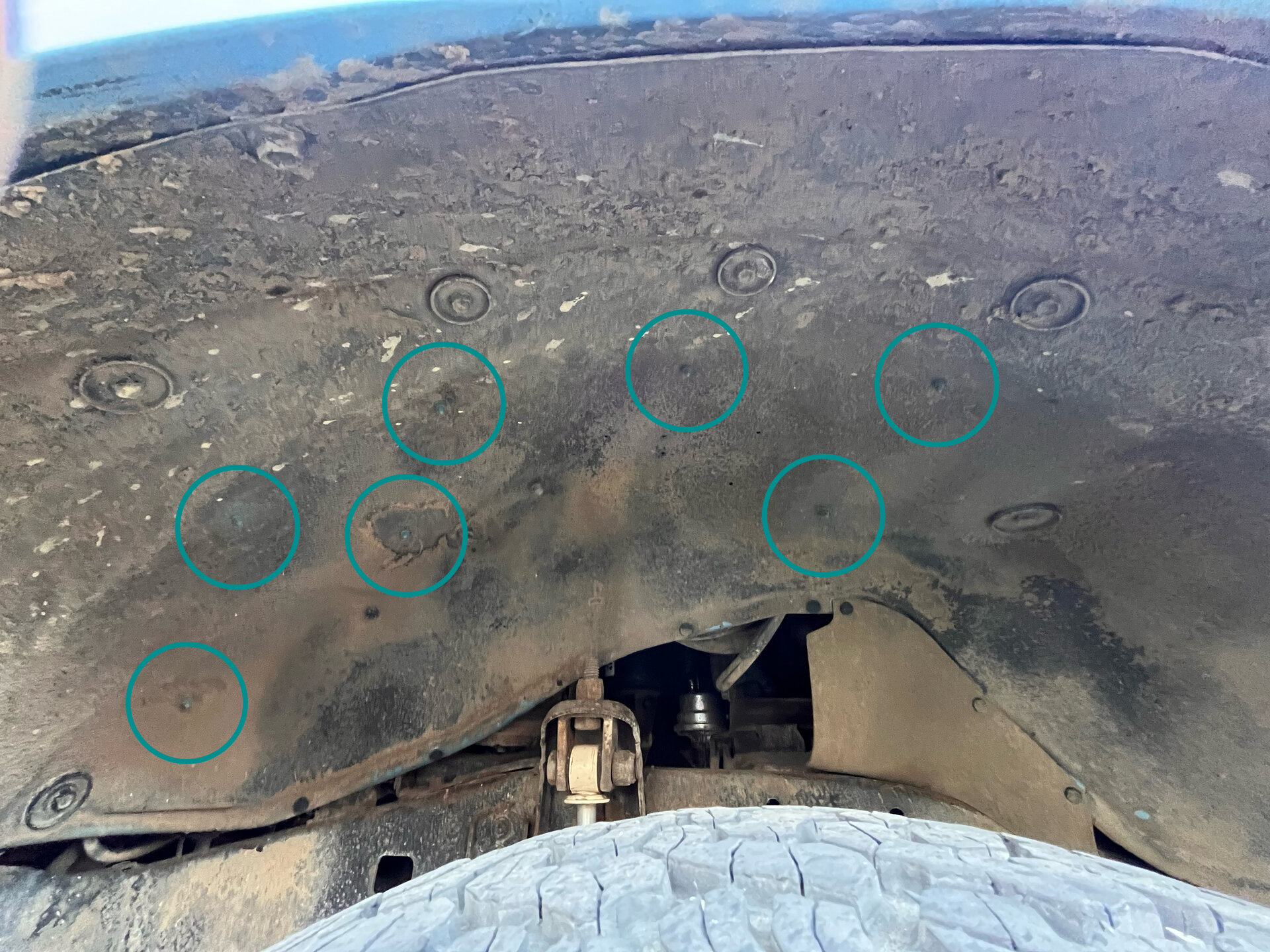

My engine bay wire ties were all cracked and broken and the harness was rubbing on a few spots where it was flopping around. Plus I have some extra wiring from add-ons I’ve done. So I found the Toyota part numbers and ordered them. Wrong ones. Ordered some more, one of them was right. Finally found both correct part numbers.
I ordered a bunch, counted them into the correct quantities, and put them on the website as a “kit”. It’s a convenience thing if somebody needs them - good pricing, everything in one click, no research (I already did that). Shipping will be about $5, unlike some of the online parts retailers that charge a minimum of $40 to ship.
I had previously gotten some knock offs that were labeled as a Honda part. They fit but several broke on install. No cheap junk, I went back and found the Toyota parts and of course they’re higher quality. These also fit larger cables - albeit barely - like @Fourrunner heavy duty cable upgrade kit.
You can order the kit here.

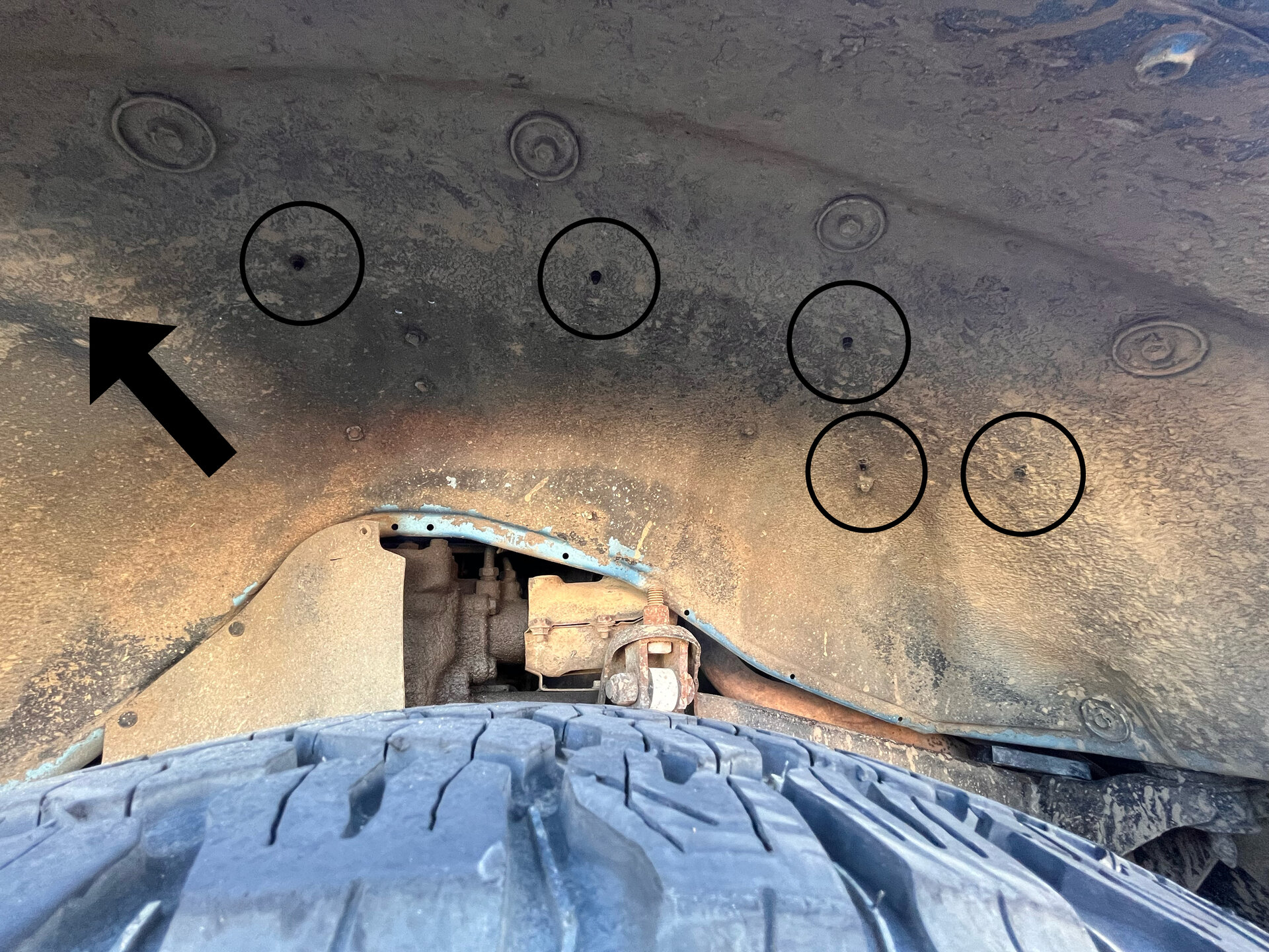

Here are the locations. Green circles are on the right side, black on the left side.
Note that one of the black ties is not on the inner wheel well, it’s on the inner fender near the air intake tube (shown above).
I recommend clipping off the protruding part of the old ties underneath with some flush cutters, then poking the remainder up from the bottom with a screwdriver. Install is easy: push in the receiver side, loop the tie around, then push in the other side. It takes maybe 20 minutes to do them all.

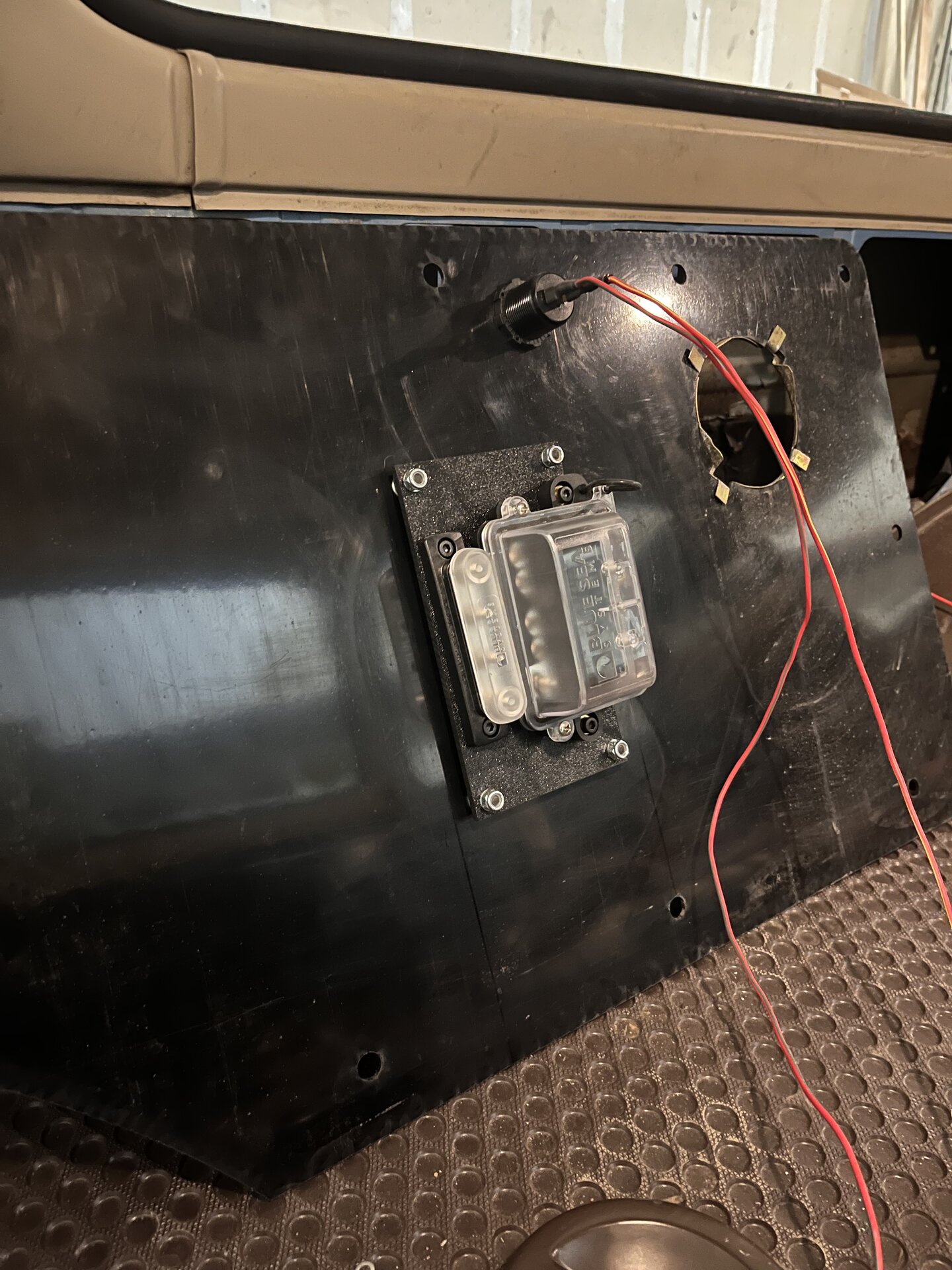

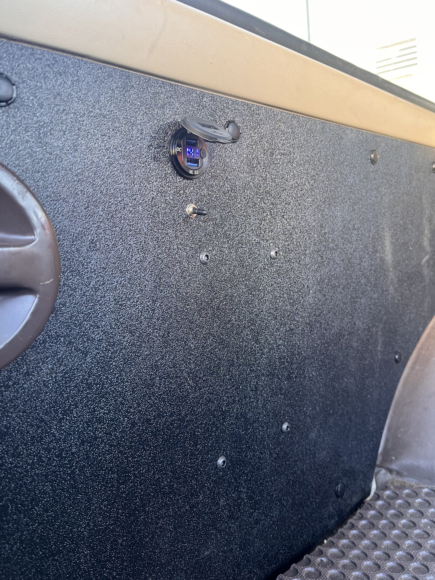

Additionally, I built some power distro into my personal cargo panels over the last week and a half. This is something I could offer as a kit on its own or as an add-on to a cargo panel purchase. I would love to hear some feedback about whether this would make sense to people or not. I kind of think it's too much for some folks (the hardcore DIY person) and too little for others (the folks who don't wrench on their trucks very much and need a full turnkey solution). What say ye, peanut gallery?
This is just a small piece of ABS with positive and ground distro attached, held to the cargo panel with standoffs. It sneaks right between the body work supports in the cargo panel cavity. I added a USB charger and some lighting, but would not provide that. You'd get the Blue Sea power distro stuff, the abs sheet, and the hardware. Panels ordered with that add-on kit would have holes pre-cut to attach the standoffs. You can see in the second photo that the bolt heads for the standoffs are very low profile so they don't catch on any cargo. They aren't super visible.
And yes, the switch for my lights will get ripped off - I used what I had on hand for that and will be replacing it with a near flush-mount push button.

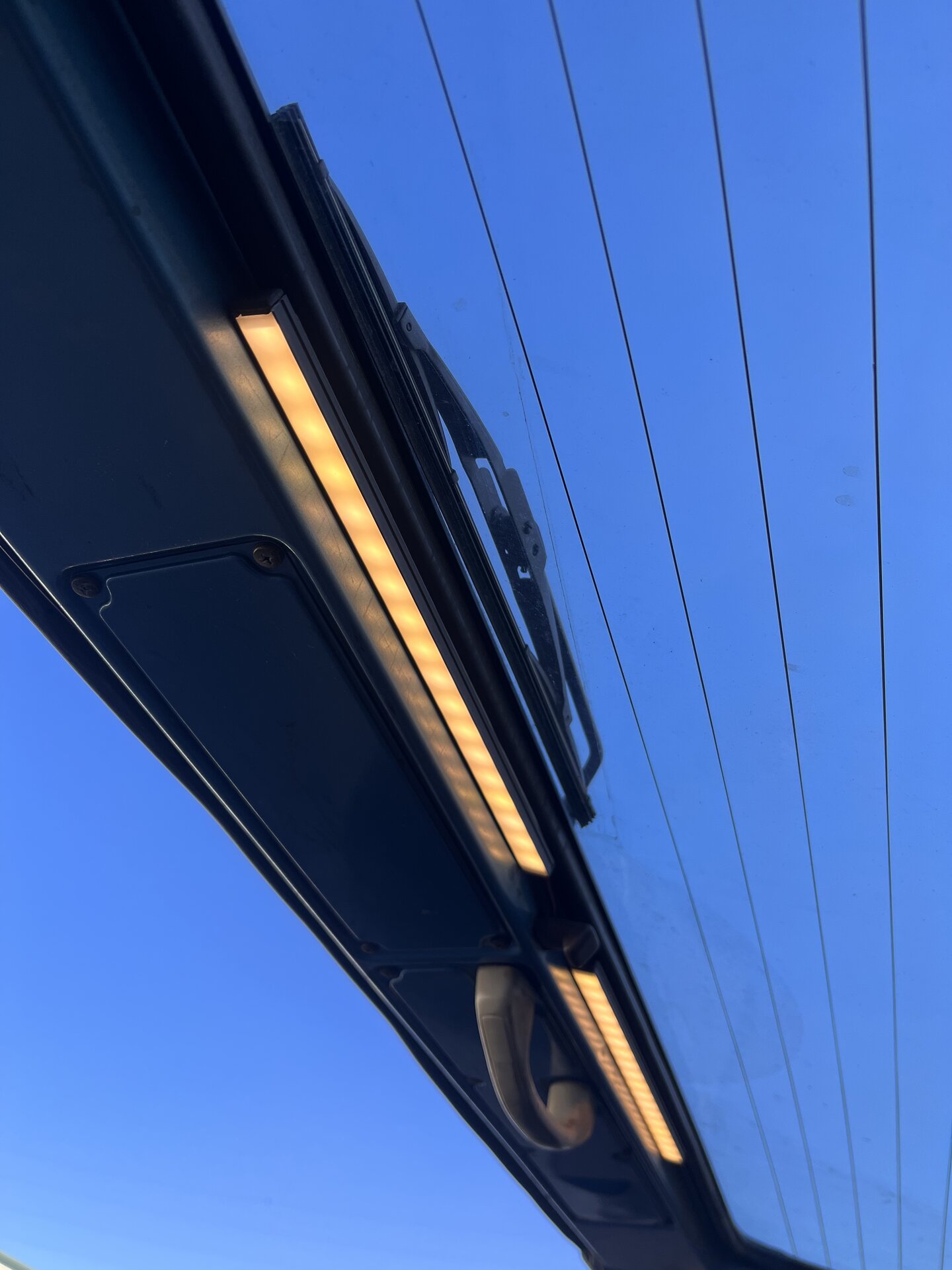

For the curious, here's the lights. The wiring follows the rest of the wiring for the hatch electrics (defrost, wiper motor) up the d-pillar, through the headliner, inside the rubber boot, and down inside the hatch, and comes out of the body metal at the lock tab.
