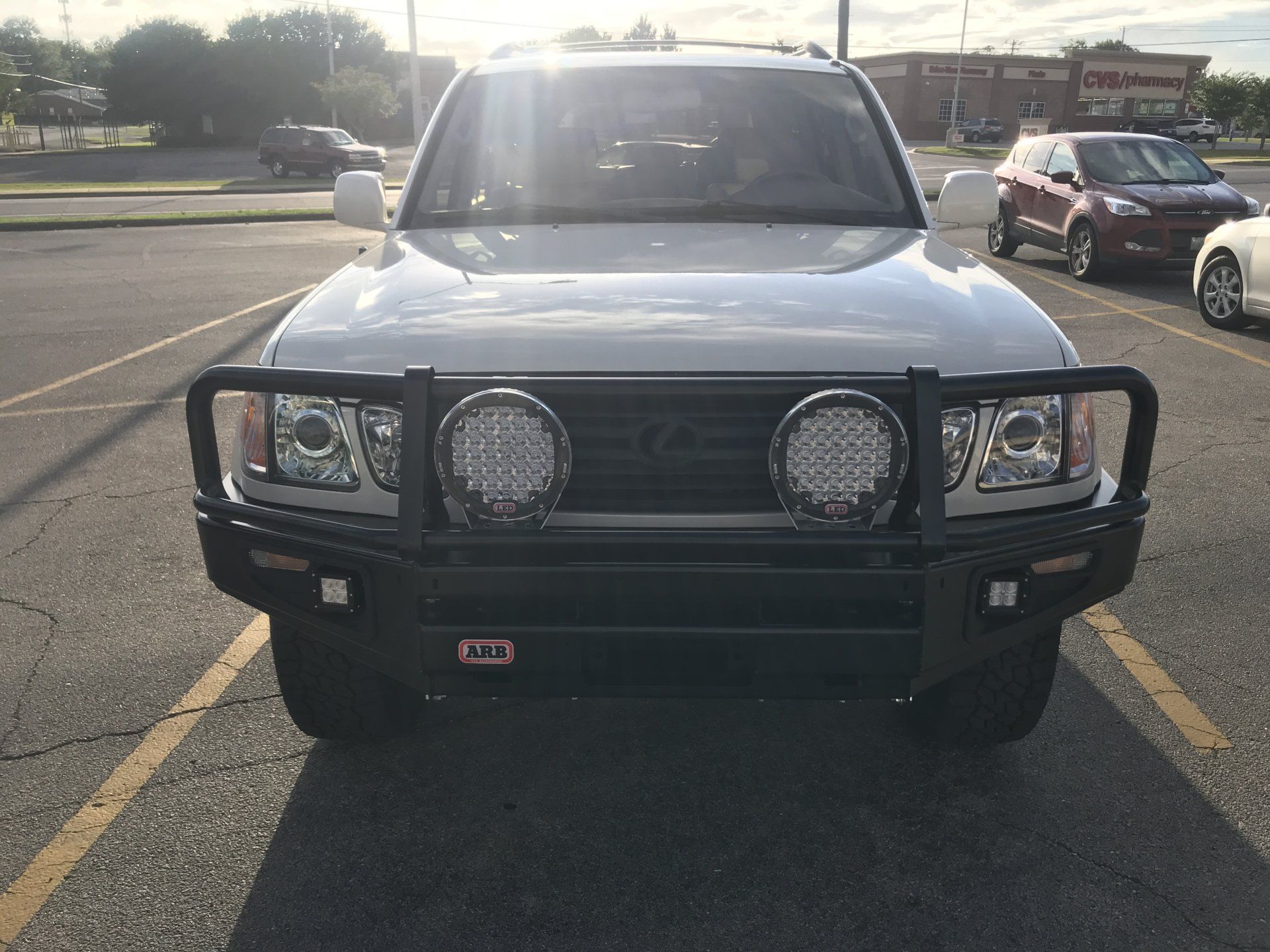

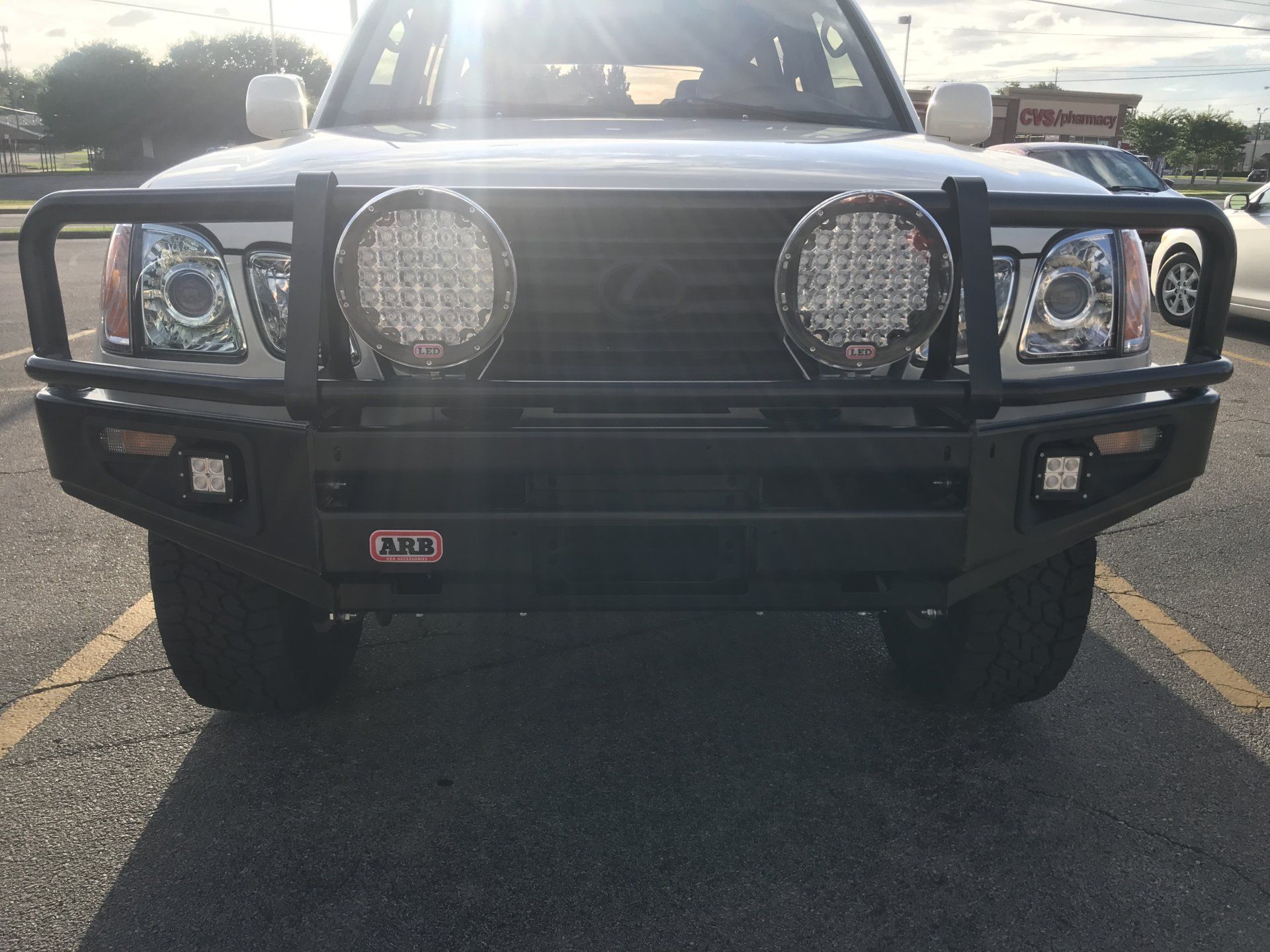

I found these fog light brackets for an ARB front bumper. They are from Paranoid Fabrications and were only $25. Interested to see how it works. My ARB front bumper should of been here Friday, but Amazon totally screwed it up. It will now be here 3 days before I leave, the good news is they refunded me 20% so I got the ARB bumper for about $950.

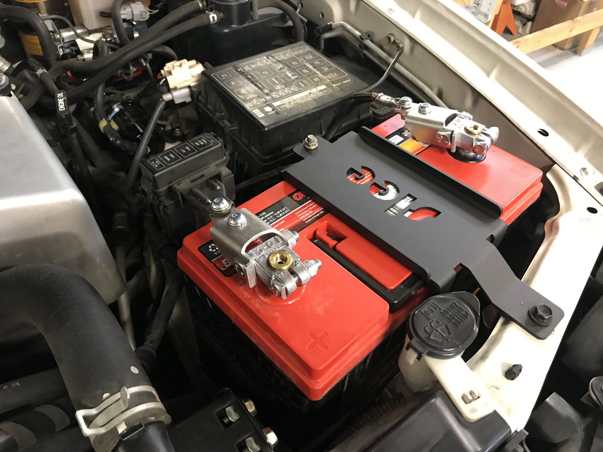

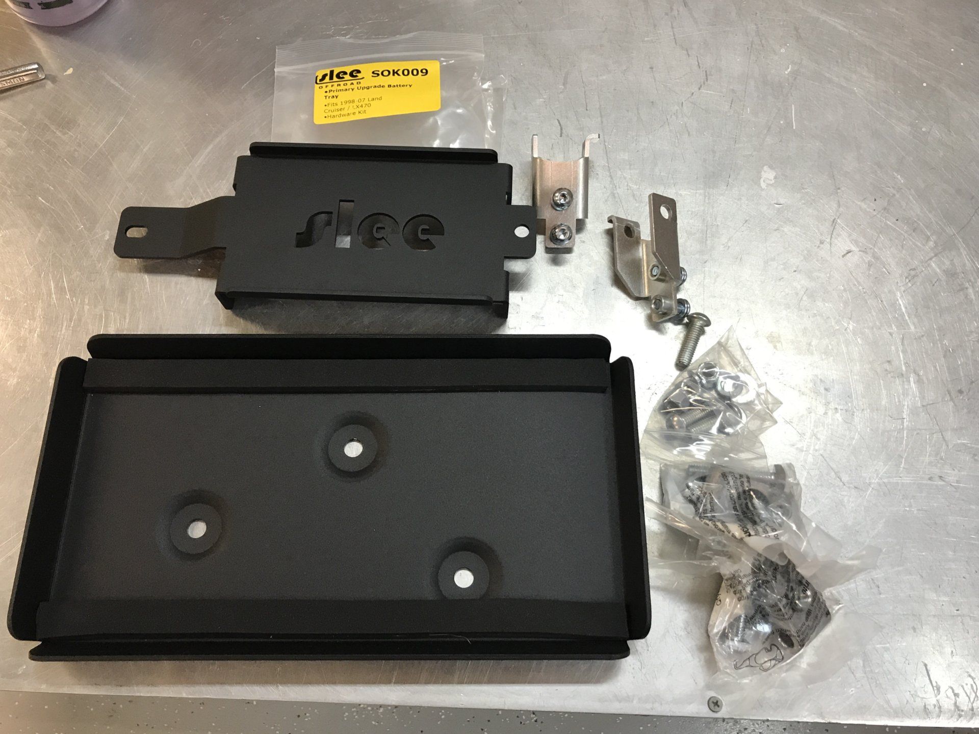

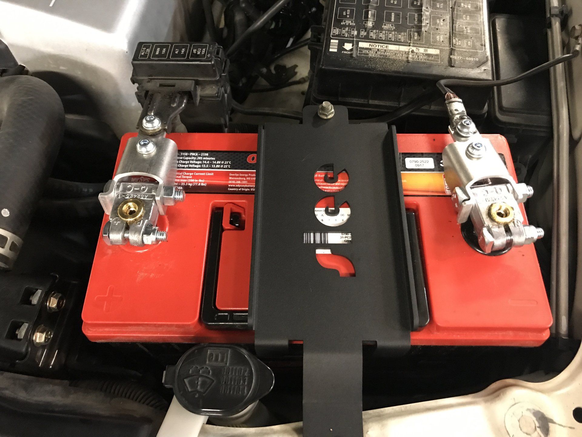

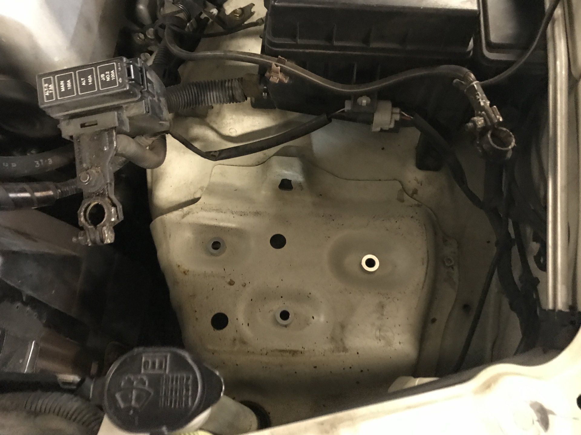

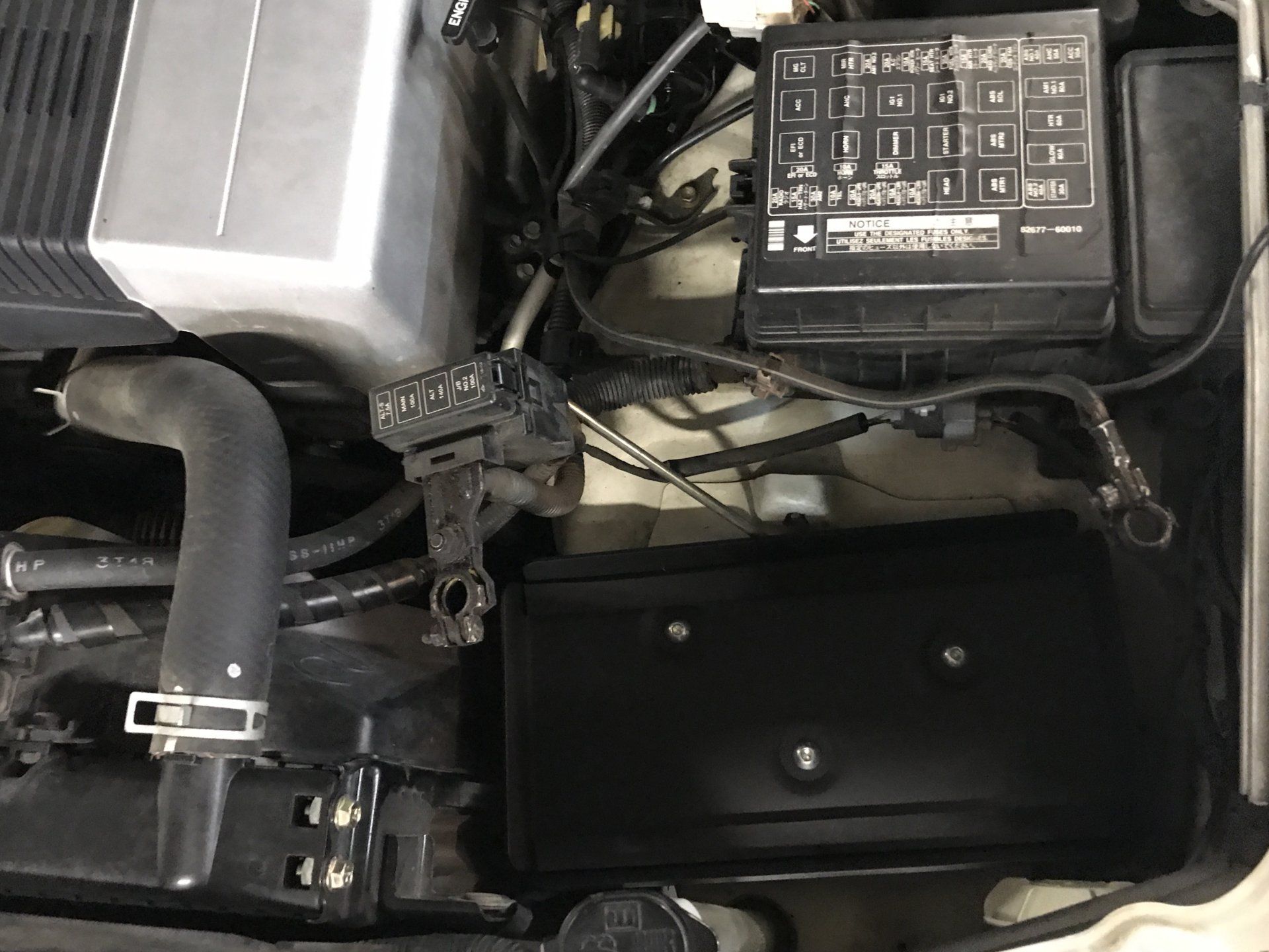

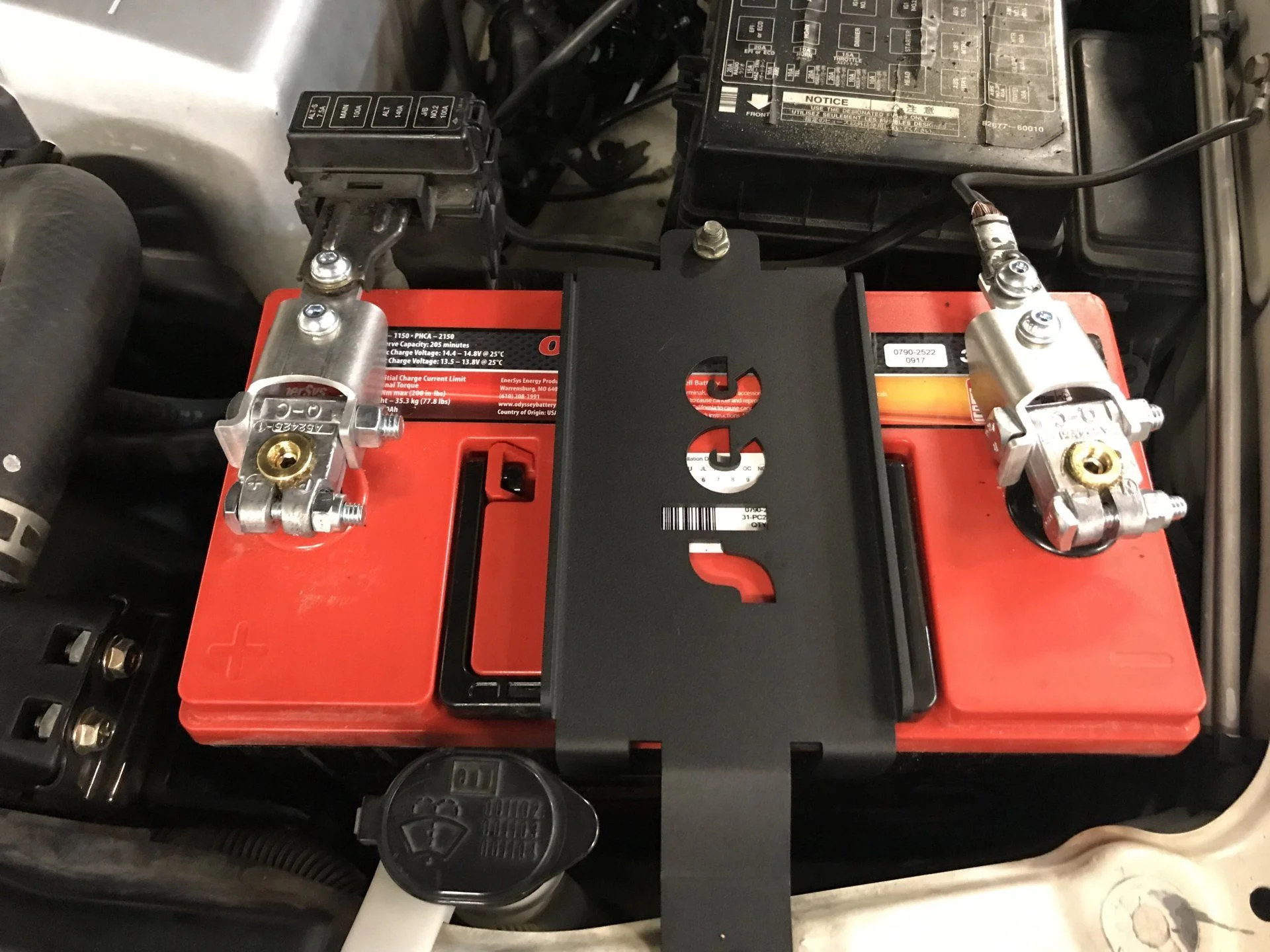

Performed a two step paint correction on the exterior, will get some pics of it tomorrow. I also upgraded to an Odyssey Group 31 battery using the Slee kit. Pretty easy install and the kit was well thought out with good instructions. This should help with extended camping trips, especially if I can get an ARB Fridge!!
Stupid question, but what is the Slee battery box for?

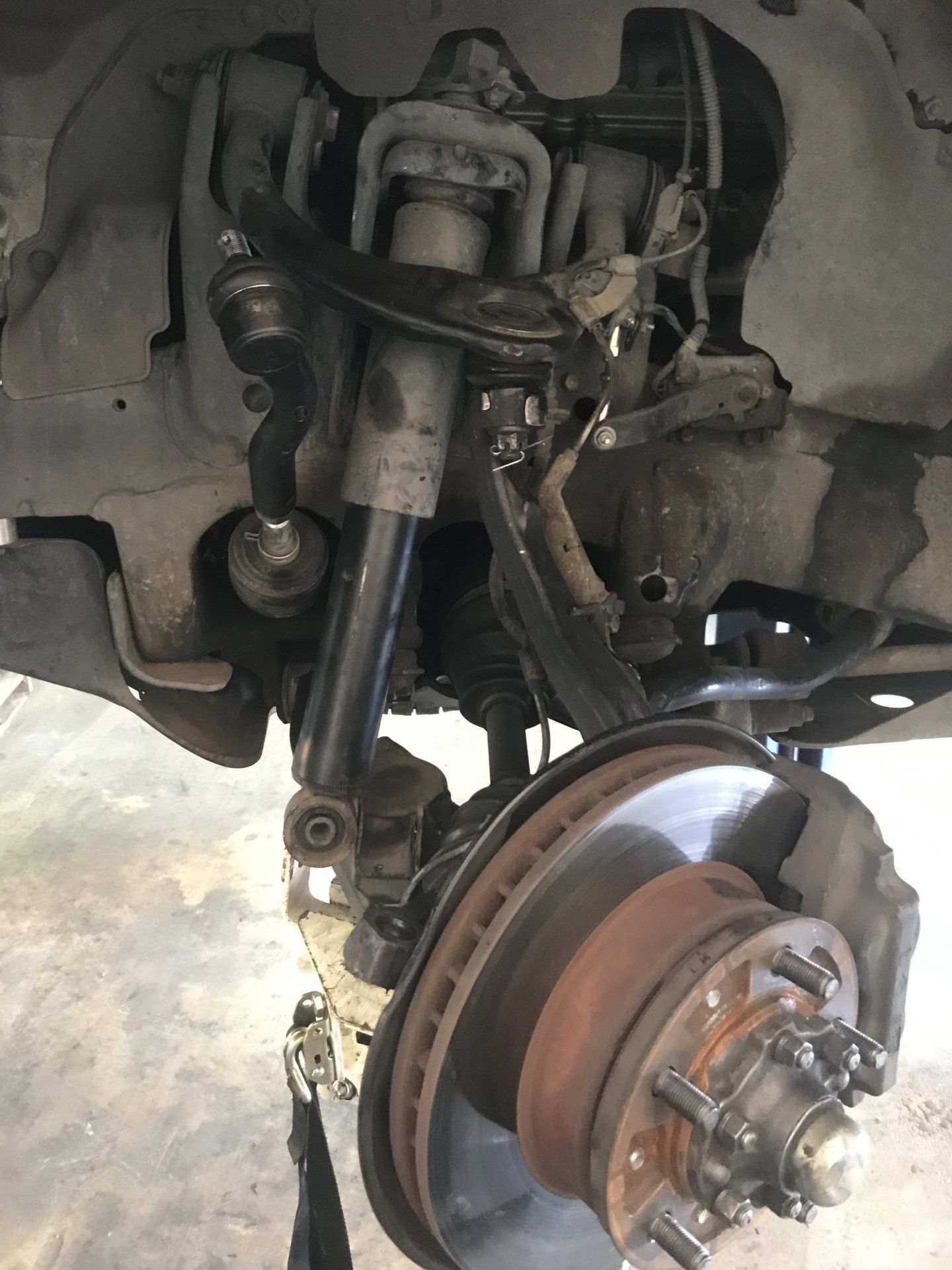

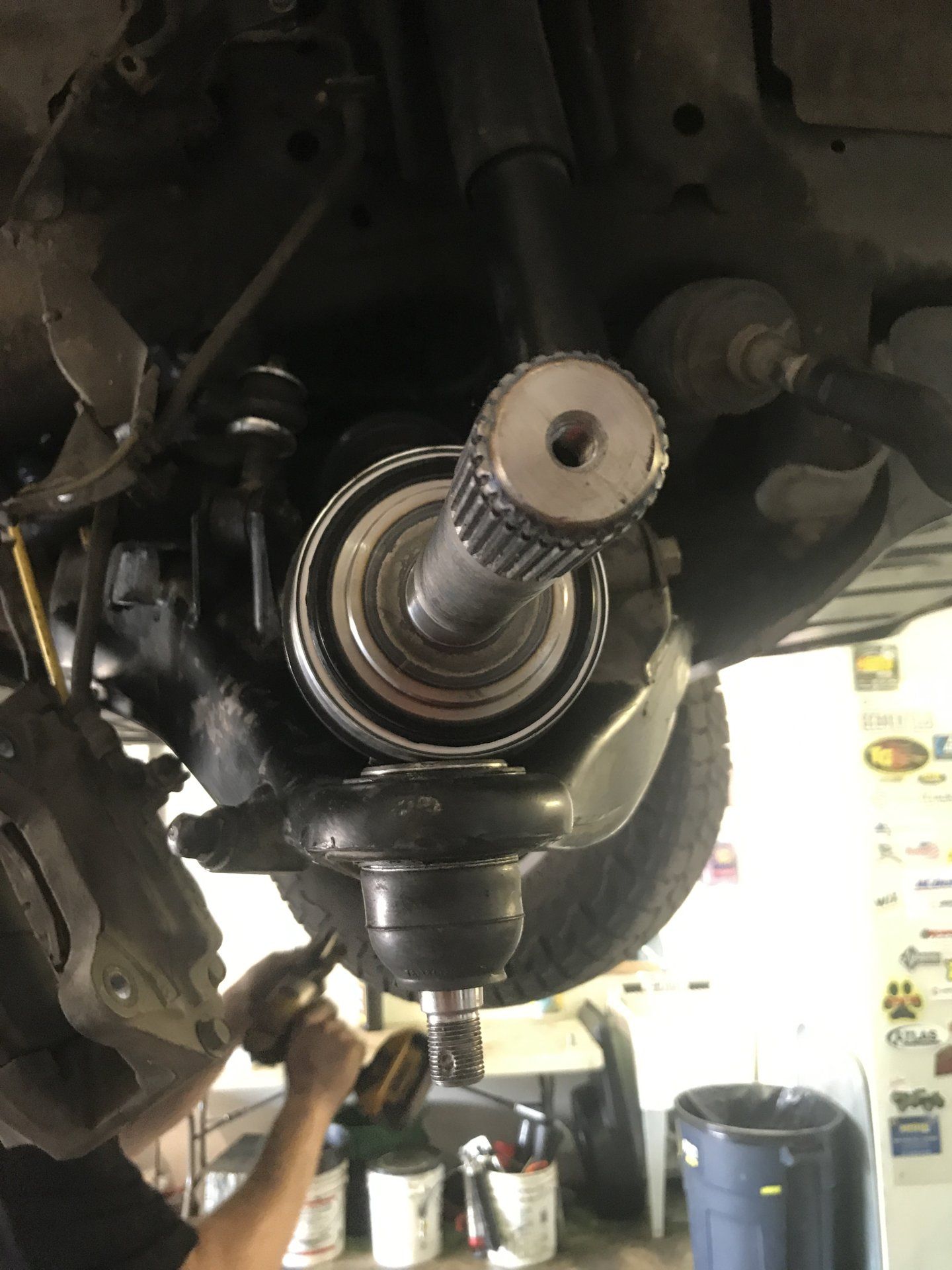

A lot of one step forward and two back. I replaced front end components on passenger side to match what was previously done on driver side a while back. So 555 lower ball joint and CV Axle. Also noticed my lower AHC shock bushings were very worn, especially the driver side where I was getting the clunk. Replaced this bushing in the vehicle without removing the shock with the the help of my local mechanic (Gear Grinders Garage). We completely ruined the old bushing getting it out so no picture. Had to cut the metal sleeve with a body saw, then drove the bushing out with an air hammer. New bushing went in easily with a ball joint press. Thought for sure this would fix the clunk, but it did not. Still getting the clunk and becoming very frustrated as I don't know what could be causing it.
Last night I went over the entire front end to try and fix this clunk. Found the diff drop crossmember bolts and the upper control arm bolts both needed to be tightened. This finally fixed my issue!!

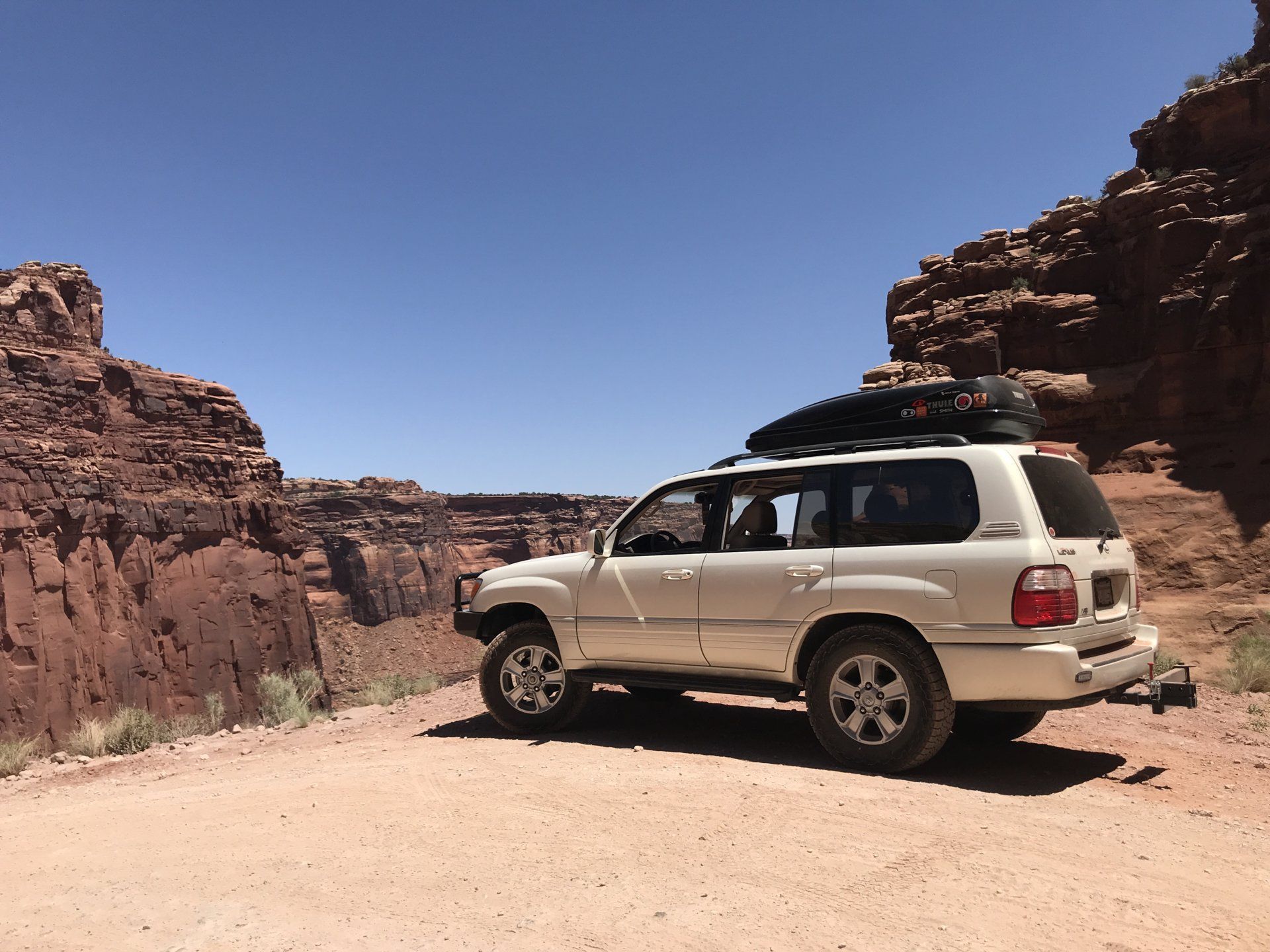

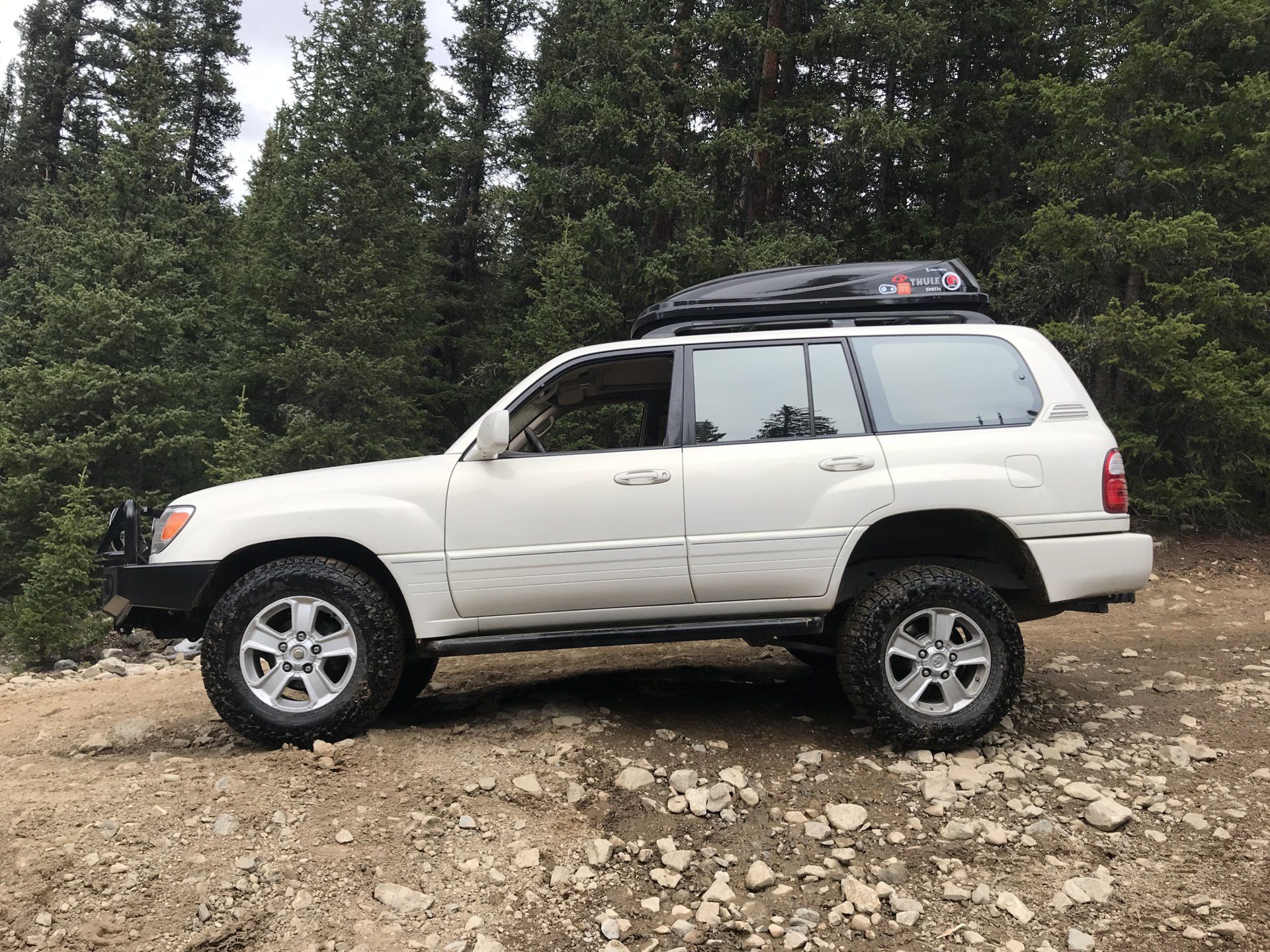

Long overdue, but we got back from our trip to Colorado and Utah almost 3 weeks ago. We had a great time and the Cream Puff did great. Not a single issue on the 4,000 mile trip. I was stoked to finally take this rig off-road and was very impressed with how it did. We did the majority of Georgia Pass in Breckenridge, until we got stopped by deep snow in the pass. We also did the Shaffer Trail in Canyonlands NP and we exited Arches NP via an OHV Trail that took us by the Dino tracks. Learned a lot on the trip and will definitely tweak the setup a bit. Having a fridge is amazing, by far the best purchase I have made. I would really like to find a slider setup for it that still allows me to use the 3rd seats. Here are some pics of our trip.
Looks like a great trip!
the Cream Puff looks awesome!
Those are my favorite 18" Tundra Wheel.
I love to see guys using these rigs with family. What an amazing experience for your kids.

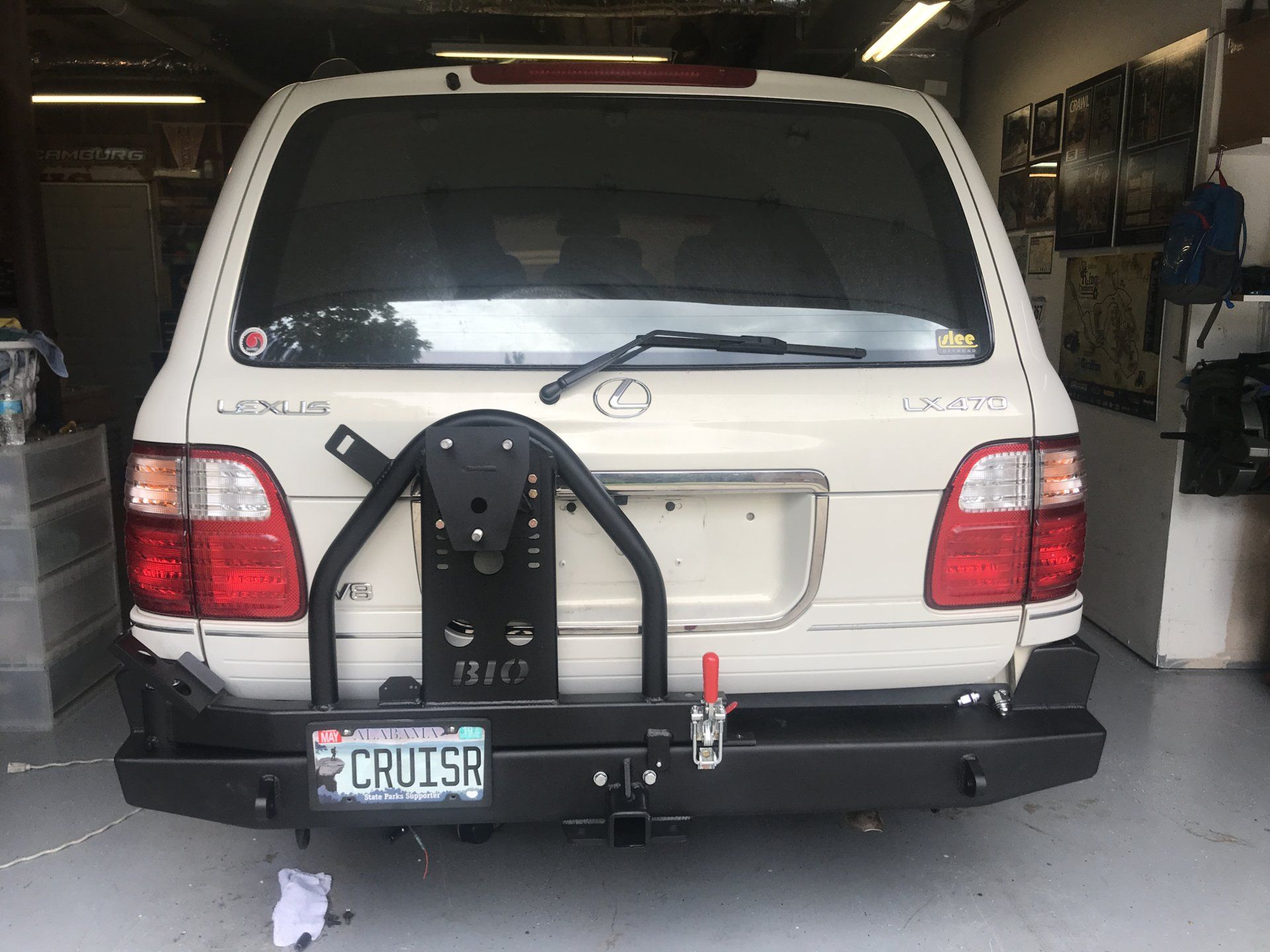

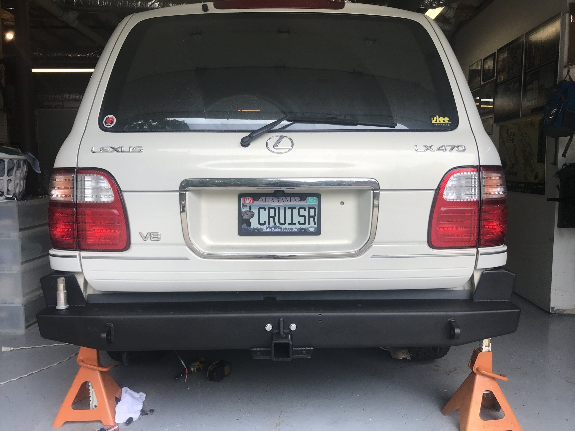

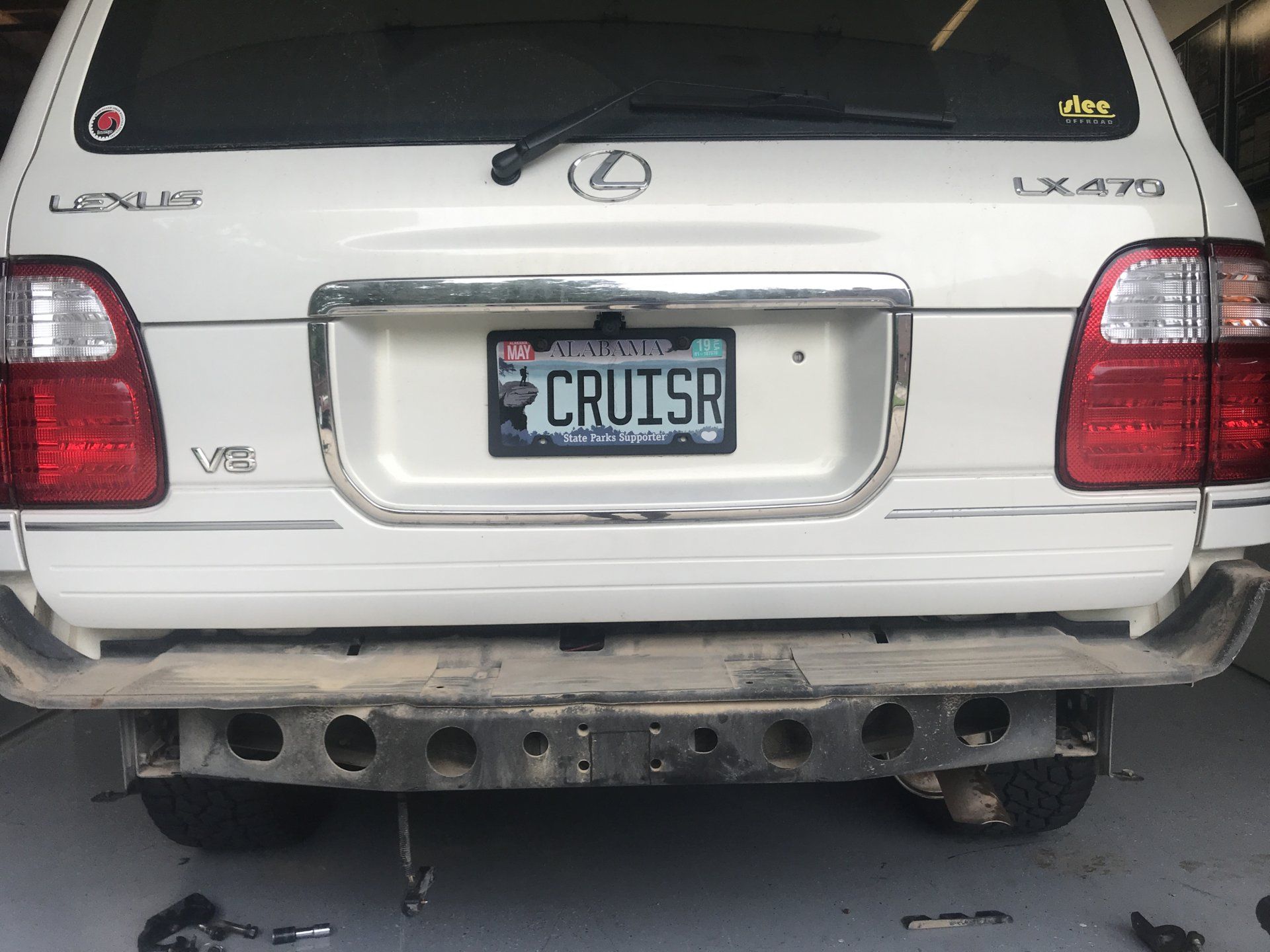

Worked with Mike at Bump It Off Road on a rear bumper and tire carrier. Mike was great to work with, great product, and good communication. I had to have a driver side swing-out and Mike was able to make that happen.

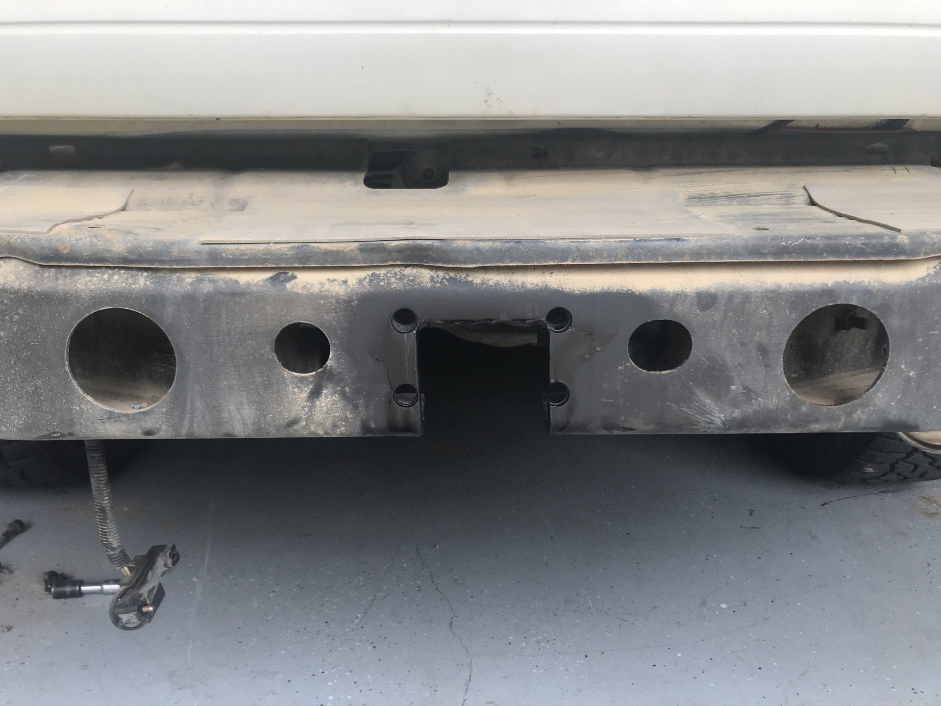

I got the standard bumper with integrated hitch, single swing out on driver side, adjustable spare tire mount. Fit and finish was very nice and it was pretty easy to install. Hardest part was notching the crossmember for the hitch.
