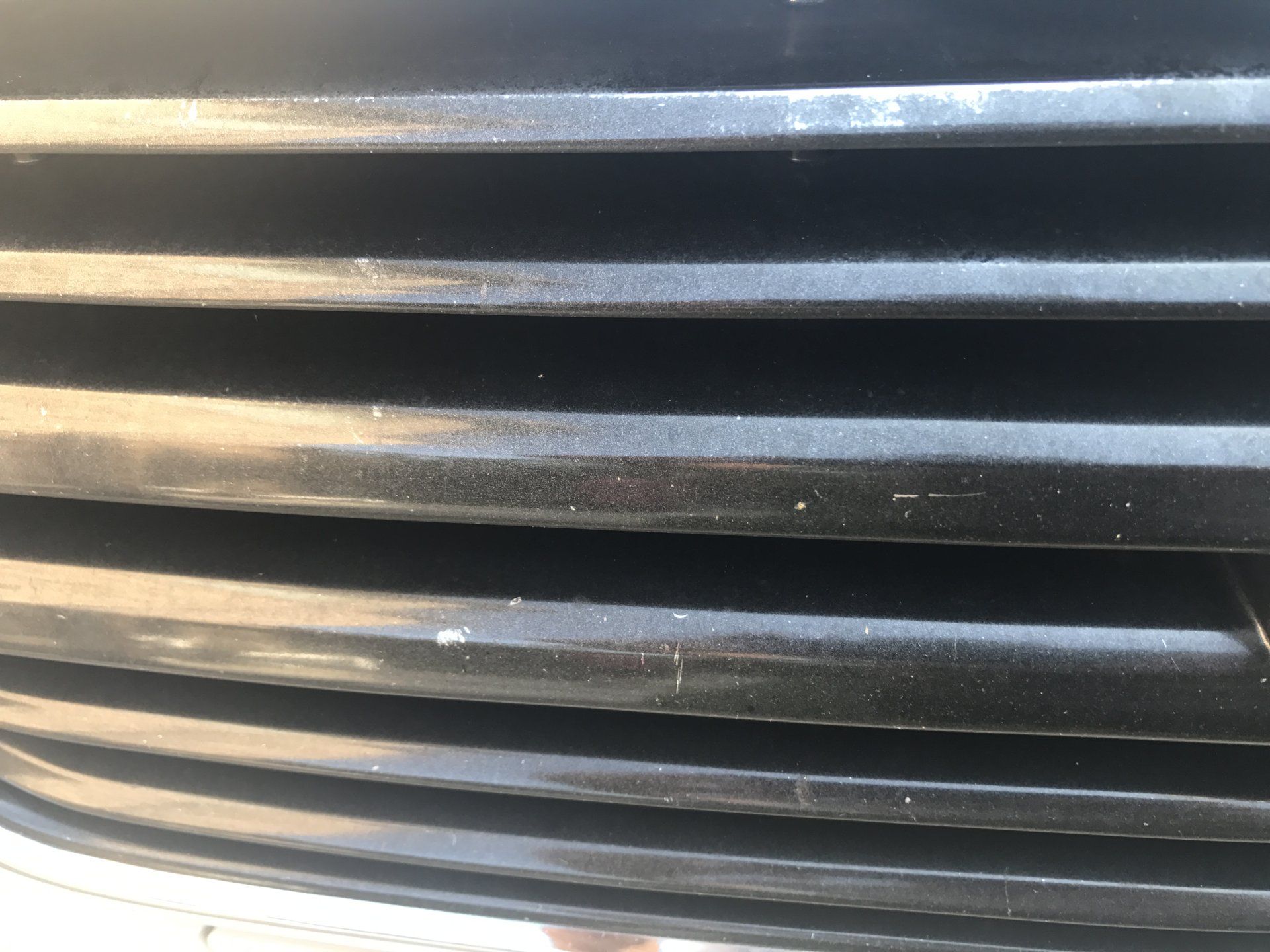

A few small updates. I plasti-dipped the grill as the chrome was flaking off. Went gunmetal at first, but I didn’t like the color. Sprayed black over it. Not sure how I really like it, but it will do for now.

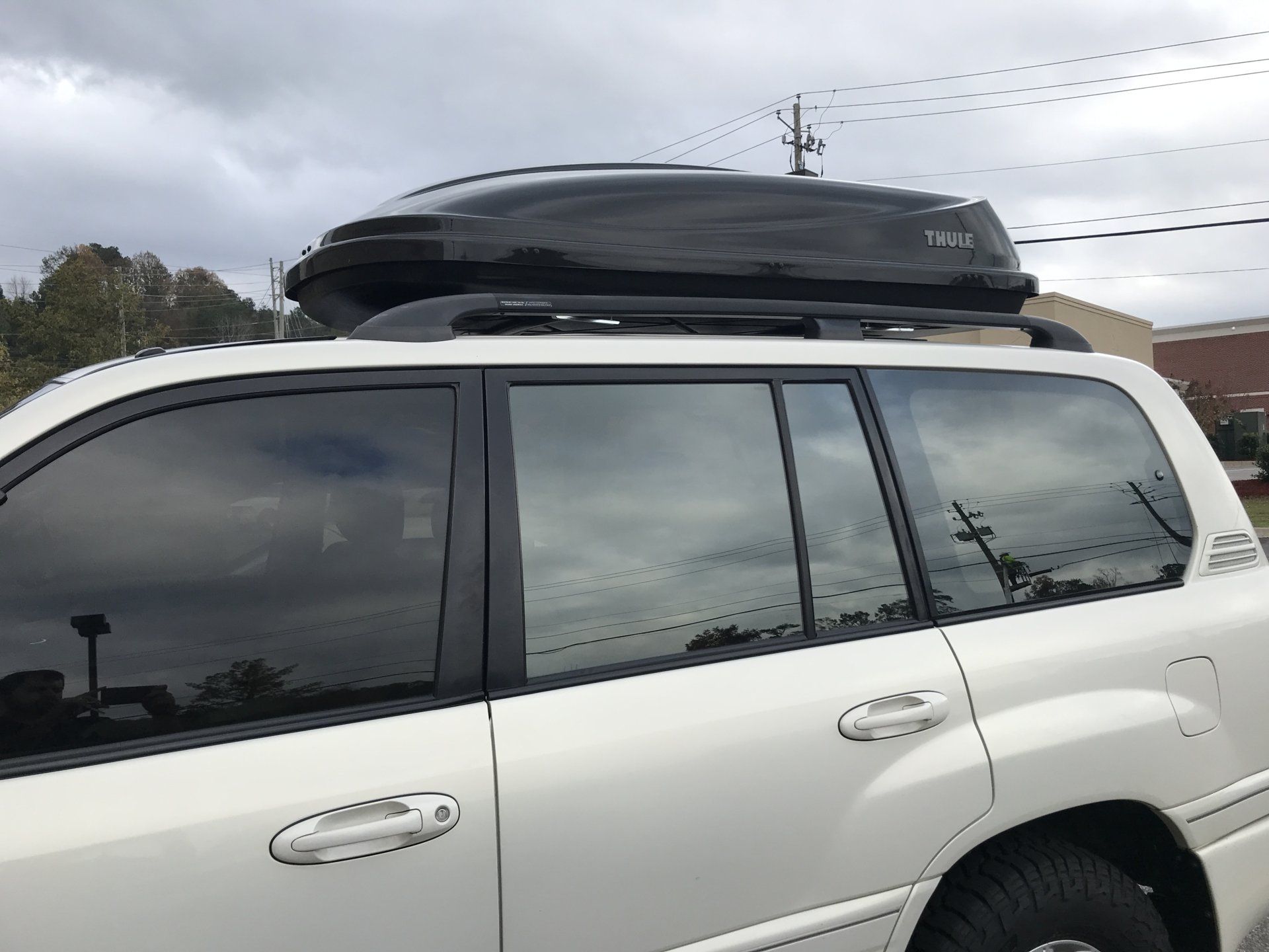

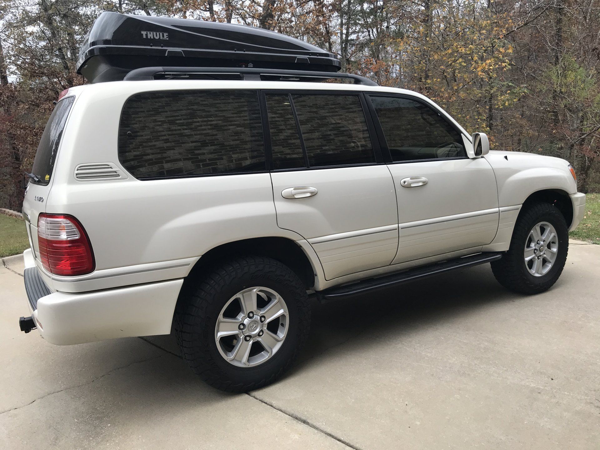

Looks like I may do a cross country trip this summer with my oldest boys. I am going to shift my focus on making updates needed for that. Found a good deal on a Thule box on the local classifieds and picked it up today. This box will really help with family travel on both vehicles.

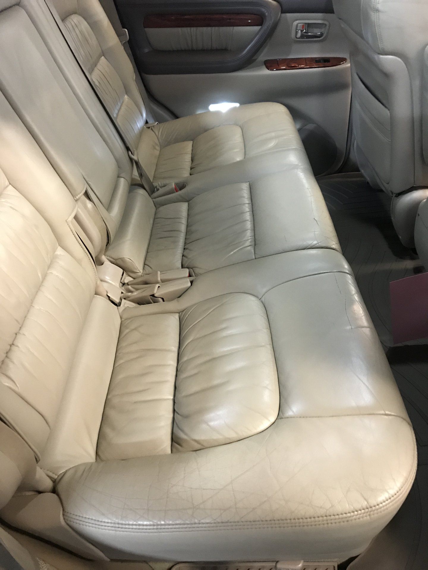

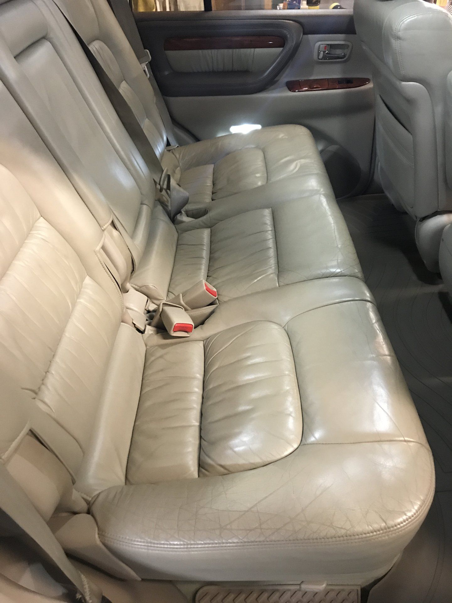

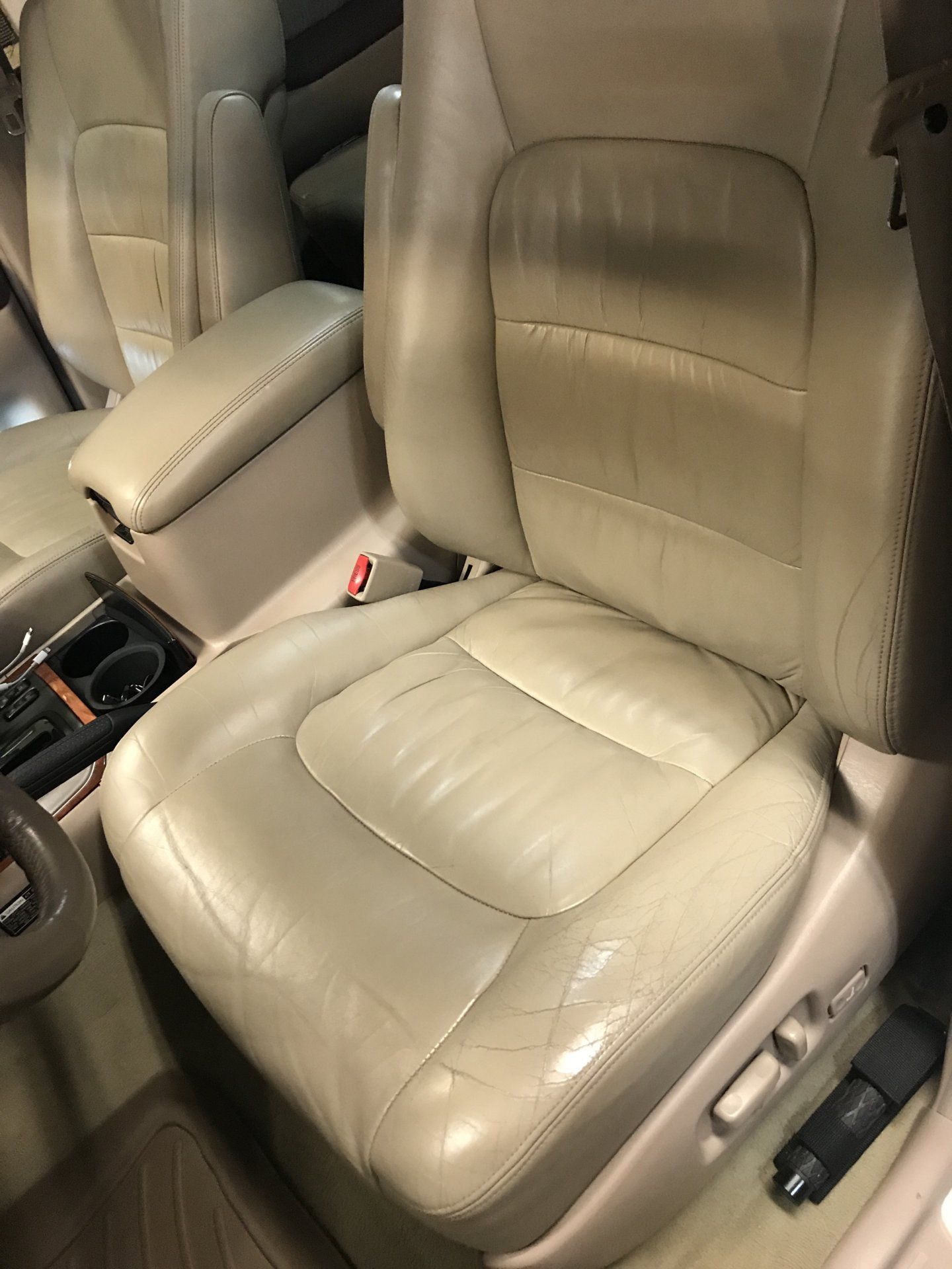

Been off this week and found some time to work on the LX. I did the Leatherique treatment. Left it on for over 24 hours. Even left it in the sun on a decently warm day. My seats were still very glossy and tacky when I cleaned the oil off. Makes me think the oils never really got into the leather. Leather is a little cleaner and softer, but you really can’t tell much.
Before Leatherique Treatment:

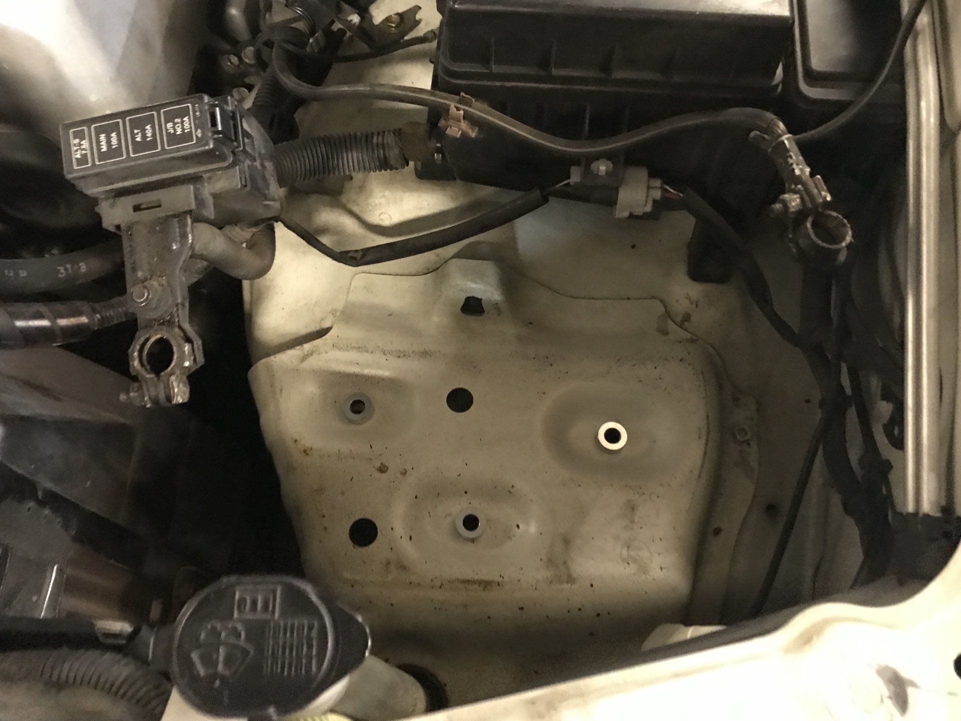

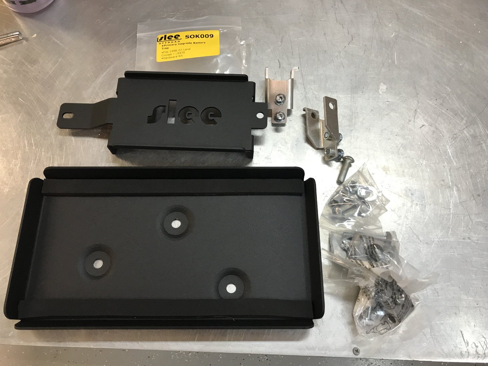

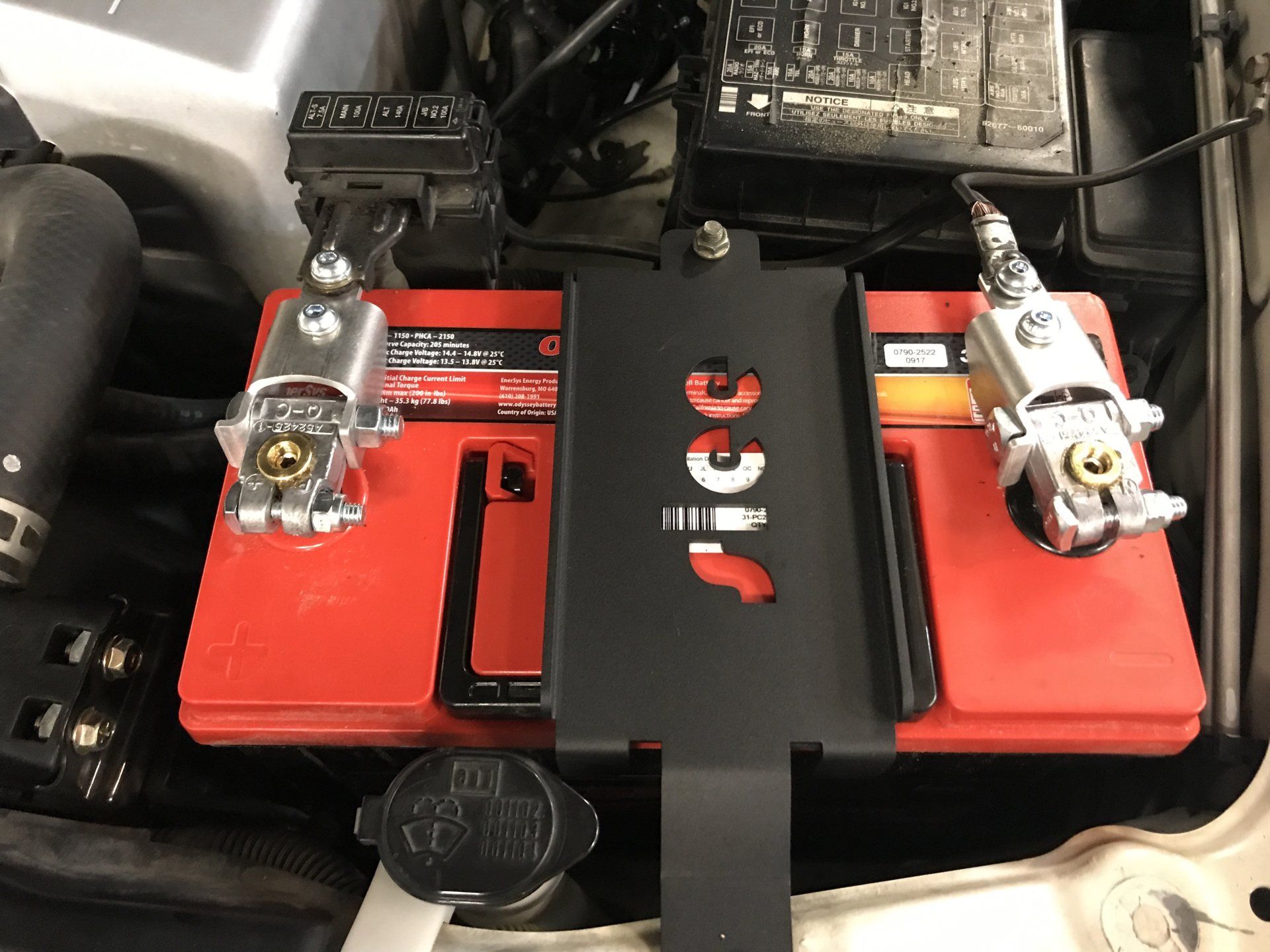

Performed a two step paint correction on the exterior, will get some pics of it tomorrow. I also upgraded to an Odyssey Group 31 battery using the Slee kit. Pretty easy install and the kit was well thought out with good instructions. This should help with extended camping trips, especially if I can get an ARB Fridge!!

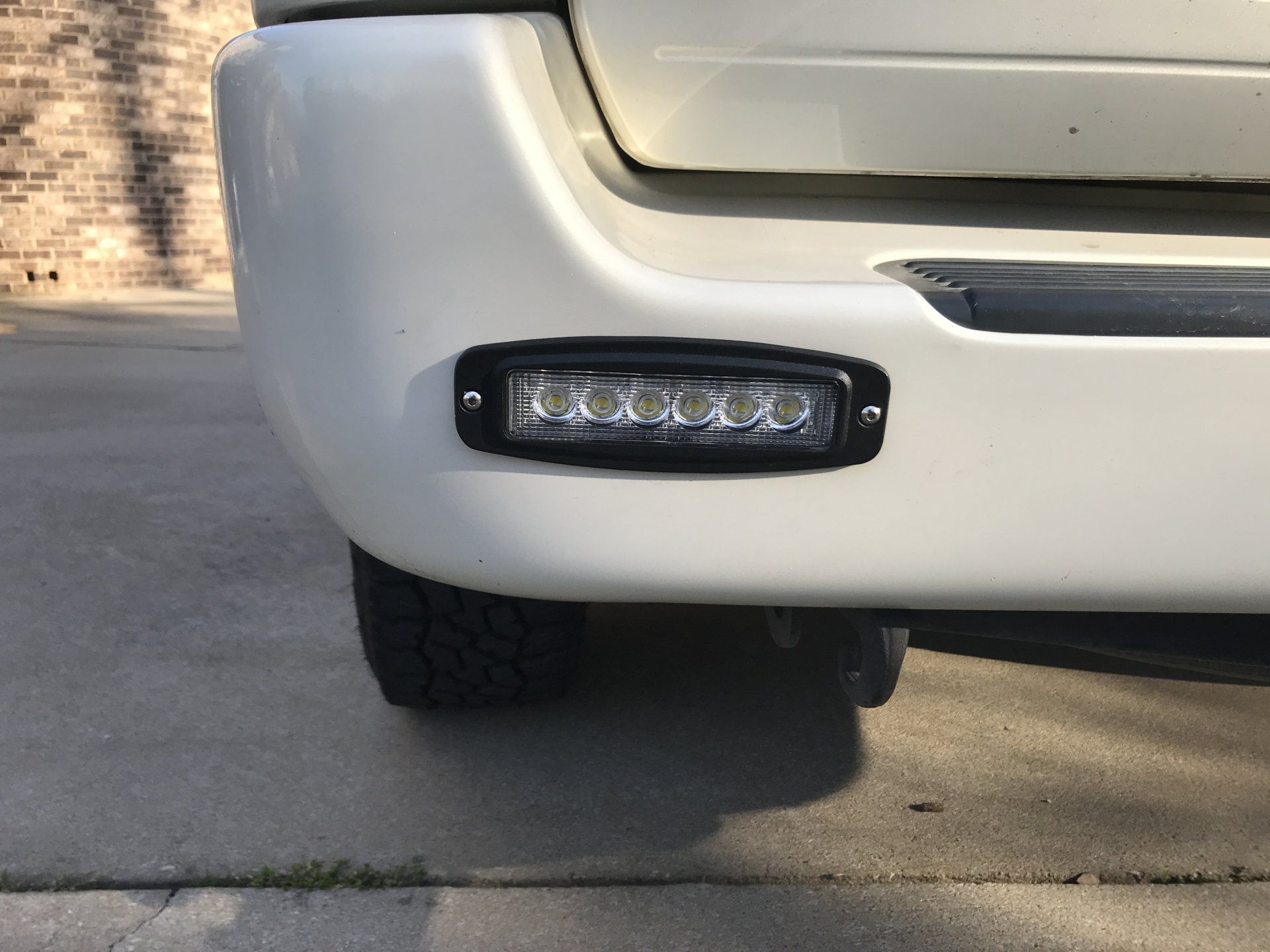

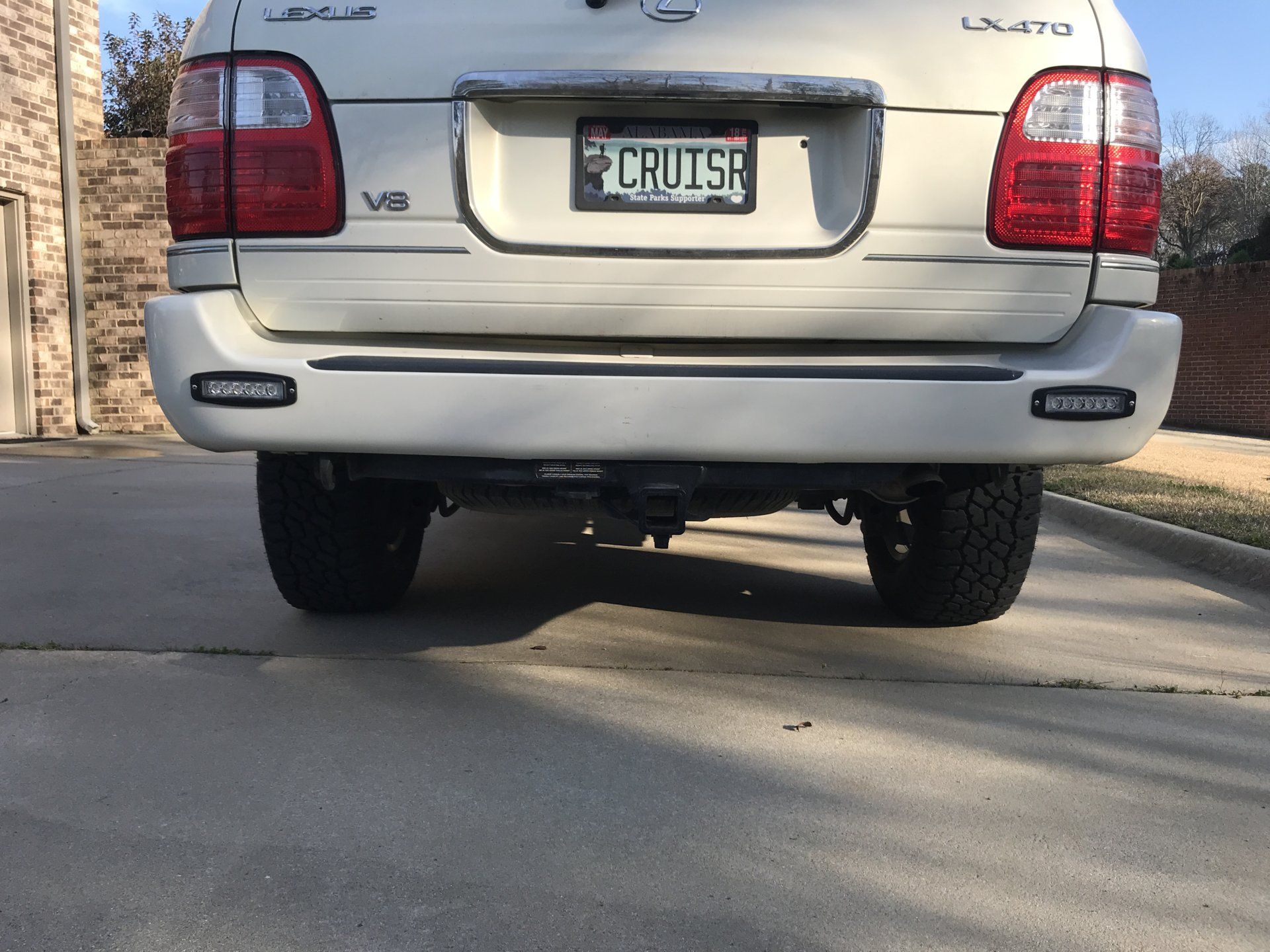

I also removed the rear reflectors and installed some Amazon backup lights. See the pics below. This really helps with the backup cam view at night.

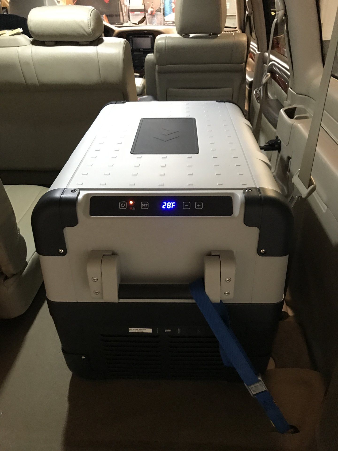

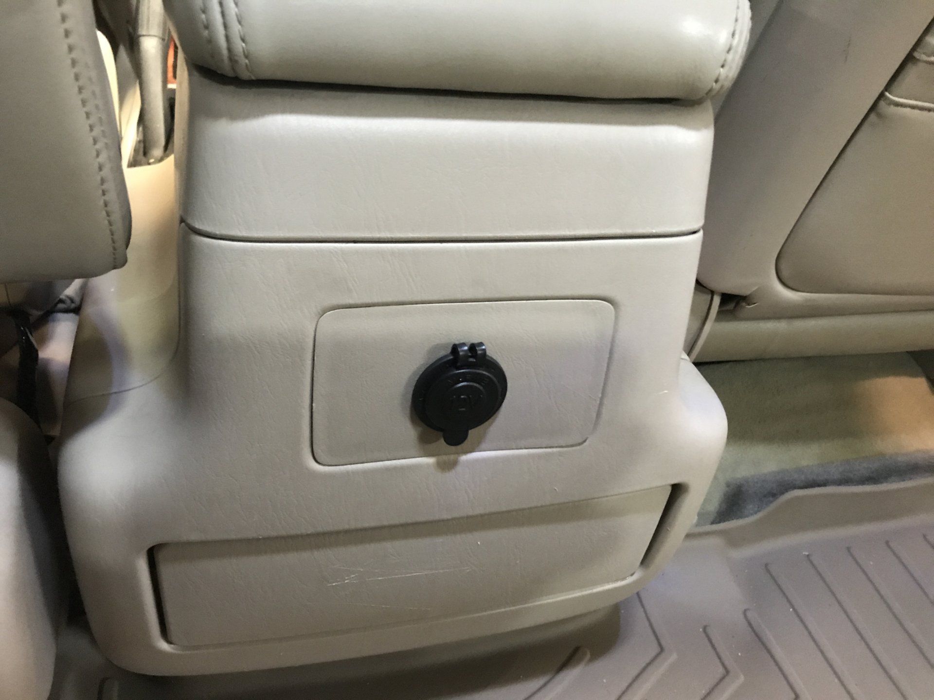

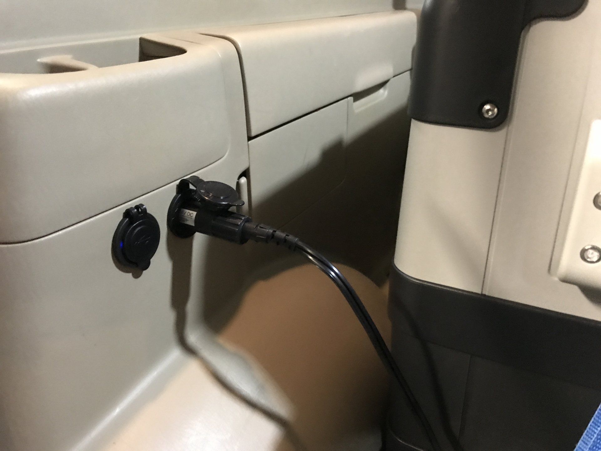

Getting ready for a west coast trip in 6 weeks. Got a Dometic fridge and needed to add some 12v outlets from the battery. Ran 8 gauge from battery over to passenger side. Added a Blue Sea 12v and a Dual USB. Also added a 12V outlet to the back of the center console. Fun project overall, tested it out with the new fridge for a few days with no issues.

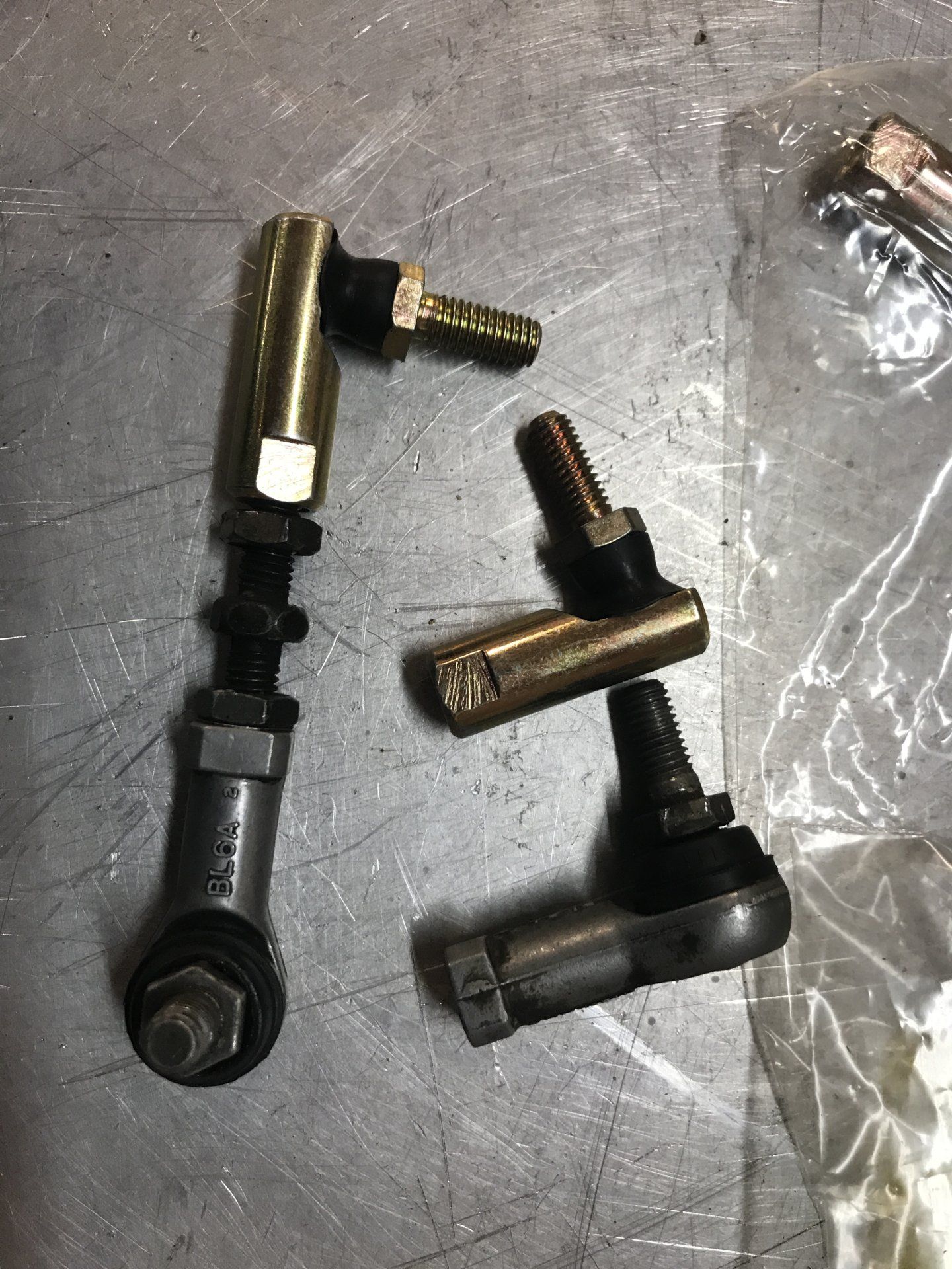

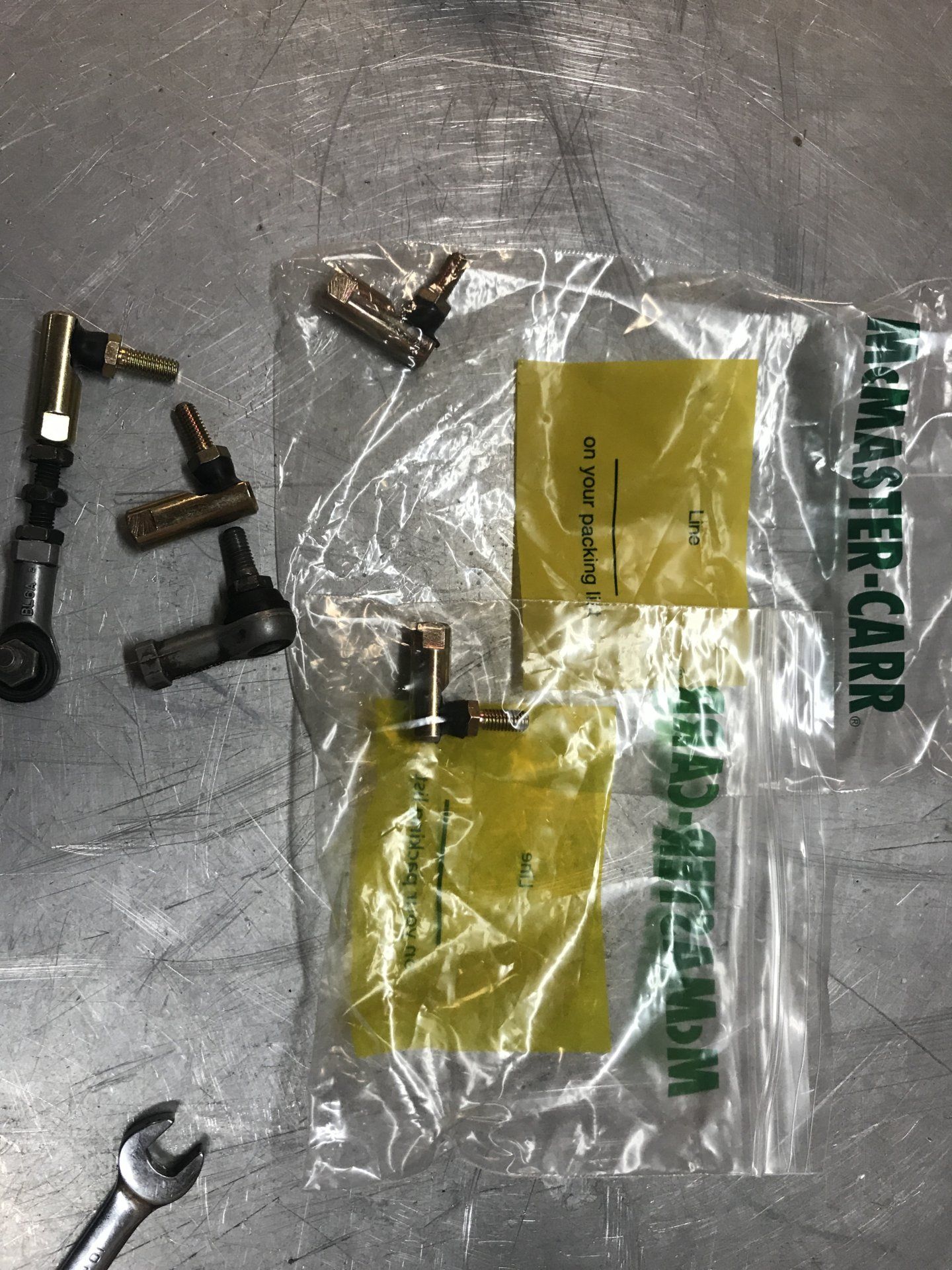

Small update. The joints on my AHC sensor arms were shot. No way I was paying $150 each for new sensors. Searched the part number stamped on the stock joint and found a suitable replacement via McMaster Carr. These worked perfectly, no issues. Total cost for 4 joints shipped was $30.
