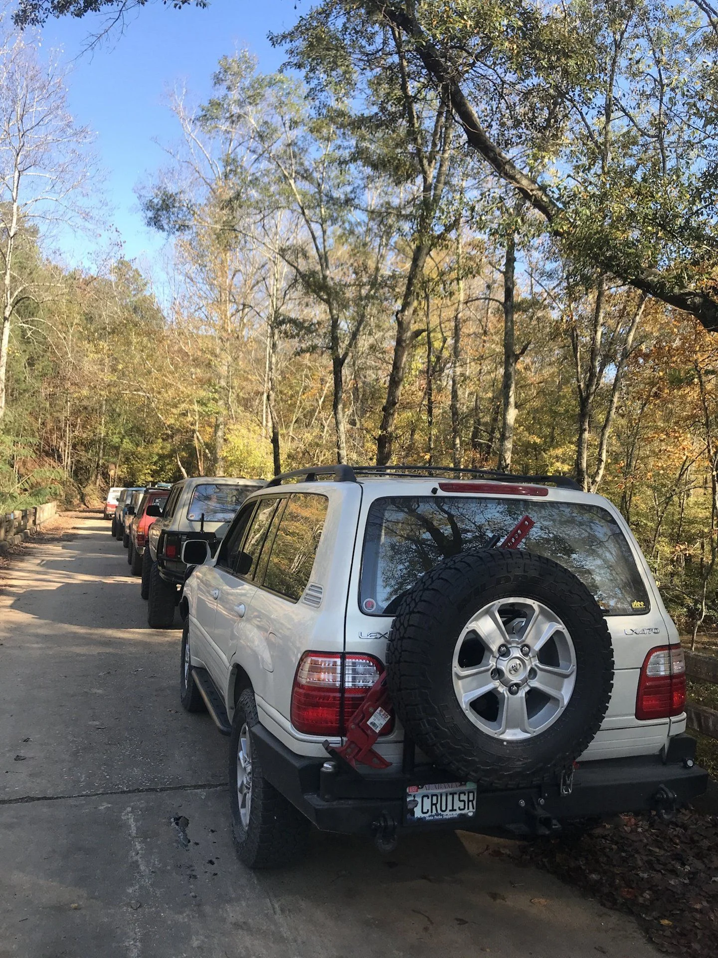

When I took the entire family to NC in October it was clear we needed more room. The rig was packed to the gills even with the Thule box. So I started looking for M416 trailer. I don’t have time to take on a project, so I was looking for one that was setup well. I came across one near Atlanta that was exactly what I wanted. Looking forward to breaking in this setup,
Bumper does look really good. What’s the little thing on the opposite corner of the swingout (kinda where another spindle would be)? A light? Back up camera?
Sweet trailer!
That is some serious bike hauling. Looks like you & the fam are enjoying the LX.
That is a Rigid Ignite backup light. It’s ok but will probably switch to a Diffused Dually for more light output.
Wow. Really tiny.
I have the PFRAN reverse lights which have helped but would still like to increase my visibility. Looked at some 3.25” traveler led cubes today (tractor supply brand) but something tells me you get what you pay for.
Enjoyed reading about your build. Now following.
Wow. Really tiny.
I have the PFran lights also but a good bit of their light is blocked by the spare tire. The Ignite light is good I will probably retain it as a aux light to help with campsite setup at night.

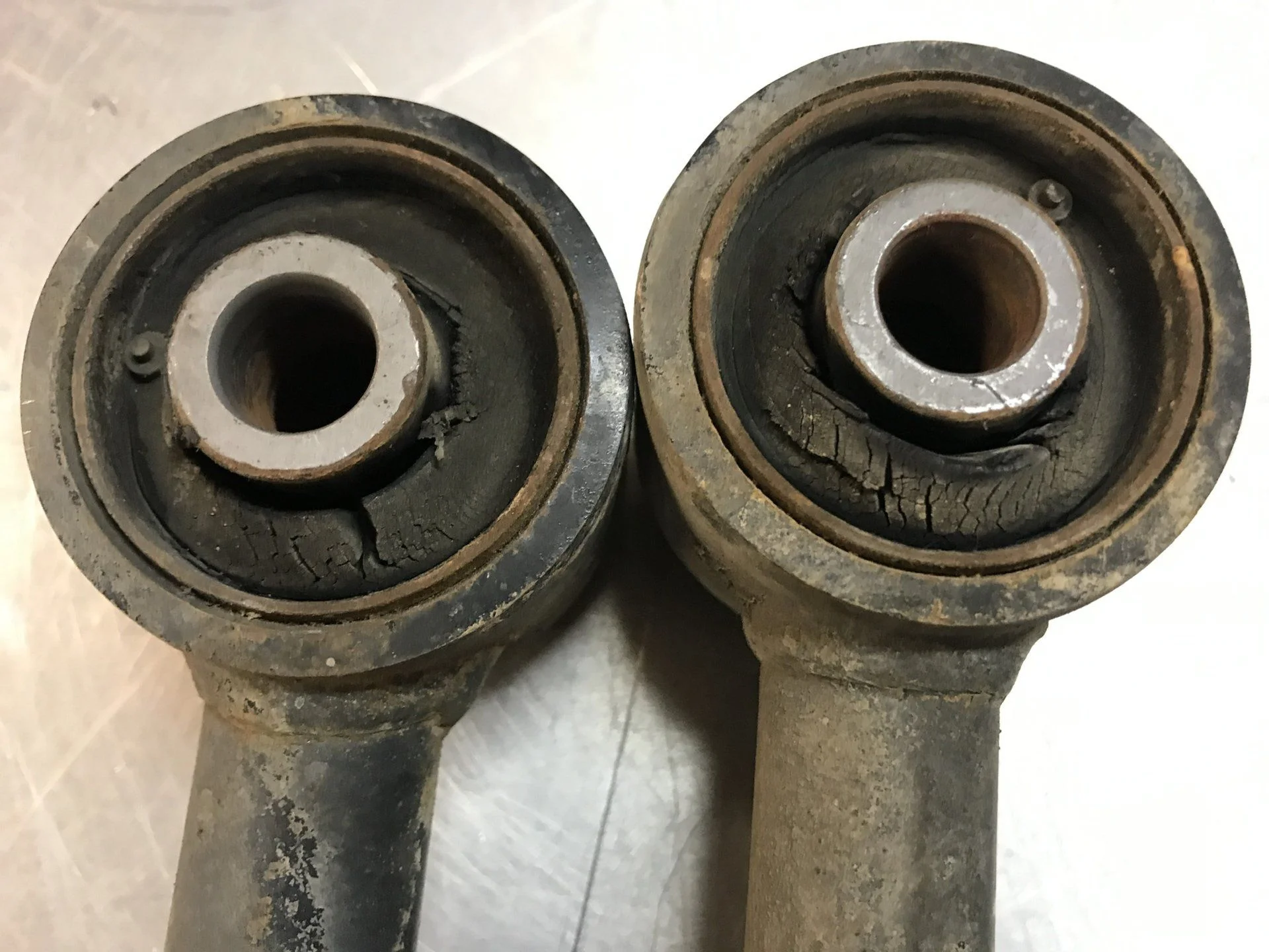

I noticed a while back that my rear suspension bushings were in bad shape. I ordered some SPC Lower Control Arms from Slee and some OEM Upper Arms. The rear bushings were not terrible but the uppers were totally shot and should of been changed long ago.
Next up was the winch which I have been putting off. I found a great deal at 4WD Hardware on Black Friday. I got a Warn VR-8 for a great price. It is probably a little light for the Cream Puff, but I will not use it much and I have a snatch block. Ordered up a 3/8” winch rope and an offset fairlead from Slee. Trying out this safety thimble from Smittybilt. The Factor55 stuff was way too rich for me. Lol. Only thing left to do is spool the rope on. I will say this feet forward install is a PITA and relocating the control box took the longest time by far.
Does the truck feel better with them replaced? Looking to do this as well. How come SPC for lowers?
I called Slee and asked what they recommended. They said SPC.
Truck driver better for sure. Also No driveline thud when going from R to D.
