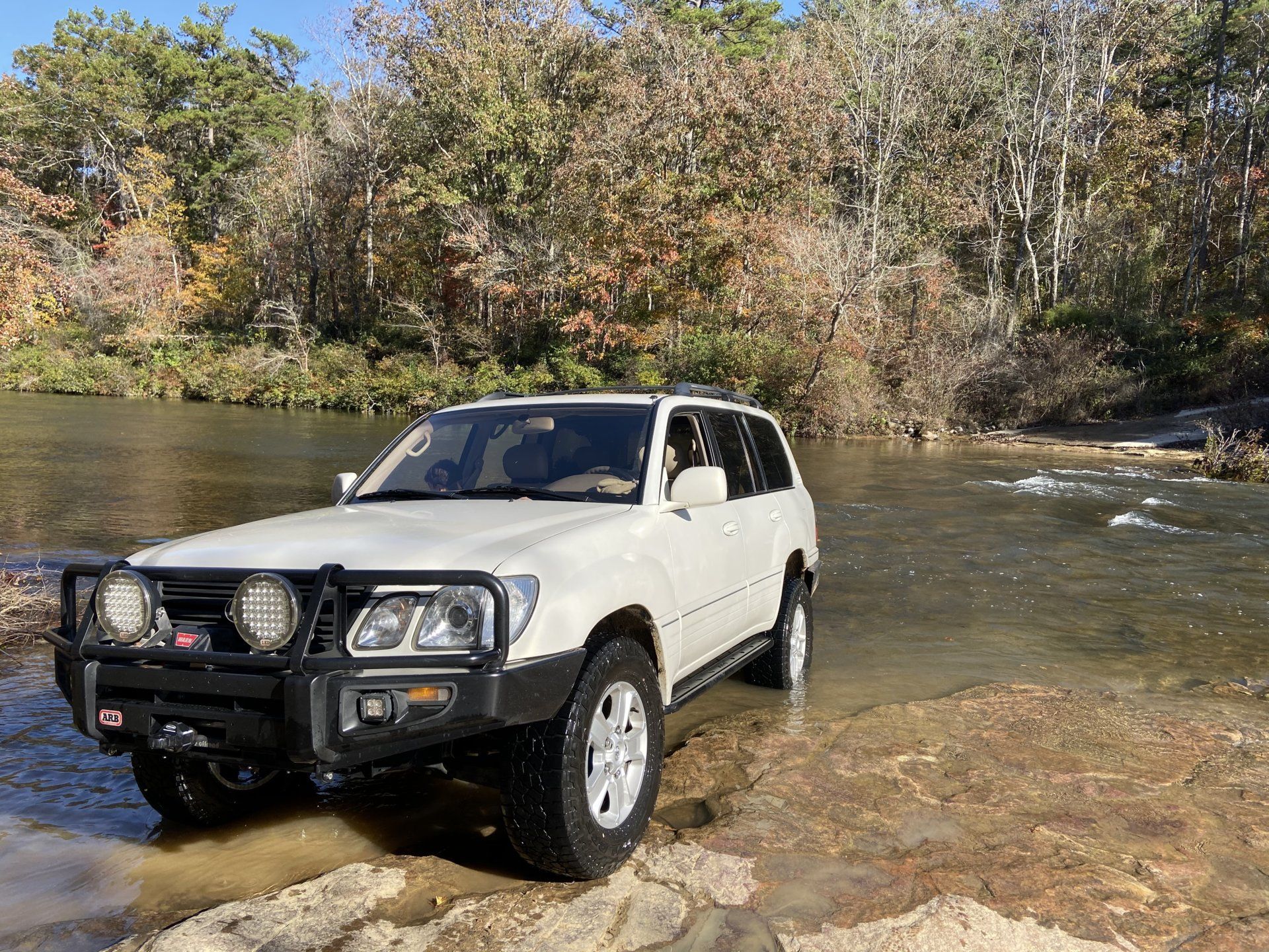

Updates from recent trips. Lots of adventures in this 100. Almost at 220k miles and still going strong.

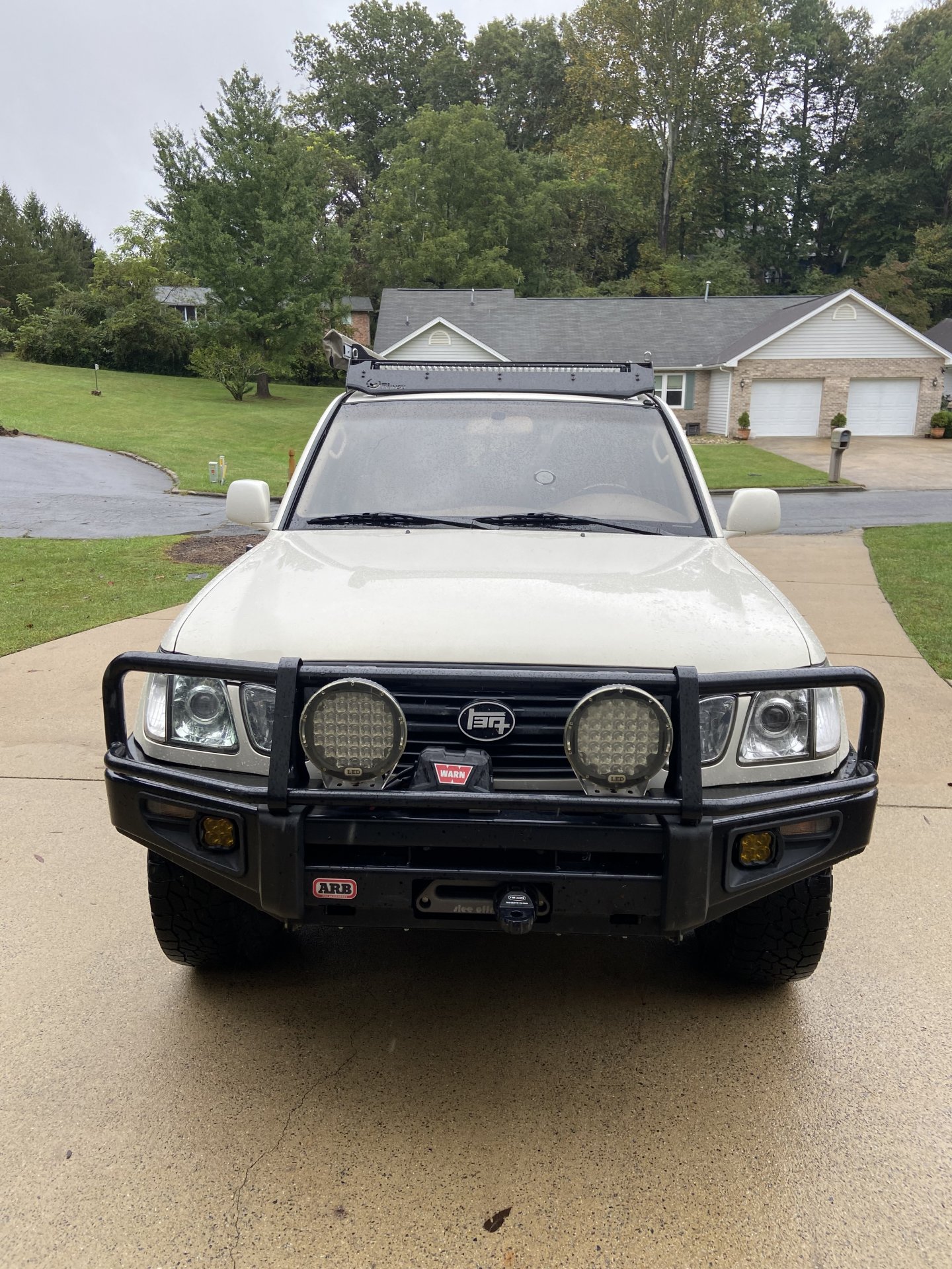

Been a while since I updated. Really not much maintenance to be had. Added Freedom UCA, oil changes and tire rotations. Have done a few upgrades. Prinsu Rack w/ LED Lightbar and Awning. Diode Dynamics Pro Series Lights to replace my Amazon special lights that were chipped and looked light crap. Just rolled over 240k miles. Not much planned for the future except keeping it running. I have ordered new AHC globes, so will be replacing those. Best vehicle I have ever owned.

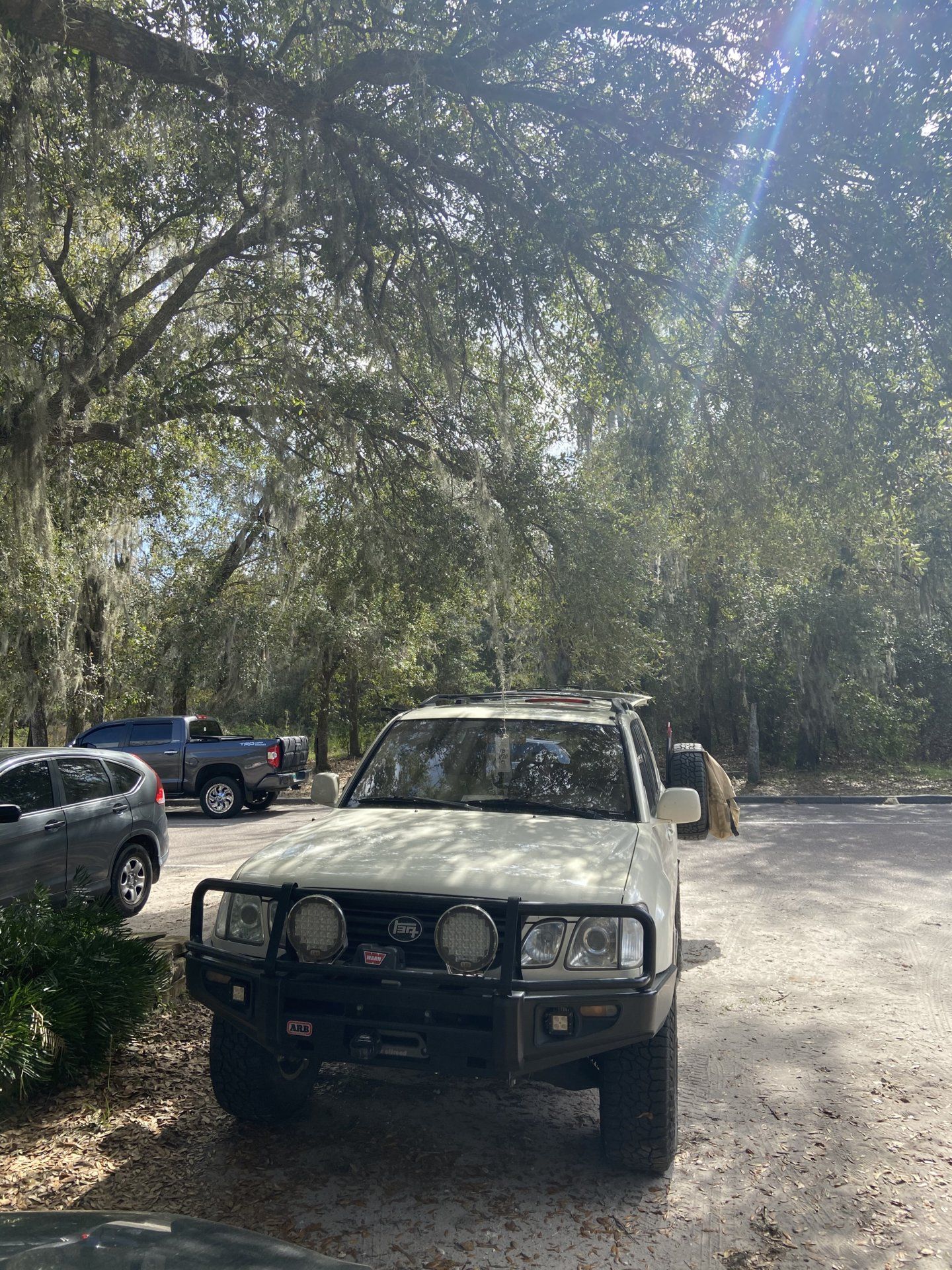

The Cream Puff is still doing great and has taken us on many adventures this year. Spring Break camping trip to FL and then to Shenandoah NP via the BRP. Great family times and the vehicle always performs flawlessly. I have done a good bit or maintenance over the past year. New globes and AHC flush. Globes had 245k on them and were right at 7 on the low to high test. Easy job that offered a great improvement in ride quality. I had to replace the power steering system due to using a stop leak product. Local shop replaced pump, lines, and reservoir using OEM parts. Also replaced valve cover gaskets that were leaking. Front CV’s were also replaced due to leaks and torn boots. I went back with aftermarket because the cost of OEM’s is crazy. Last set of aftermarket’s made it 3 years and only cost $200 per side. Also replaced rotors and pads all around. Next project is bushing refresh, index torsion bars, and get AHC pressures as good as I can. Here are some pics of recent trips and parts about to go in.

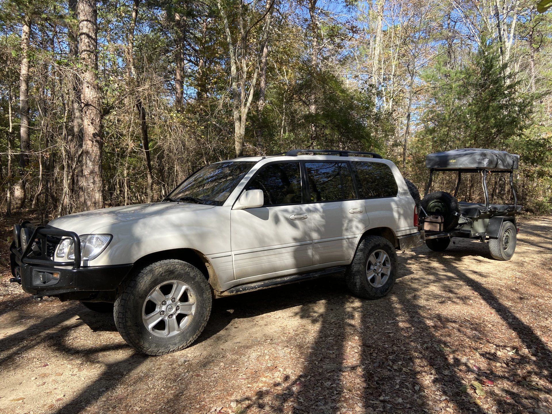

Few more pics. Love this rig. It recently got an exterior detail and looks great now! Also added the Ironman awning a while back and a new set of BFG AT's. I loved the Wild Peaks, but the cost is sky high now. Never thought BFG's would be less expensive than the Falkens, but they are.

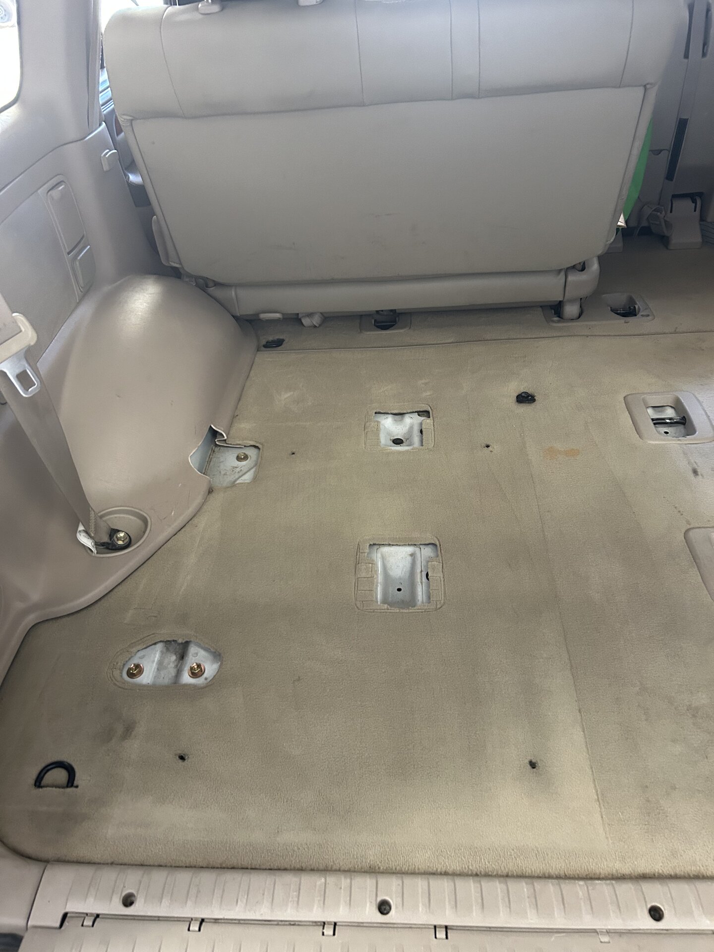

Future mods are to add a single rear drawer so I can get some organization. I need one rear seat, but I have the fridge permanently mounted in the rear and plan to reuse the Dometic slide on top of the ARB drawer with fit kit. Also, in our area scheduling auto repairs is a week or more out. We want to have a backup vehicle in case one of ours goes down and looking at potentially getting an 80 Series!

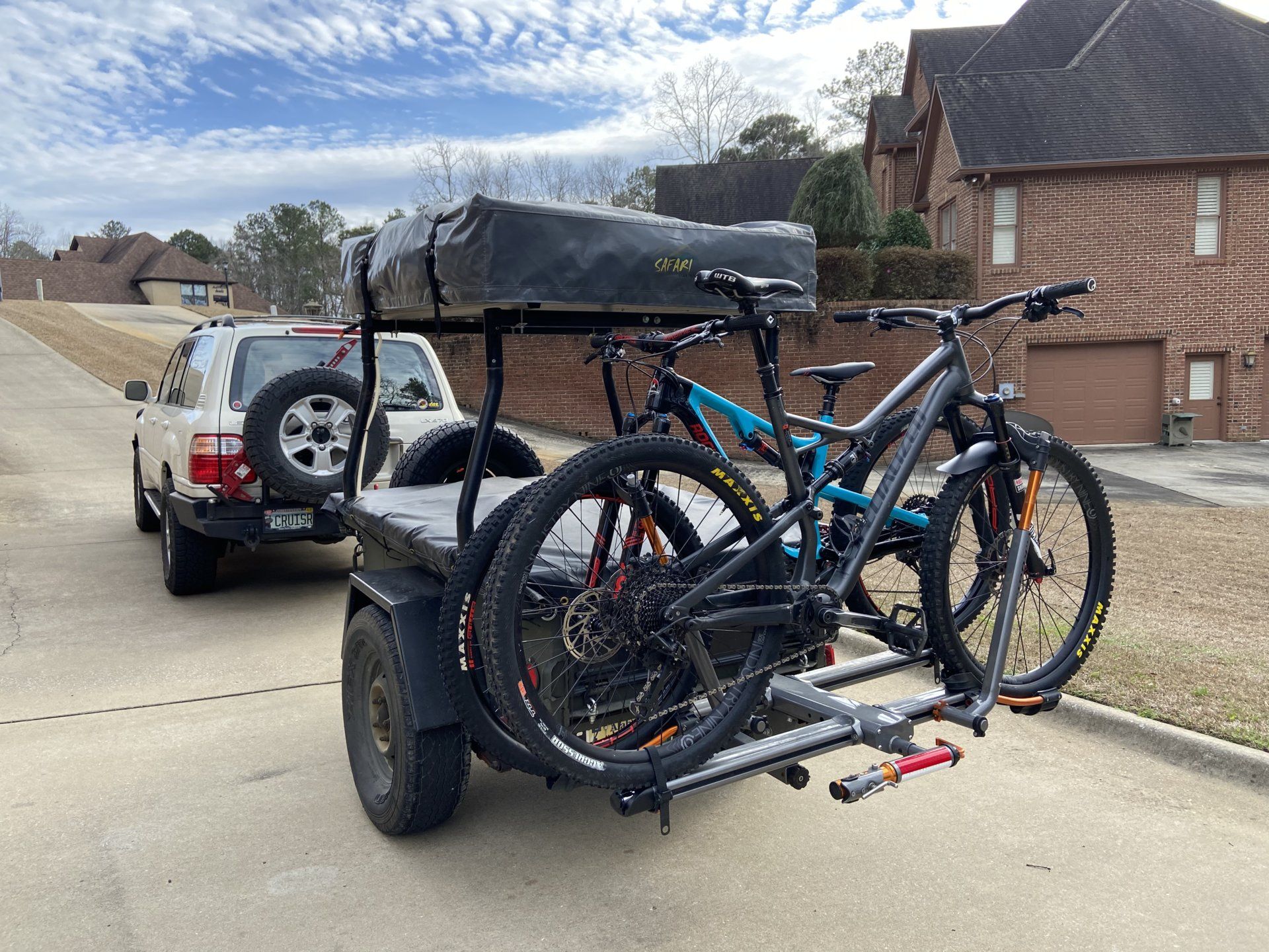

Few pics attach with my M416 setup. Enjoy.
