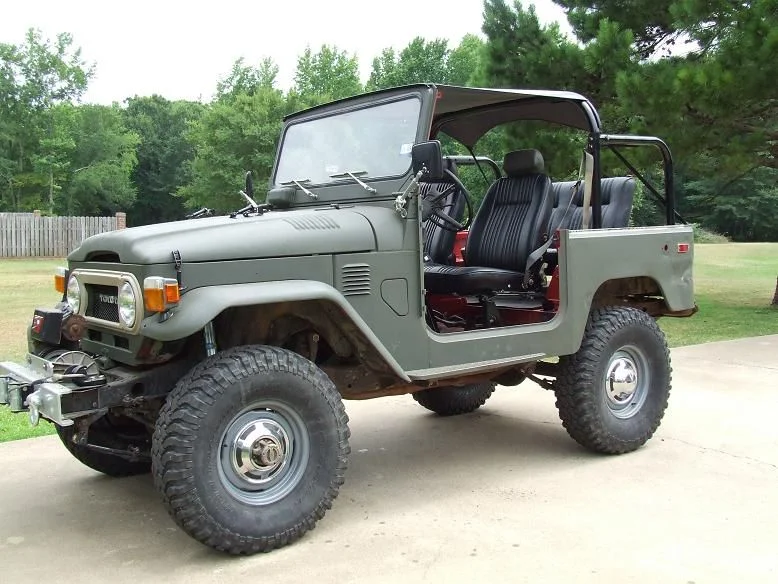

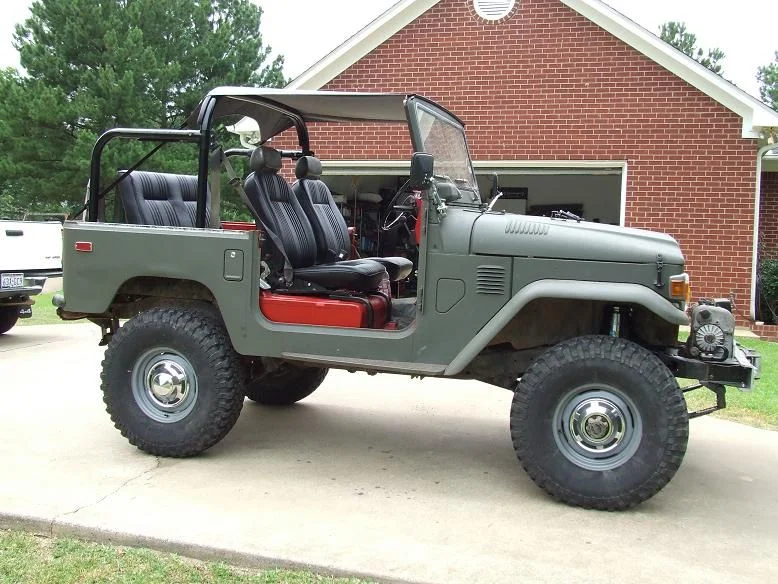

Finally got my seats back !!!! I have been waiting patiently for my friend to finish them. He did them as a favor so I just had to wait.
While waiting, I detailed the interior some and installed my skyjacker 4" lift with bilsteins.

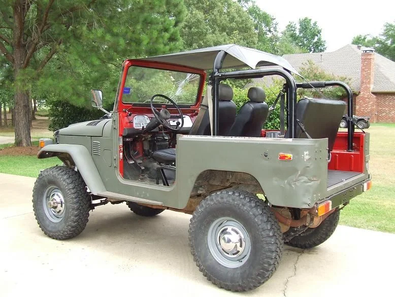

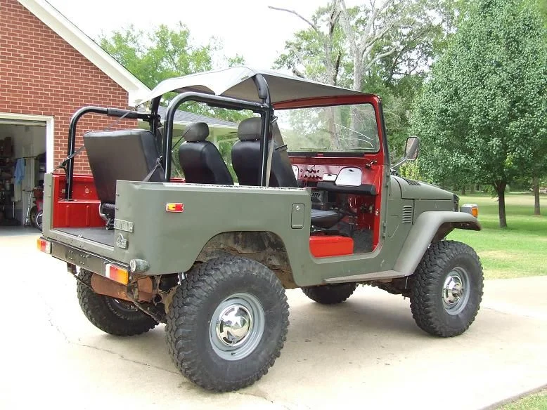

One more pic...

Those seats look pretty darn nice, and I like the way your friend matched the back seat...looks like it was worth the wait :cheers:
What rear seat is that?
BTW...your cruiser no longer looks like it did the day you got it...looking good :cheers:
Cool rig man. Just came across your thread for the first time. I like the flat paint too. I am in the middle of a "rattle-can resto" as well. How's that lift working out? Do you mind telling us how much the skyjacker/bilsteins set you back?
The rear seat came out of a 87 or 88 Dodge Raider. I did the research here on MUD, then found one on craigslist with retractable seatbelts for $40. It folds and tumbles and fills the 40" of space between the wheel wells nicely.

Looks dang good man. Careful, looks like those rear shackles could invert at any second...

Copenhagen1, Does the rear seat happen to have three seat belts, or just two? I'm looking for a seat that has three for my three kids. I was thinking about making a third row mini van seat work, but that is going to require some cutting and fabing the rear finder wells.

can you put up a picture of the rear seat mounting with hardware & with the seat folded & tumbled?
Seat is not mounted yet. I just set it in there for the pictures for now. I am going to try to have it mounted within a week or so.
what did you do for reenforcements for the mounting of the rear seat?
The seat will have 4 bolts to the floor. The front two holes in the seat frame are just fractions away from the two large existing bolts that hold your tub to your frame. I haven't done it yet, but I think I can slightly enlarge the holes in the seat frame to make those two body bolts work.
In the rear two holes on the seat frame, I will have to drill holes in my floor pan. I will also have to mount the two retractable lap belts also, so I am thinking of drilling and tapping a piece of plate steel for the bolts to pull against on the underside of the bed.
Your 40 looks good by the way, nice work.
Mike
Mike ... it only has two seatbelts. Thanks for the compliments.
