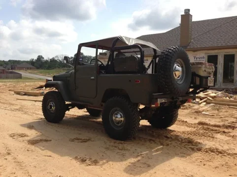

Ok. I am going to try something new. Whenever I try to insert photos that were taken by my iPhone, they sometimes wind up rotated funny if I send them from my phone to my computer then post them. They never seem to act funny if I post them straight from my phone to Mud. So I am posting this from my iMac and then I will try to edit and add pics from the Mud app.

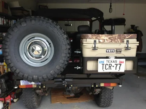

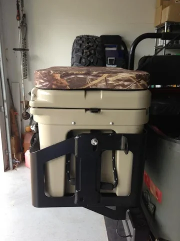

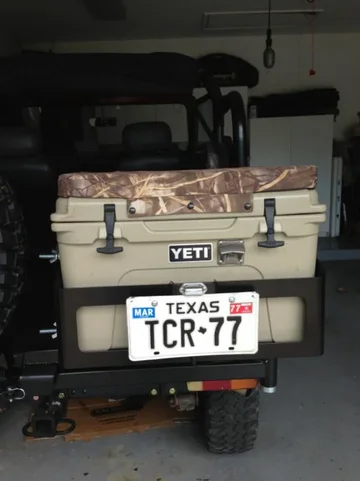

The 4 plus bumper is a very very nice design. I am very pleased with it. I ordered the flat stock basket because it is a little bigger inside dimensions. I knew it was going to fit my 45qt Yeti that I have owned for about 2 years.
It did add a little weight to my rear end and it did soften the ride. I now have a little shackle angle(maybe 10*) but I have ordered new 4+ shackles from Dave. I ordered +3/4" for the front and +2" for the rear. I think it is going to make a big difference once installed. I will post up when I receive them and get them installed.
Here are pics.
This is how the 45qt Yeti fits in the flat stock basket. It is a perfect fit. Here are some up close pics....

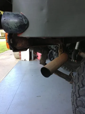

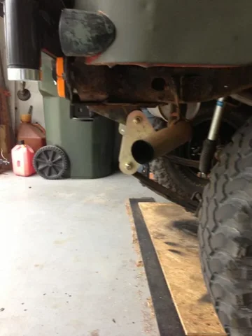

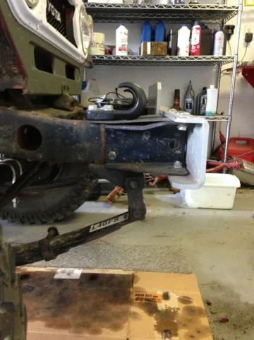

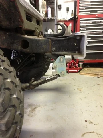

Alright I received the shackles from Dave and they are very sturdy. They didn't do as much for my shackle angle as I would have hoped but maybe now the springs will relax a little. I think that the weight of the new bumper and the length of the new shackles have combined to help soften my ride considerably. It isn't near as harsh as it was. At least now I am not thinking of purchasing all new springs. I can definitely live with these now.
Here is the front.
Before:
After:
Here is the rear shackles:
Before
After
Sent from my iPhone using IH8MUD

crazygreek can you see the sticker on the front spring in the front shackle photos? the sticker is from Skyjacker and says L40FS. I wonder if the "S" means "soft ride"? Or maybe it means Skyjacker? :meh:
