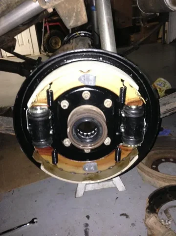

Moved on to the rear axle and realized that I had seals leaking
So I got online and ordered new bearings and seals
Got them installed today and continued putting my new OEM brake parts on
Anyway, I am having a lot of fun fooling with it. I have realized that my least favorite thing to do is refinishing existing parts. I wish I had the patience that some of you guys do to spend the time to sandblast, paint, re-plate nuts and bolts but I just don't have the patience. I want it to run and drive like a brand new FJ40 but I really don't mind if it looks like a 35 year old truck.

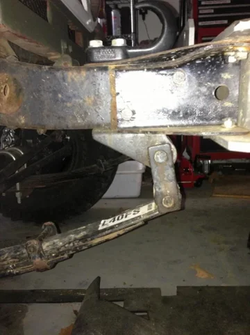

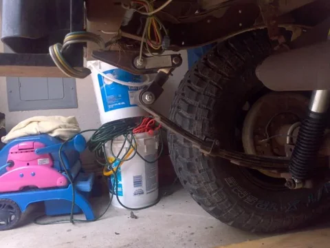

A while ago I mentioned that I installed a Skyjacker 4" lift. Since the weather has been nice I have been driving my 40 almost daily. It has begun to bug me how stiff the suspension is.
Is it because I have no weight on it? The top and rear ambulance doors are off. I do not have a spare tire carrier or spare tire installed. I also took the Warn 8274 off the front bumper in order to refurbish it.
I have been researching LCWIZARD's rear bumper with tire and cooler swing outs. Would the weight of this help make my suspension loosen up?
I will attach pics of my front and rear shackles as it sits right now.
I know shackle angle is important but what are some suggestions that i can do to affect it?

I have always heard that the skyjacker spring pack is rock hard, so it sounds like unless you're going to buy OME springs you will just have to get used to it.

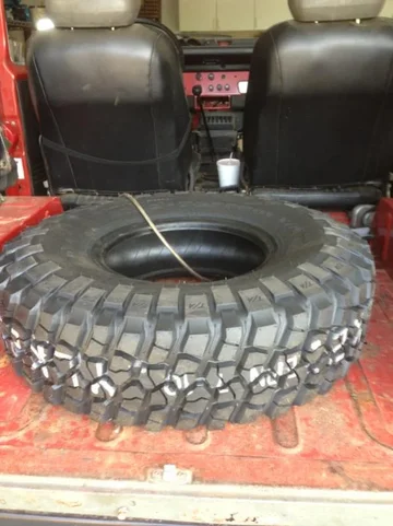

In anticipation, I ordered a new OEM steel wheel and a new hubcap from Toyota. I got them yesterday and scuffed up the wheel and painted it to match my others. Krylon Smoke Grey is a very close match to the factory gray wheel color.
I also ordered a new BFG KM2 to use as my spare. My other 4 are the original style BFG Muds and I hate for them to mismatch but sooner or later I will replace the other 4 with KM2. Not sure I will ever wear them out but the age is going to come into play soon.

You might want to think about some shims here. From my understanding, I believe that will bring your angles back to correct position. I read to be sure to buy the steel and avoid aluminum for longevity reasons.
Also, you might try flexing your axles on some ramps to see if that will loosen them up. I am going to try this to see if it helps at all.

You may not have enough shackle for a 4" lift. . Most 4" springs are at least an inch longer that a stock spring. You might damage the spring under compression or, at least, the spring may not fully compress when the shackle runs out of travel. Find the eye to eye specs on the Skyjacker leaf and compare it to stock. Ad the appropriate length to the shackle
I ran a 2.5 inch skyjacker lift. It was a "Soft Ride" version. Is your 4 inch a soft ride? I think each lift size has a soft ride option. My 2.5 inch was the best riding set of springs I have had on a cruiser. And my shocks were just pro comps.

I had the same thoughts as you, add more weight, even though I was already running the hard top, full size spare, etc. My brand new lift had horrible shackle angle, pretty much vertical front and rear. I also have extended shackles, about 2 extra inches over stock.
I ran enough weight in the back that my tub metal actually got stretched in the rear :mad:, and still no change in the shackle. So after talking to a fellow cruiser head, he recommended pulling a few of the springs off and seeing where that netted me. Cost me nothing more then a few hours of work. I didn't completely remove the spring that is attached to the bushings/hangar, just dropped everything else. Once that was done, I cleaned up the rust between the springs (brand new springs and they were already rusting in the middle where the paint rubs off), and added a bunch of dry graphite spray.
I ended up settling at 3 spring removed on each corner, so I went from 7 springs down to 4. Now the truck rides like a new car, and the shackle angle has improved a bit. I'm finally getting decent flex! I did lose a little on the lift height, but not enough to matter. It's well worth a try, and you can always put the springs back in if it doesn't make a difference.
are you running aftermarket shackles? if so, how tight are the bolts? overtightening will not allow the spring to flex like it should
How tight should the bolts be? Do you know a rough torque spec for the shackle to spring? I had Mark's offroad initially install my lift, so I would presume it was torqued correctly, but I can always double check just to confirm.
Kerry, I bet shackles help but no guarantee for smoother ride. I have these teraflex shackles and stiff rough country springs. The bilsteins helped but I need shims to bring the axle back to center..
I have actually left it parked in a bar ditch with the suspension torqued for a few hours at a time. It didn't seem to loosen up much. May try it again though since I haven't thought of that in a while.
This is interesting. Can I measure eye to eye with it on the truck and then measure the oem spring eye to eye on the shop floor? If I find out that the skyjacker spring is 1" longer (for instance), would I then buy 1" longer shackles than stock? Can you elaborate a little on this? I am not opposed to putting longer shackles on it than stock but I thought people usually put longer shackles just to get more lift. In my mind, I didn't know that it could correct suspension geometry. If you could tell me more about this that would be awesome or give me a link to study.
I purchased these used out of Houston but when I got them they still had the stickers. I am not sure they were ever actually mounted but I also do not know if they are "soft ride" since I didn't order them new.
....I ended up settling at 3 spring removed on each corner, so I went from 7 springs down to 4. Now the truck rides like a new car, and the shackle angle has improved a bit. I'm finally getting decent flex! I did lose a little on the lift height, but not enough to matter. It's well worth a try, and you can always put the springs back in if it doesn't make a difference....
I may have to try this eventually.
No. These are factory I am pretty sure. I was very careful when I installed them not to over tighten. I had to buy all new Skyjacker bushings because there were none in the springs when I got them. I made sure to leave them where they can cycle like they should but not tightened down to a point of crushing the shackle or bushing.
