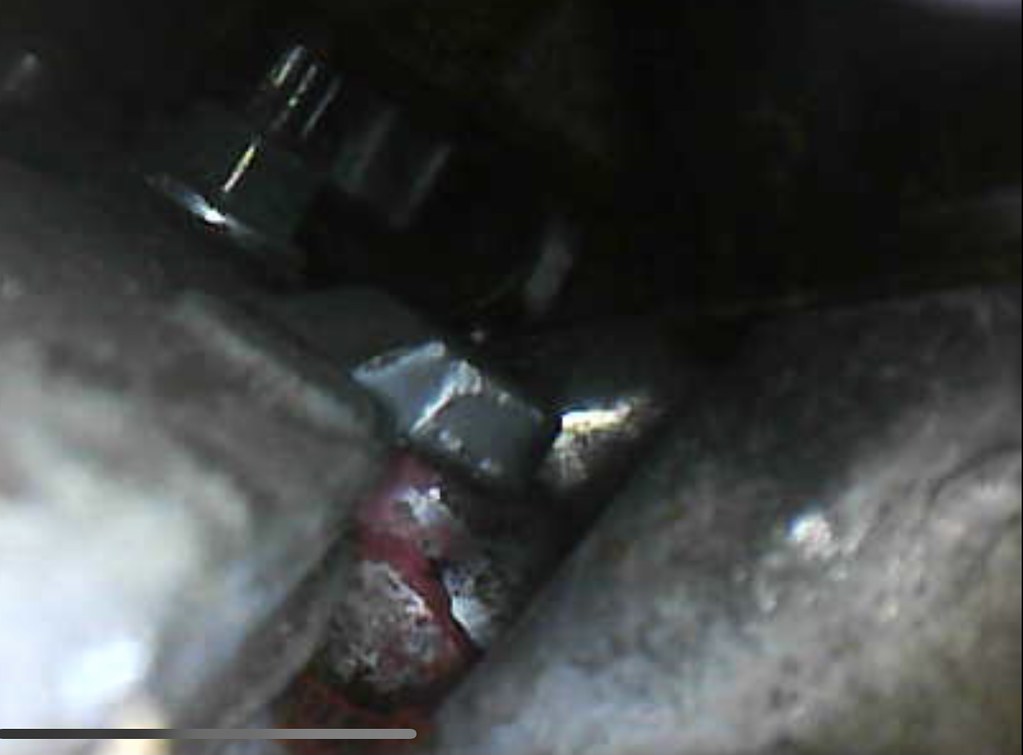

I've been losing some coolant out of the bottle lately... Thanks to this thread, sent the borescope down under the intake and saw the dreaded pink sludge way back on the plate. Guess I will have the "right of passage" of making this repair!
