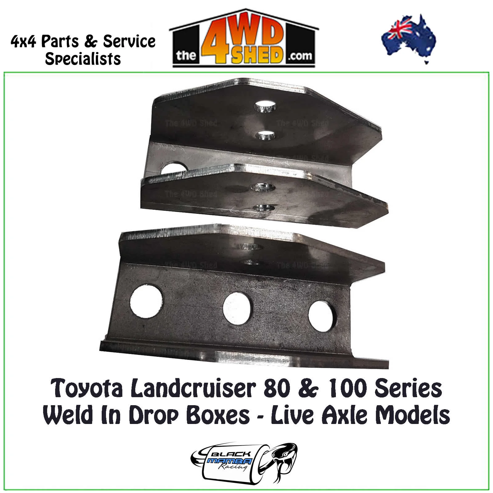

Also since not too many seem to be familiar with these I'll post the Black Mamba drop boxes I'm running. They are designed for a 3-4" lift but do so with only a 2" drop and moves the radius arm 12mm forward. Corrects about 5 degrees of castor. These are a weld-in affair but still maintain OE radius arm to chassis mouting point if you ever want to revert back. But if you do so you may want to cut out the drop box so it no longer hangs lower.
80/100 Series Weld In Drop Boxes - Live Axle Models - Black Mamba Racing

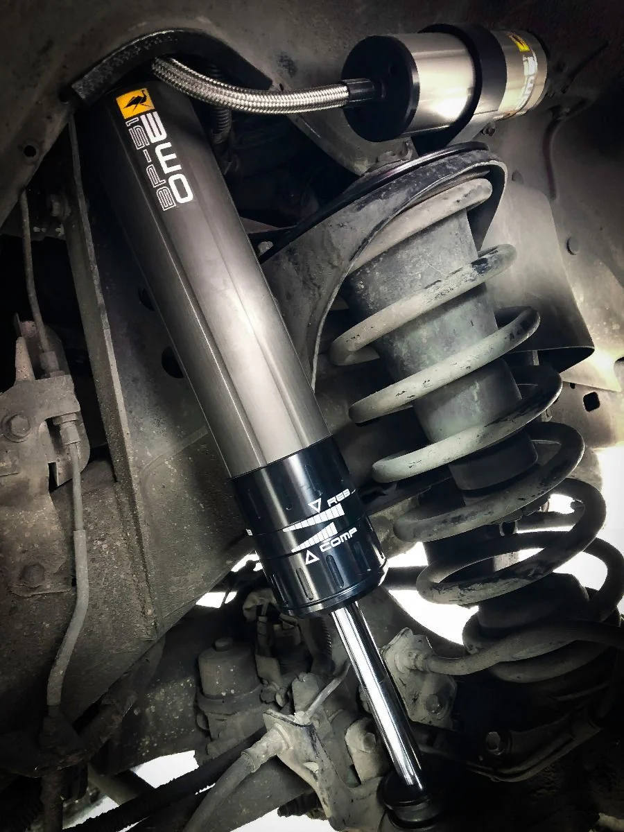

I came across this today. Enjoy.
Those are quite nice especially with the built in 1" spacer which is what I was looking to do once my bumper+winch is on. King hydrop bumps wont allow you to run spacers. Look to only be for the fronts. Wonder if they'll ever design rear ones. I'll try shooting them a message...
