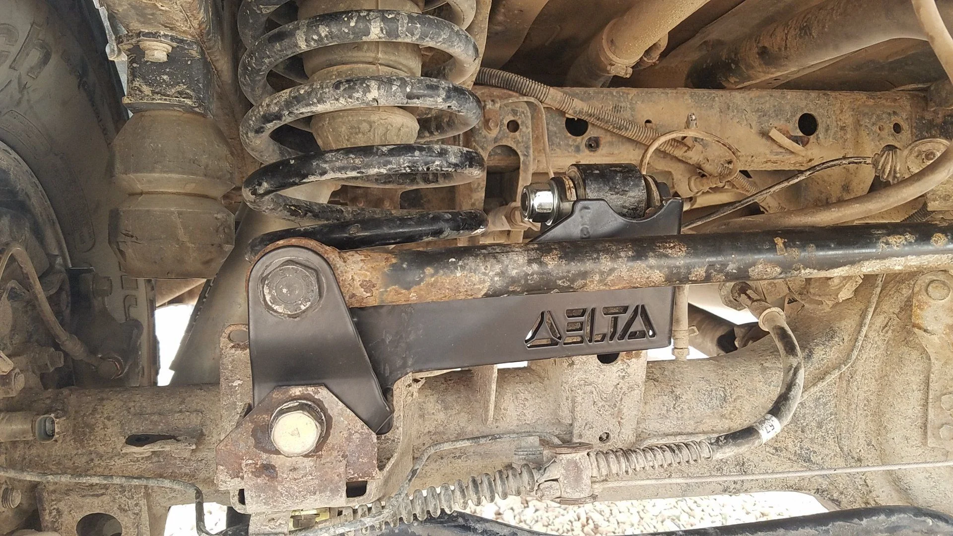

Installed my new @Delta VS Panhard Lift Bracket this afternoon....the claimed 15 minute install is MUCH greater on a well worked POS like mine, but the effort was 1000% worth it... $250 well spent. NO more rear end wiggle when in/out of the throttle. Able to go back to a stock rear panhard. NO contact on the drivers side Timbren bump. Noticeably better handling for the short run I just made.
FJ80 Delta Panhard Lift Bracket
FULL test next week, Rubithon and back.....but first impressions are excellent :)

I noticed the "rear end wiggle" when I had my J coils, and the Slinky suspension didn't change that feeling. My old OME heavies didn't make it noticeable....so based on that, anything 3" and up :-)
the wiggle makes sense since the pan hards are on opposite sides and shifting the axles opposite directions. By leveling the rear panhard you are minimizing that motion. Front is stuck being angled unless you do a high steer or some sort of drop pitman arm, just have to live with it unless you want to do a lot of work.

IMHO you would need an adjustable panhard in addition to this for most applications. Otherwise you may have a not perfectly centered body/frame over your axles with regard to the rear. That would depend on your lift. 3-6" lifts are not going to be the same. Not all trucks are going to be "corrected" with a bolt on- non adjustable panhard length.

This particular one (the “stocked” bracket that we will keep on the shelf for immediate shipping) actually lifts the panhard 3”. We can adjust for any lift desired, but that will be a 2ish week turnaround as they will be made to order. This 3” bracket works great on @swankstars rig that has OME 2” lift (with no bumpers or spare, so it sits a little higher), as seen here:

This particular one is exactly 3”.
You are quite correct that lifts aren’t going to be the same. Our goal is to get rid of adjustable panhards though, as we can easily make one for any lift height desired. Bump stop extenders (on the frame, not inside the coil) will be absolute necessities if going with anything over the standard 3" version (they are recommended for the 3" bracket, but not required).
Curious why do the bumpstops need to be extended with this and why to they need to be on the frame and not inside the coil?
Well, they really could be either now that you mention it. MUCH easier to mess with the ones on the frame though.
Any way about it, they need to be extended if you’re going big lift because otherwise you WILL have frame to pandhard bracket contact on a heavy compression.

Really cool product, has anyone tried rear driver side at full compression and make sure it clears everything? I don’t remember there was much space above the mount.
