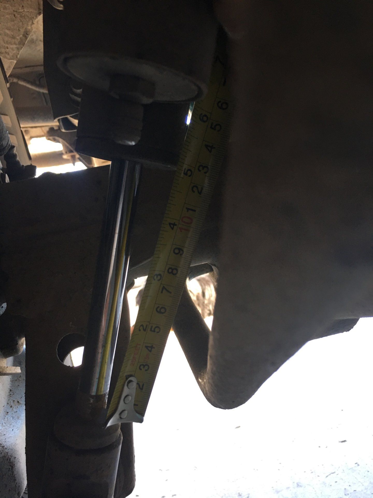

And here is my shock travel with a 10” travel Fox 2.0 remote reservoir, eye to eye with upper mount eye adapter dropping the mount 1.25”.
Bumpstops are dropped 2”, which perfectly protects the upper travel limit.
That’s right in the center of the shock and spring travel and for me a perfect application of these 4” Flexi coils. Dialed.

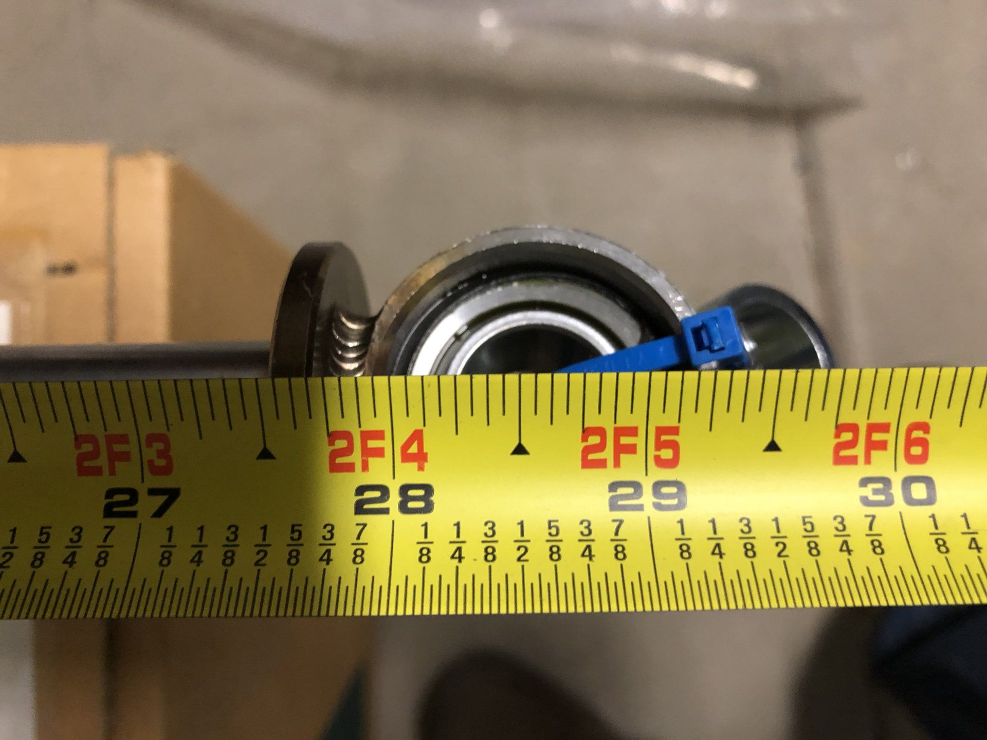

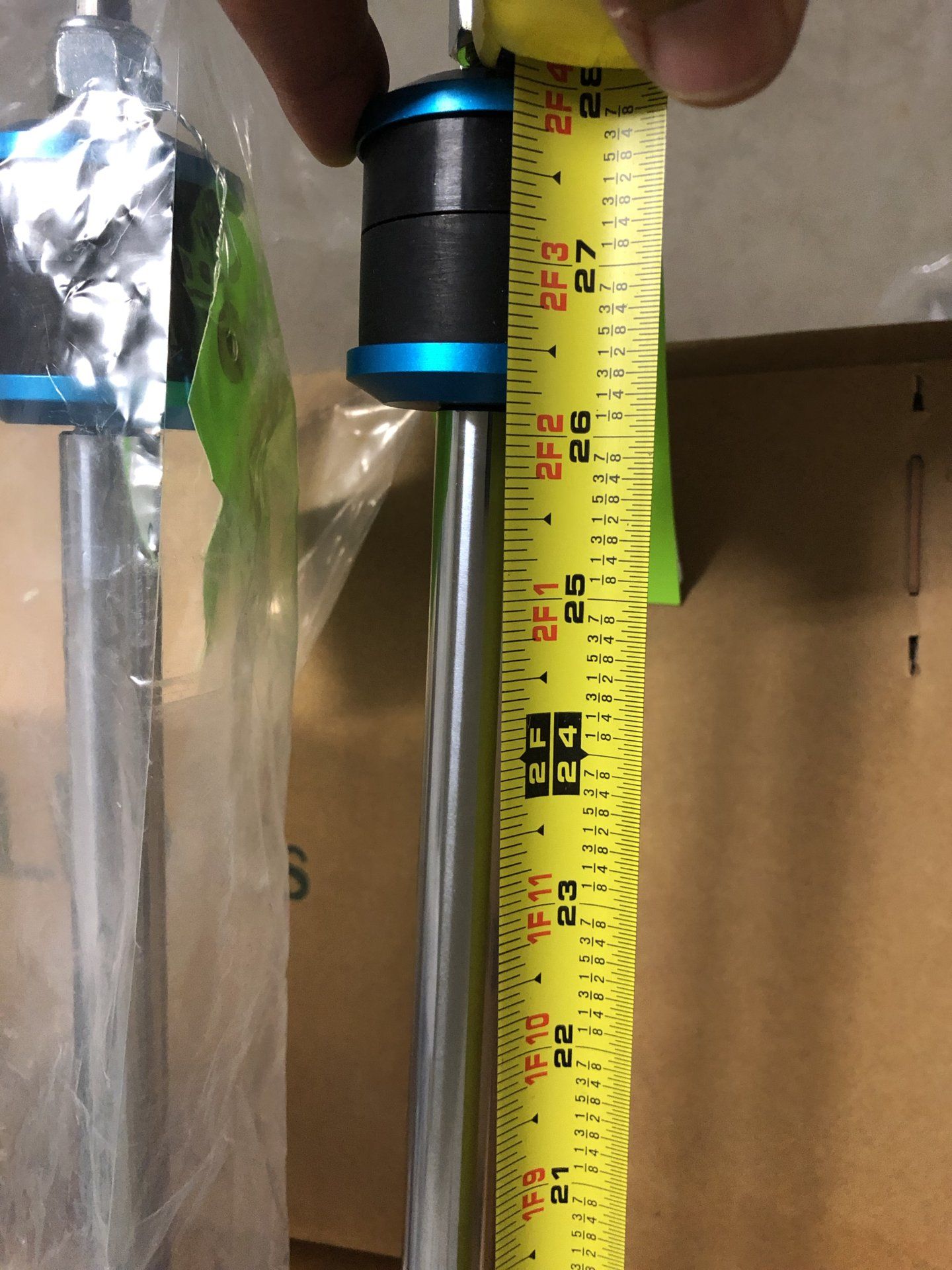

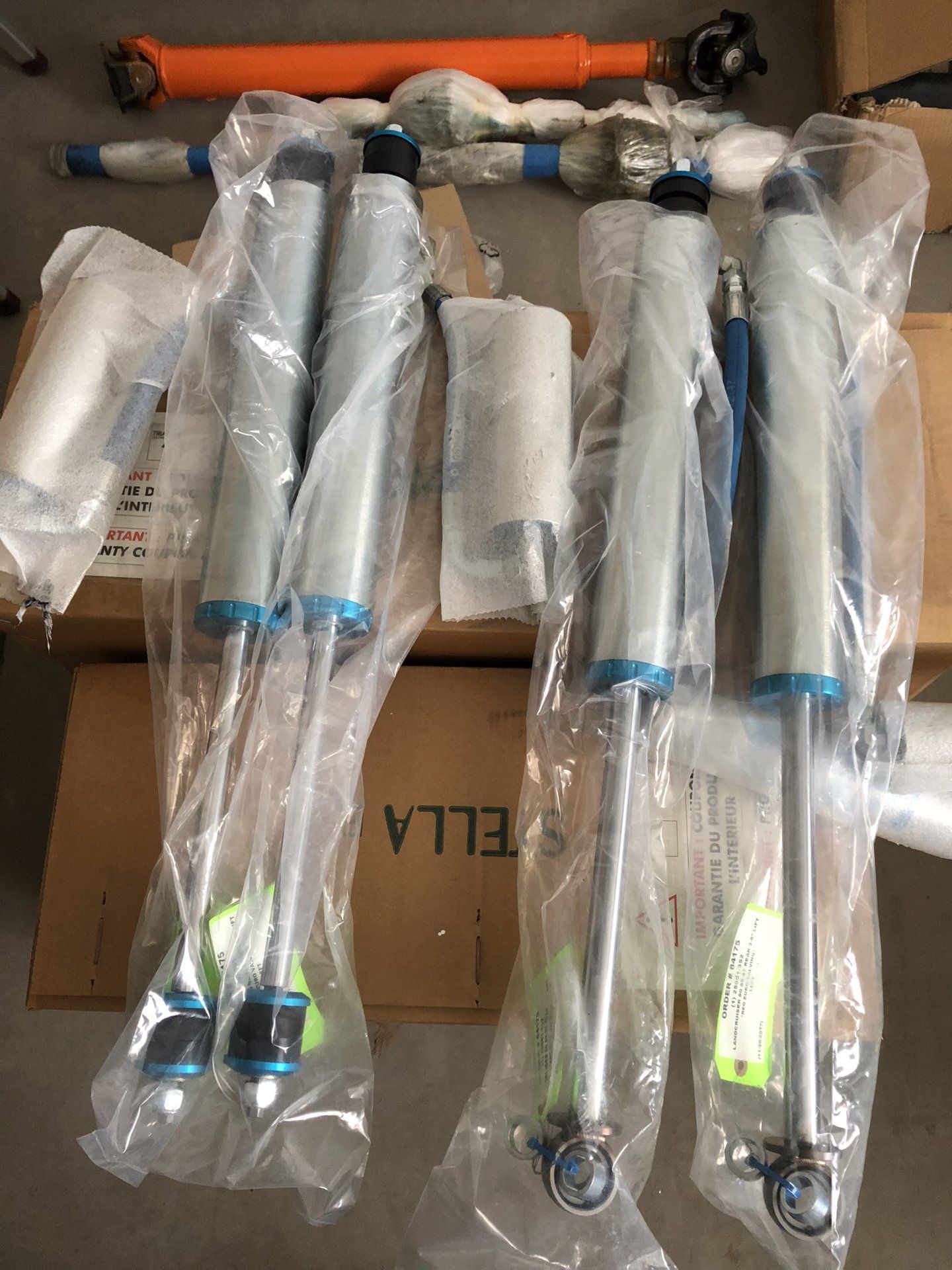

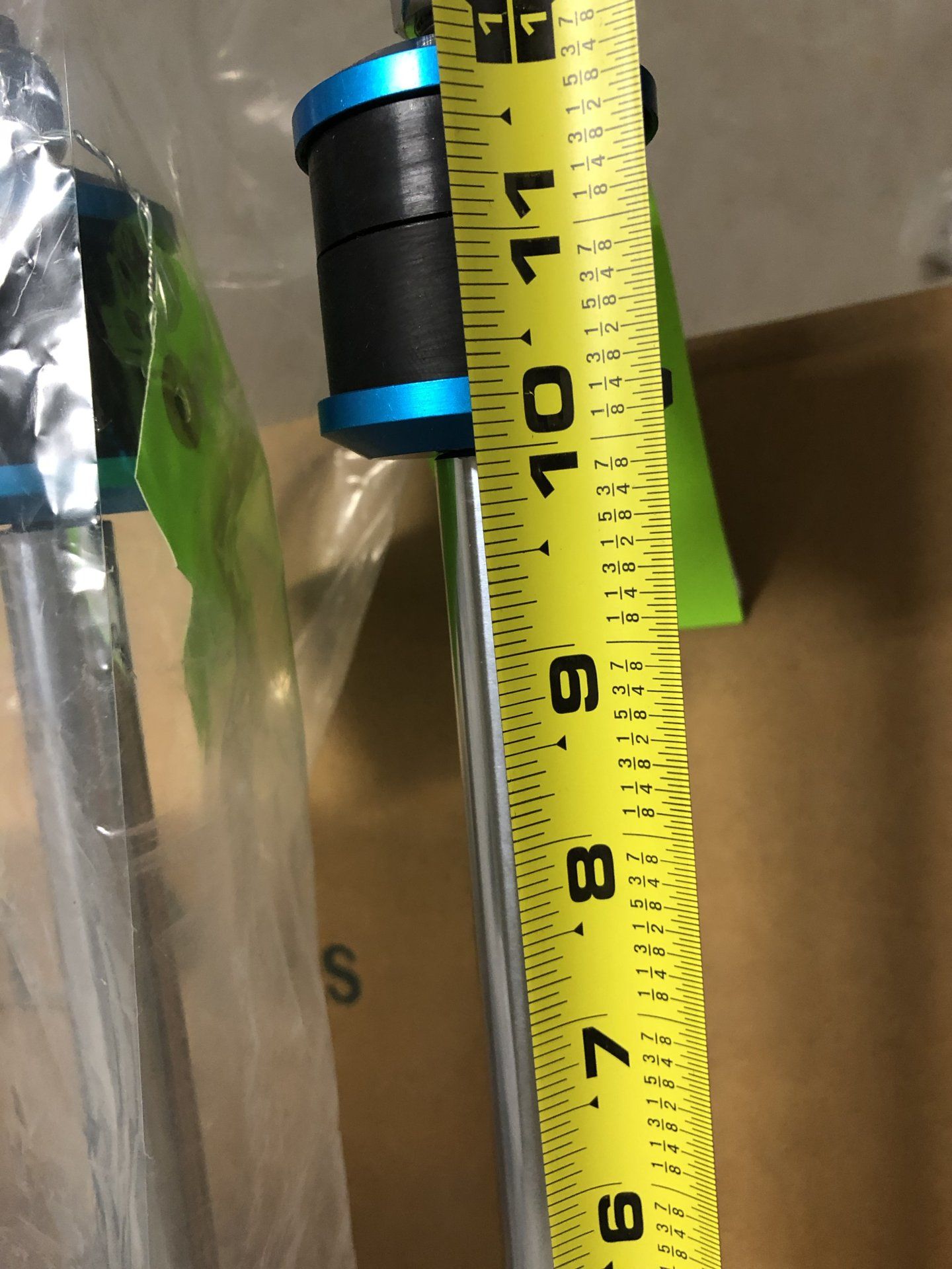

Here are pictures of the part number and order details, they are clearly labeled left and right so they must be left right specific. Kudos to King’s if they really tune their shocks that precisely!
Awesome Qball.... will you list the specs so we dont miss read the pictures.
Then I can post it on the 1st page.
