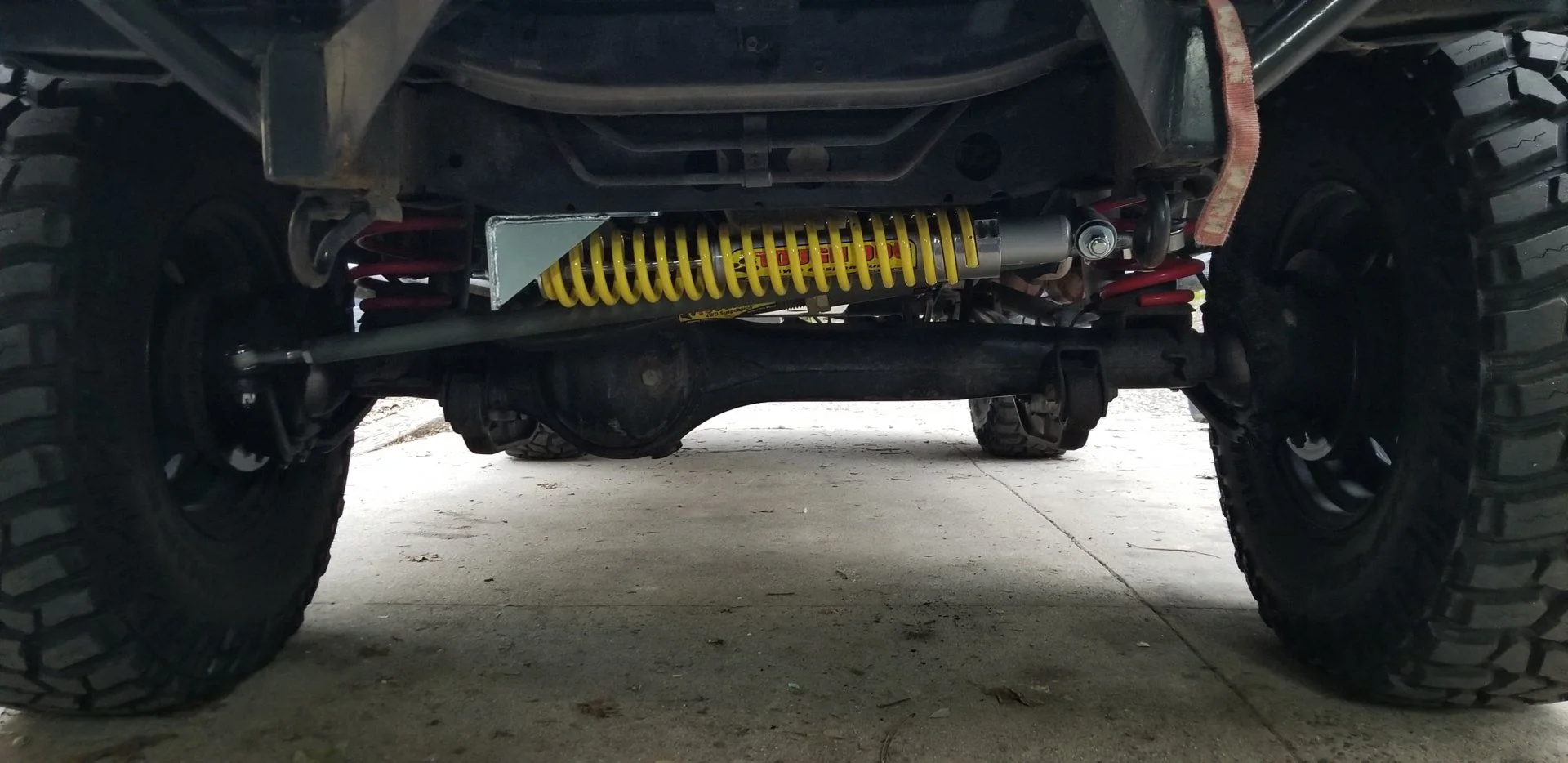

Added to my list of Tough Dog components, this RTC steering damper. Stout enough to handle big tires!
160.00 for standard RTC
185.00 for XHD-RTC

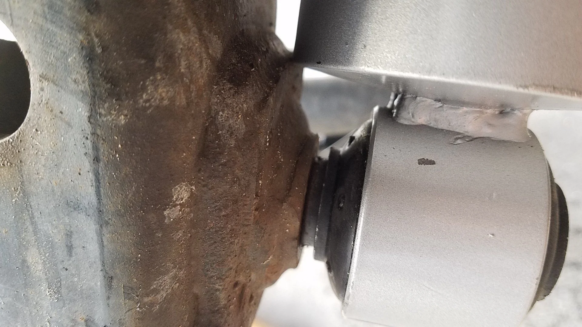

I'm installing rear tourflex springs and tough dog shocks right now. The OEM shock has 2 bushings and 4 metal washers at the top mount. The tough dog shock has 2 bushings and 3 metal washers. Does one of the bushings ride on the frame? If so, which one? I just want to make sure this sandwich goes together right.
Also the rear shock won't slide all the way onto the lower mount without the shock body contacting the mounting bracket. Am I doing something wrong? This seems sure to cause damage.

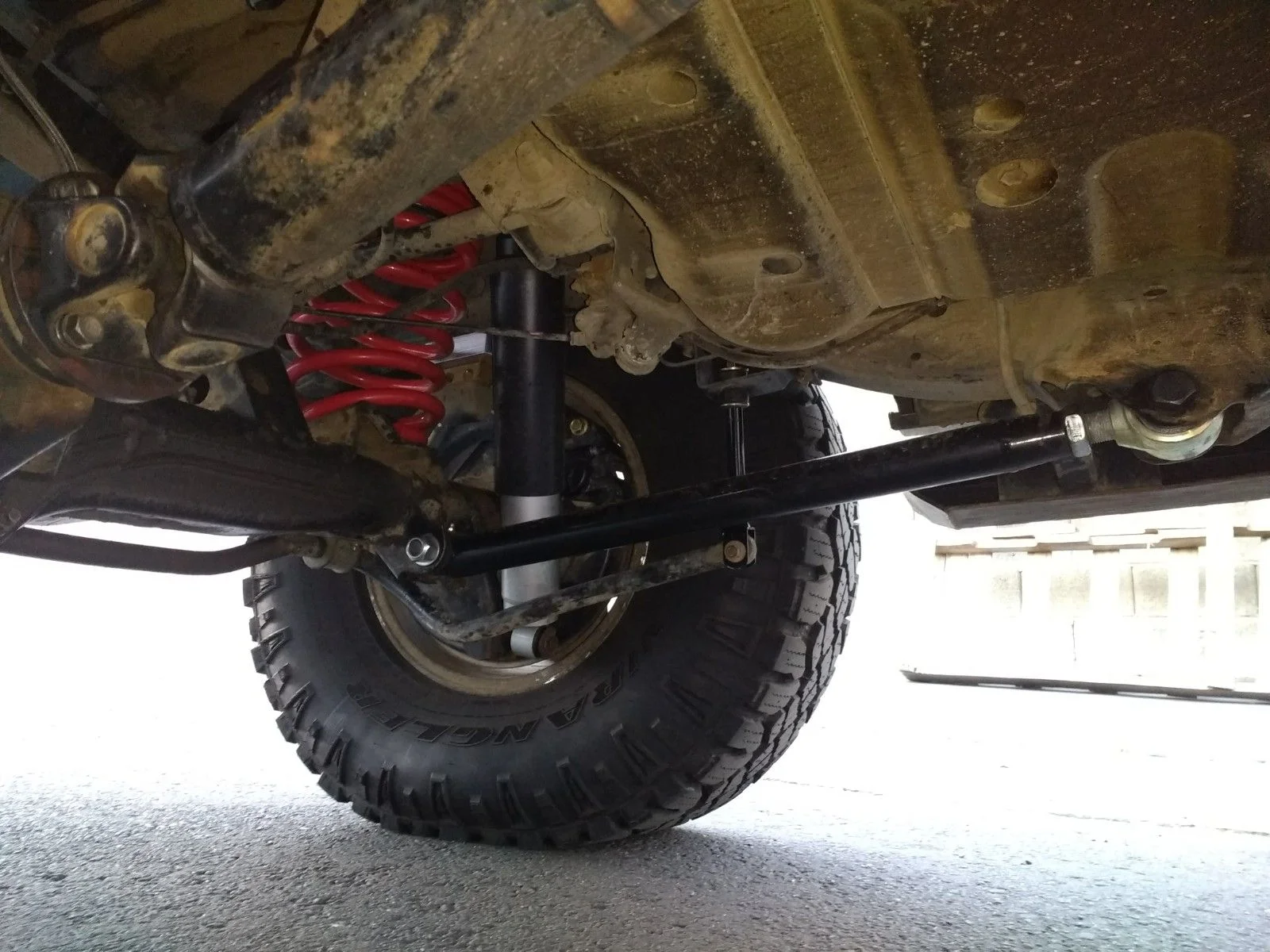

@TRAIL TAILOR I've always been told that a 4" lift is necessary for the XHD RTC on an 80 but not quite sure why this would be the case as I can't see how a specific lift height is gonna have anything to do with a particular steering damper fitting or not.
Any comment on this please?
Same concept as a panhard. Since one end is attached to the frame and the other to axle/steering the angle/length changes the shorter or taller you go.
I have the XHD on 3" to 6" lifts and all work fine (all with 35" to 39" tires). A 3-4" is where you start seeing larger and heavier tires and this is where the XHD was designed. The standard RTC in my experience is good to about a 33 to 34" tire. IMO it just doesn't have enough spring strength to work as designed for the larger tires and this is where the XHD comes in. Also the reverse happens here. The XHD has about twice the spring strength and therefore takes more attention if used on small tires.
With the extra length of the XHD assy over a standard length stabilizer, IMO 3" is about the shortest lift that can be used with it.

To the previous post by @DMD08: I had the same shock vs. weld interference issue on one side of the axle. I just took a Dremel to the offending part of the shock pin mount (removed very little material), and problem solved.
Also the rear shock won't slide all the way onto the lower mount without the shock body contacting the mounting bracket. Am I doing something wrong? This seems sure to cause damage.View attachment 1957547
Anyone have any info on this? I have the 53mm for the rear and it looks like there is no way in hell its sliding on the rear lower shock mount.
That's weird. The TD website shows that the 45's and 53's have the same 70mm OD casing, so fitup should be the same. Try putting the lower mount on first? I have to do this with my 45's.
I actually have the 45s sorry about that but I’m definitely going to have to grind some material off that lower mount so that it can slide on. Or use washers to space it off the mount a bit...
