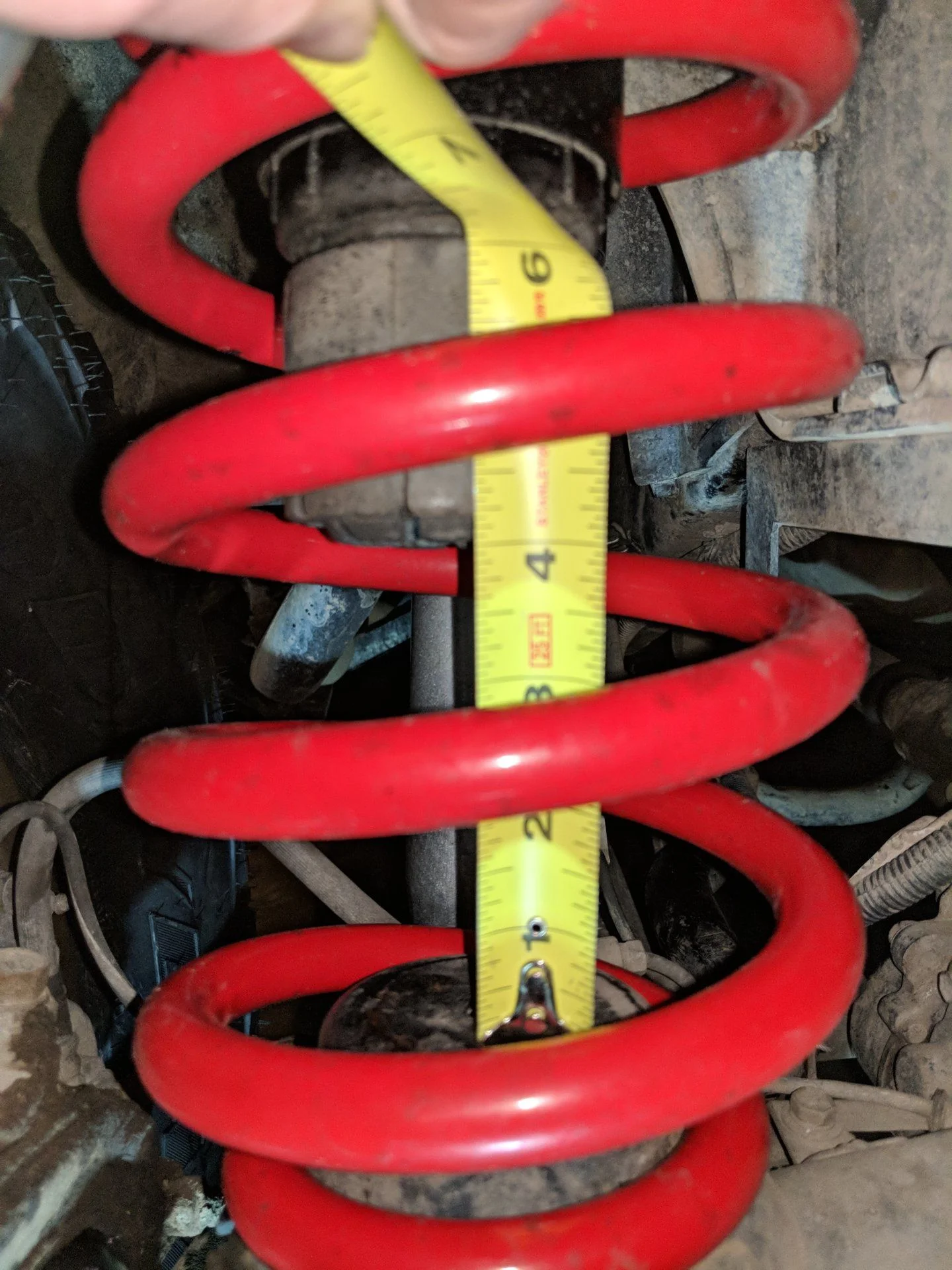

Once I seem to remember reading the factory distance from the inner cone bumpstops to the strike surface and thought about using that to measure lift. I am thinking it is a better way to determine lift amounts now that so many are trimming fenders and not running flares. Anyone privy to this knowledge?

For instance, my 2HF springs are giving me right at 4" of up travel before the center of the bumpstop makes contact. I'd guess before i had about an inch of uptravel before contact with the original springs, I know these arent 3+" lift springs yet i've gained 3" over my previous setup.

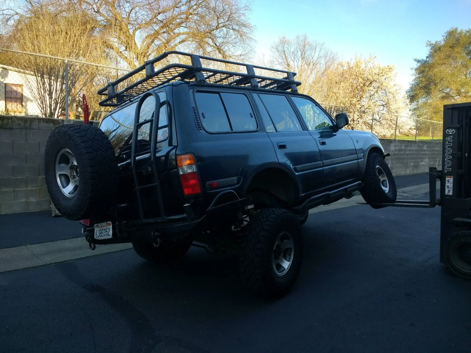

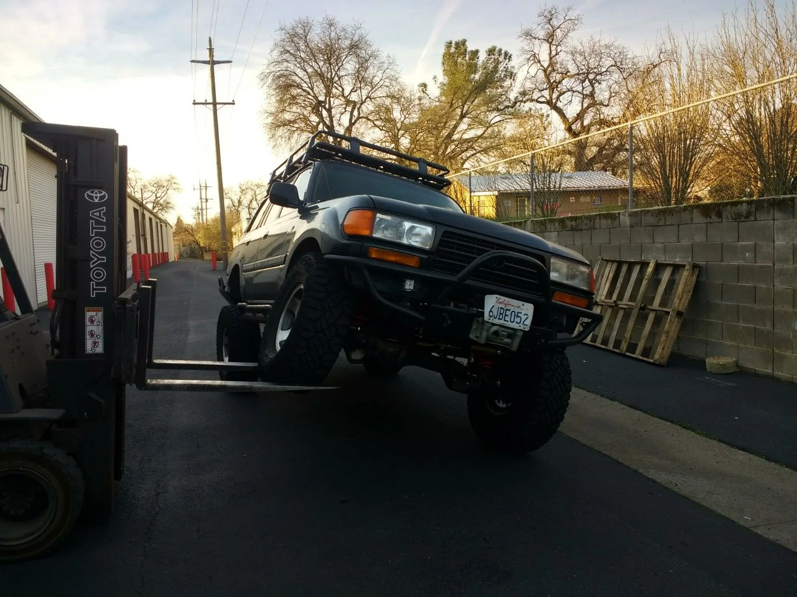

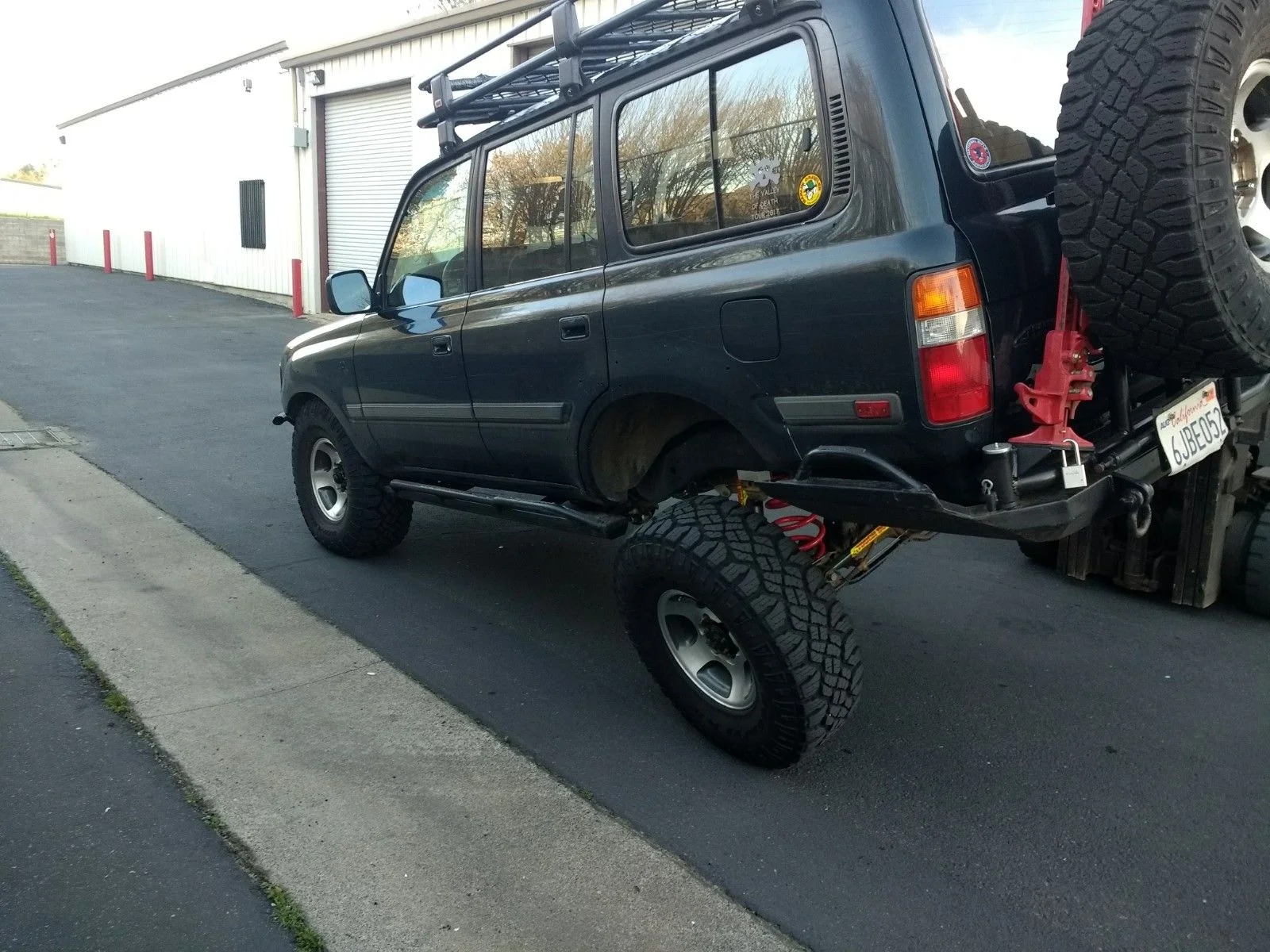

@NorCal97 came by the shop today and has the 3" TourFlex fully installed. He let me drive the rig and play a bit. I know he's happy with the kit, but I can say the feel on the street to the controlled flex of the rig is just incredible. No top heavy body roll even with a full basket ARB rack when hard braking and hard turning at 30mph. The rig just comes to a stop, no diving or roll.
I love happy customers and when the say "go ahead and hit that curb hard" just makes me smile when I'm driving their rig.,,. The 8"-10" curb felt like hitting a large crack in an asphalt road.
Was there a reason to not go with the 9 stage adjustable shocks on the front ?
Basically his load doesn't change up front and for what he will be using the rig for the 41mm up front makes the most sense. The 45mm are good for guys that range from a DD to a high speed rig. But the adj fronts tend to be set at 4-6 after a few weeks/months (basically same setting as the 41mm) and left there for the life of the shock.
The 45mm adj rears are ideal as the rig is loaded from 200-700# of gear/equipment.
