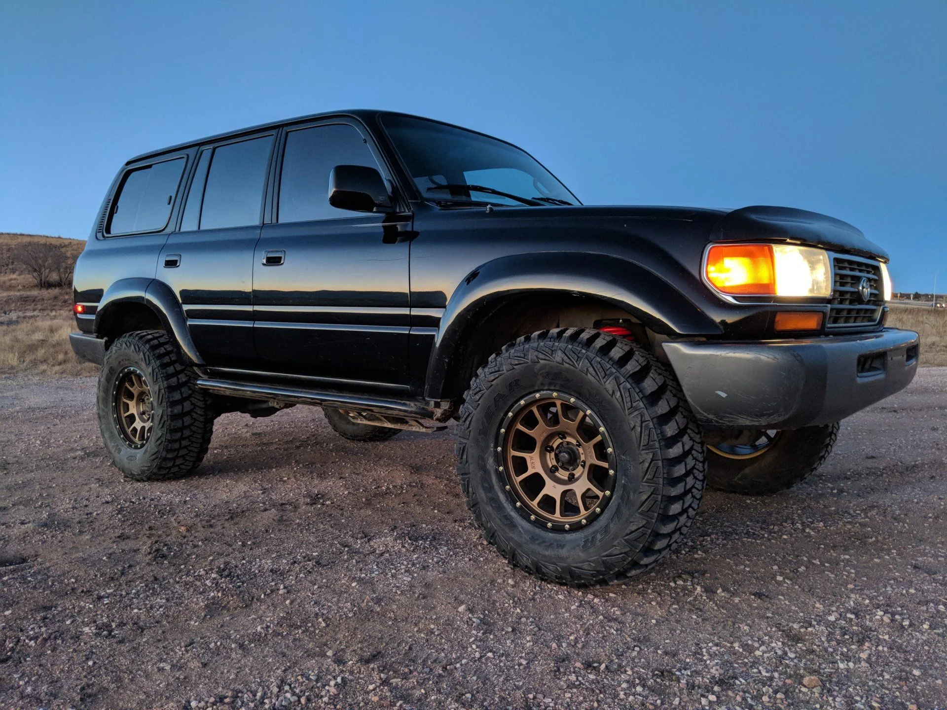

Mine went tall, real tall. I have the 2Fs with 35s, I can get some photos today showing it off. I'm hoping the back settles at least 1/2". 33s are going to be dwarfed by this kit.
The F springs settle a bit more than the HF coils. The F springs will settle about 5/8-3/4". The HF springs only settle about 3/8-1/2".

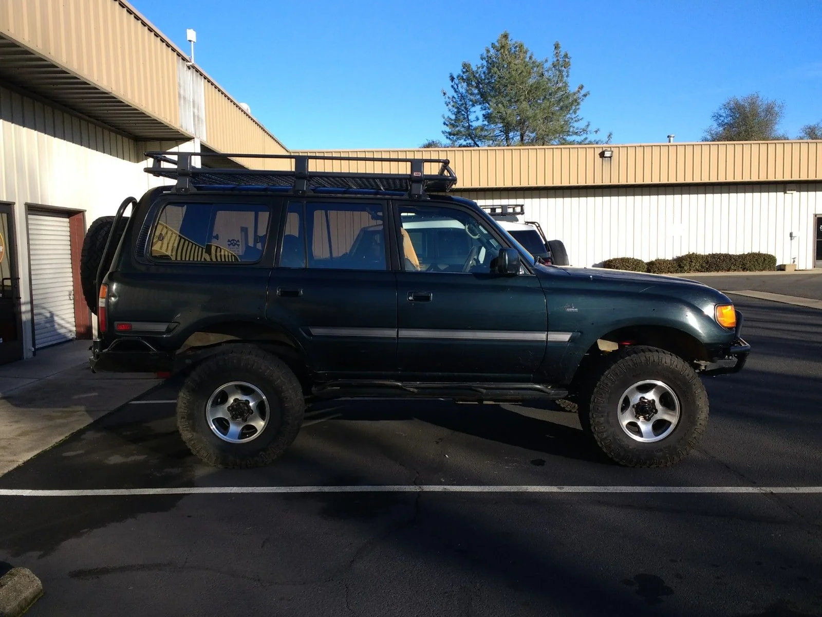

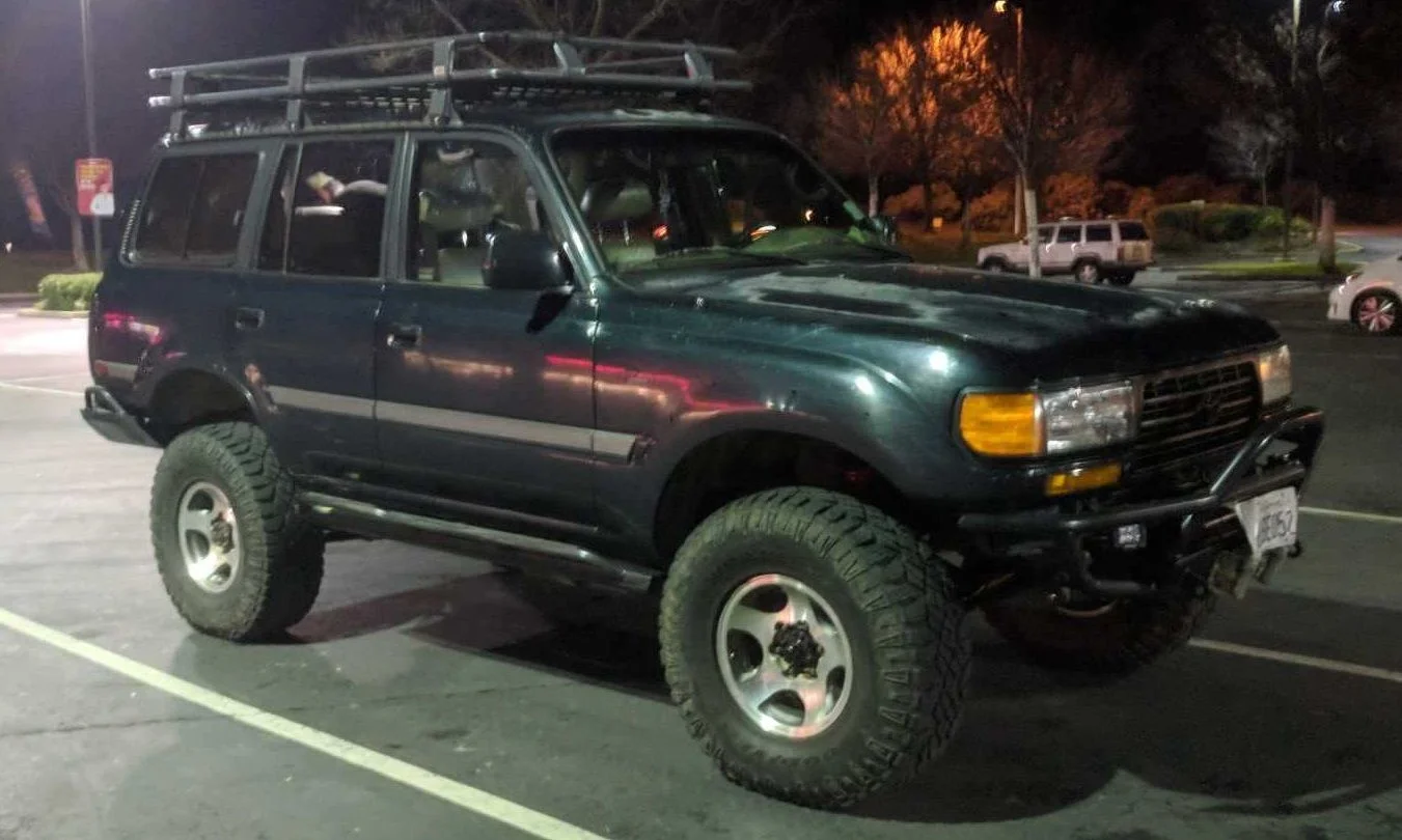

3F springs and 315 pictured.

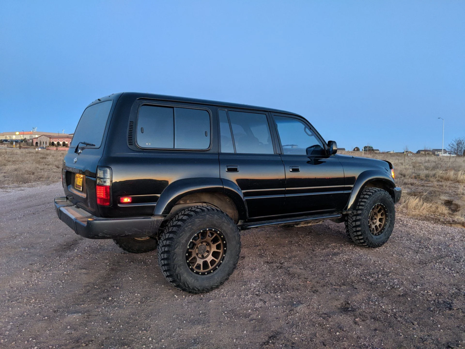

That's great news, thank you J.

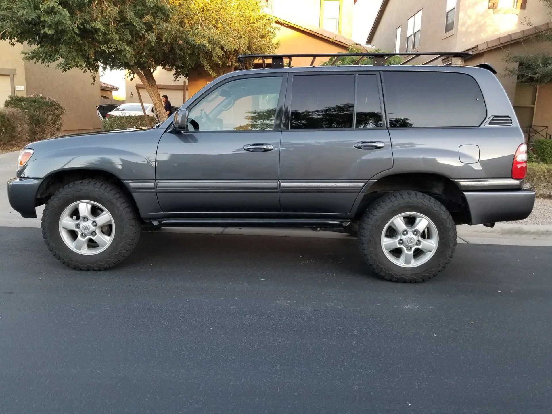

2HF front
2F rear
35/12.50/17 Goodyear MTRs
Sure J, thank you for asking.

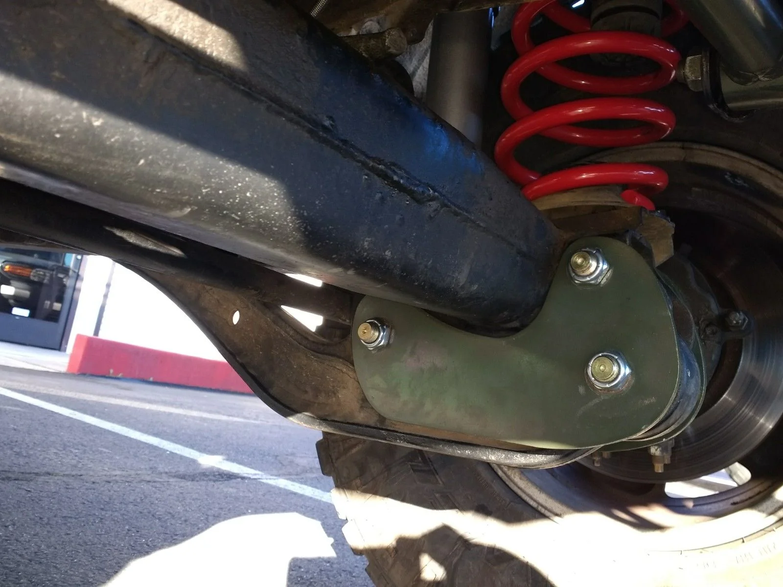

Got the @landtank / @NLXTACY 2.5" caster plates installed and it is riding and driving great! Thanks for offering a 100% better option than caster bushings.
Looks great! Whats next? Bumpers and rack :)?
Thank you.
Here's the profile photo you requested also, J.
Thank you, next will hopefully be a set of rear link guards from @reevesci .:grinpimp:

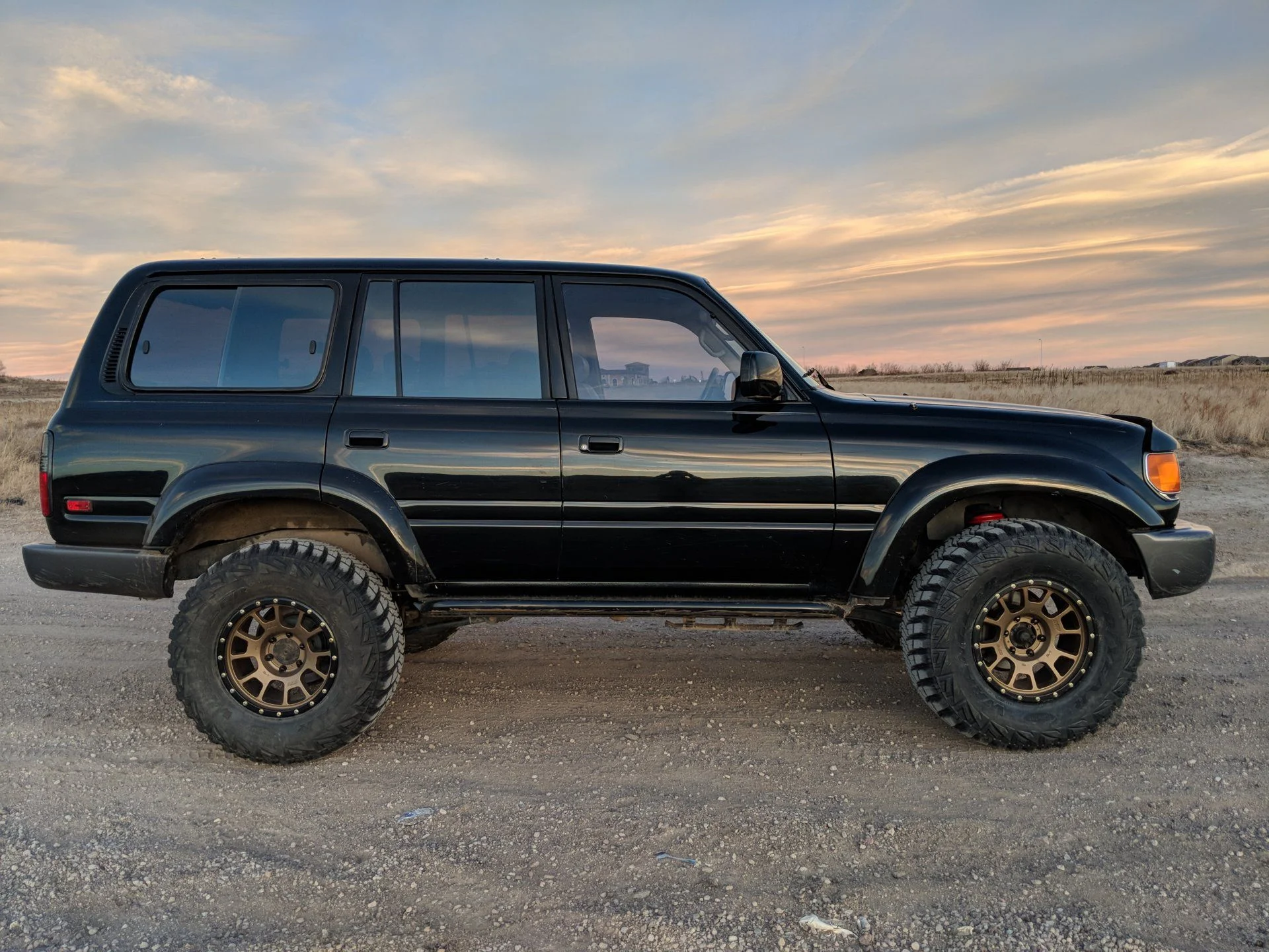

Here's the profile photo you requested also, J. Thank you for a great kit and option in the ~2" lift department.View attachment 1615385
I'll be at the shop tomorrow and Sunday. I hope to get the skids fit up.. Thank you for the side profile. Love this rig!

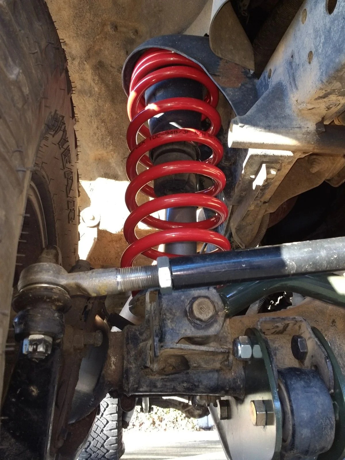

@NorCal97 came by this morning and I got to see the 3" TourFlex on his rig with 315s. Sitting at 24" F and 25" R with a 1" BL.
5 degree castor plates, 41mm fronts and 45mm 9 stage rears, Adjustable RLCAs, 3F rear coils and F & R adjustable panhard bars.

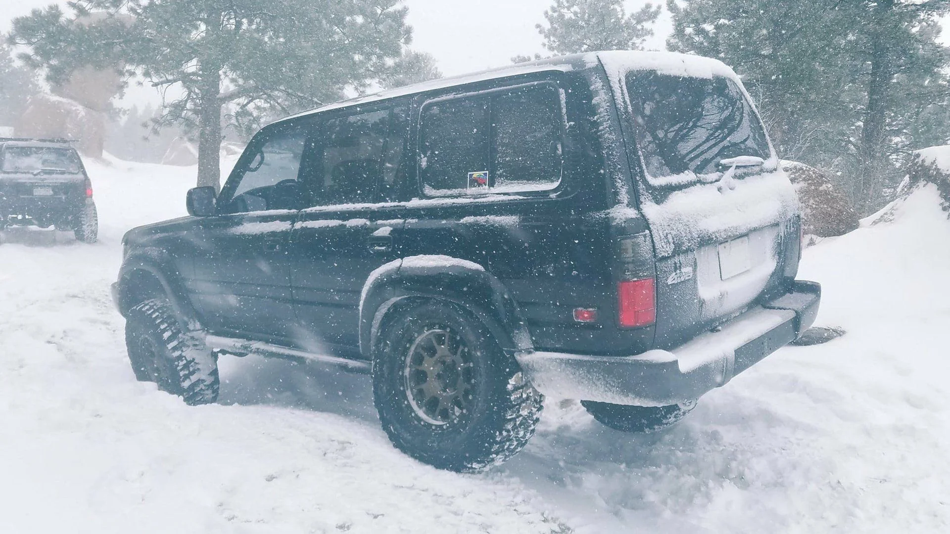

Got to work putting the 2" TF kit through it's paces today.
Should've unpinned the front swaybar! :meh:
