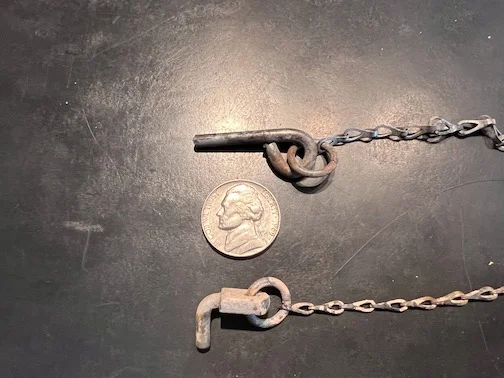

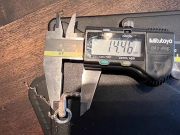

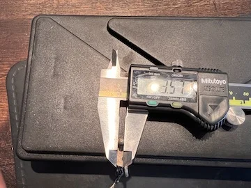

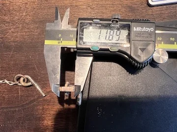

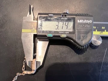

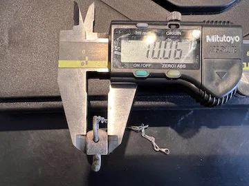

I've got a couple of the early ones I can measure as well (if I remember :p). They came out of my '65 40 and have assumed they were original to it. I was going to use them in my '63 45 instead, but the holes in the mounts in that rig (which I'm pretty certain are original) are smaller in diameter and these retainers don't fit in them ???? It's been a while since I chased this, I was going to try and figure out if there's an even earlier version of these, so for the 25's or such since my '63 is more like a '62 in a lot of parts. So maybe another dimension to all this.
Yes. Ill be near one tomorrow.
Thanks! I am going to try and make a pair for myself. Feeling crazy enough. hahaha . Logic should dictate I should go with the later style... because it's way easier to find a pin. But that wonky early version just needs to happen.
IMO, the earlier style looks like a smaller version of a particle board shelf bracket. I have the OE in the’68 and the’69 and sometimes find myself using them while camping for the novelty of offering a visitor a seat.😉
Older one is off of a 1963 FJ45, newer one is off of a 1972 FJ40.

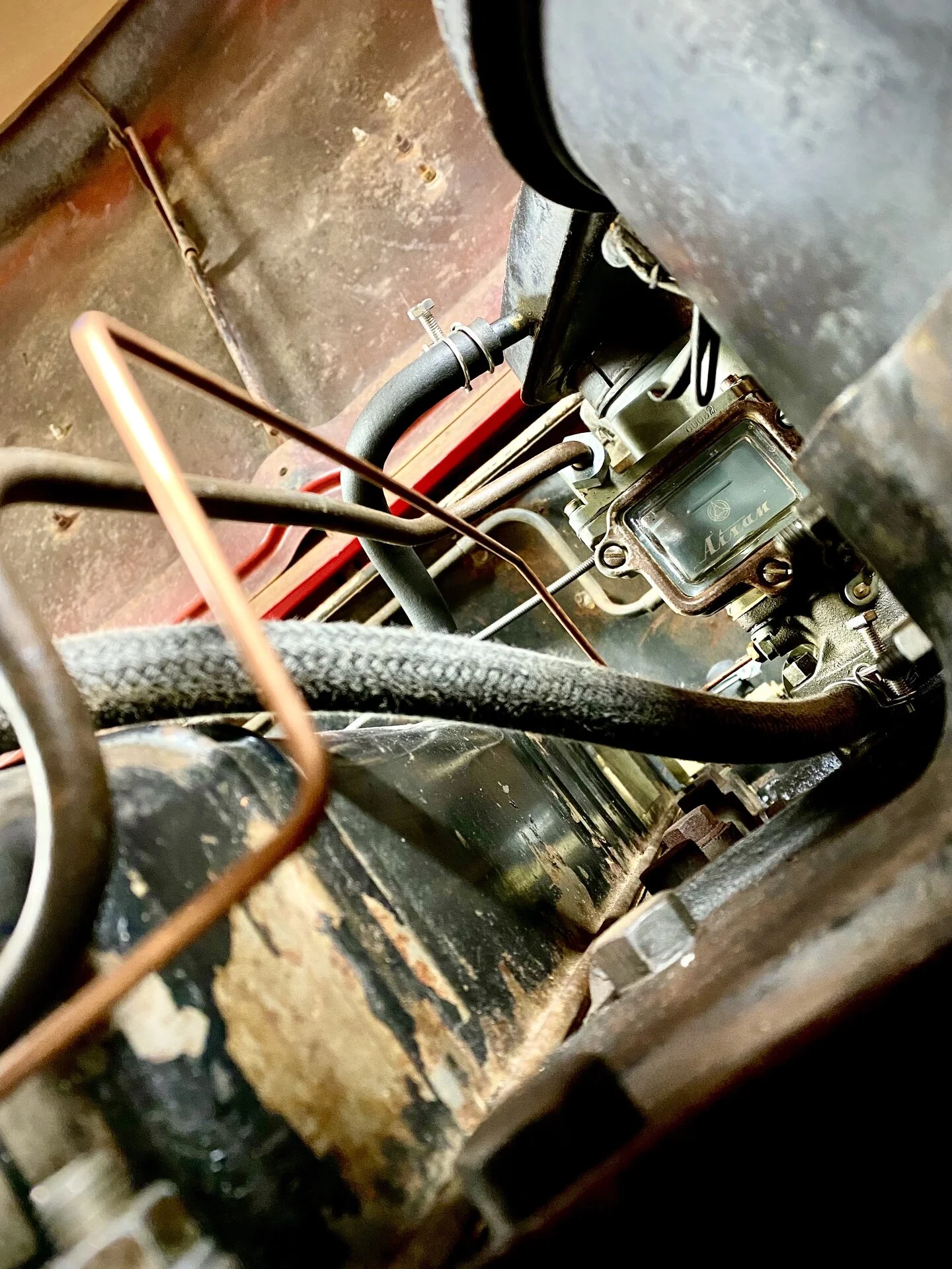

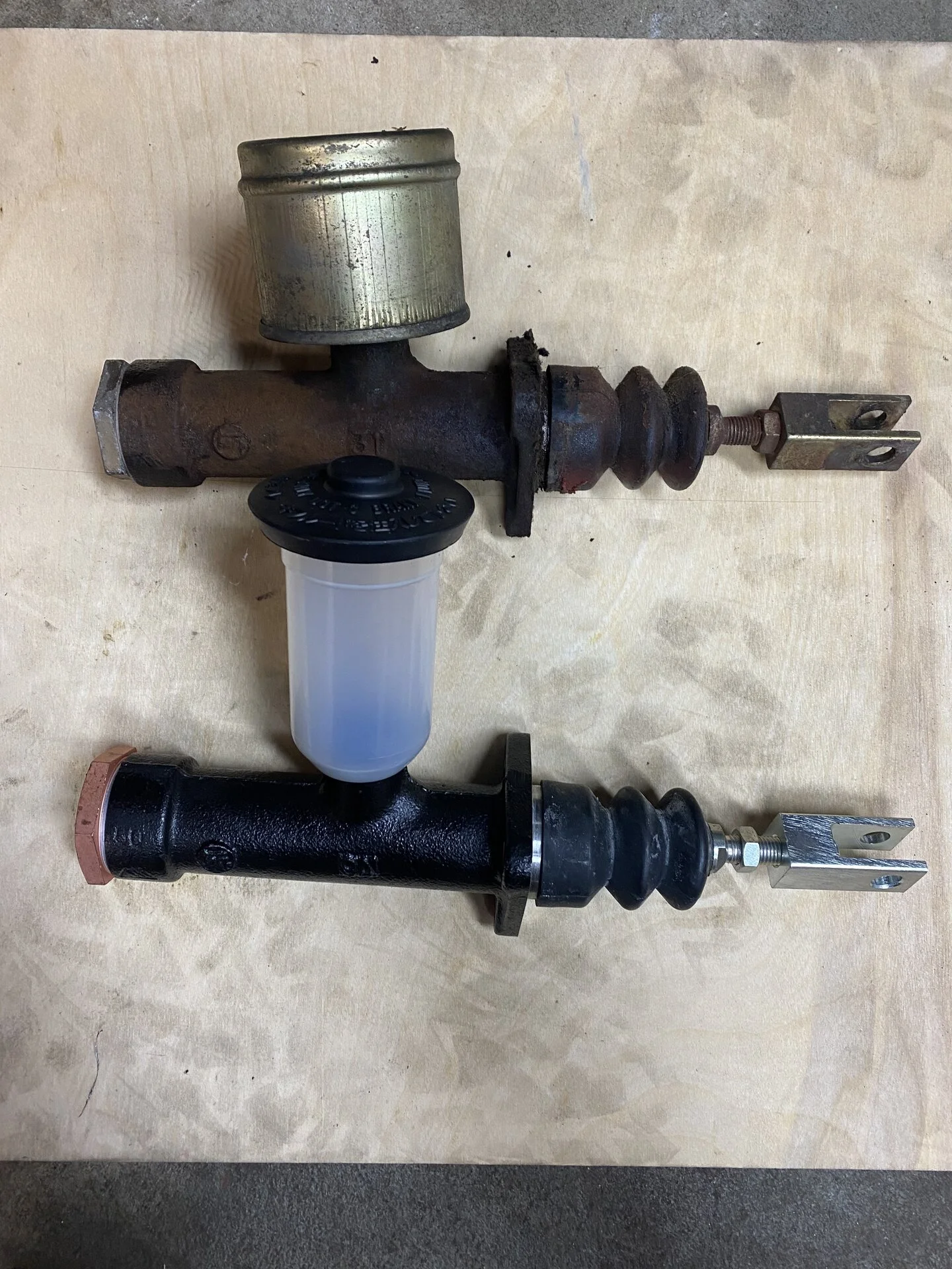

I got new lines made to the MC! There is something fun about making new brake lines. :) Also got a new MC in for the clutch. The OG one just looks too out of place now... and it was leaking badly. Plan is to swap the tin cup and end cap over.

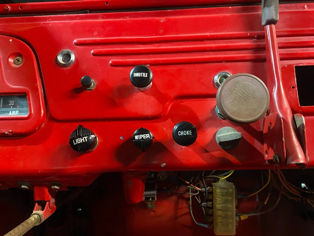

Worked on restoring some of the dash knobs! Installed a throttle knob bezel that I was missing. Thankfully Wits End made some! I sanded the knobs lightly with 400grit. Filled the letters with white epoxy. Then a top coat of 1K SEM semi gloss. Perfect! I think the full gloss is too shiny.
